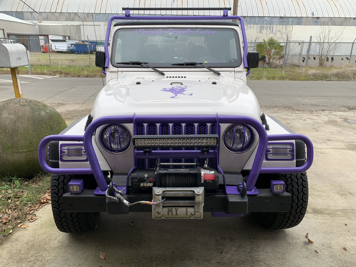

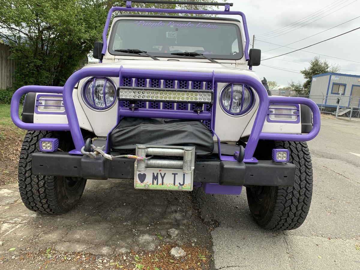

Since the last photos the main thing I did was add the winch.

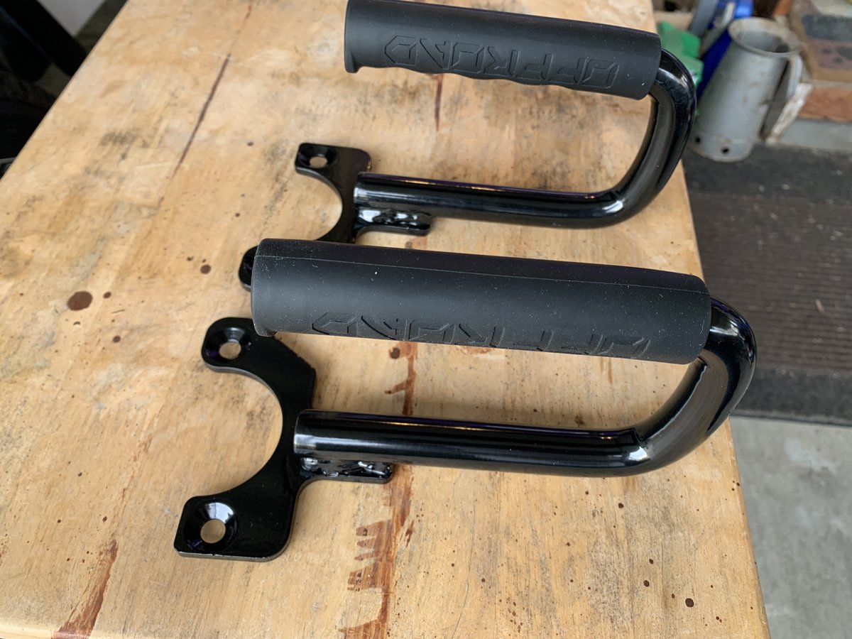

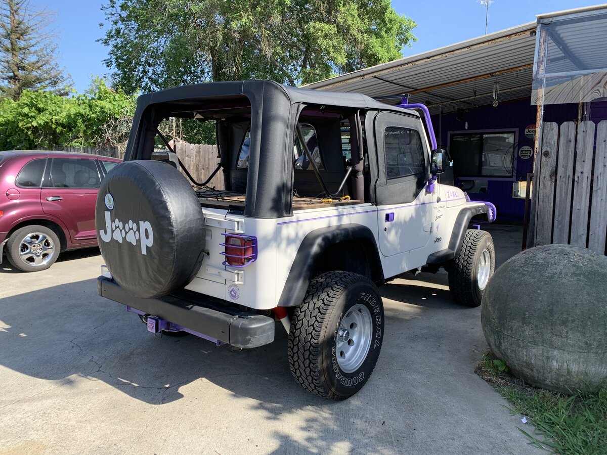

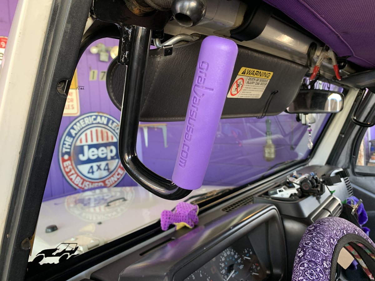

Installed some grab bars,
Then made them purple. :D

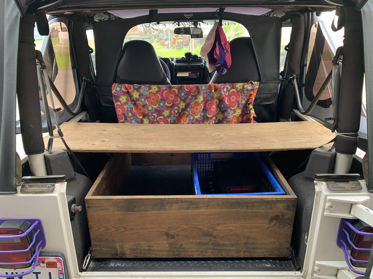

For that run I wanted to take some chairs and it is always a pain to have the chairs in the back and still be able to open my drawer to get to our lunches and all. So, I made a platform to hold the chairs. I'm going to make it cover the whole back in this summer, but in a pinch this worked. :D

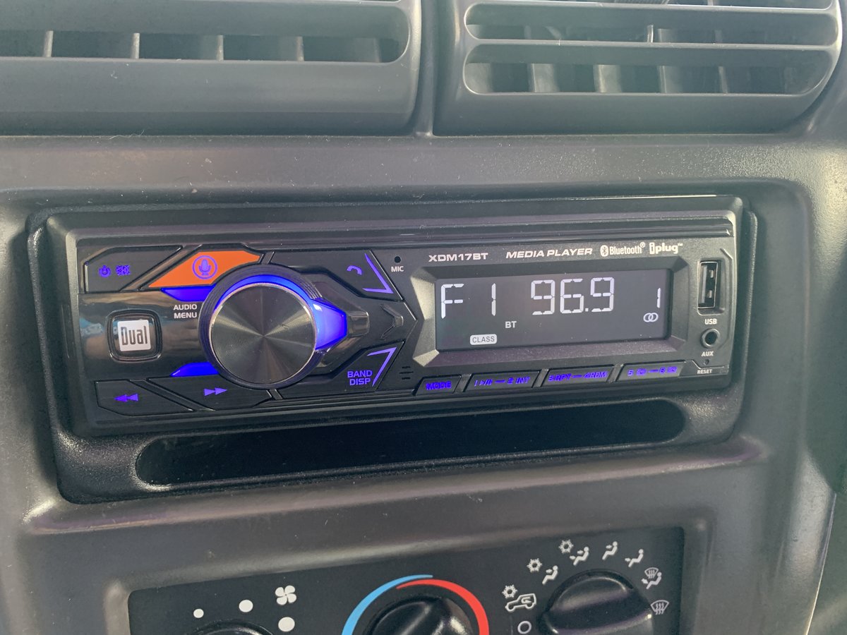

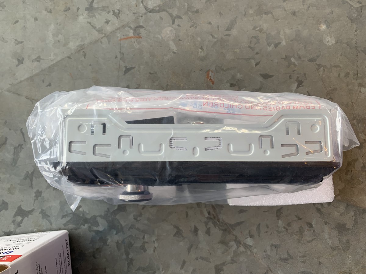

My radio quit on me again, so I found this cheap radio at Walmart. With 2 year warranty, came to 22 bucks. :D

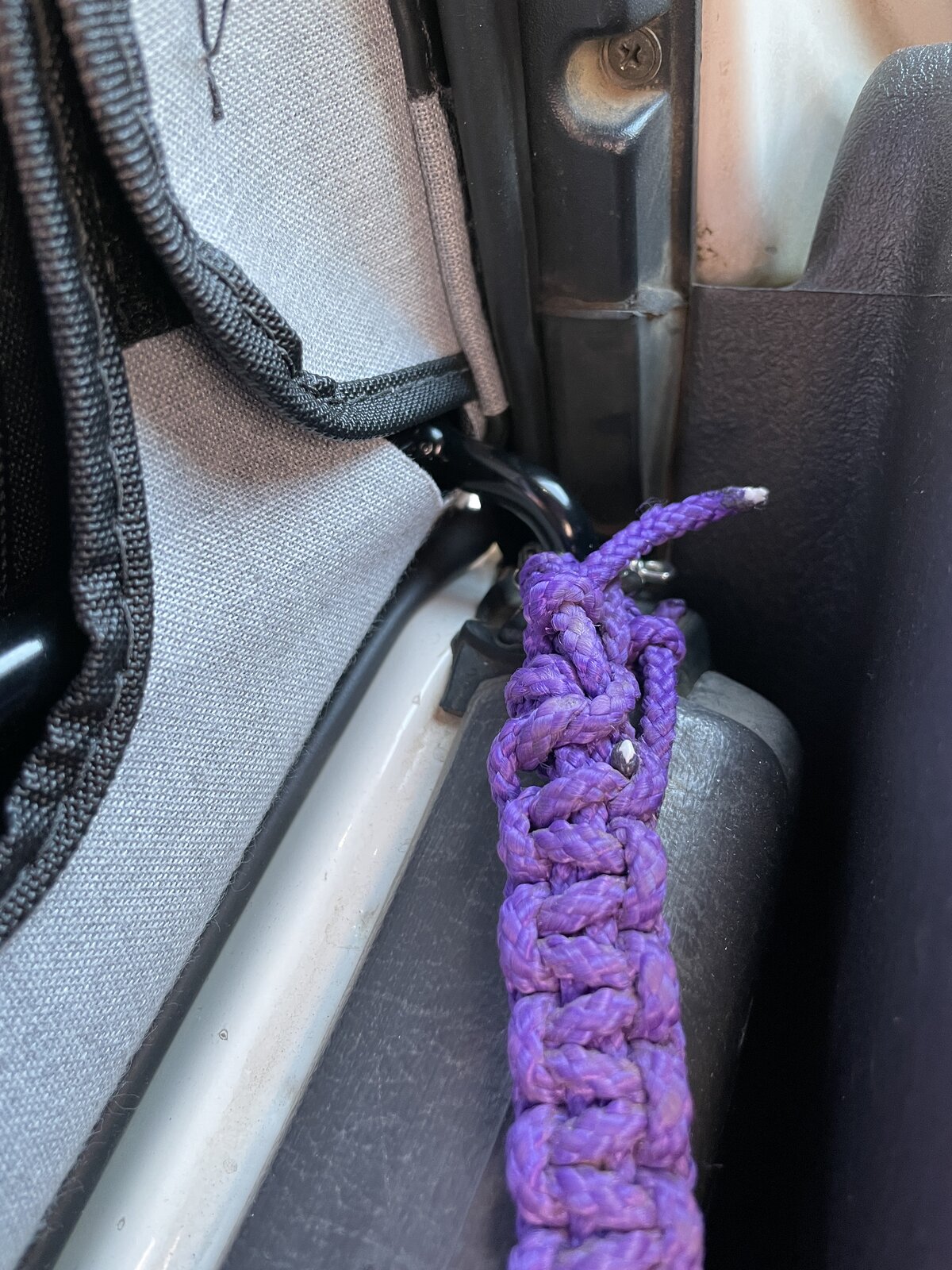

I was finding that when the door was fully open, I would grab the door panel toward the top to pull it shut. So I made a parachord lanyard to pull it with. :D Works great!!

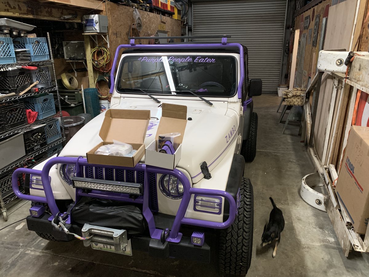

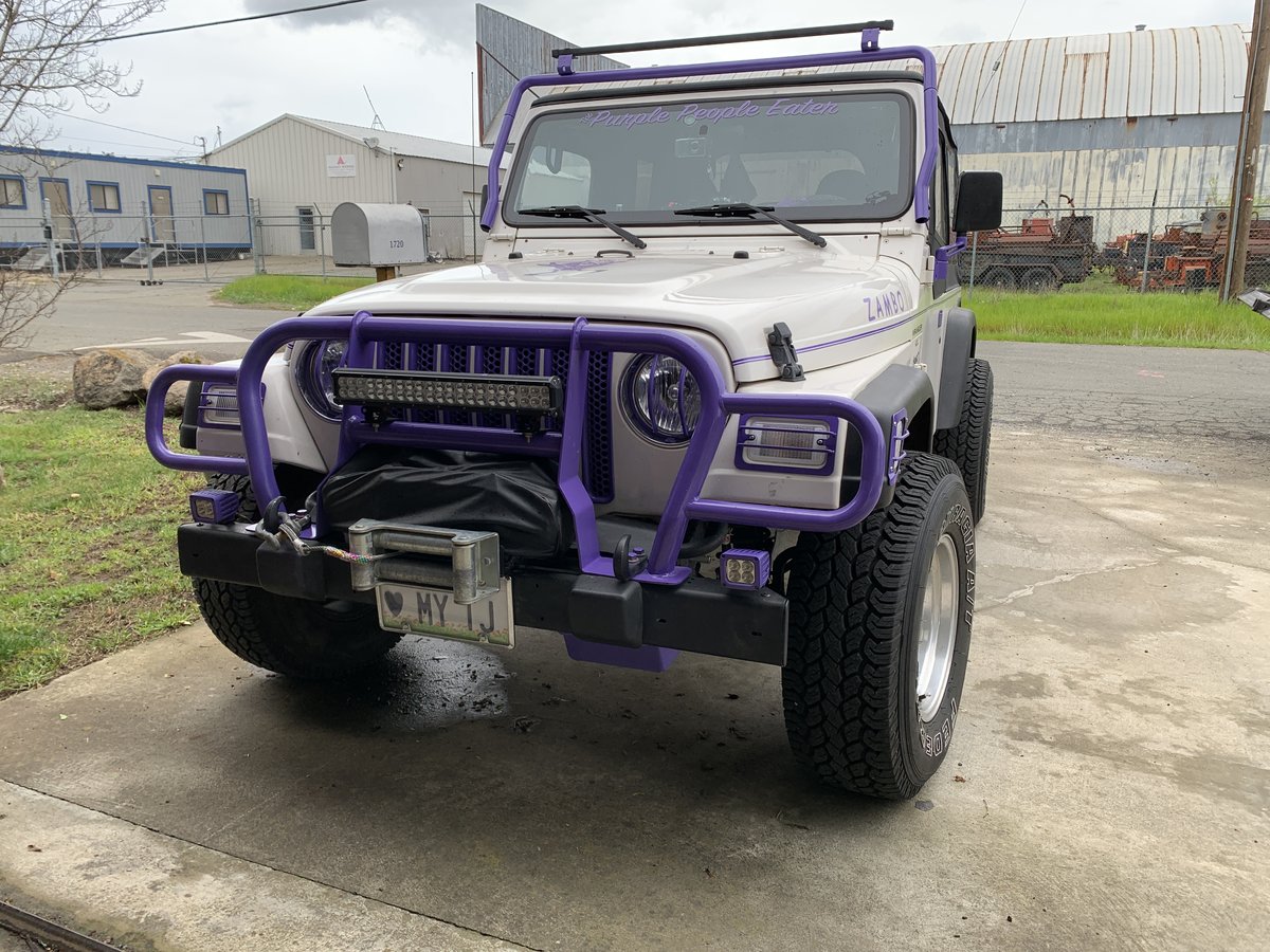

And finally, to get things all caught up. Today I installed my 1.25" Savvy BL and my Brown Dog 1" MML. For the most part I did the BL by myself. :D I did have to have hubby's help in the MML. That was a pain in the a$$.
Getting ready to start. :D
My helpers
We found these 2 hiding between the radiator and the grille. Hubby had to fish them out with a magnet.
Left over parts. :D
I forgot to take a pic of the original height. It was 18". I remembered to take a pic of the after. It just didn't come out that great. A little over 19" now.
Here are some after pics.
View attachment 146383View attachment 146384View attachment 146385View attachment 146386View attachment 146387
I can no longer see the grille guard from the inside.
I'm going to be painting that dirty piece to the left black eventually. :D
And here are the side by side pics. Before on the left after right. You can see how the grille guard now sits lower then the hood. I will be raising that up a bit eventually. I can't get to the headlight screws that easily with the way it is now.
Ok, all caught up. :D

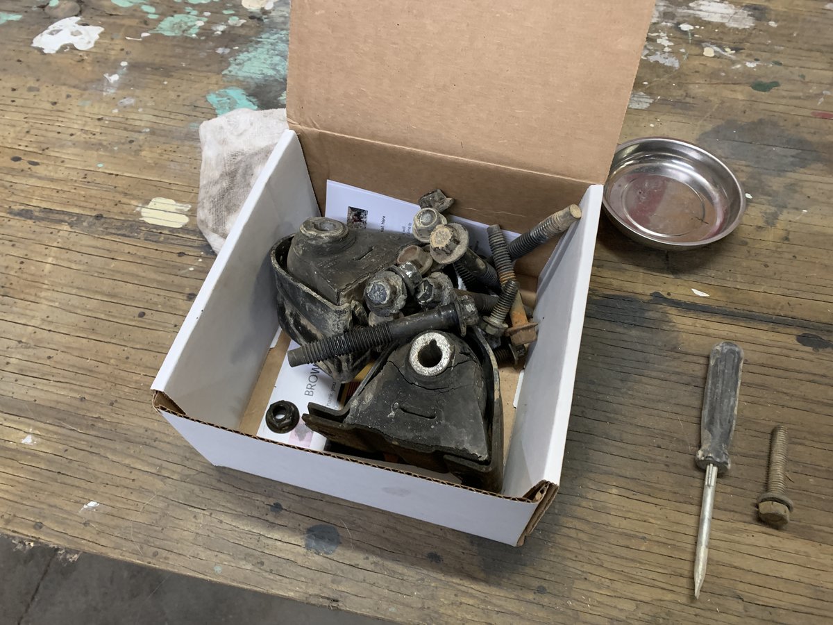

It’s a really good thing you ended up going with those engine mounts! Your stock ones were cracking bad :(
Ya. Those stock mounts were shot. Looking good.

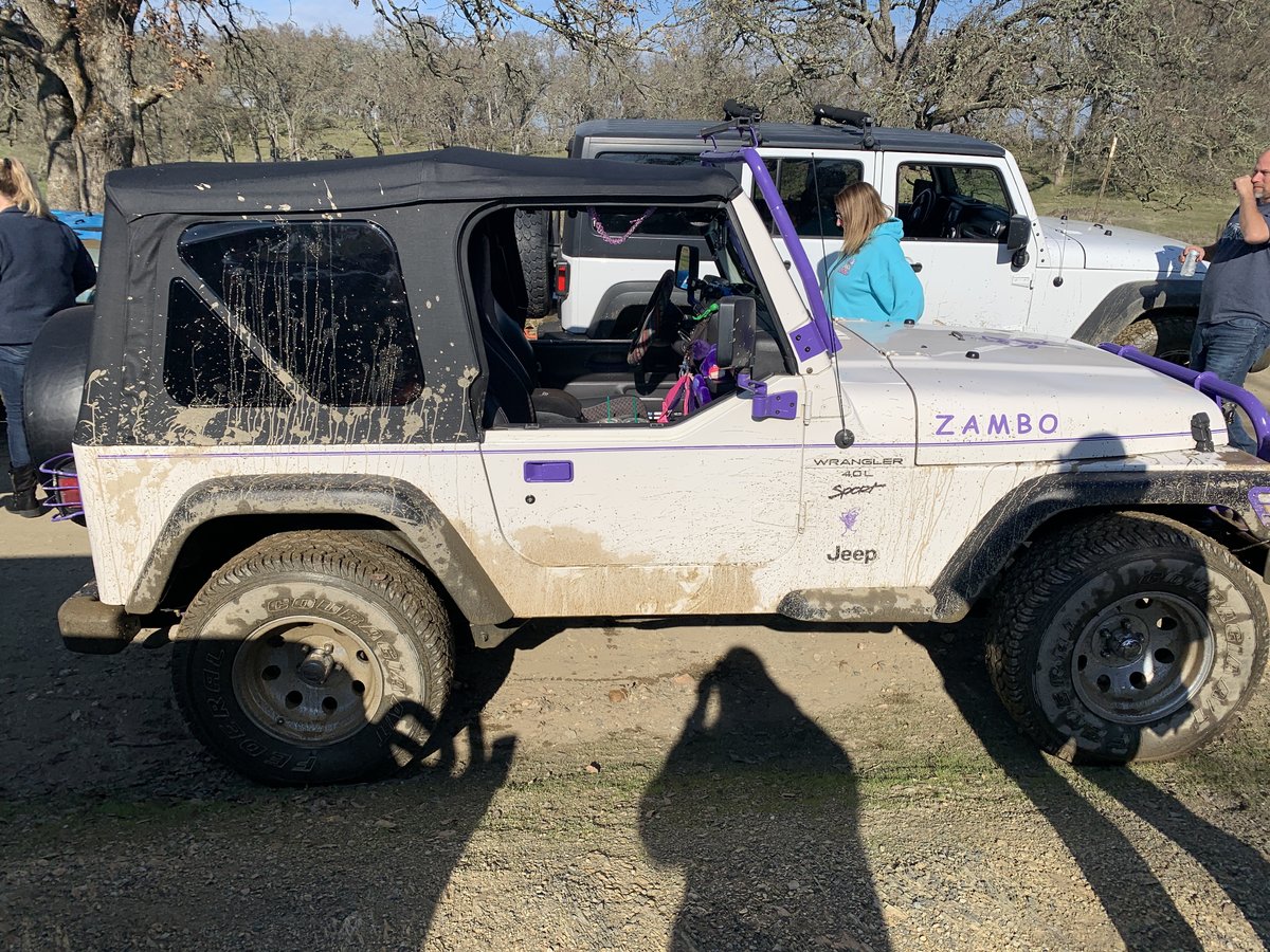

Went on a 4 wheel drive run with a group here in Sac.

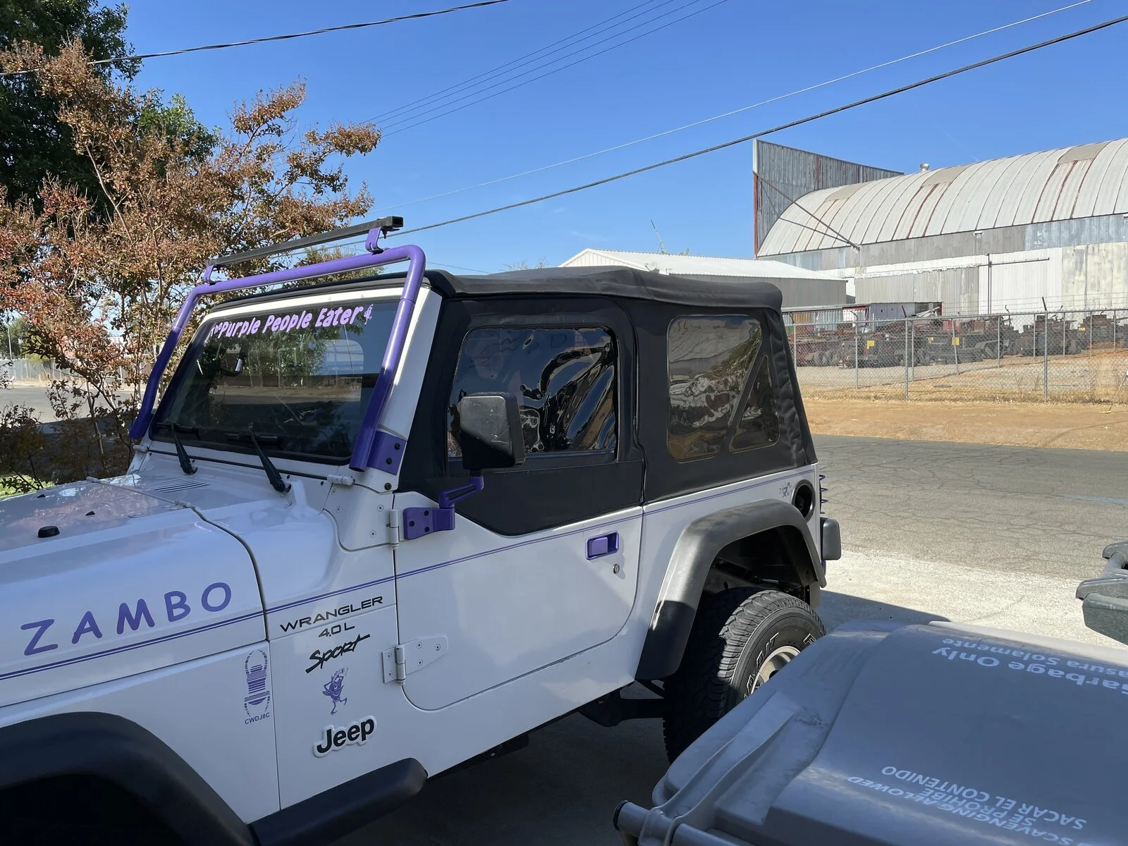

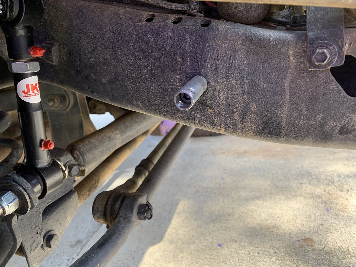

Installed a set of JKS quick disconnects I got from a member here. :D
Went on another 4 wheel drive run with another group here in Sac. :D This was the first time disconnecting my links. This is where I found out I wanted a lift. LOL

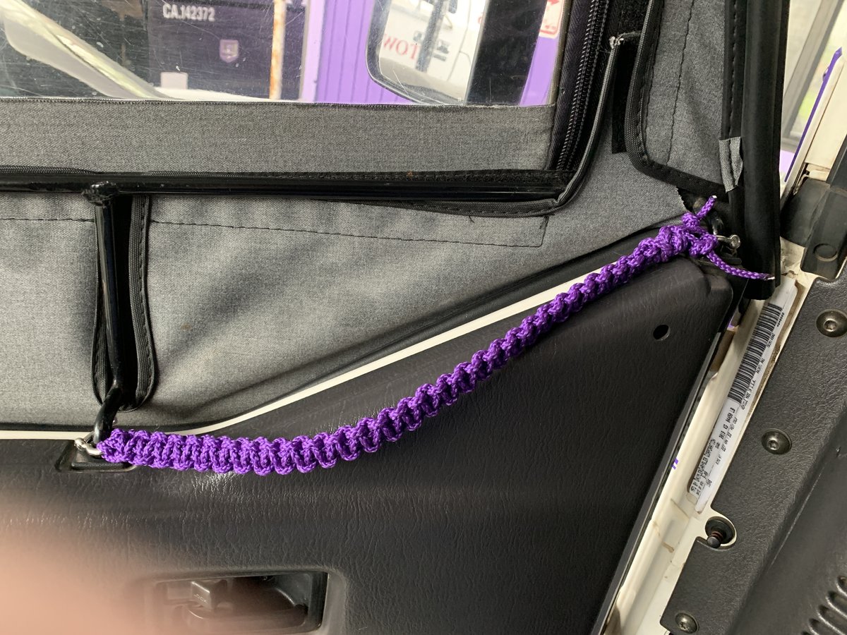

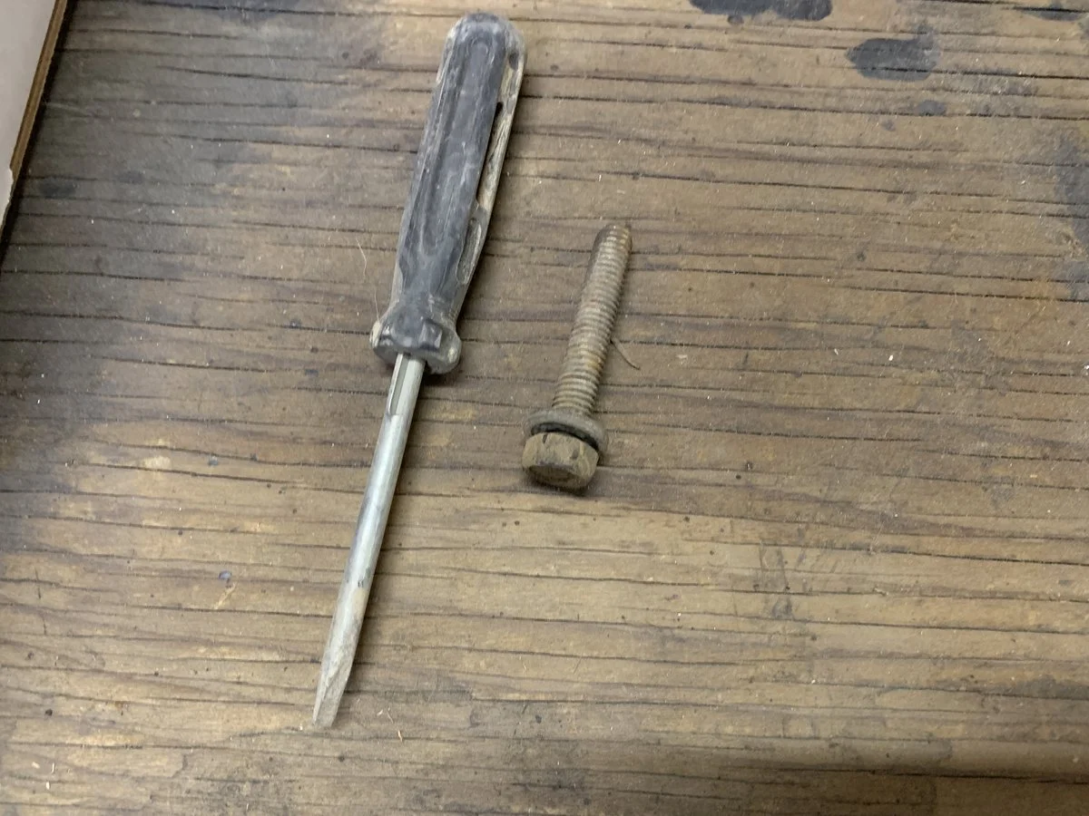

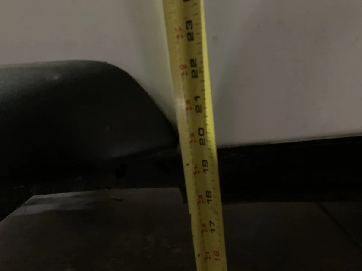

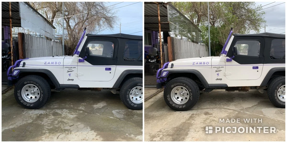

Yah, I noticed that and told hubby they looked pretty bad. We also found out one of my rear shocks is shot. It's leaking whatever is in there. Looks like I'm going to have to get shocks asap. I'll probably just go with the Rancho 0-2" lift. I have read several say that even with a 2 inch lift, the 2-3" ones are too long.

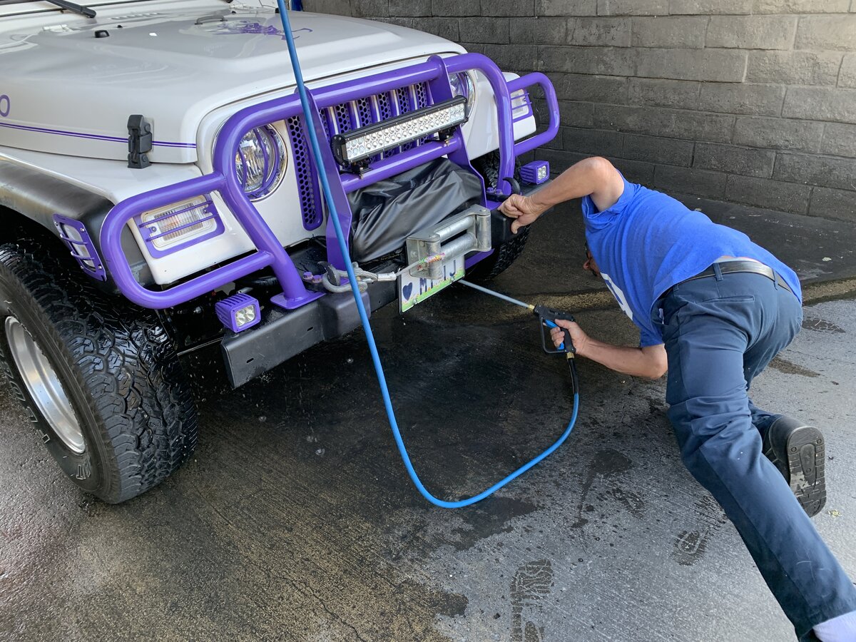

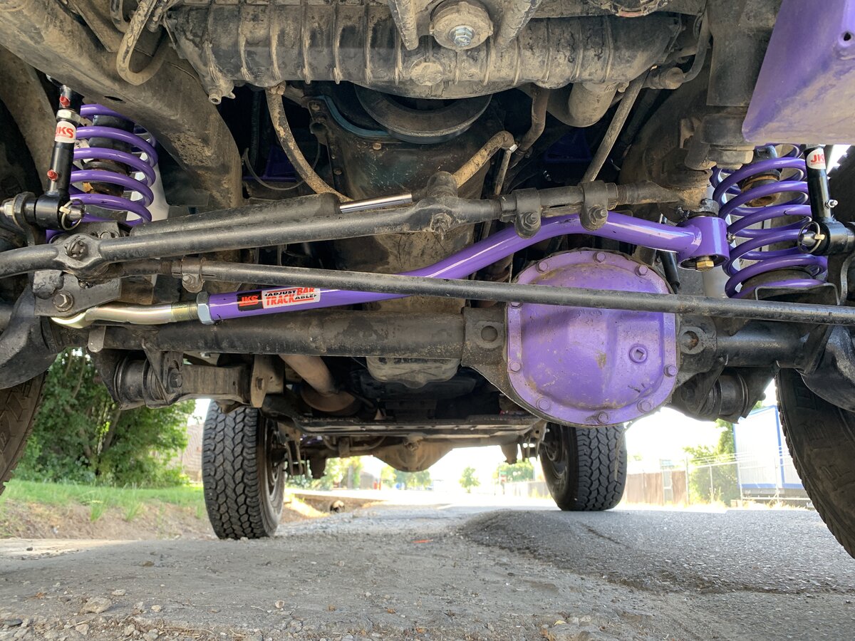

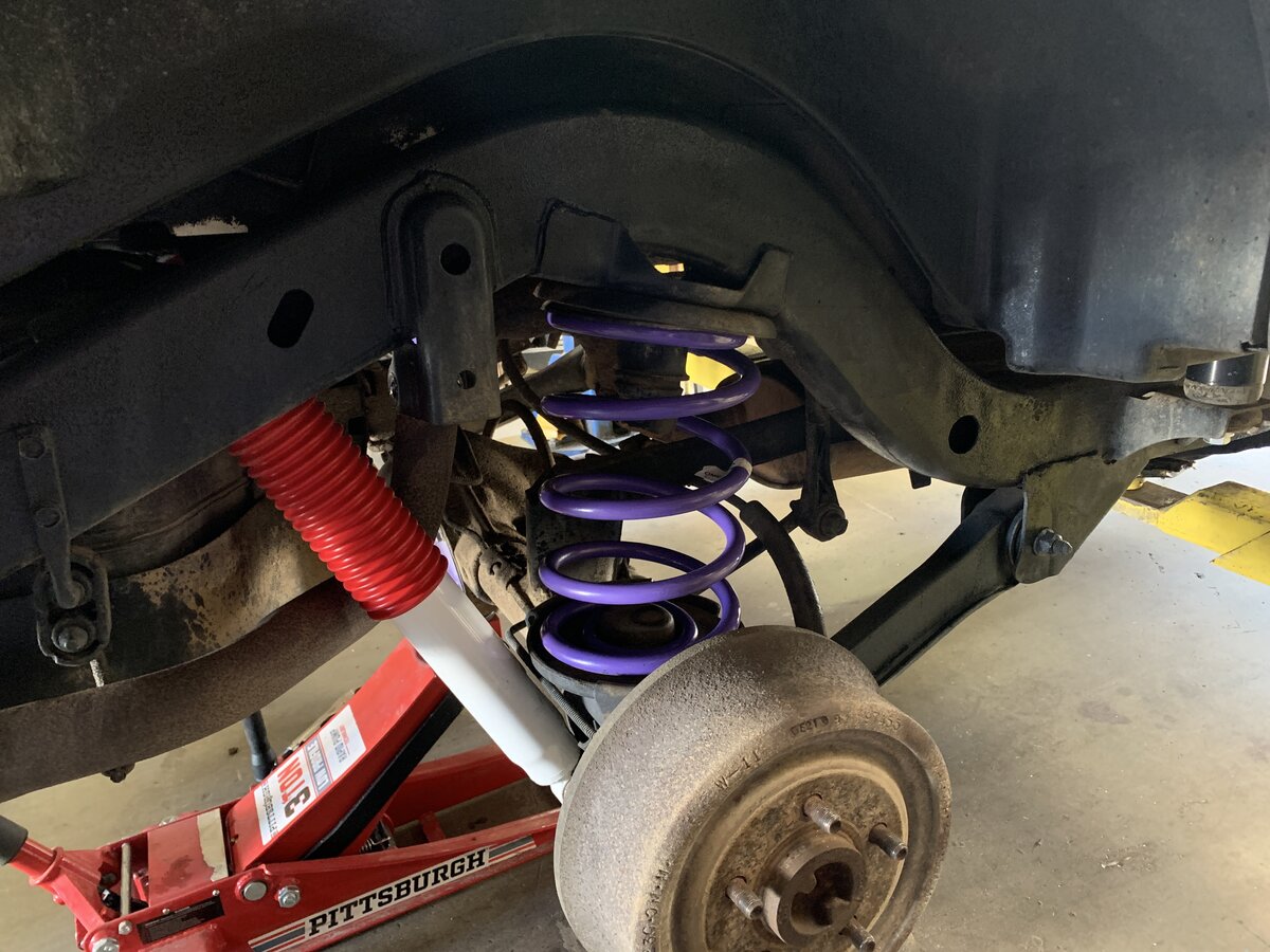

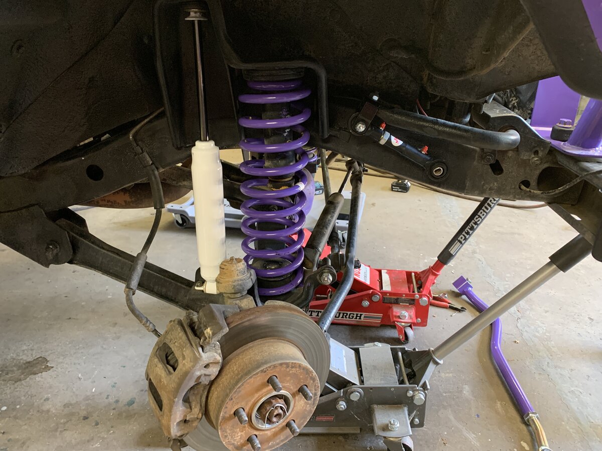

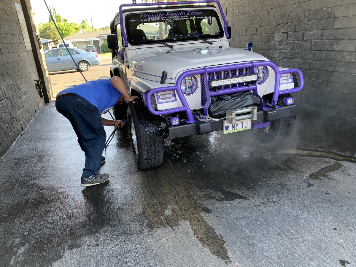

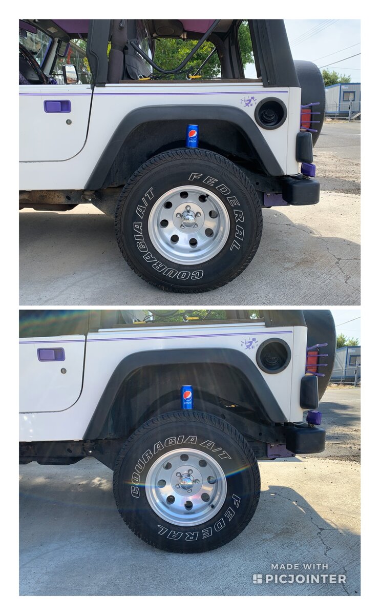

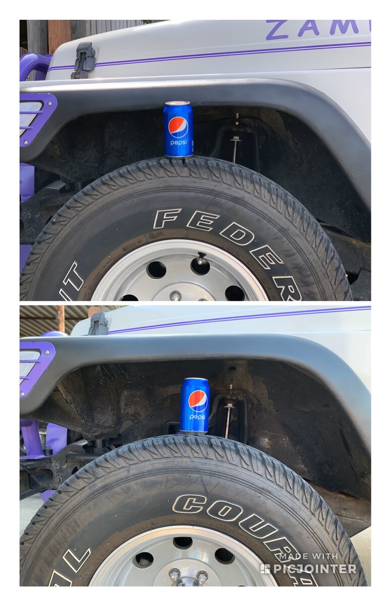

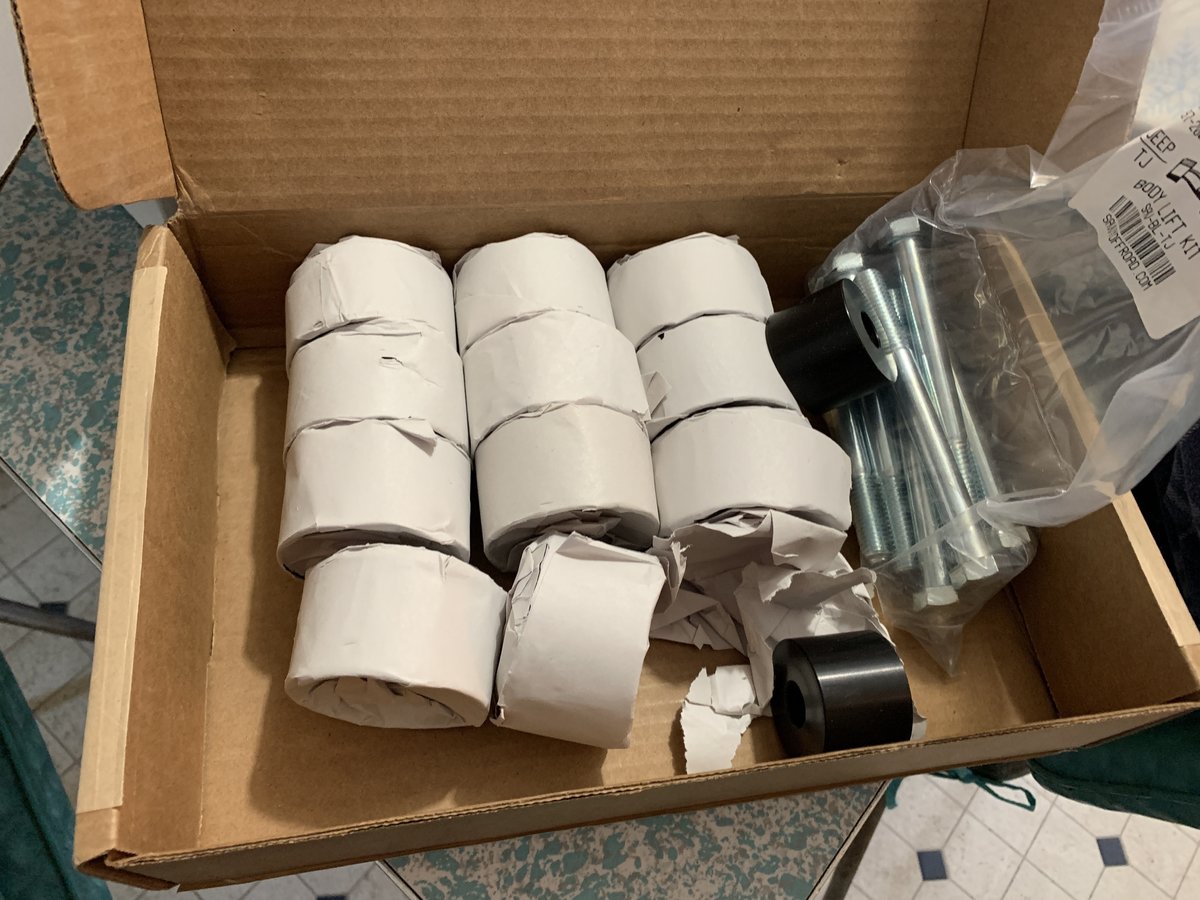

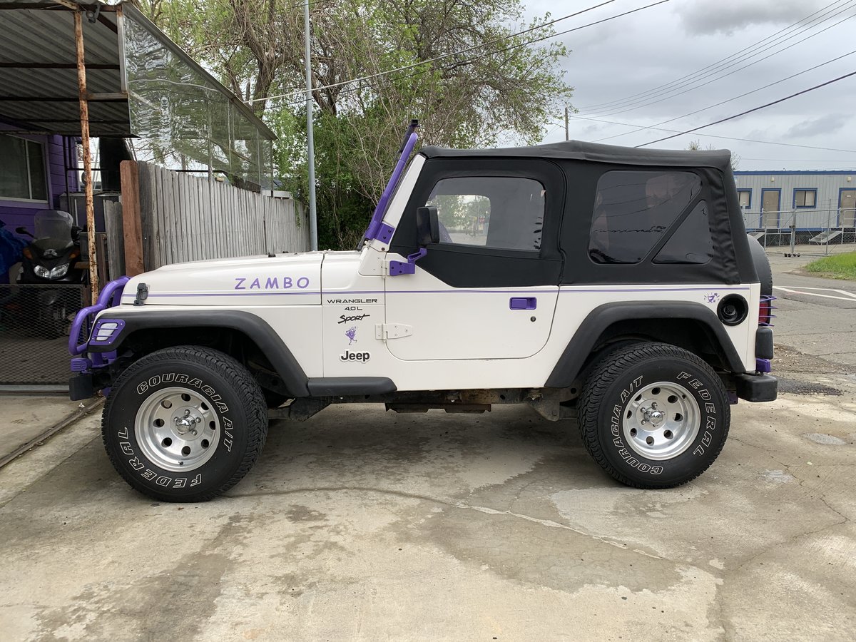

Got the lift put on today!! :D First thing we did was went to the car wash so hubby could clean the suspension a little.
We started in the back. Went pretty well but I will have to say, we are not very good at it. The rear is still a little out of adjustment. We didn't buy a bracket for the track bar and put it in the original track bar location. To do that, we had to put the adjustable part in first, then put the other end in. Here is where I ran into my first issue. I tried to tell hubby we needed to put it on the ground and then figure out how much adjustment we needed. Well, him being him, didn't want to do it that way. He measured it up in the air. We had do lower the exhaust to be able to turn the track bar to adjust it out a bit. Once we did get it back on the ground we measured and it is just under a quarter of an inch off. I'm calling it good enough for now and I may buy a bracket later down the road so it is easier to adjust.

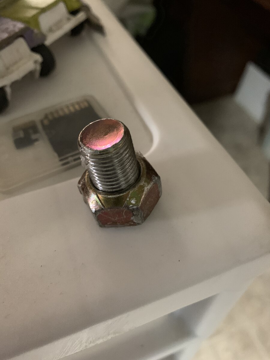

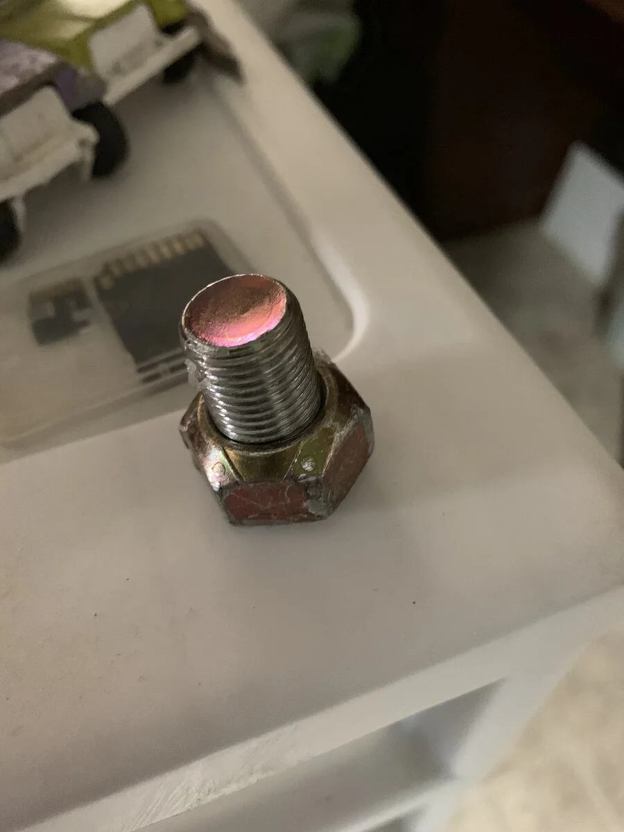

Then we moved to the front. Here is where my other issue came along. We were doing good and it was going pretty smoothly. Then I told hubby we had to drill out the hole bigger to attach the trac bar. So he started to do it and didn't have a sharp bit, so he got it just so the bolt would almost go in. He said would be able to get it to thread in and it would be fine. Well, it wasn't. It messed up the threads. It wouldn't tighten up all the way and he ended up having to cut the bolt in half to get it off.
Had to run to the hardware store to get another bolt. Got back and he got the hole drilled out all the way this time and things went well after that. :D We got the front dialed in really nice. Even on both sides. :D
Here it is all done. :D

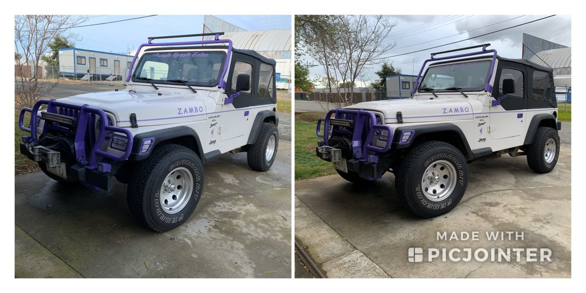

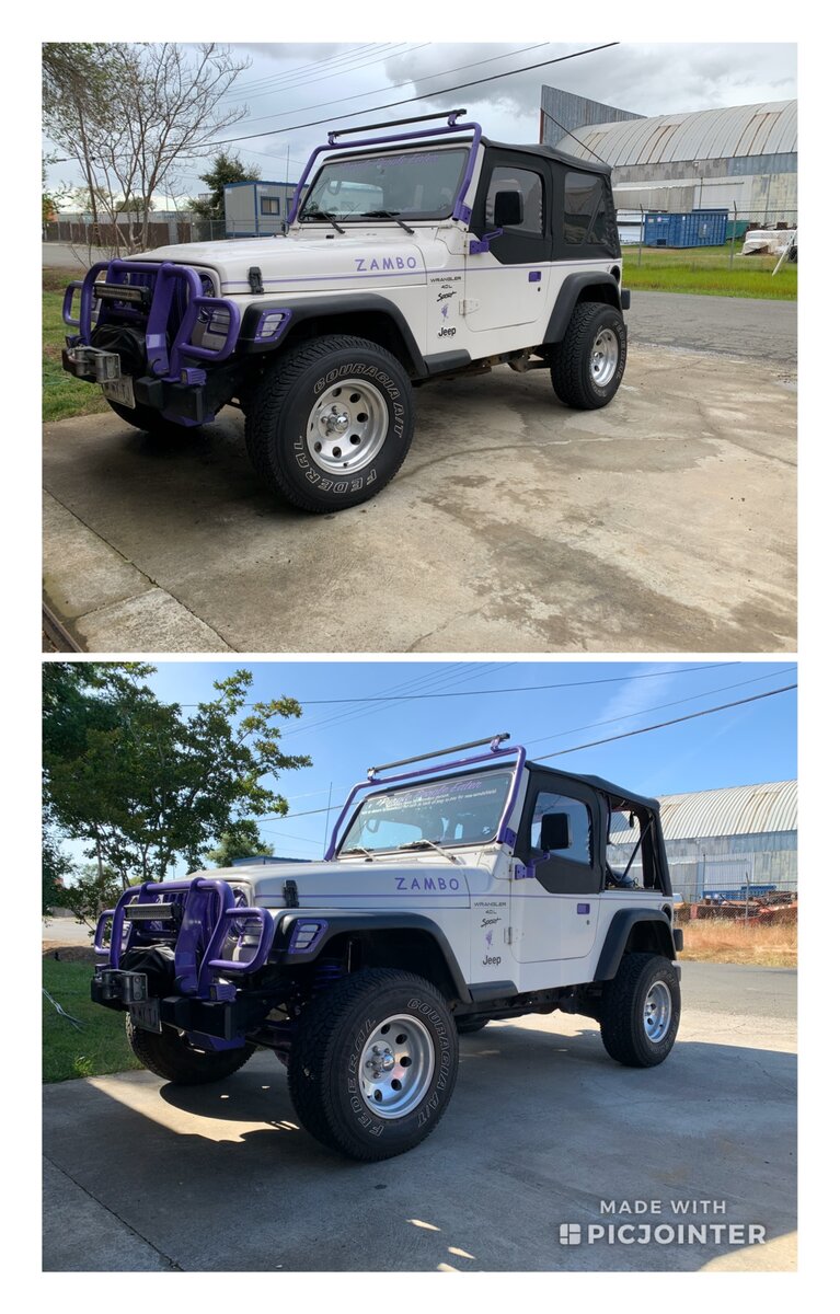

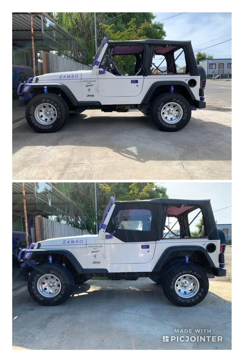

Some before and after pics.
With body lift and then with lift too.

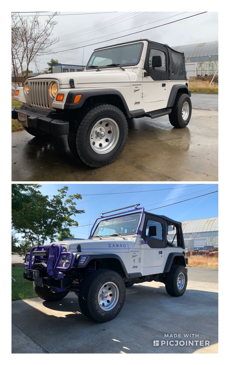

The day I got it and now!
So it went pretty well except for hubby not wanting do do as some of the instructions said to do. LOL I'm going to take it on Monday, I hope, to get the alignment. It seems to look ok, and goes down the road fine, but figure from what I read it is best to have it done after a lift. :D
View attachment 159972View attachment 159973View attachment 159974

Looks great!! Did you take measurements of the gain? It looks like a lot more than 2" in the rear.
Sorry, I thought I replied to you, but was just looking through my build thread again and noticed I didn't.
No, I didn't take measurements and yes, the back looks a lot taller then the front. Not sure why though. To me the Jeep looks to sit level. At least to my eye it does. LOL
Maybe it sits that way because there is weight in the front and virtually no weight in the back? They are the heavy duty springs.

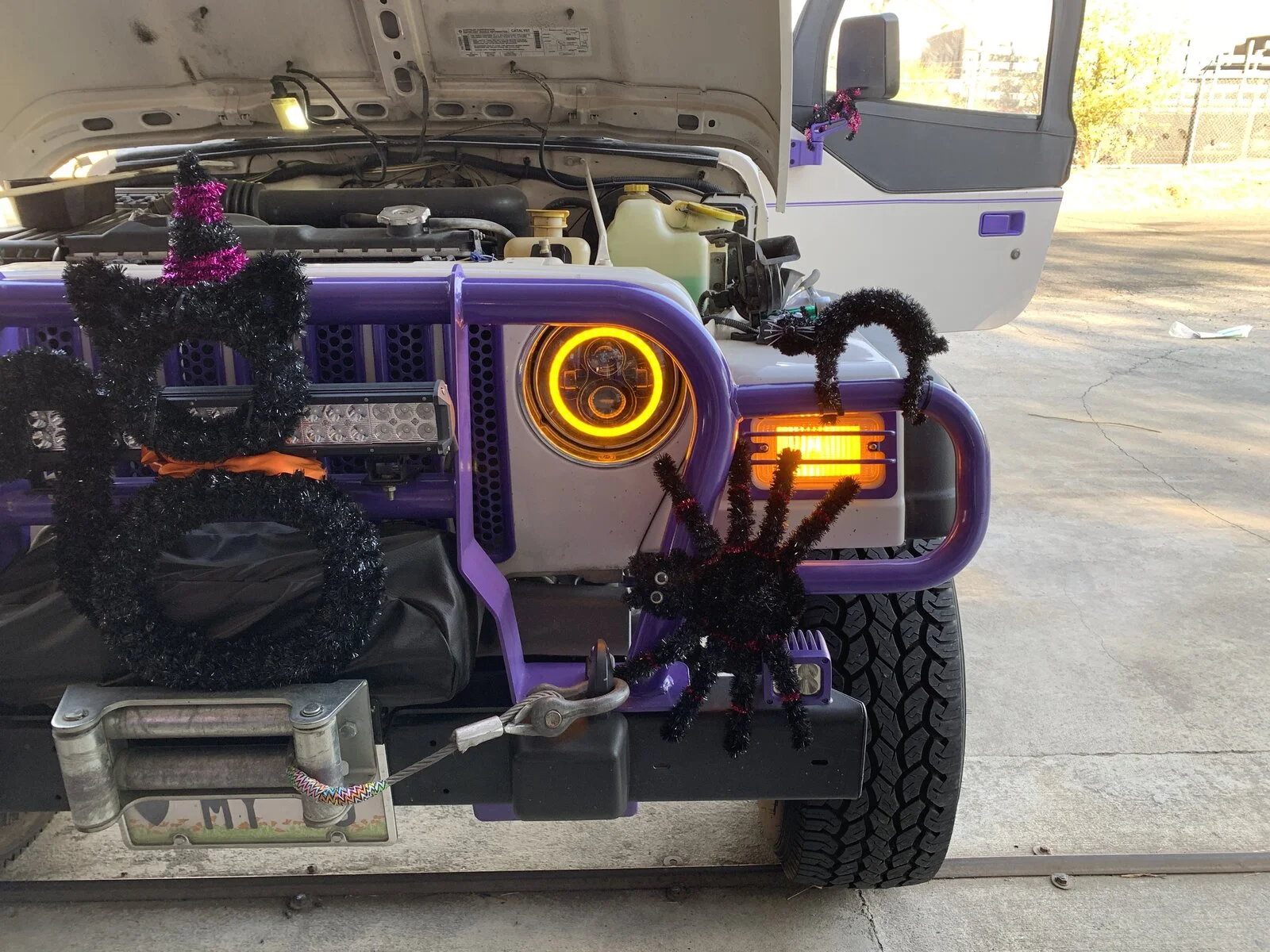

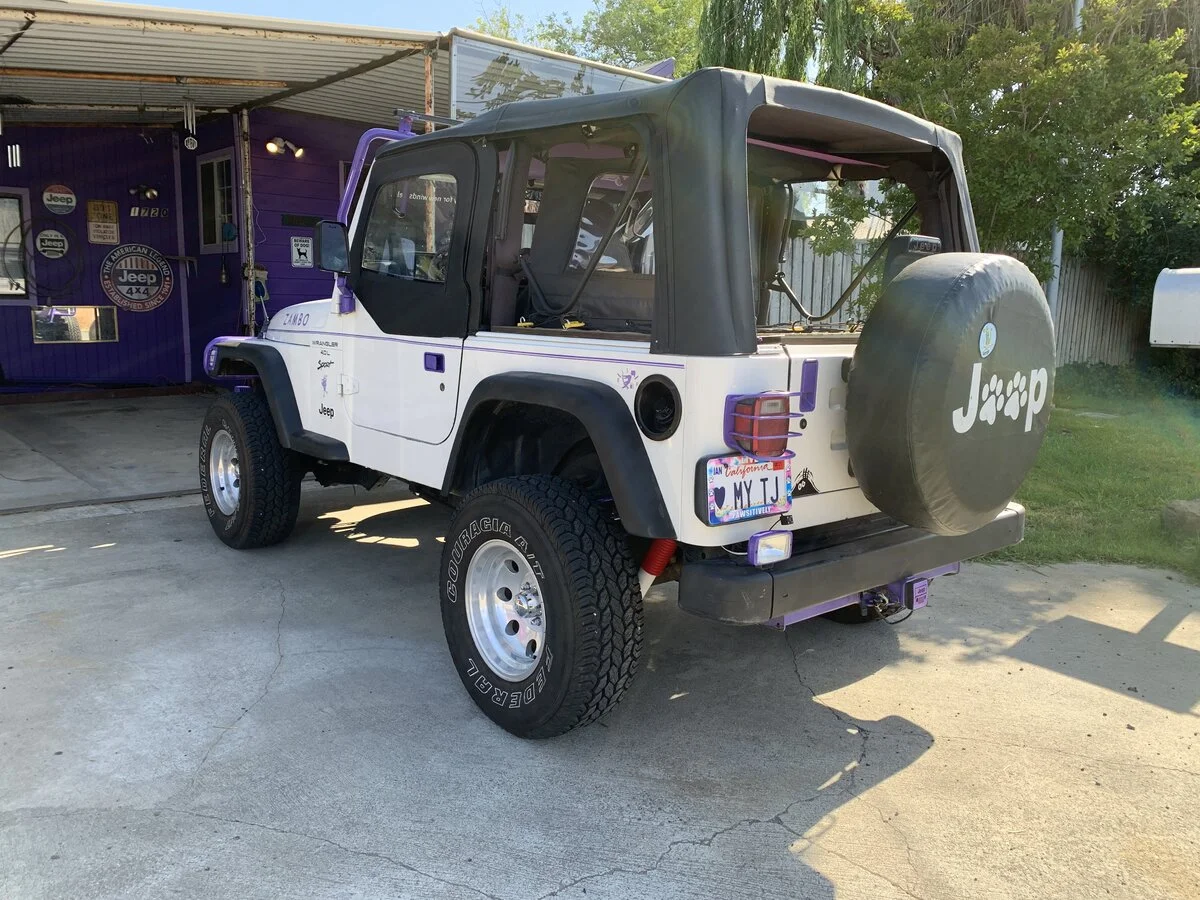

Finally going to add to this thread again. Haven't done any major things just a few small ones. Most of you probably already read about this stuff in the "what did you do to your TJ" thread, but figured I'd update this thread. :D
Put some cheap halo headlights in. They are ok, but to me the high beams suck. I would get different ones but I really like the turn signal function they have. LOL
I also found some hard uppers. I ran them last winter and I like them, but I need to paint them black. That was supposed to be done this last summer, didn't happen. LOL Not sure if I want to still attempt in now that it is getting cooler, or just run them tan again till next summer. :D

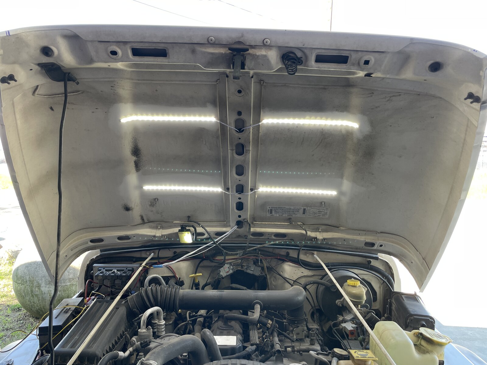

I installed some better underhood lighting. :D

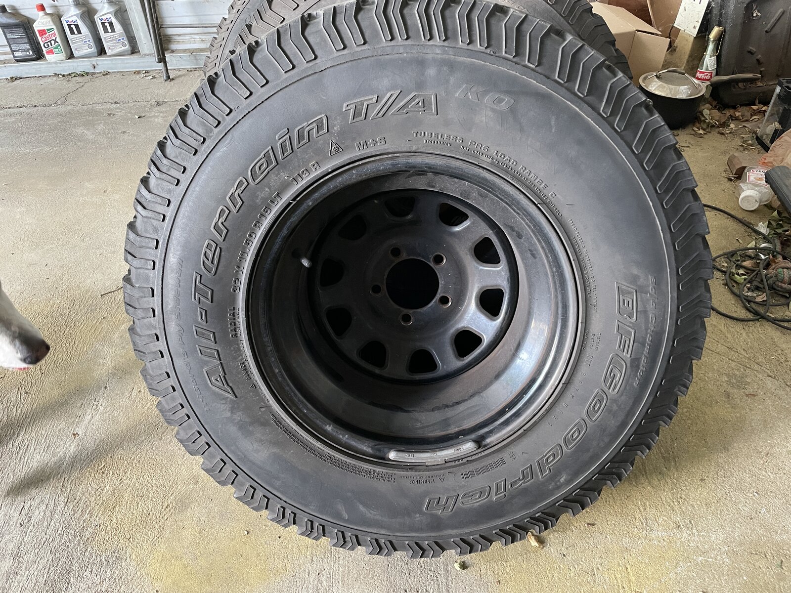

Hubby found a set of 32" tires, but I have yet to try them on the Jeep. I want to do that and if I do like them, I may have to have the rims powder coated. :D Never guess the color? :D

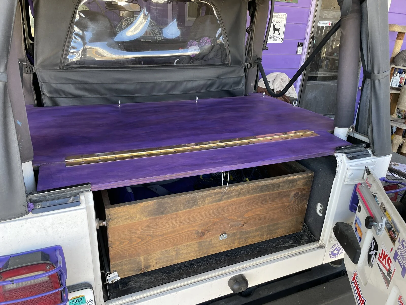

Then just recently I decided to redo my deck in the back. Found some product called Unicorn Spit. LOL Didn't come out as good as I was hoping but after I put some polyurathane on, it started to grow on me. :D

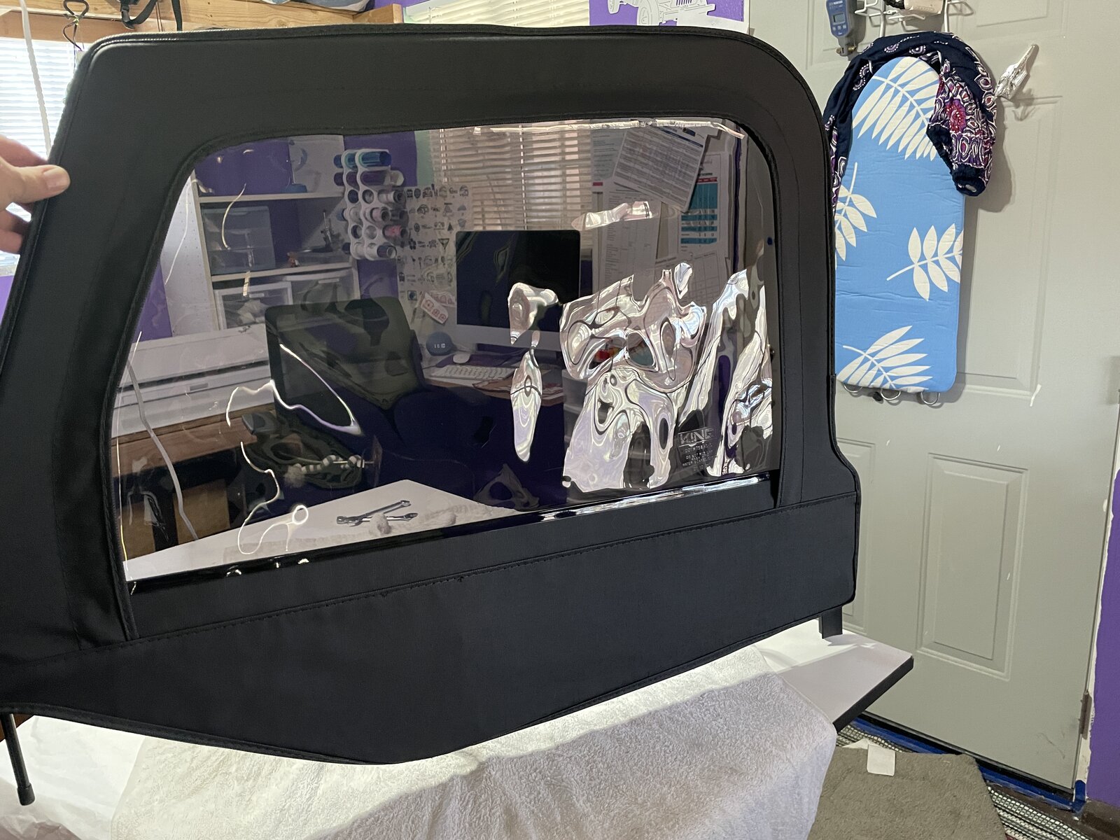

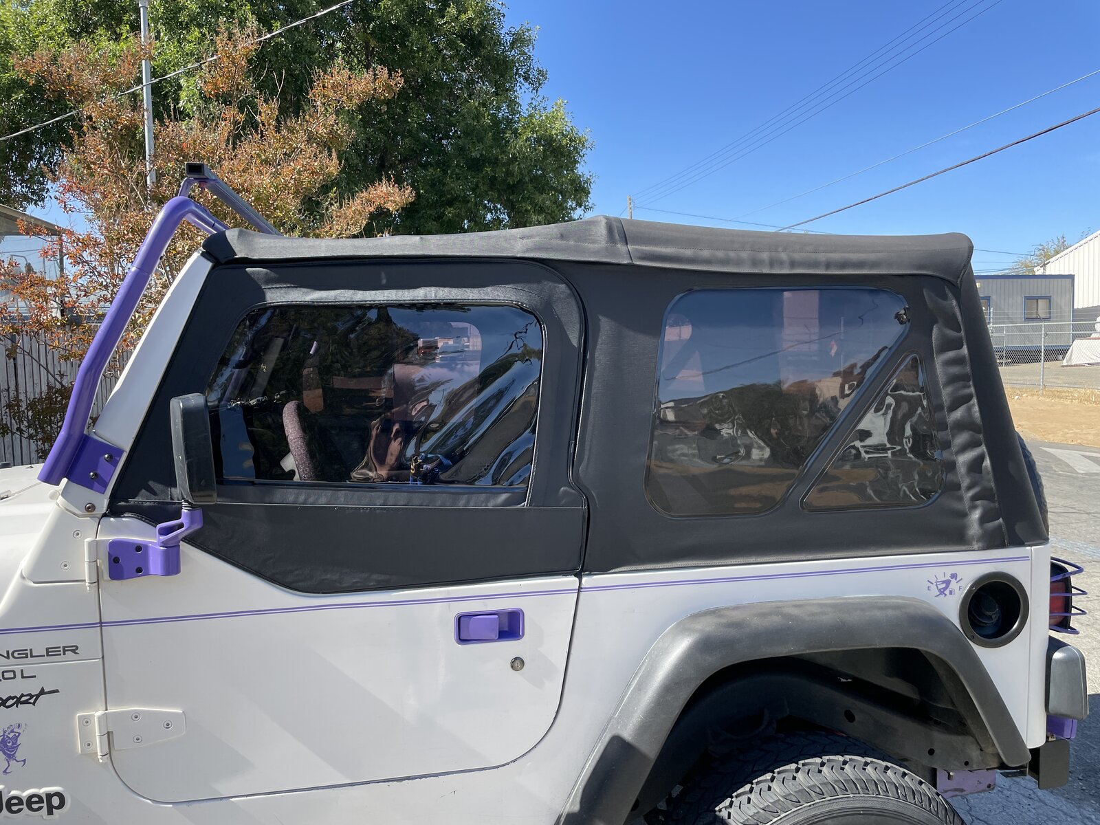

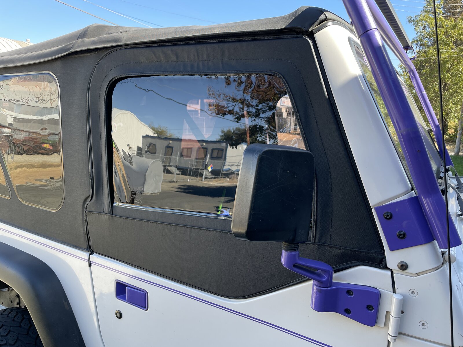

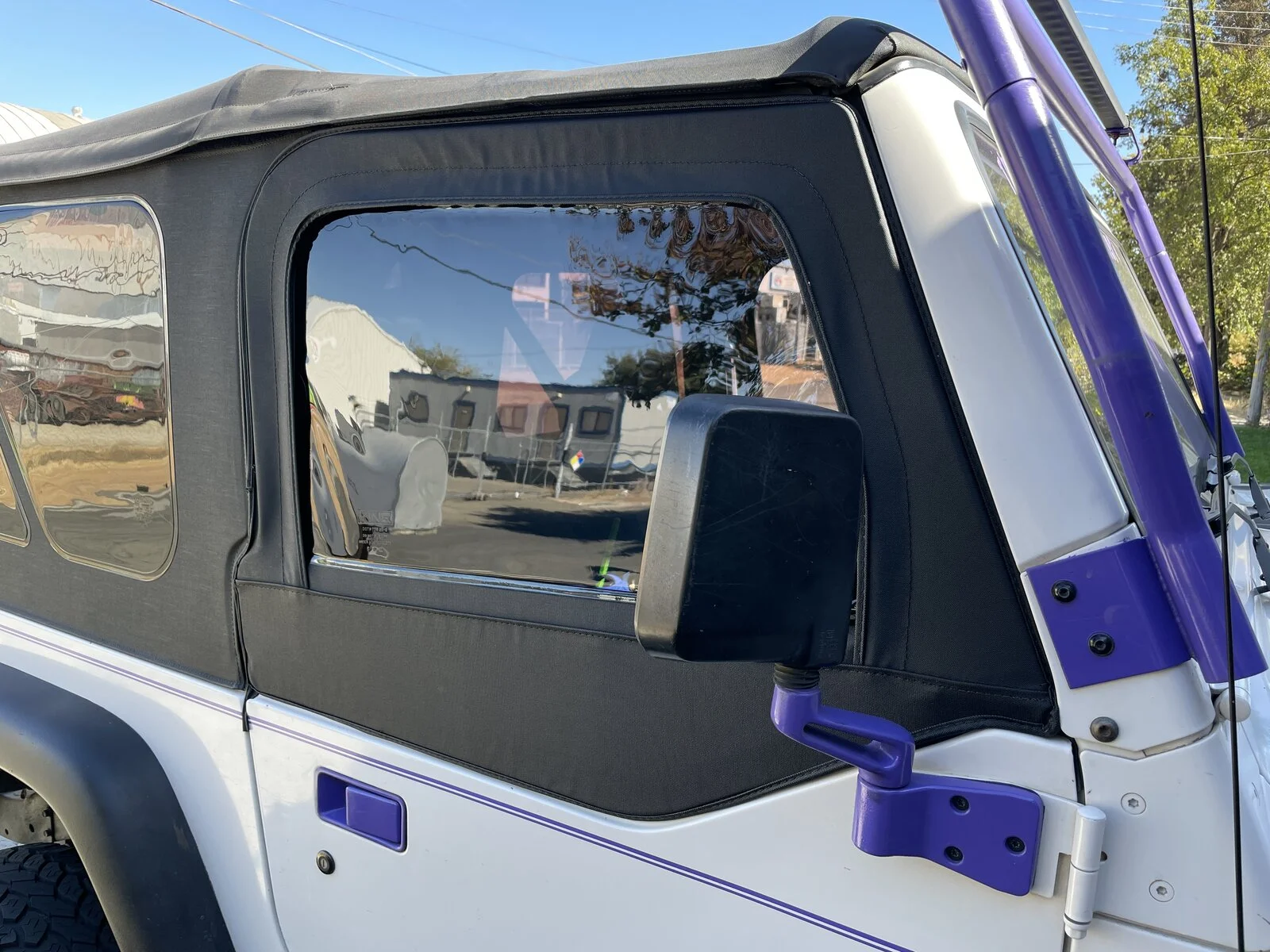

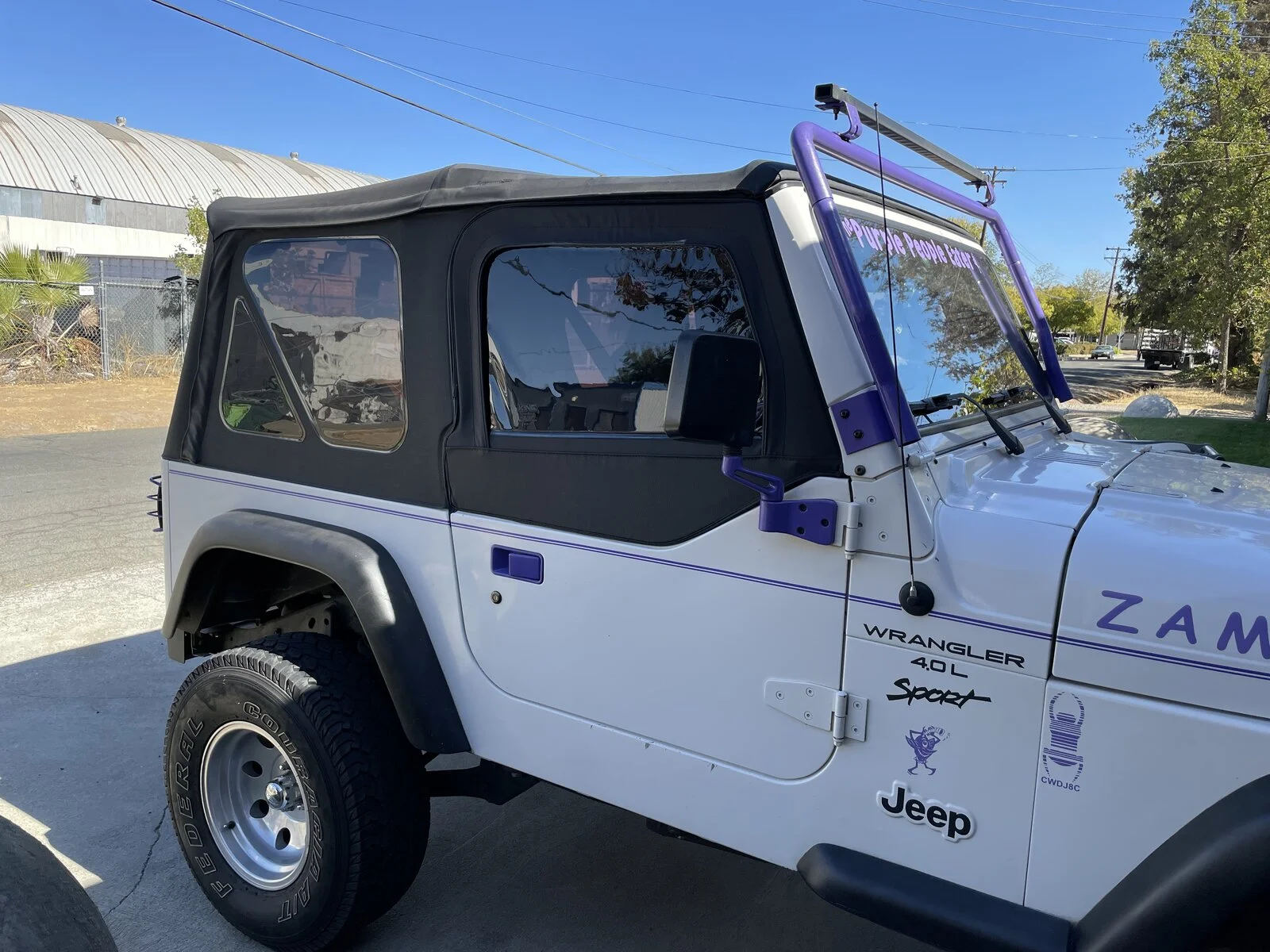

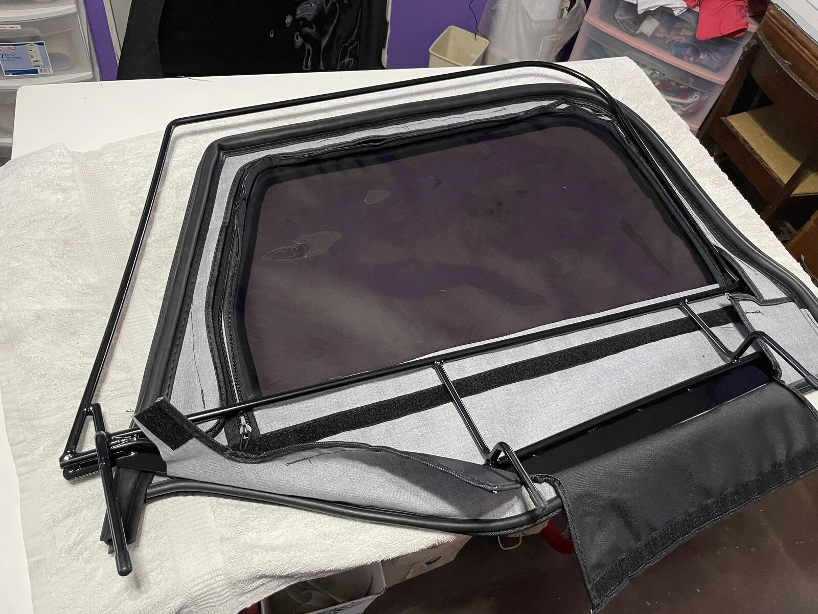

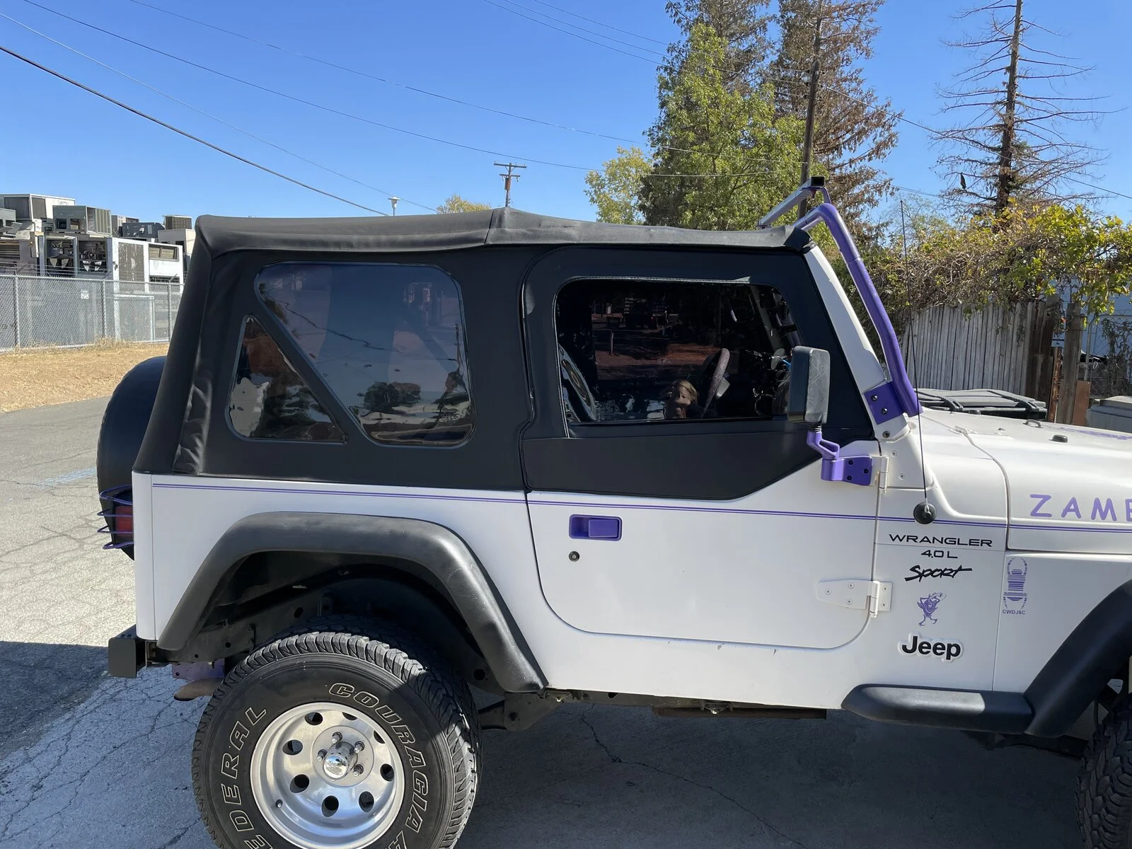

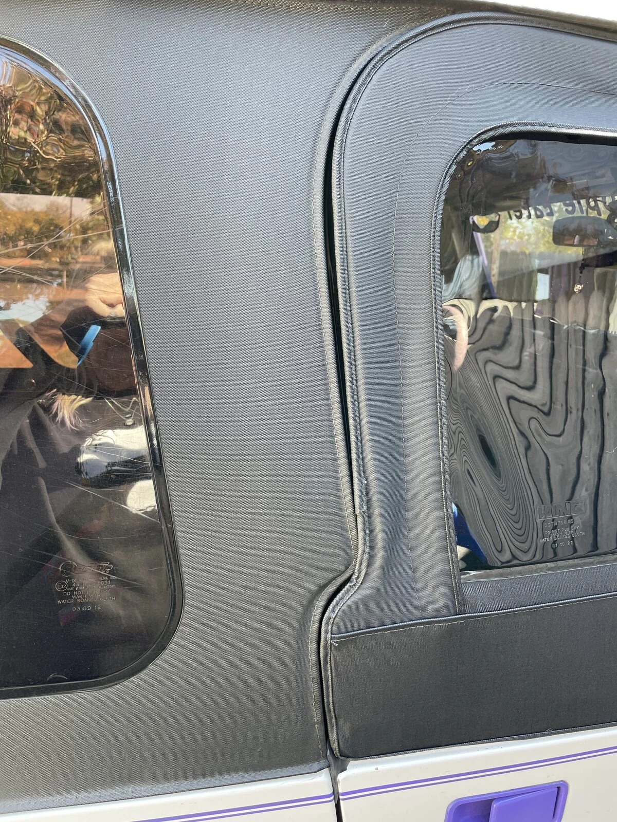

Thanks to this forum, I got a set of tinted soft uppers. I decided to buy new frames so I could have the option of switching to my old soft uppers if I felt like it. Those came the other day so I worked on putting the skins on the frames today.
I should have warmed them up before I started but I did the driver side cold. Took some working around but finally got it on with the help of a couple boxed end wrenches. LOL.
I decided to let the passenger side sit in the sun for a bit while I went and tried the driver side on the Jeep.

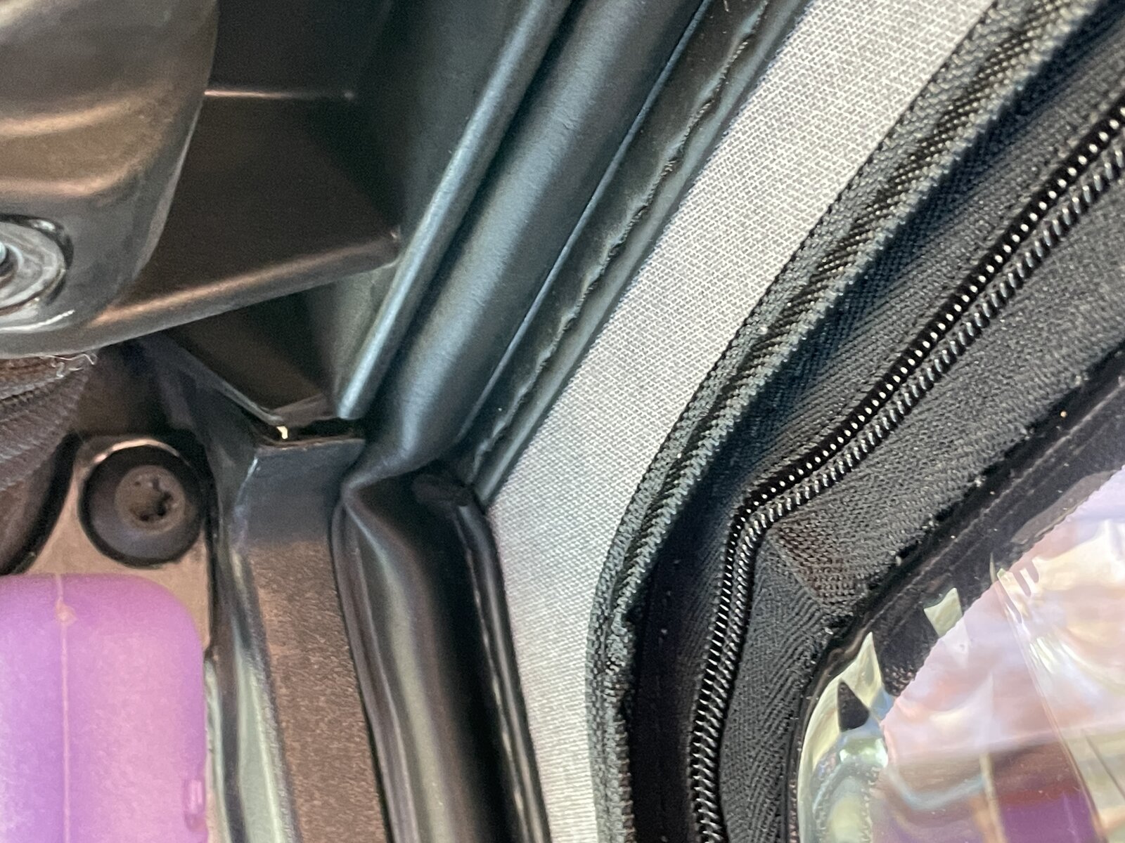

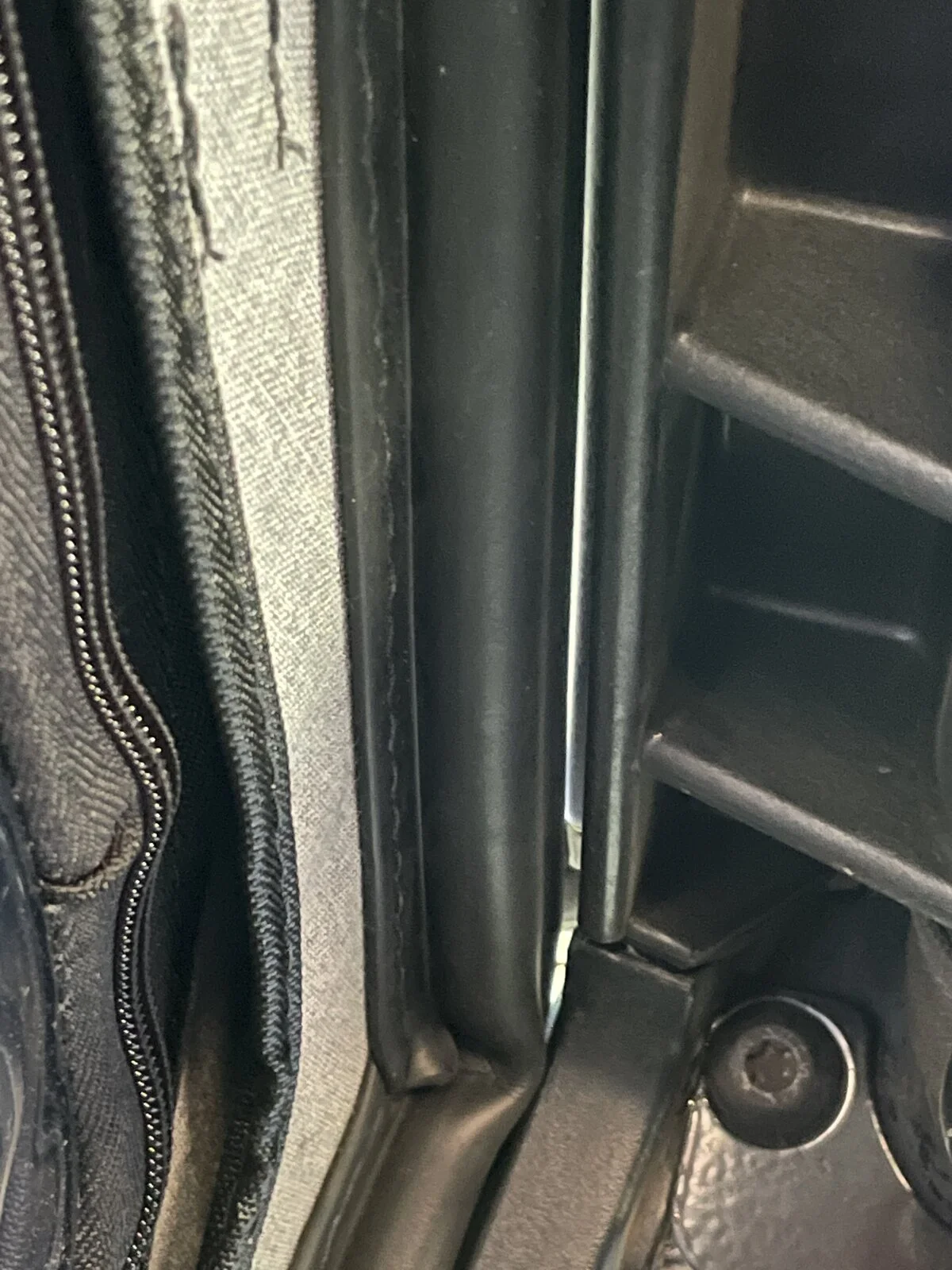

I wasn't to thrilled about a couple gaps here and there. This pic shows a hole at the bottom front corner. I'm thinking rain would easily get in there.
Also had some daylight coming through at the top.
I went back and looked at my old upper and found that I didn't get the bottom front corner completely in, so I set the upper in the sun and went to tackle the passenger side.
From this pic, it looks like there in no way they will fit the frames. LOL
Got that one done and installed. It had a lot smaller gap at the bottom corner. I felt comfortable with that. I also figured out how to do some adjustments to make it shut really well. No gaps!
I went back and managed to get the driver side bottom front corner on correctly and tried again. This time the hole was really small.
They shut a lot better than my old set. I may have to adjust them a bit now that I know how to do it. LOL Only thing is they do have a gap seen in the pic below, but the weather strip does touch everywhere it needs too. I'm happy with the results.

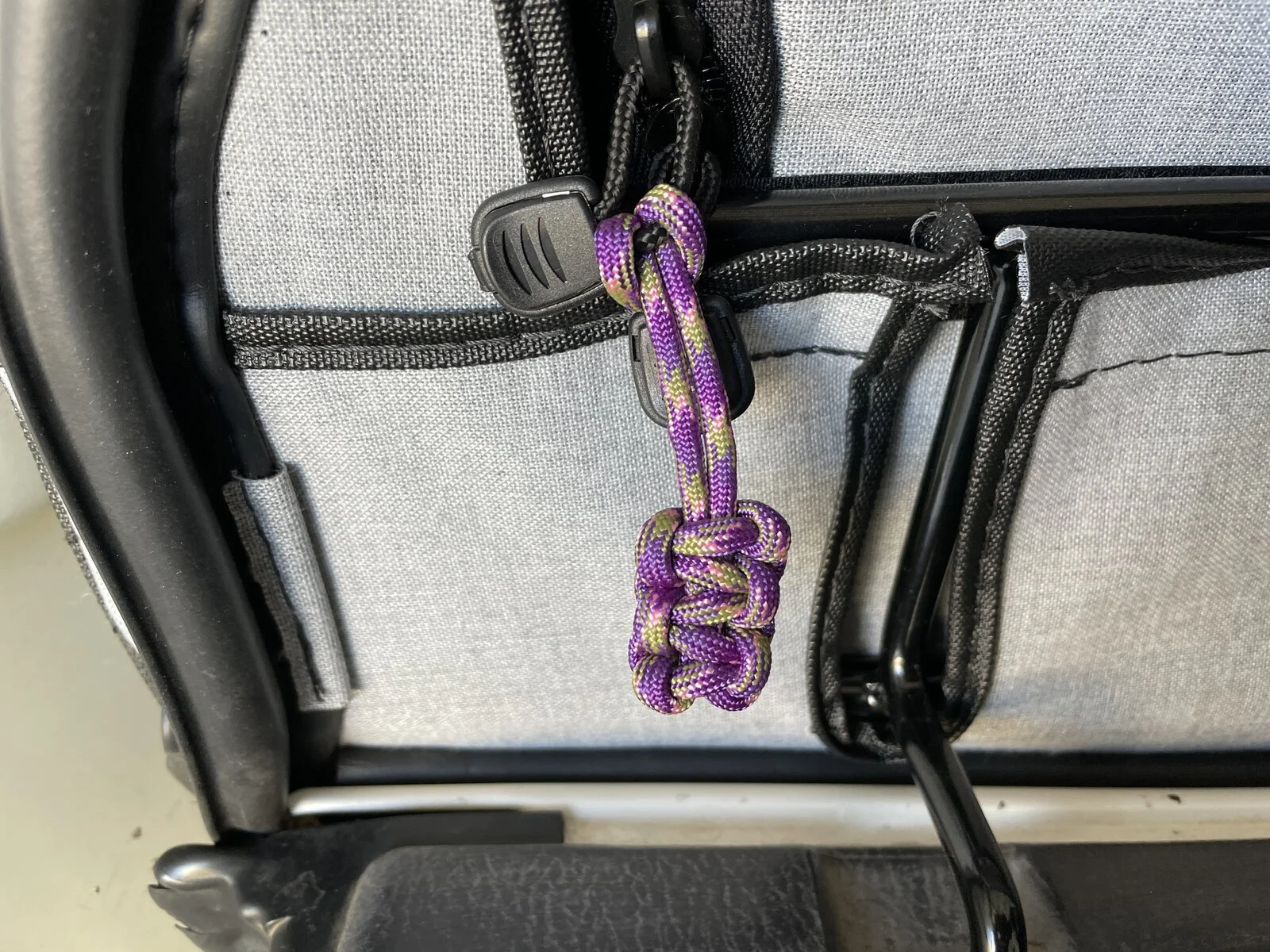

Because I kept my old uppers so I can use them if I wanted too, I had to make new zipper pulls. :D
