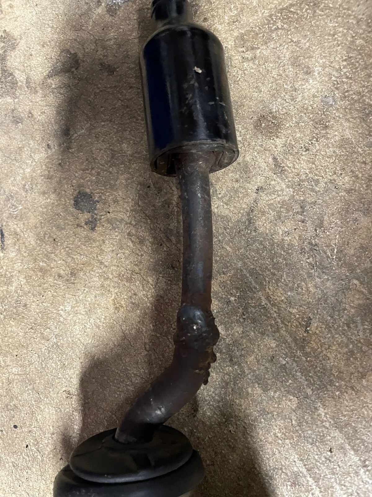

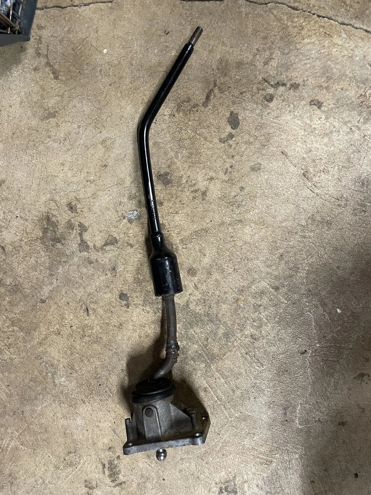

I would first try and determine if they heated and bent your shifter..do you have a friend with a similar tj you can reference? Or look at pics on ebay?
Reactions: jrmcafee
I could probably manage to do that. I don't know that it matters though at this point, right? Something will have to change, whether it's due to the 4" lift or somehow the upper or lower shaft has been damaged.
It doesn't matter it's just how my brain works..I need verification that it has been altered before I can think about a solution. ..there really isn't anything else I can think of that would cause your issue.
If your 3 inch body lift was dealer installed, they have been known to heat and bend or even cut and weld an extension to the shifter. Do you see any evidence your stock shifter has been modified?
When I installed my Tuffy console the shifter didn't have enough room to shift. Took about 5 minutes with a handheld propane torch and a pair of gloves to bend it enough to clear.
I don’t yet. To @P man’s point, that may be where getting a side by side comparison comes in. It was definitely not dealer installed though.
I had to run the Jeep through the shop for something unrelated and they bent the lower portion of the selector so that I now have about an inch of clearance. Probably not right yet but closer and more functional.
