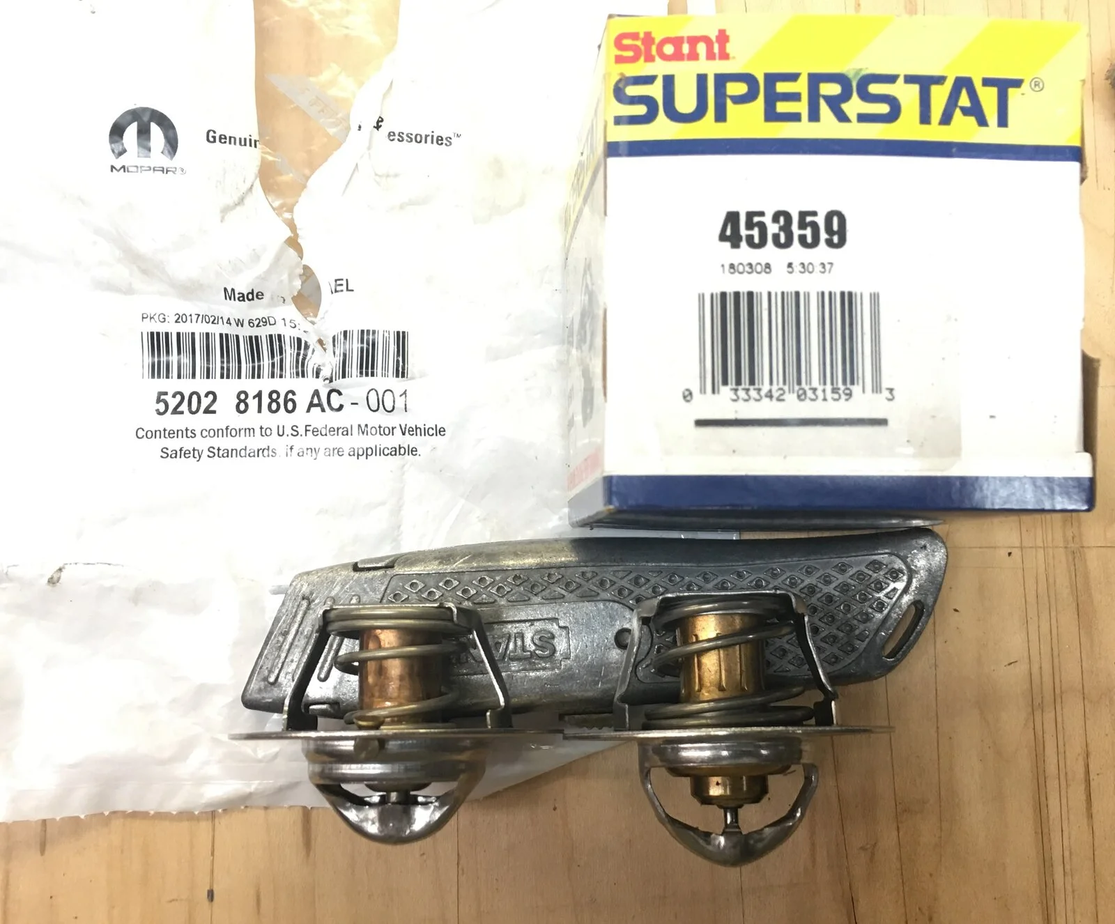

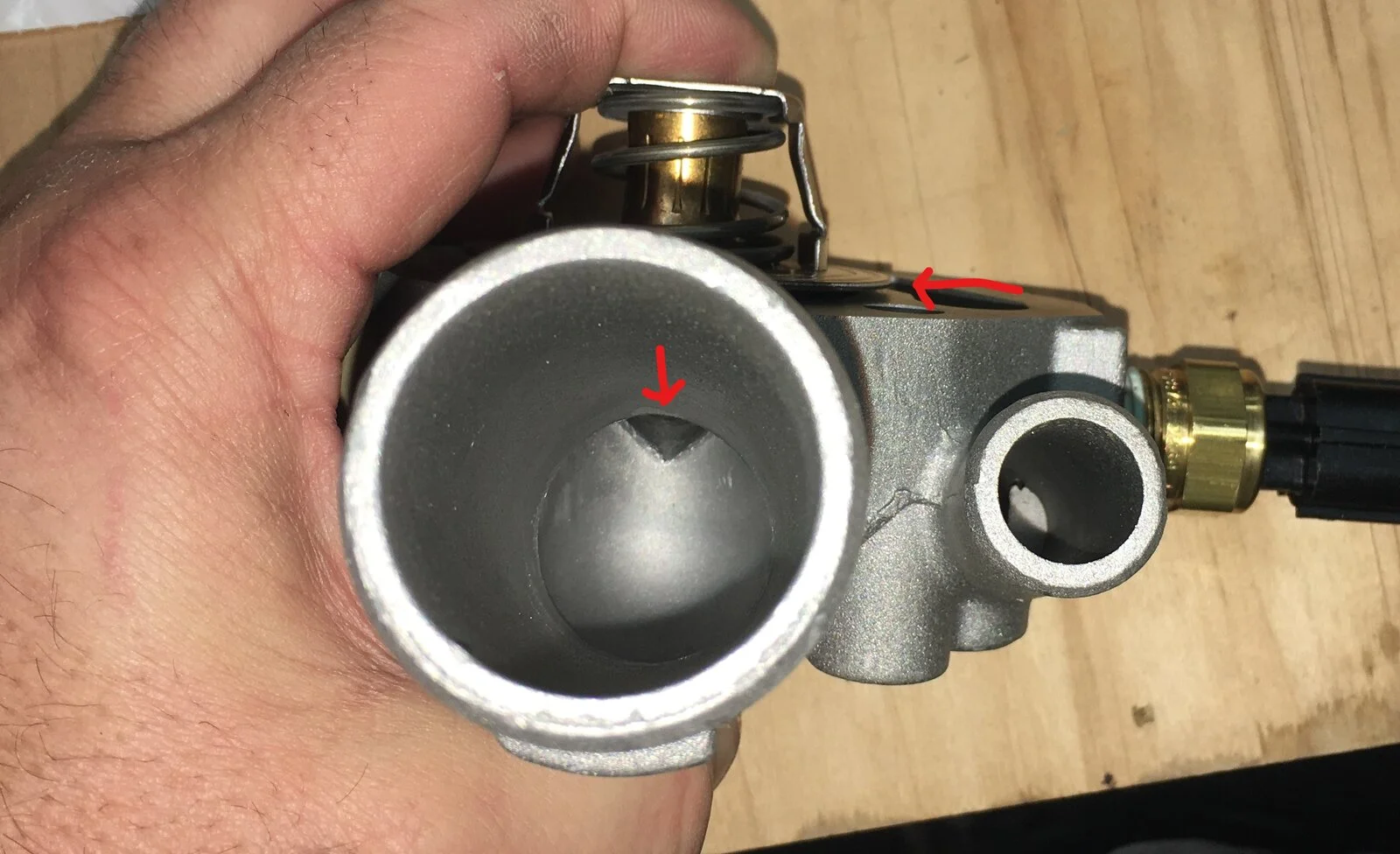

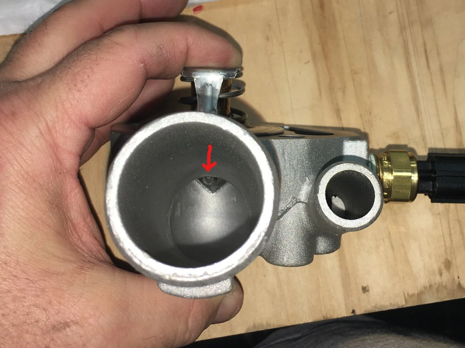

What thermostat are you using? I was going to use a Stant last time I changed mine. I was also going to drill a small hole at the 12 o'clock position to help air escape the block. I didn't pay attention to the t-stats at the time, but when I was test fitting I noticed the Stant had a taller bridge that the MOPAR and hit the housing when I tried to position the t-stat with the newly drilled hole at 12 o'clock. If I had noticed this before hand, I would have drilled in a different area. I ended up using a MOPAR t-stat.
Bridge hitting the housing, flange not resting on the housing
T-stat rotated, bridge not hitting the housing, flange resting on the housing.
