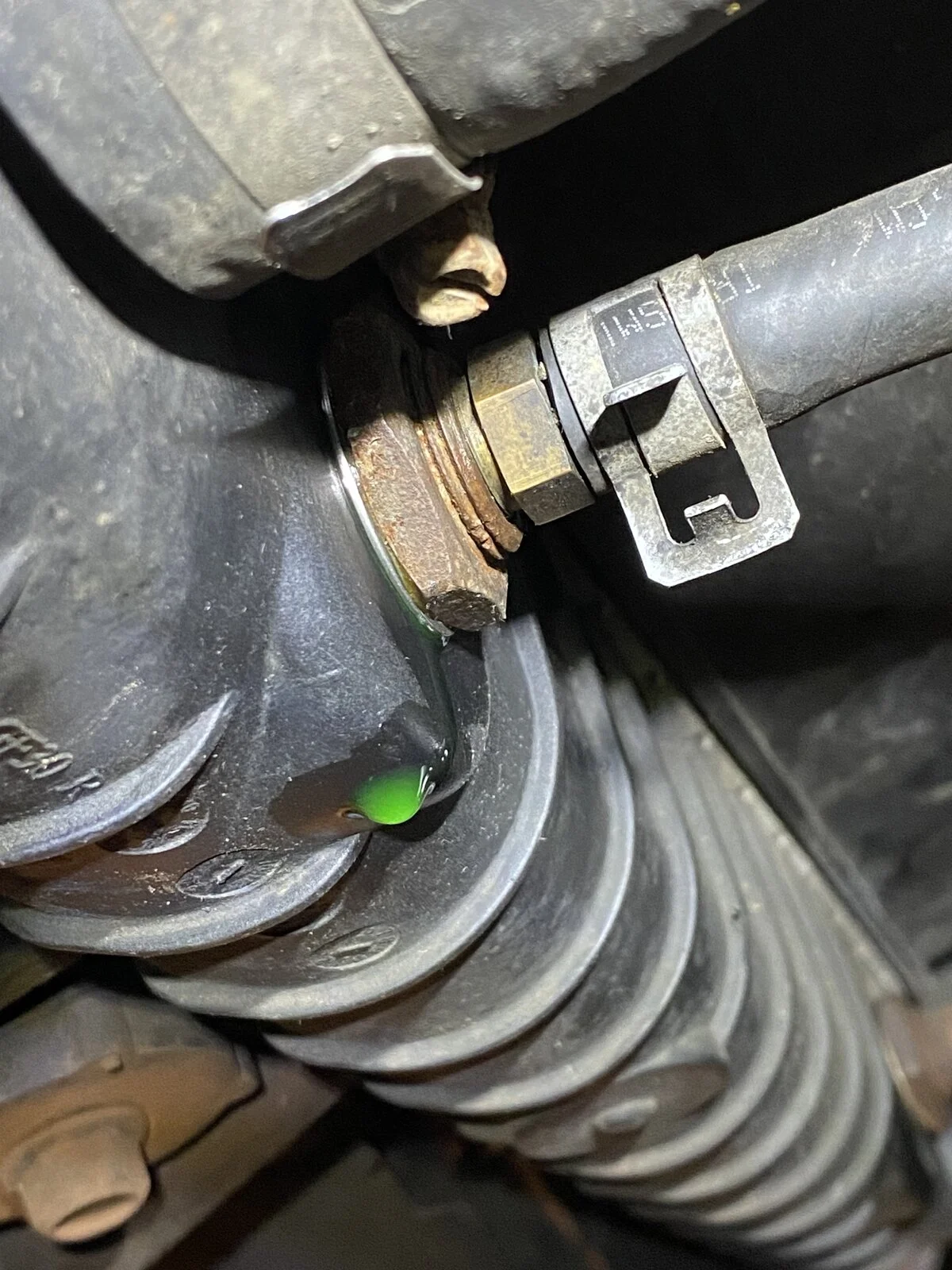

I recently found a puddle of coolant under my TJ. I traced the leak to one of the transmission cooler line fittings. But looking at it, the coolant seems to be coming from between the plastic housing and the flange part of the metal fitting, not the actual thread of the hose barb. I’ve been trying to think of a way to fix this, but I’m at a loss. Anyone have any suggestions? Or am I going to be replacing the whole radiator?
I have a manual transmission so I don’t know a lot. But doesn’t the metal flange part you are referring to screw into the radiator? If so might be able to remove it and clean it up use some thread tape and reassemble. Or maybe it just needs to be tightened some?
It would be leaking ATF from the hose barb threads.
You might be able to remove the fitting from the radiator tank and reseal it, but I'm not sure as mine are MT. I'm sure somebody knows if that's threaded into the tank, or glued in or..
The fitting for the hose barb is what holds and seals the trans cooler to the inside of the radiator.
You might be able to tighten the fitting nut (not the barb) to stop the leak.
Thanks for the good ideas. From looking at new radiators on line, I’m thinking the silver part and large bronze colored nut part are molded into the body. And the hose barbs thread into that. But maybe I’m wrong and the bronze part threads into the silver part. But regardless, I guess I’ve got nothing to lose by removing the lines and the hose barbs and seeing how it all goes together. Maybe there is an o-ring in there or something I can tighten.

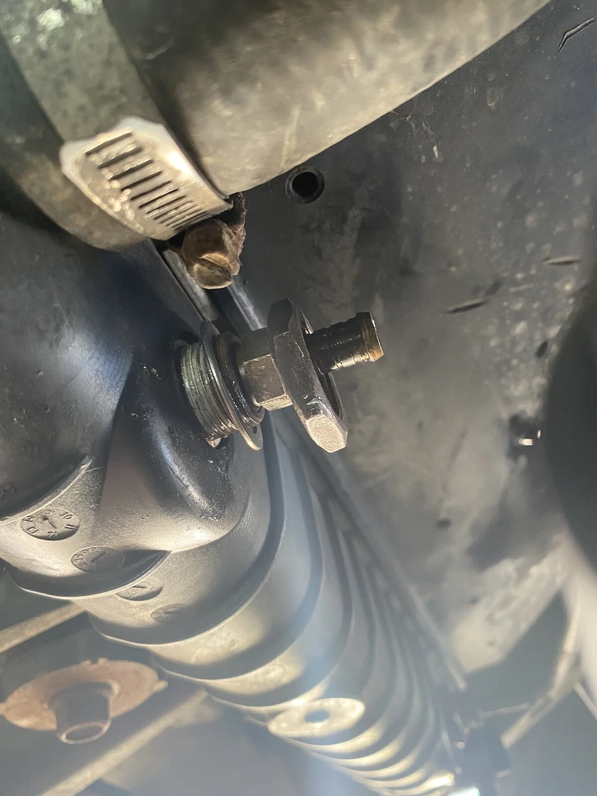

So I finally got around to trying to fix this leak. I removed the transmission line and unscrewed the nut. It appears the large jam nut just tightens up and pushes the washer tight against the housing To seal it off. Great I thought, I just have to tighten it up a bit. Well I’ve been tightening it little by little, but it’s still dripping. Then I tightened some more and it started leaking more. So I backed it off slightly and it’s better but still drip drip drip. From what I can see, it looks like the coolant is coming through between the nut and the washer. Should I try some Teflon tape on the threads to possibly seal it up? Any other ideas? This seemed like an easy fix (for a change), but I guess not.
I'd try Teflon tape or better Teflon paste.
Your hail Mary would be JB weld or steel stik.
Maybe there's supposed to be an o ring under there.
-Mac
Reactions: Tob

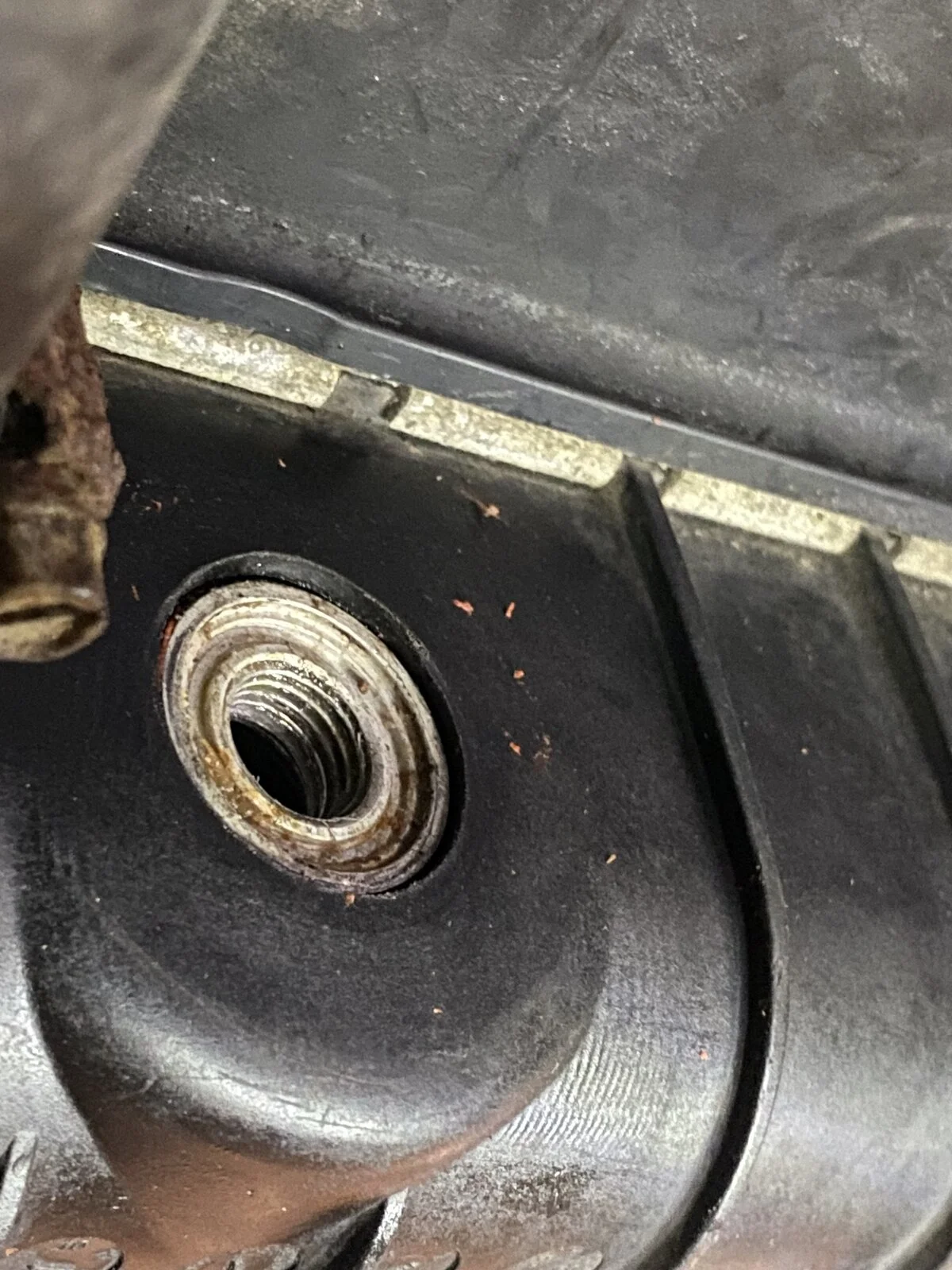

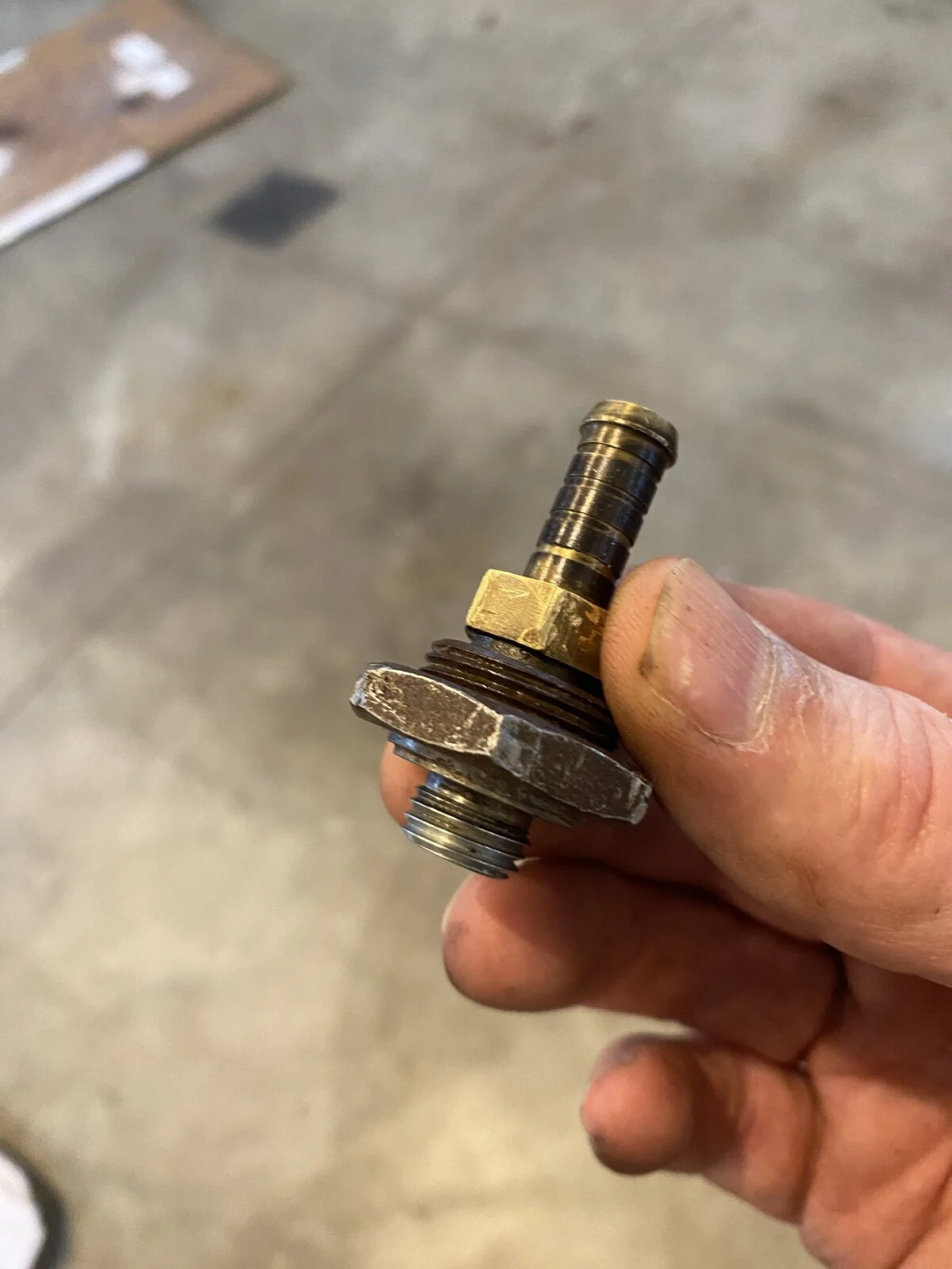

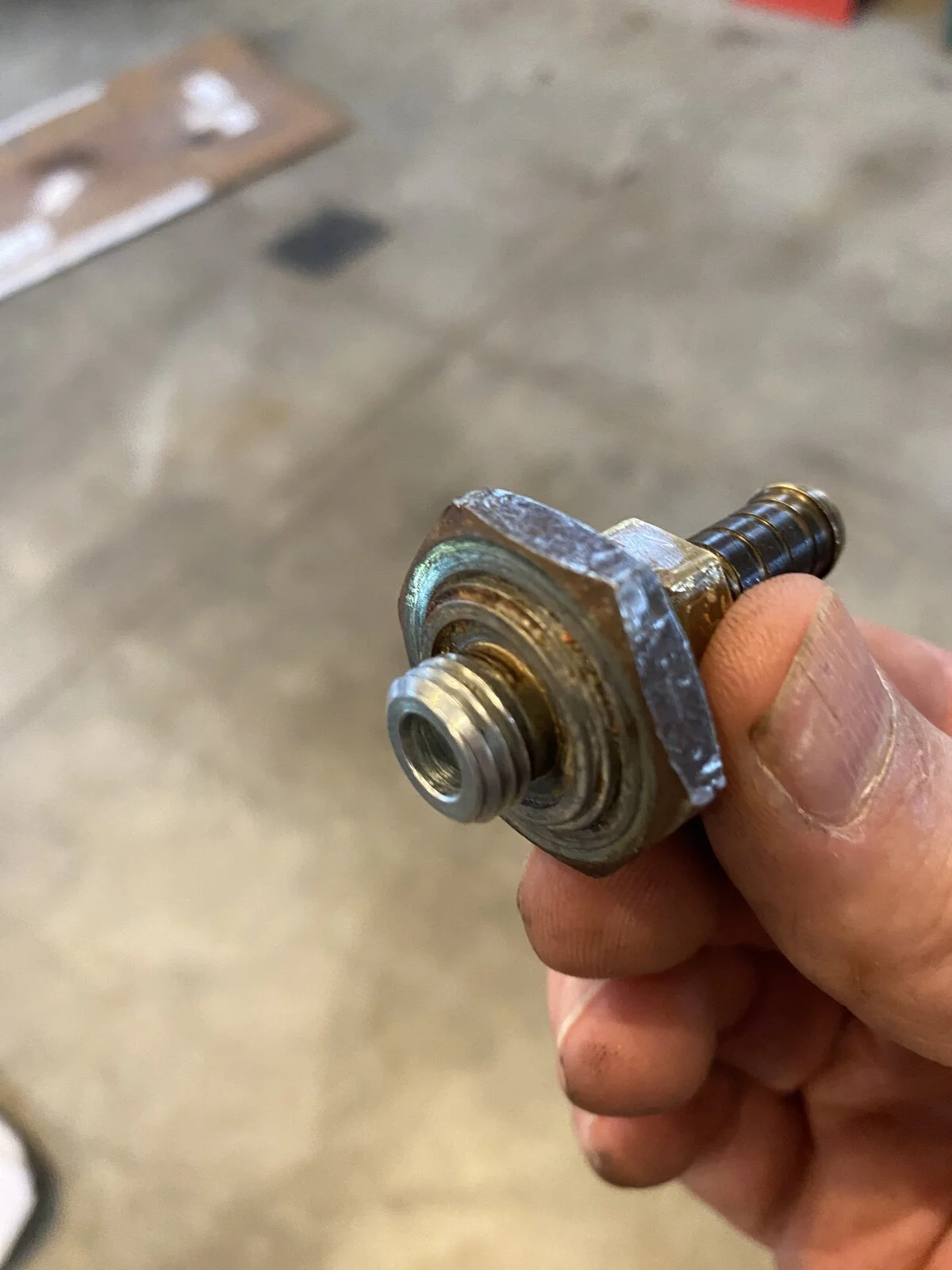

So when I tried to remove the larger jam nut, the entire threaded fitting unscrewed from the transmission cooler. Does anyone know if there is suppose to be an o-ring inside there? (on the inner thread to seal the transmission fluid, not my other coolant leak).
note, the weird blue color is a reflection or something, it doesn’t really look that color.
I would definitely clean the threads on both side with a plastic tooth brush until they are free of gunk and particles. A squirt bottle with water and the plastic tooth brush should do it. If it isn't seating right, because of all the gunk, that may cause leaks. All that pink stuff around the hole, looks like something may have broken up, like an O-ring. Can you contact the manufacturer of the radiator and ask them if there is supposed to be an O-ring in there, or if they recommend Teflon pipe tape on the threads to seal it, because it was leaking there? Ask them if they have email so that you can send them pictures.
The manual transmission Mopar radiator and the automatic one are the same radiator. When the radiators are made, the lower plastic tank is drilled to fit the automatic transmission cooler into it. I don't know much about how the cooler is installed but it must have something to keep the coolant from leaking out. Most probable is an oring. In the pic where you are holding the fitting and can see the part that threads into the radiator, there is a round area of clean metal that looks like it might be where an oring is supposed to go. I think I'd try an oring. Get one of the right size in both diameter and thickness. I'd put a little dielectric grease on it before installing it.

It's tough to tell in the pictures, but that looks like a soft metal crush washer. If it is, it may be deformed. Sometimes turning them around, or some gentle flattening with a hammer on a flat surface can bring them back, but I would take it into your FLAPS and get a new one. I would also clean both the radiator side and the plug side so there's no debris.
If that doesn't work, like others have said you could wrap the threads with teflon tape.
I was thinking the same thing. But if there's supposed to be an o-ring there, where did it go? Not installed during manufacturing?
