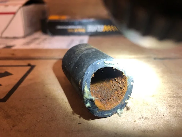

I think a lot of it might have to do with how well the cooling system was maintained. Before I got my Mustang it was a rental car and there was just rusty water in the radiator. They also didn't believe in changing the oil. They believed it was a better lubricant when dirty but no particles. Getting my Mustang cleaned of that condition became an issue, so I added the Gano filter. I suspect that if they cooling system isn't well maintained and rust is allowed to build up, then it can become an issue getting all the rust cleaned out and protecting the system with rust inhibitors like coolant.
I suspect that if you open the radiator cap and see a dark orange color then it can be an issue. And just flushing it may not solve the problem because the rust settles because of its density. It might take driving it and getting the rust to flow in the coolant, which the Gano filter can then trap. Just a theory based on my personal experience.
Well, as a young and dumb kid I read that plain water dissipated heat better than antifreeze/water mix, so I ran straight water in my Cutlass. After some time the engine overheated because the impeller rusted off the water pump. The pump was replaced, ethylene glycol mix was installed, and there was never any rust clogging the radiator. So I have no idea how you got so much rust in your cooling system compared to the woefully neglected (or maybe abused ?) cooling system on my Cutlass..

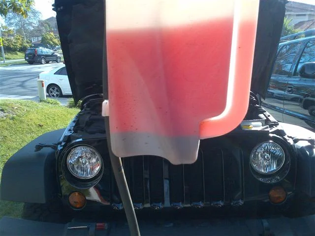

There are pictures all over Google with that sort of condition. Here is one such picture in a 1998 TJ. This guy put a small inline filter on the outlet of his heater hose, when he got his jeep from a PO that had neglected his cooling system. It was too small, so he created his own filter. The Gano is much larger and can be easily removed. You just need to drain enough coolant to clear the top hose to empty and rinse it. Then, you tighten the Gano back in place, and put the coolant you trapped back in. It takes about ten minutes. We aren't allowed to place links to other forums. Just Google "inline coolant filter" for pictures. I'm surprised you've never heard of them. I'm done. I don't want to argue. Note: If you have casting sand, obviously that condition would have to be rectified first, before trying an inline filter. The Gano filter looks cool with the glowing green coolant showing through it, and doesn't leak if you put it in right.
Here is an article on the dangers of mixing the Green and orange coolants. Read the comments for proof. I think Chrysler took it a step further and added Red coolant to the mix in the JK. It seems to produce "casting sand" when mixed with other coolants. There are 80 pages of that horror in the JK forum. Now, imagine if some uninformed PO mixed green, orange, yellow and red coolants, thinking it didn't matter. There is a recent article on this forum of casting sand in a TJ. I had a mechanic do the same thing in my TJ, and I saw casting sand in my Wrangler overflow bottle. He thought it didn't matter too. I was furious, because I had asked him not to do that. He flushed it, and I brought the green coolant before my cooling system was ruined. Your choice, I'm only trying to help.
I think your info is good but a technical issue. You aren't seeing casting sand. Yes sand was used to cast the cast iron blocks our Jeeps have but that sand is removed in the manufacturing process. There shouldn't be any left inside the engine unless there was an issue with the manufacturer and that probably would have shown up soon after the engine is placed in service.
What I believe we are seeing is higher silicate coolants mixed with incompatible coolants and the reaction causes the silicate to precipitate out of the solution causing the appearance of sand. Clearly mixing coolants is not good. I wonder how many pictures of "mud" in the cooling system is incompatible coolants being mixed. My Jeep has had multiple previous owners but apparently the proper coolant was used (or at least not mixed) because my cooling system is nice and clean even before I flushed it. I guess I got lucky given the horror stories I've seen on here.
