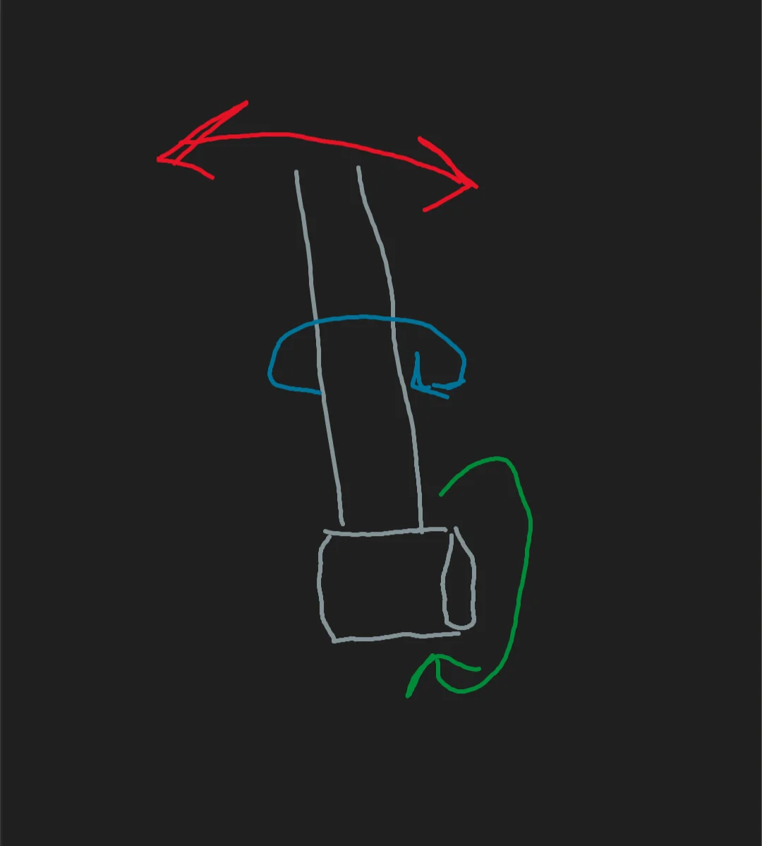

But.....Poly bushings suck. They squeak/groan/creak and don't flex worth a crap. They also tend to transmit a lot of vibration.
I thought that was the general consensus.
Johnny joints are poly so the squeaks and creaks and groans as well as the nvh concern would be the same.
Not flexing is a problem though, because there needs to be misalignment in all 3 planes and even having a JJ in the other end only gets you a second out of those. You get green either way, JJ in the other end gets you blue, but you're asking the poly to compress (and the mount to flex) to absorb the red, which is what you get when you flex out an axle with a track bar.
