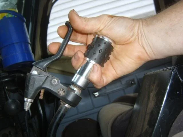

It is a 3/8-16 stud or bolt with the head cut off. My column is threaded there so the stud moves in and out to adjust and the nut locks it in place. The cable stop is a model airplane wheel collar, what I had in the garage. I think they sell cable stops for all types of things. E-brake repair kits have them. Like @jjvw says, bike parts are an easy way to go. If you have a co-op type bike repair shop around you can do the whole thing for pennies.

I’ve been meaning to do this to my TJ. I had a clicking shimano shifter off a mountain bike. I loved it in my cj when using the winch and it acted like a poor mans fuel injection in rocks. The click feature allowed me to set it and forget it. I’m wondering if there’s more chance of binding if taking directly to the pedal in a TJ.

In the trucking world with mechanical throttle pedals, a throttle cable has a knob with a center release. You pull it out to increase RPM and fine tune by rotating the knob. When your done with it, depressing the center allows you to push in the shaft/cable.
Here's a common example;
https://camions.macpek.com/products/58-5-5-throttle-cable?setcontextlanguagecode=en-us
The dash number, "-5" of part number 58-5 is how many feet long the cable is. Comes in 5', 10', 15', etc. These offer the best control and can usually be had from industrial suppliers to the trucking industry. I've sold lots over the years.
To trim, pull the center cable out, cut the outer casing, re-insert the inner cable and trim that. I'm sure they could be made to work on a Jeep throttle cam.
