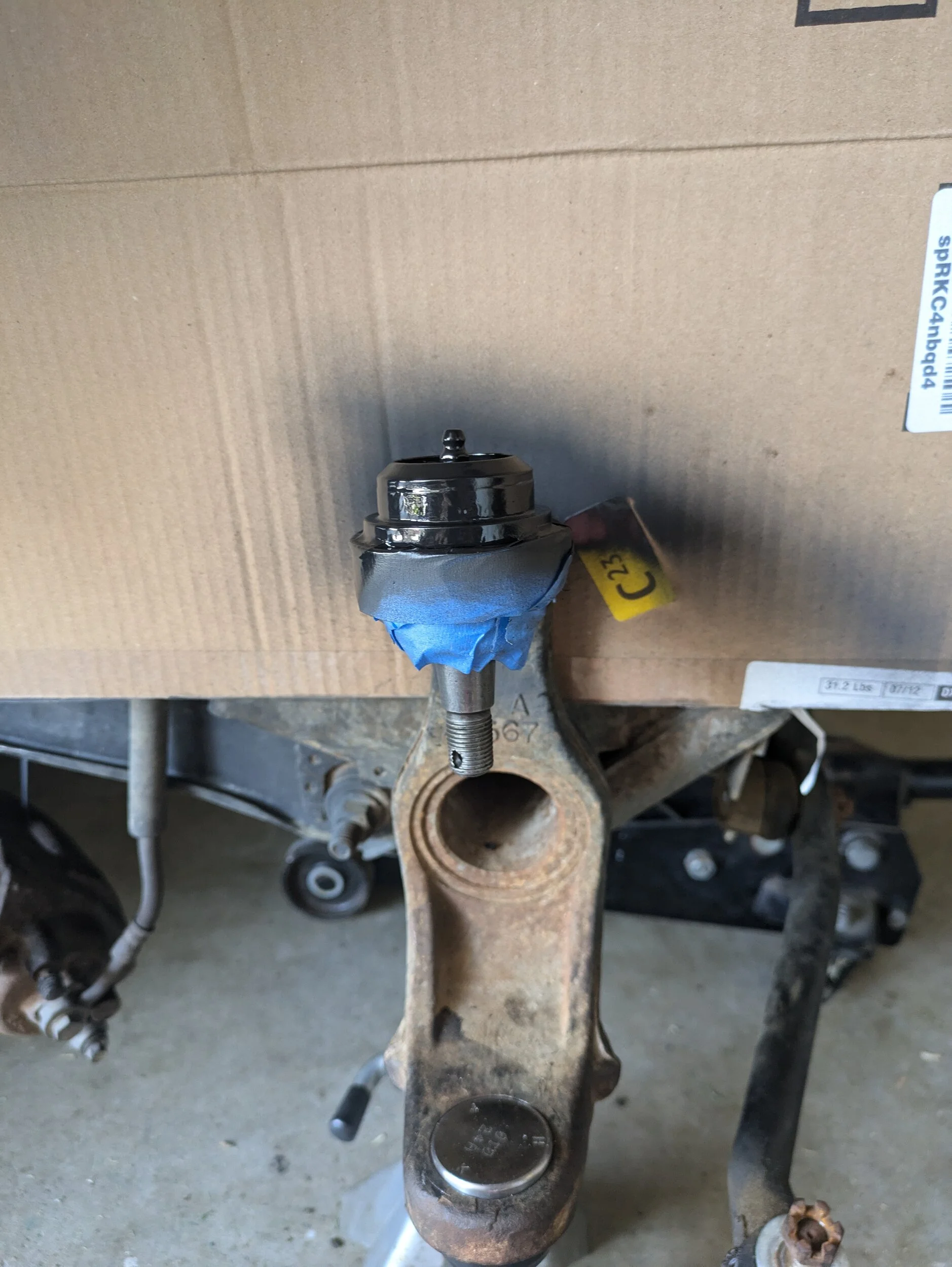

I got the ball joints pressed out without much fuss. Getting the new ones installed went fairly smoothly as well. I just took my time making sure I got the ball joints lined up well before pressing them in. Painted the upper ball joints to avoid rust.

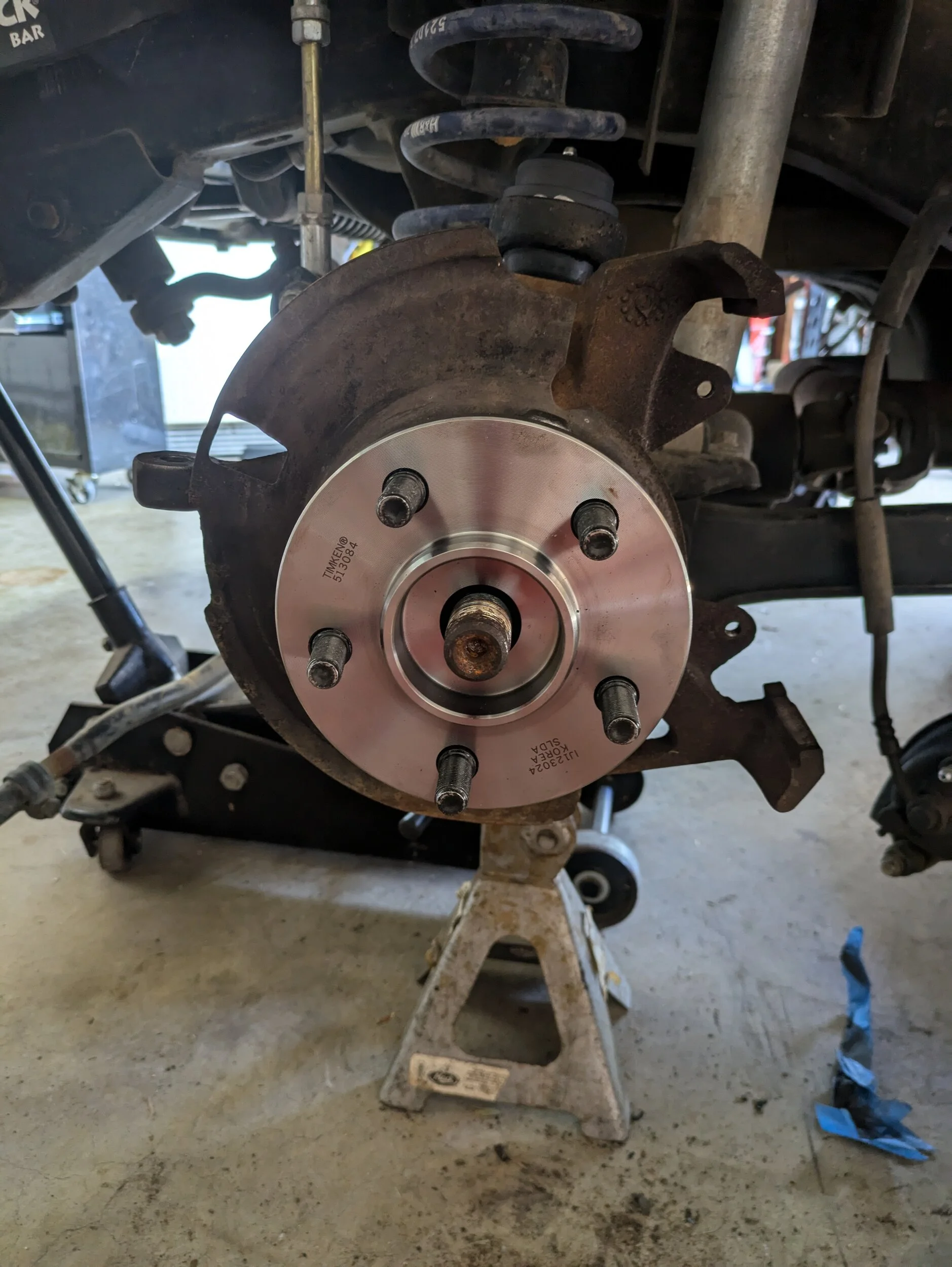

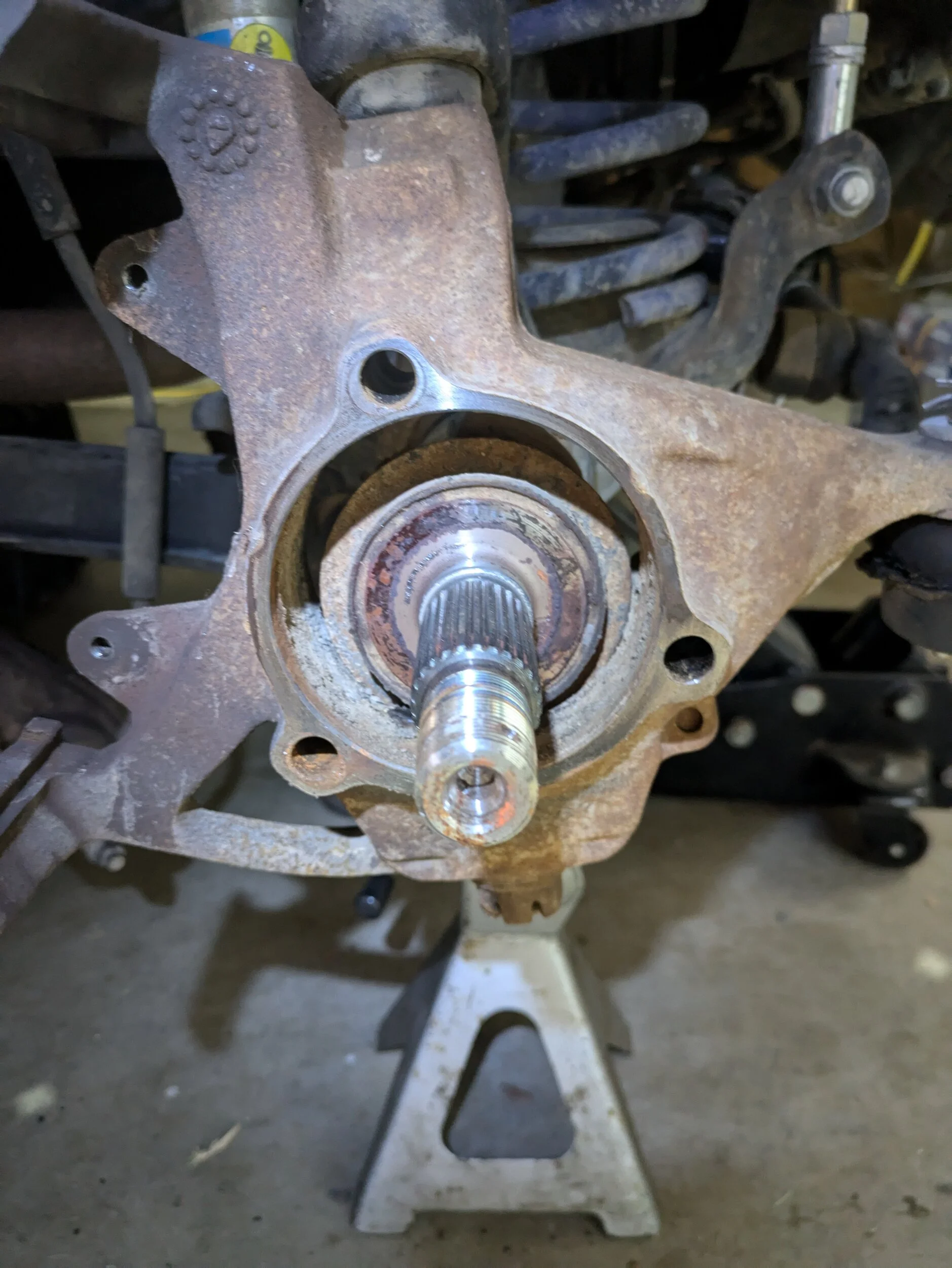

I was hoping to get the knuckles back on, axles back in and the new hubs in today. I had good success on the driver side, here she is:

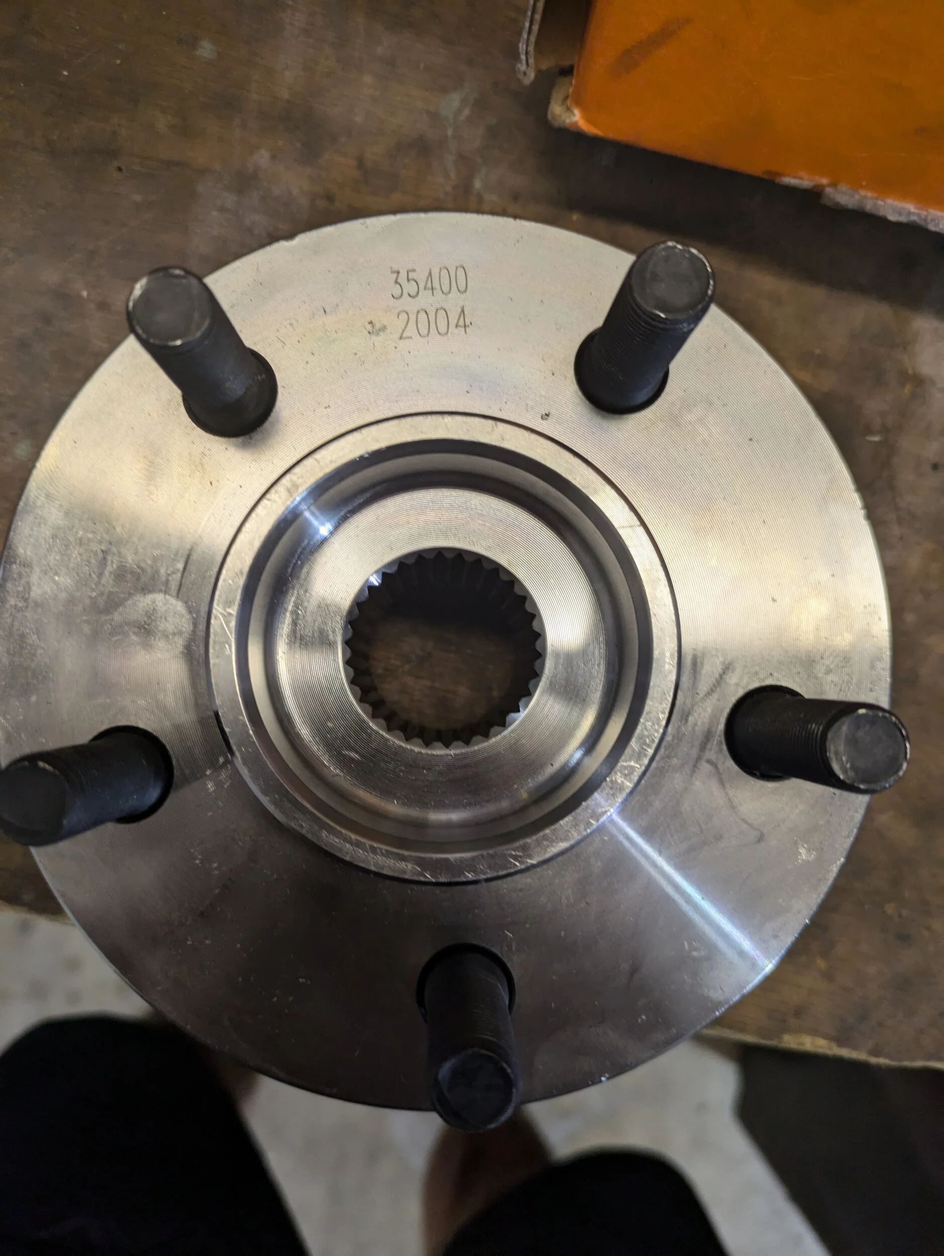

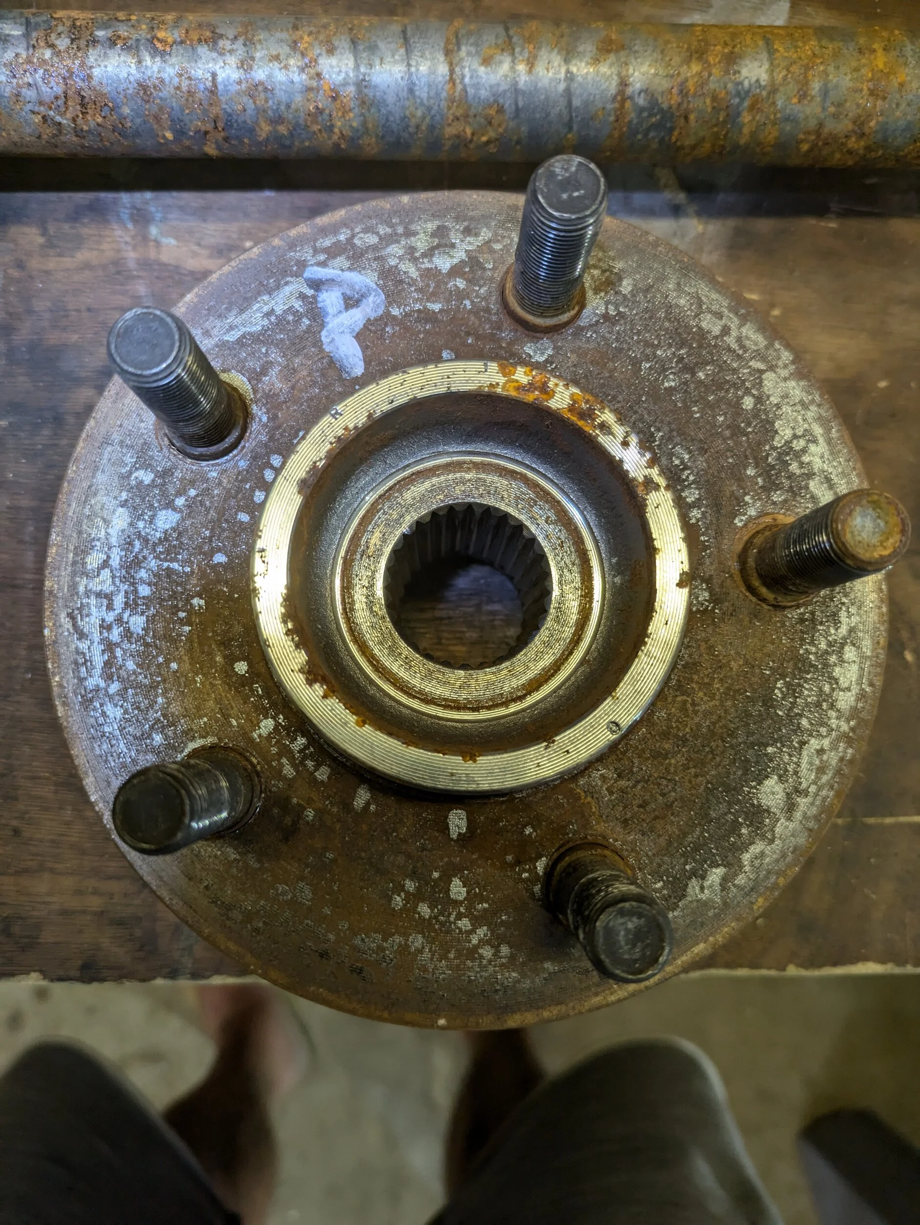

Unfortunately I found when I got to installing the hub on the passenger side, it was not the correct hub, looks like it is maybe a 30 spline hub? So I had to order another off Amazon that should be here tomorrow. It was rattling around on my axle shaft.
Picture of the offending unit:
I googled 35400 and saw an alloy usa not a timken? Anyway it's going back to the sender.
That's a bummer, but the rest is looking good!
