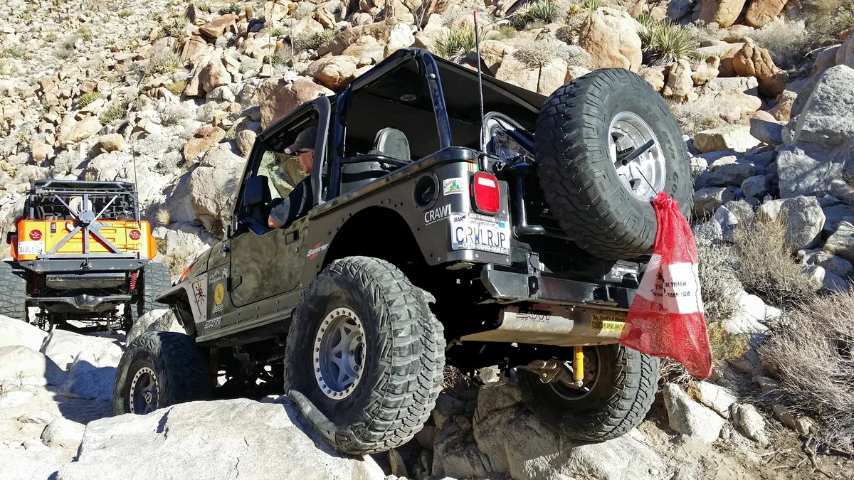

I just used a mallet to bend the rear plate to the curvature of the rear corner, mounted it directly to the corner, then used LED mounting bolts to light the plate up at night. https://www.denniskirk.com/k-and-s/led-license-plate-mounting-bolts-25-9160.p213803.prd/213803.sku
Hey Jerry,
Did you use existing threaded holes to mount the plate?

I didn't need nutserts, just put a bolt through and a nut on the back side, nothing was blocking once I removed the rear portion of the inner fender liner to gain access.

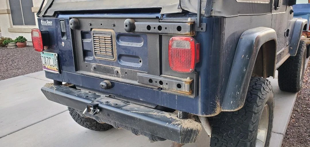

I just drilled the plate, shifted it driver and used three bolts (left and lower) in the stock locations on the tub. Works fine on a CA plate, don't know if it'll mess with the markings or stickers on a NV plate.

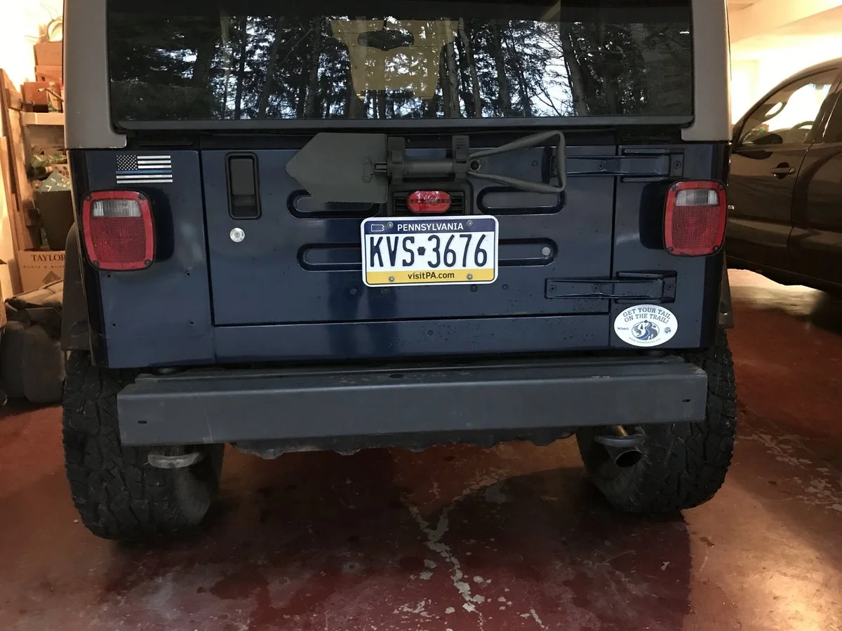

Here's what I ended up doing with my plate re lo. Installed onto tailgate vent louver using universal plate bracket that I had laying around. Thanks for everyone's input.

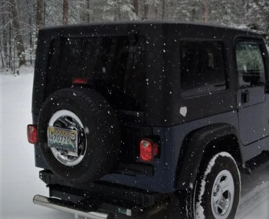

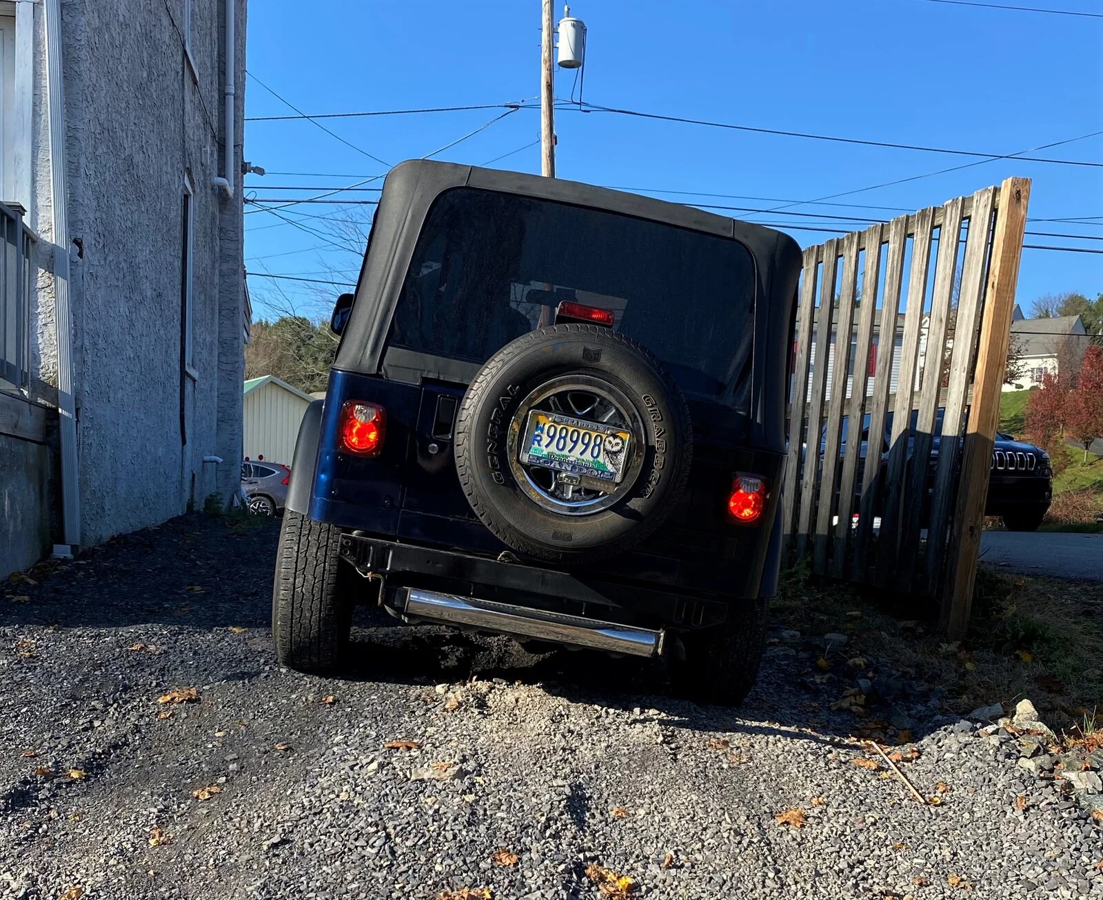

Excellent - I really Like IT - I maybe prejudice I have attached my version .. I am working on wiring my license light with the two wire system to the 3rd brake light. How did you do it ( currently I have it connected to my trailer wiring) ?? Thanks !

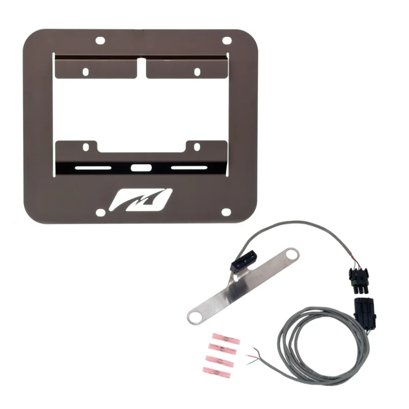

I bought this few years ago and it has been sitting it a closet ever since.
I also have the ORO PlateLITE for tag light and 3rd brake light. Where would be the best place to tie this in to my 06 LJ? I don't really want to cut into the factory wiring, but would if I have to. I had bought a trailer harness hoping to tie into it, but I have no idea where it's at and would have to look for it. Any reason why I shouldn't try to tie into the trailer harness if I can find it?
