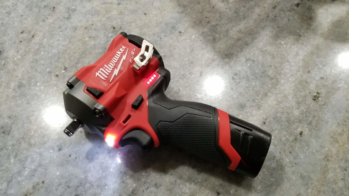

I runs (2) Viair 400P RV versions for our SxS / ATV's & airing up for beach runs with no issue, they have been great units. They are not super fast or convenient but I'm usually not in a hurry at the end of the day... & because they are not mounted I can take them in any vehicle / on any trip. They aren't going to run an air tool obviously but as mentioned the newer battery powered tools are incredible. A small inverter will run the battery charger & you can have a Impact, a Drill, a Grinder, etc, etc, etc all portable (oh & a Viair) for less than a OBA setup that can run Air tools efficiently.
Now if money, weight, & space are no problem...in the 12V world.... I also own a Oasis XD3000 continuous duty (100% cycle duty) 12V compressor that I have on my tow rig (8cfm @ 100PSI - no tank) that will break bolts with the correct Impact wrench. It was expensive (& is bad a$$) but when I purchased it the lithium battery powered tools where not an option... It is what all the service / wreckers used if they weren't using gas power. It has faithfully run & done everything I've needed for 12+ years.
But... I love the mobility of the Viair & the battery powered tools... I know some say the battery stuff is expensive (& the good stuff is) but you will use it everywhere& for everything... not just wheeling... just my .02

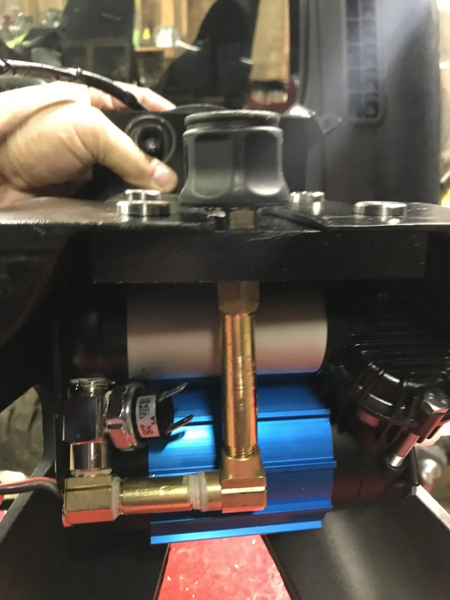

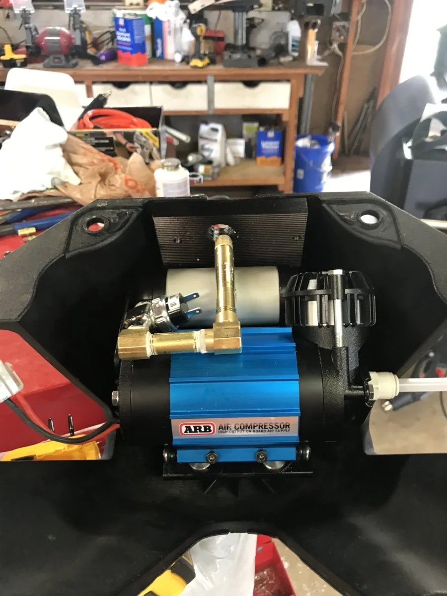

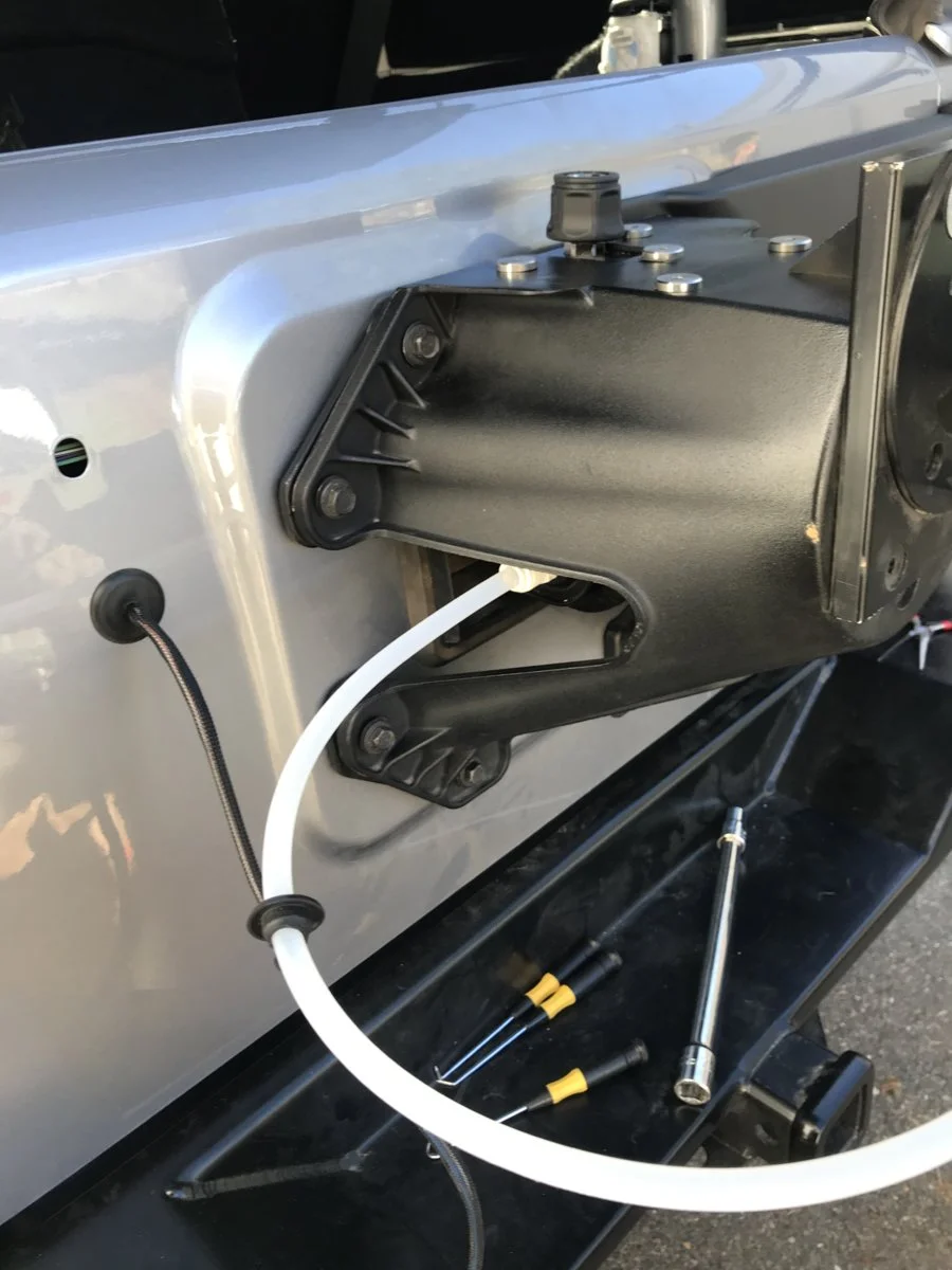

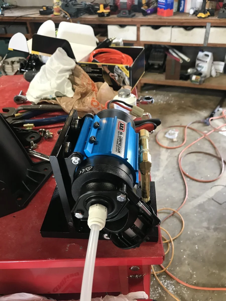

I Mounted an ARB single under the OE spare tire carrier on my wife’s JKUHR. There’s just as much room under the stock TJ carrier.
I use an 18V battery air compressor from Ryobi around the farm. Almost never use the main shop compressor for day to day life. Its able to fill a soft rear tractor tire easily on a single old style half dead battery. On these new lithium ones it seems to last forever. That way if I have to do any other repair I have the impact, drill, sawszall, etc ready to go too. Have a car recharge and you have air plus a whole lot more.

Nice set-up, looks really clean, awesome use of available space.
Thanks, all the “Store Bought” mounts put it inside under the seat where it drives you crazy or in the way in the engine bay. This is somewhat out of the weather and completely out of the way. Like I was saying, I could get one under the TJ carrier just as easy.
