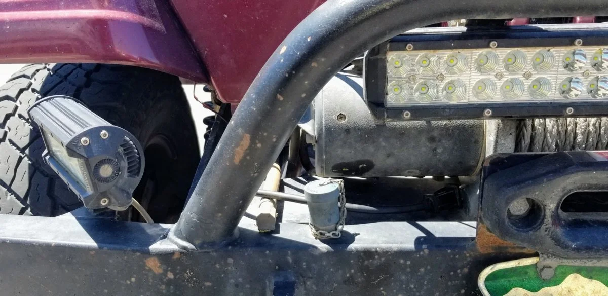

Here's mine. :)
As I mentioned, my bumper is a coupler mount that coincidentally is an air tank.

Here's mine. :)
So just the bull bar is the tank or the whole bumper?
