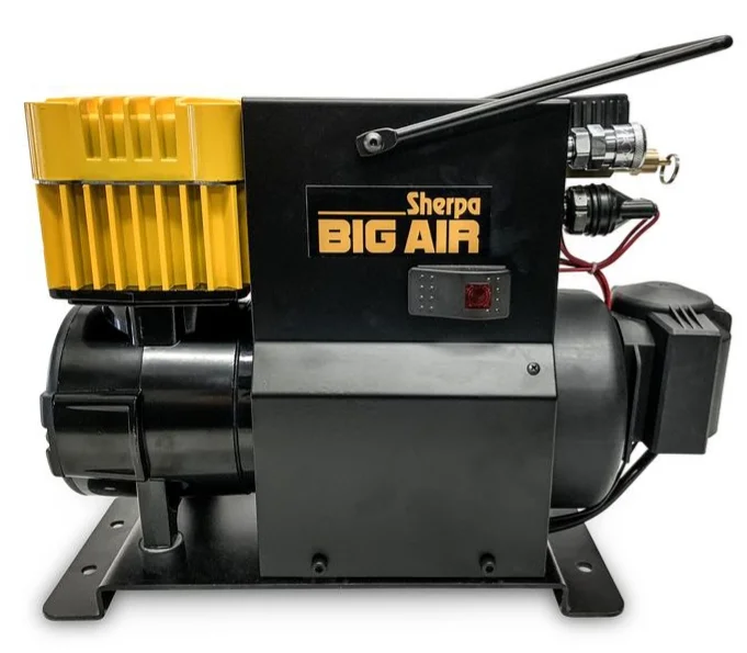

Sherpa Big Air - ~4.5cfm @ 90psi

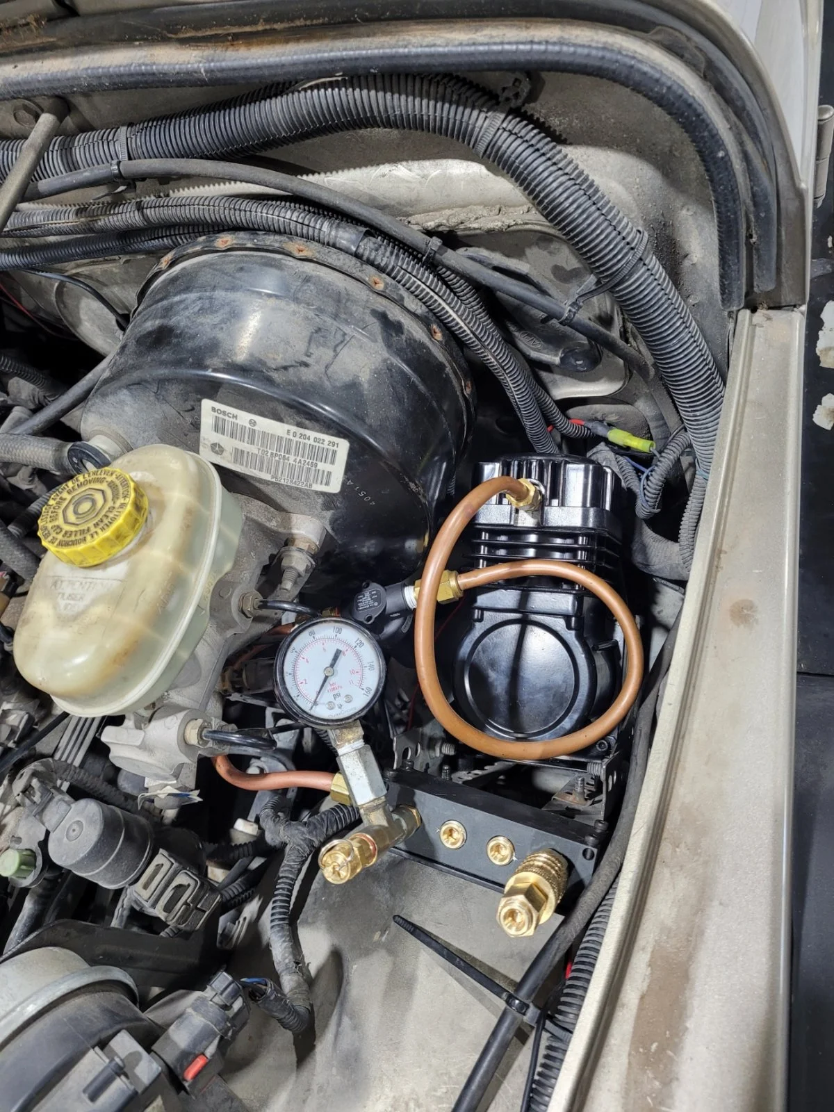

Here's my on-board air setup with a Speedmaster PE560.1001. I made a bracket out of some angle material and recommissioned some rubber dampers to reduce vibrations. After removing some extraneous fittings and rotating the cylinder 180 degrees, it slid nicely down into the cavity to the outside of the master cylinder. It already has a relay, so I tapped into it to hard wire it to the battery and installed a rocker switch in the dash.
