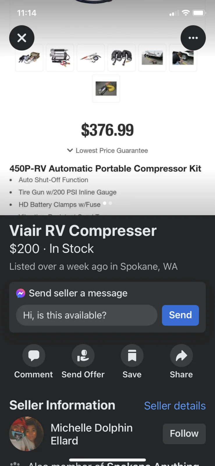

@psrivats
Look at this. Just went on FB Marketplace and walla!
There you go! That's perfect. Buy it!

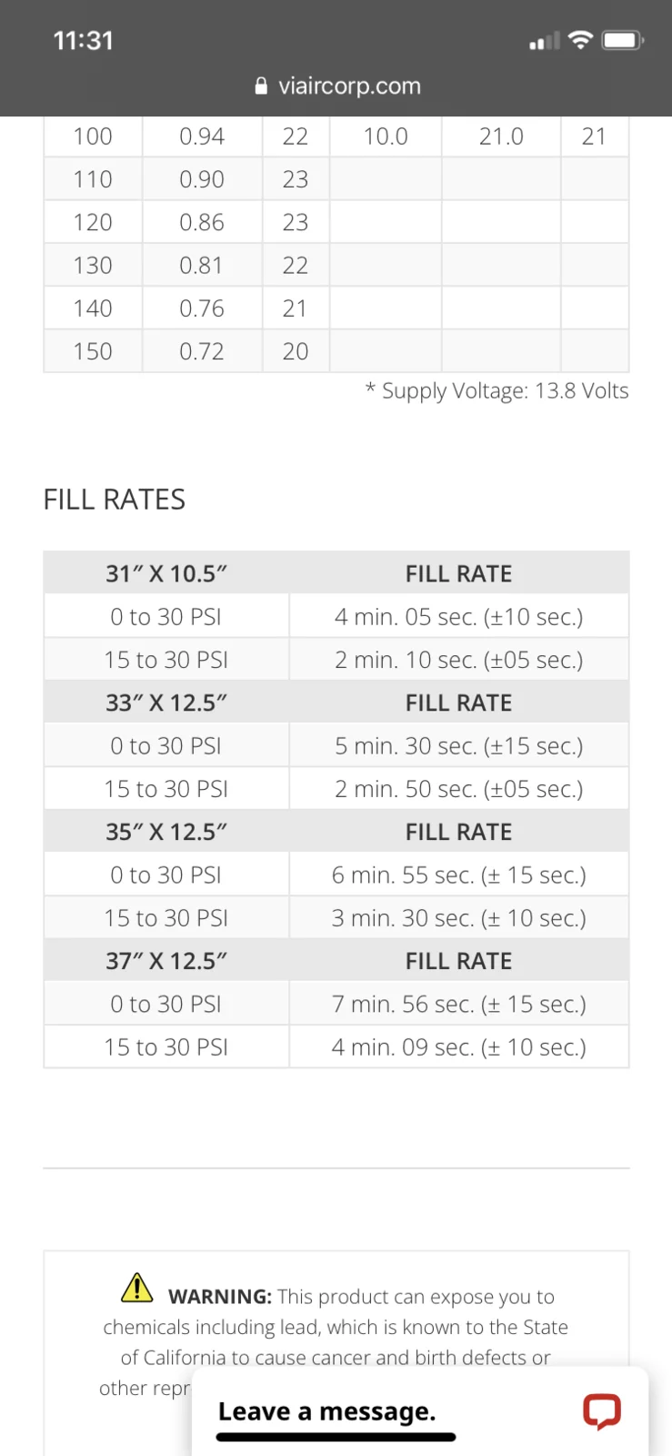

Fill times. I air down to 10psi and run daily at 24psi. Sounds like it would take ~3.5 minutes per tire. Hmm…
Only CO2 will be faster than that, I think.
Looks like the 440P boasts 3.0cfm and fills a 35 “ tire from 15-30psi in 2 min 15 sec. not one available on FB though.
Does that one minute difference really matter ? 🙂
My 88P fills them in 4:15, so I’m contemplating the value of reducing each tire 45 seconds.
Last time my sons and I went out it took over 30 minutes with the 88P to do all eight tires, so I need something.
