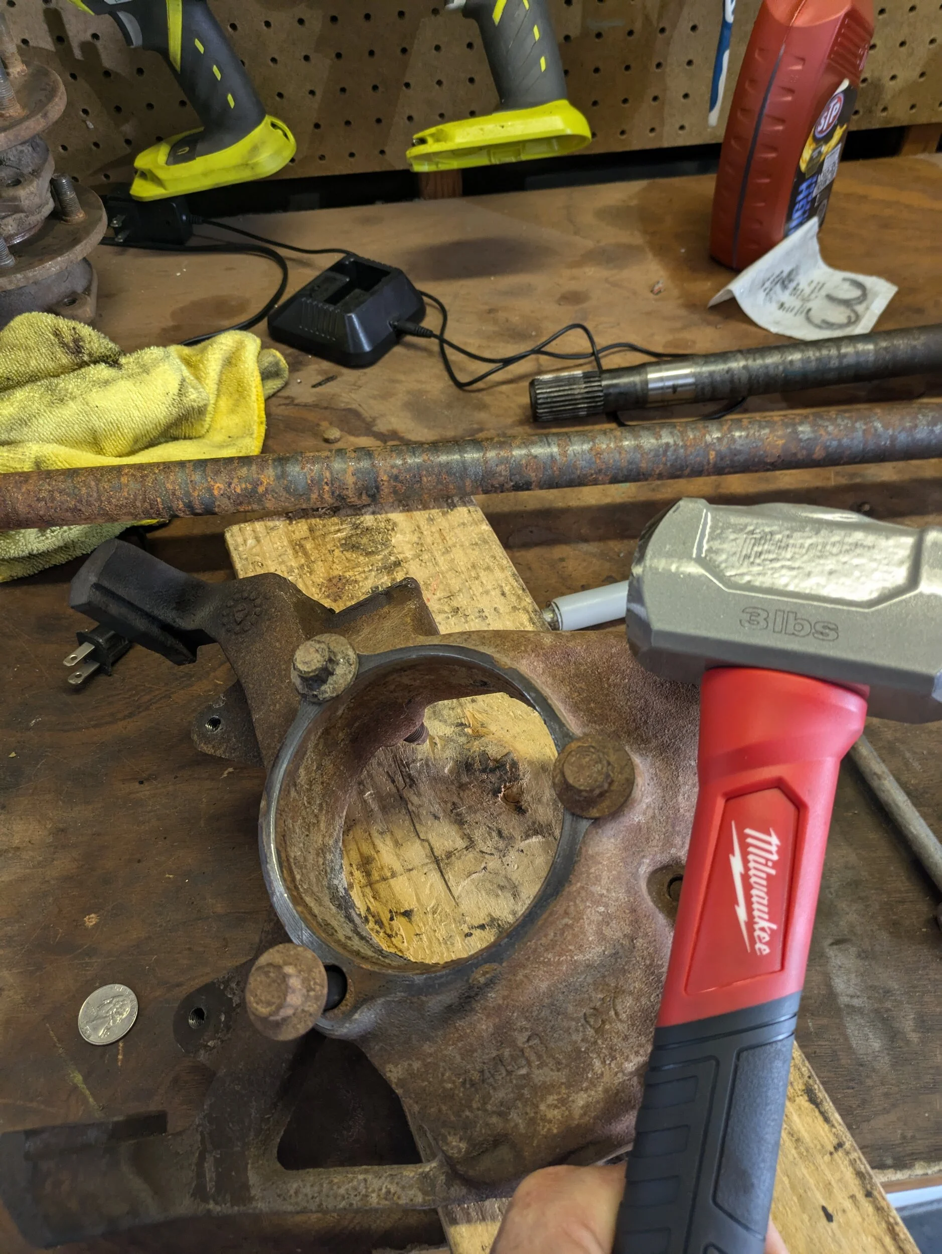

You may be right about that. Out of necessity I purchased this 48 oz drilling hammer. HD didn't have any selection in store for the ball peen dead blows, just one or the other.
Anyway, I got home and probably gave the knuckle another 10 good wacks with it before it finally came loose. We'll see what the driver side is like, but that thing was on there.
