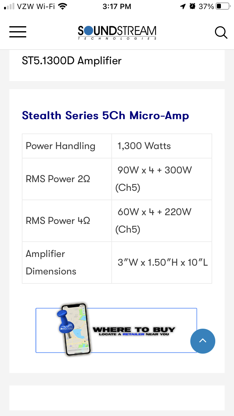

the kicker replacement sub i’m looking at comes in either a 2 ohm dual voice coil or a 4 ohm dual voice coil. which one do i need if running the 4ohm polks front and rear? here’s the amp specs that i plan on running. should the sub be wired parallel or in series? trying to get this figured out as it’s been a way long time since i’ve installed a decent sound systems.
I'm pretty confident you need the dual voice coil 4ohm so you can bridge your amp to 2 ohm and get the 300w to the sub.

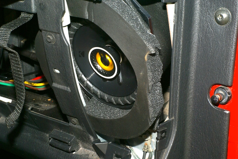

That is an entirely different product for an entirely different issue. I'm using those as well - but honestly don't know what they do if anything. They supposedly close the back off so the sound doesn't escape as readily in that direction, the foam rings pipe it out the front - this latter I can attest to. Still, I cut a hole in those back shells to let the speaker breathe. I figure the back shells are 90% of the $90 "pods" at 10% the cost.
I also did this to the soundbar enclosures, in addition to some boom mat and polyfill inside:
With a significant improvement in sound quality therefrom.

i’m guessing it’s ok to wire the 4 ohm dual voice coil sub to 2 ohm while the others are running at 4 ohm, all running off of the same amp? ready to order the pieces to this puzzle, just wanted to make sure i’ve got the right pieces.

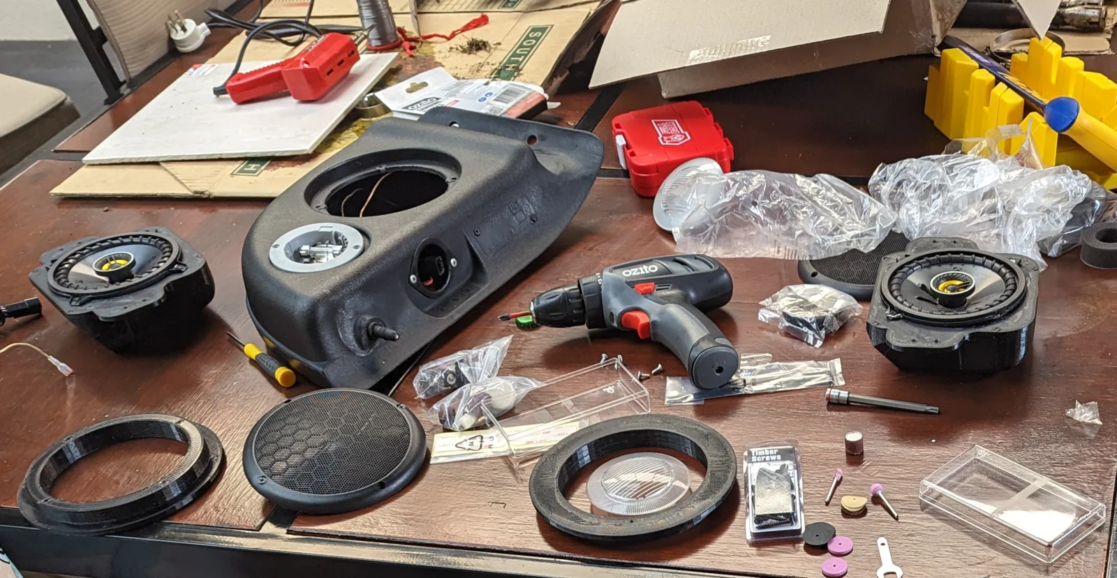

The front sound pods worked beautifully, which was the main thing. It comes out in four separate pieces, basically a faceplate and pod for both left and right sides. I used plastic cement to seal the two halves of each pod together and drilled a narrow hole in the back for wires. I filled the pod itself with polyfill.

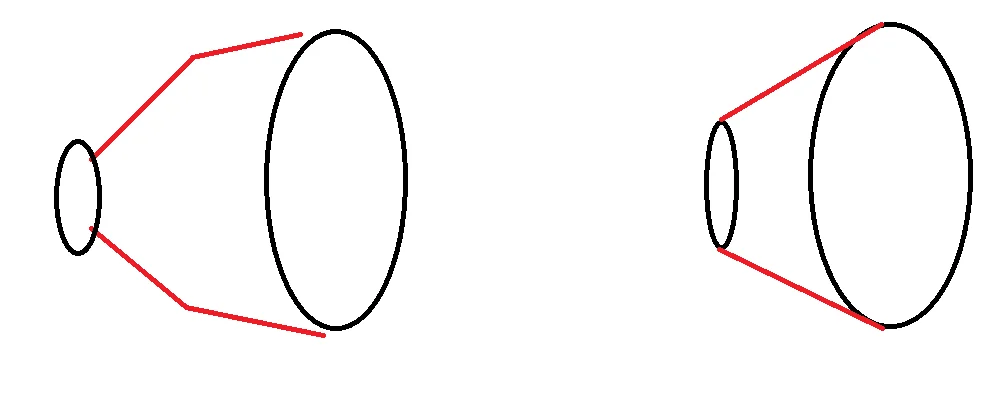

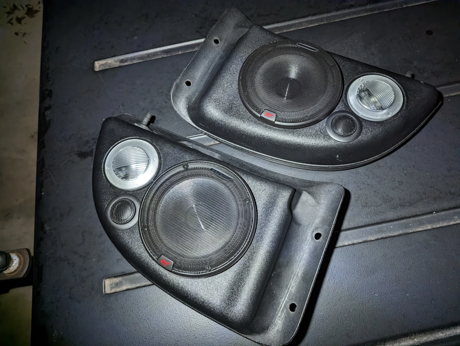

I had a bit of trouble with the adapter rings for the rear stock sound pods, but that was because of my particular speaker. They would be good in general, but I think everyone's experience with these may vary. In my case, I used Alpine Type R 6.5" component speakers (R-S65C.2). The issue with these was that they are hefty and the metal housing which holds the magnet protrudes almost perpendicular to the front of the cone (left), whereas most speakers have sharper angles (right):
I had to dremel a decent chunk of material off of my adapter rings in order to get the speaker to go through. So really depends what speakers you have. I think some people have dropped 6.5" speakers straight into the stock hole and screwed the speakers and grilles directly to the sound pod. I wanted to keep mine somewhat reversible and not mangle any stock parts more than necessary:
Can see the printed adapter rings and pods here (I will post another pic of them installed when I get a chance to take one). I had the 5.25" kicker speakers a lot of people use up front, but am about to replace with better Alpine component ones and tweeters (plan is to use the tweeter pods linked above)
