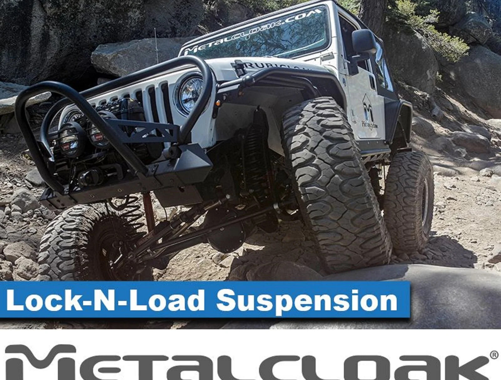

Post a pic of your front end. Looks like your kit has a dropped frame side trackbar mount.
Reactions: Necro
It DOES look like it on their website:
If they got the geometry right with the drop bracket and drop pitman arm then I would guess that bump steer is not the issue. I would check the splines on the pitman arm and make sure there isn't any play there, and the steering gear box itself if all the other parts in the system are relatively new and the alignment has been verified.
I’d still personally remove it just because the geometry was correct stock.
Usually when I see brands running drop trackbar brackets it's because the trackbar they are using binds and limits down travel.
The version shown in the pic you linked doesn't look like it would bind, but it's bolted in differently than the stock trackbar. The stock trackbar bolts vertically and the cheaper brands can't get enough flex out of their bushings.
Yea I was wondering if he took off the track bar bracket can he still run the MC track bar.
Could he just move the joint to mount horizontal? Given if it will line up and the axle would be centered.
