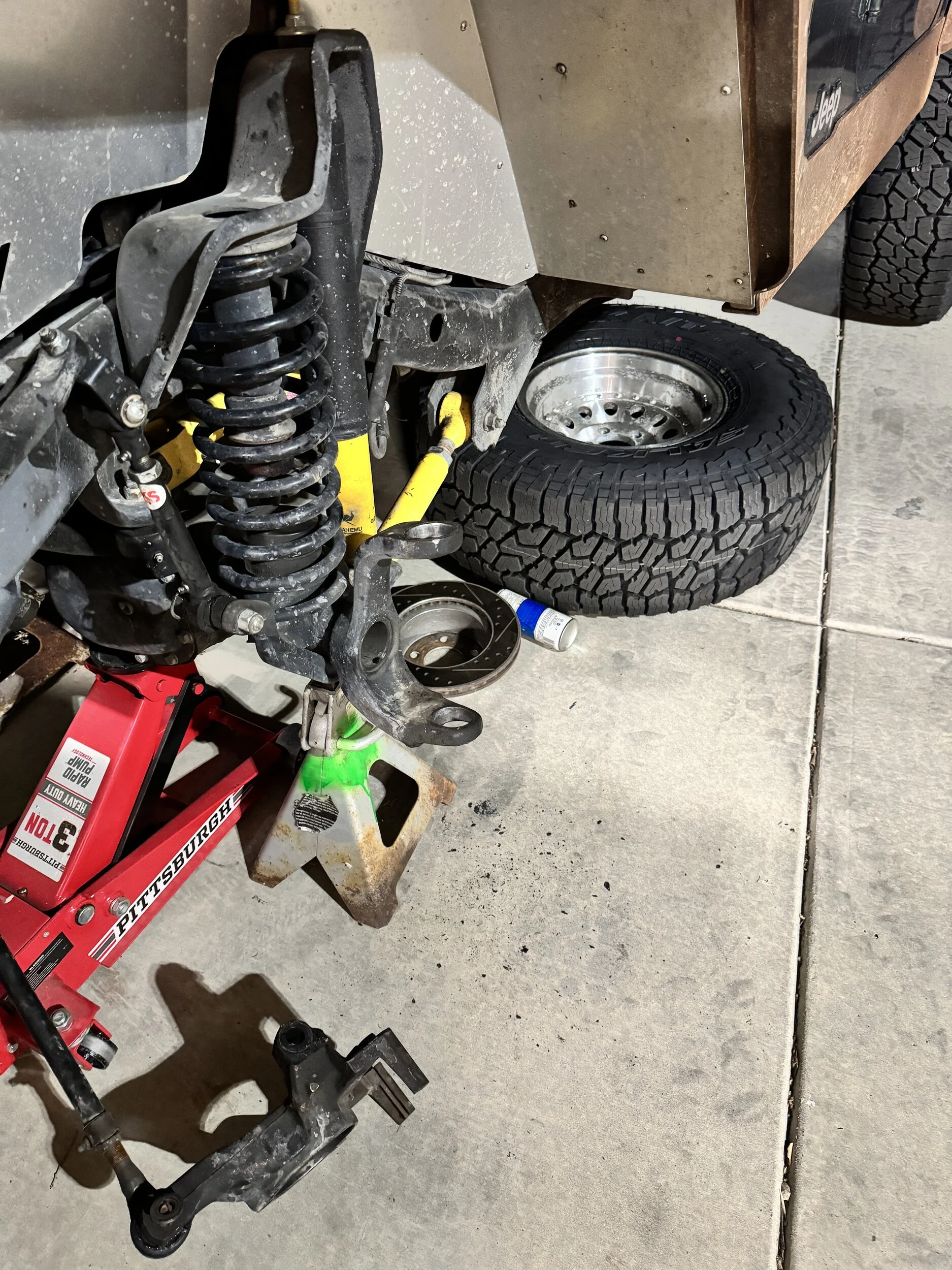

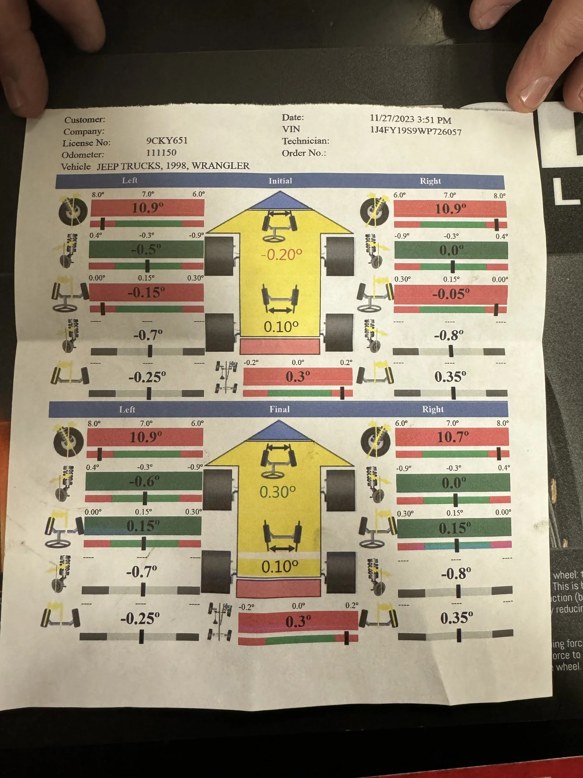

The “memory steer” still remains. At this point I’m convinced it’s the ball joints. The caster is at almost 11 degrees and the toe in is correct (see alignment sheet). I’ve removed the moog ball joints that were installed last year and unfortunately come to find that they were knurled. I already have the spicer units in hand, which are now a loose fit. I can’t quite push them all the way in by hand, but I know it’s not correct. Contemplating the ball pin and loctite method… any input?
11 degrees of caster will make the steering very heavy. The peen and Loctite 609 method has never not worked. The peens don't need to be deep, just close together.

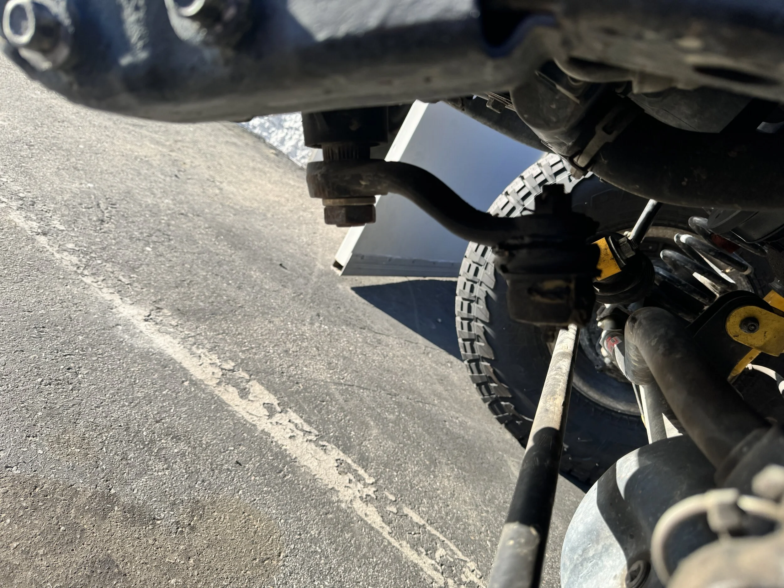

It does not look like I have a dropped pitman arm. But I am curious about which plane the tie rod is supposed to move the same as something else as it doesn’t seem like any of the components (tie rods, drag link or track bar) are in the same plane. Is it possible there is a geometry issue in the tie rod set up that the Currie correctlynk would solve?
One other thing I would add, is I have no idea how well the adjustable control arms are setup and if they’re pushing the axle to far forward or back. To me, it does not seem like the top spring perch is centered over the bump stop.
