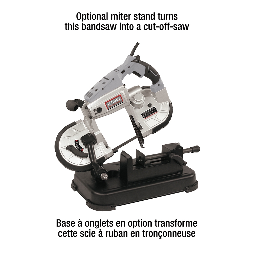

I've never shopped for band saws but I found what appears to be a Canadian company called King. They make what looks to my untrained eye like some nice big expensive stuff, like horizontals.
They also sell this.
I might have gone for it already except that it looks suspiciously like Harbor Freights Bauer model, but is twice the price. I don't know what differences might exist internally, but I did find a YT video that confirms the Bauers lack of accommodation for attachment to the stand.
My metal cutting options currently consist of a Sawzall, a jigsaw, and a 4.5 angle grinder. They're ok but getting a good straight cut is time consuming.
