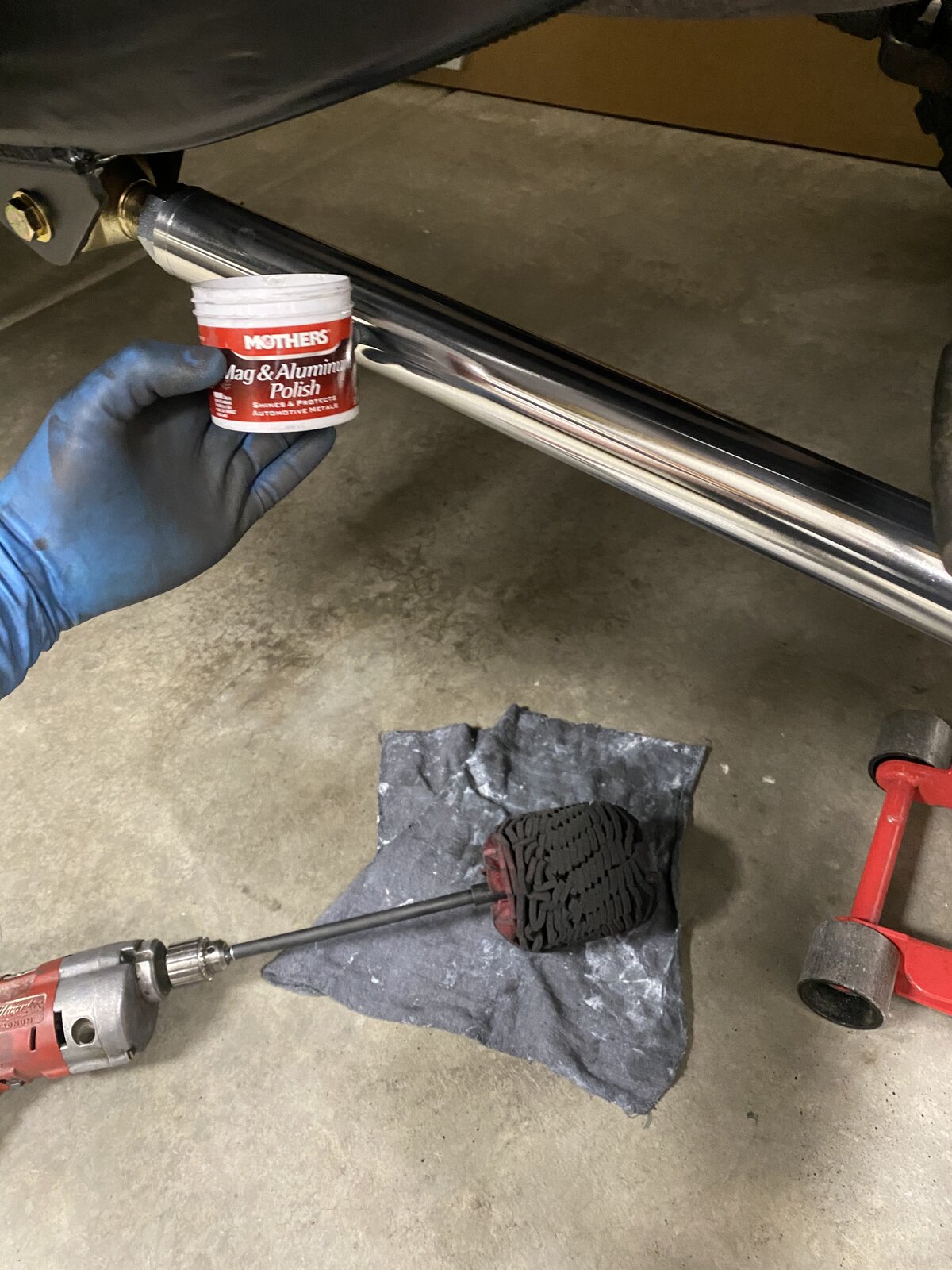

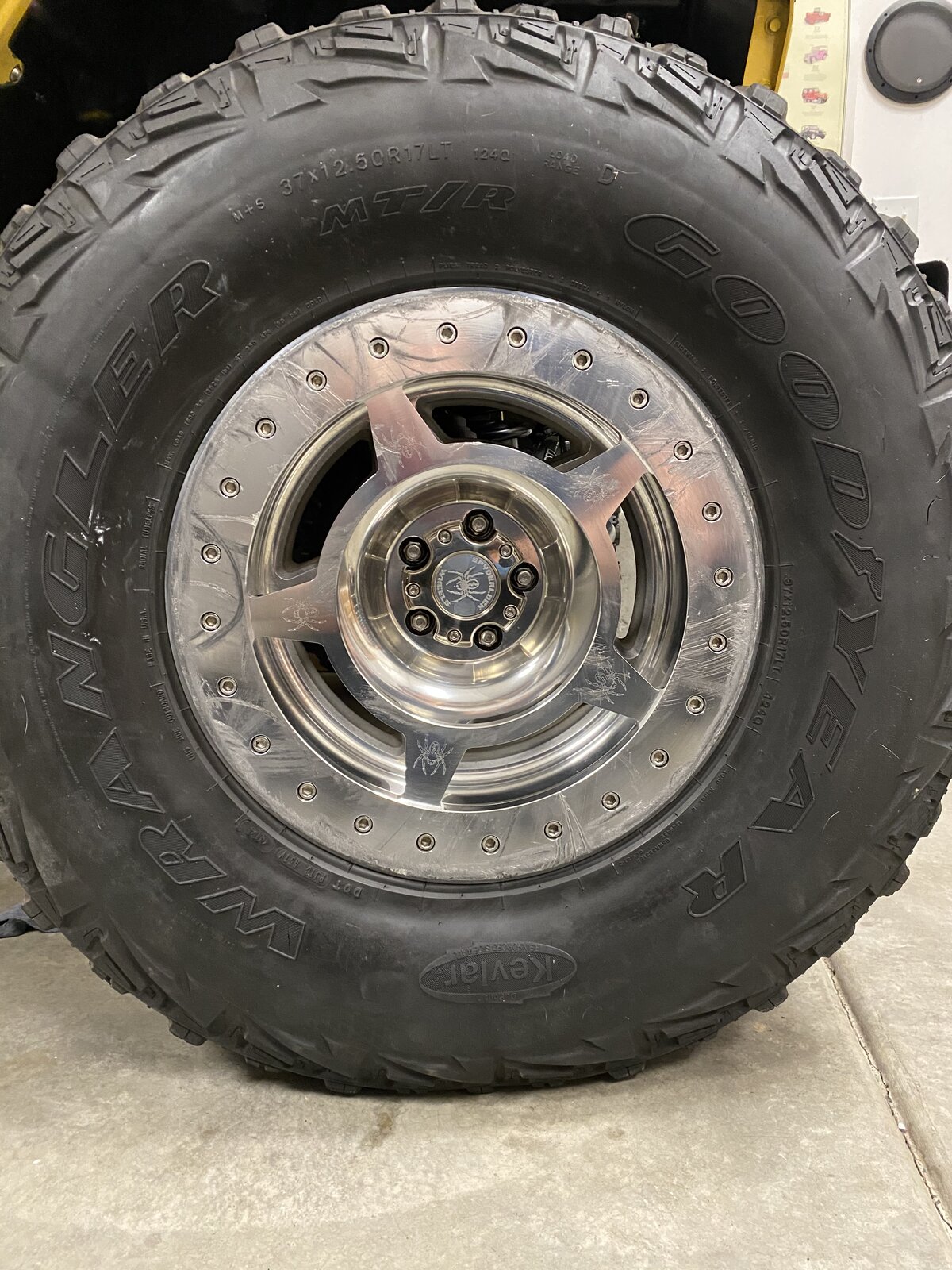

Rainy night tonight. Figured it was a good time to break out the mothers polish and powerball. My wheels needed a quick polish and then made this mid arm stand out more then it already does!
How long does the shine last? You put a clear coat over it?
I polish my wheels once a year. They don’t have much of a haze at that time. I do store it inside and dry them off after washing. I plan to start the links on the same schedule, we’ll see how they do!!
No plans to clear coat. I don’t want the clear chipping and coming off when they get some rock rash.

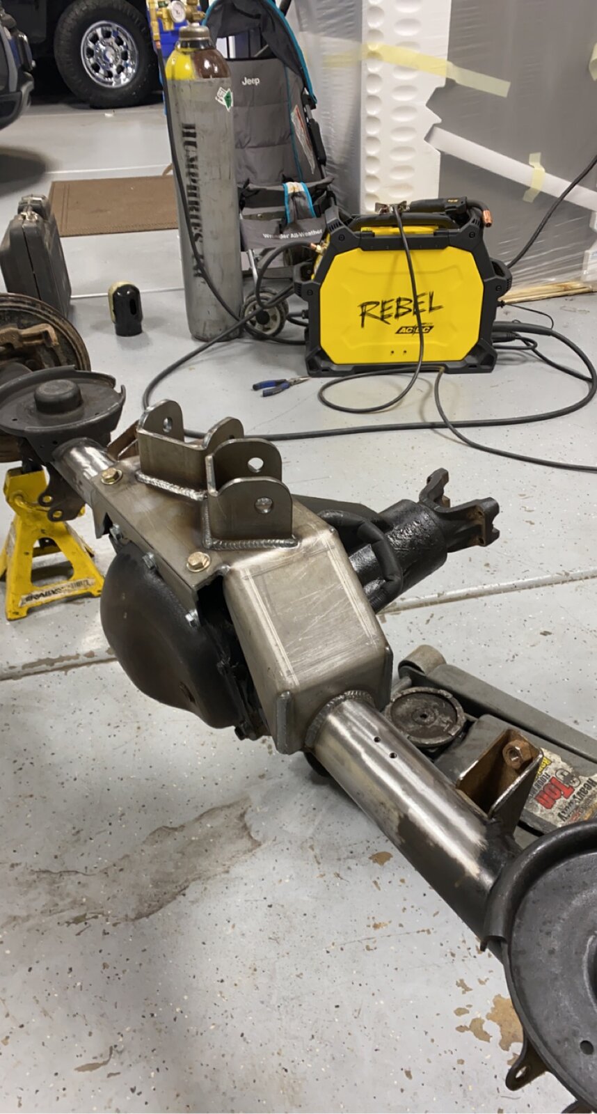

Progress is slow as I only get a few hours after work to spend on the Jeep. I got the rear upper coil pads cut off, and welded the rear truss, the control arm frame mounts, and welded the coil pads in their corrected position. I am very pleased with the way things are coming together so far! Enjoy the pics! View attachment 210853

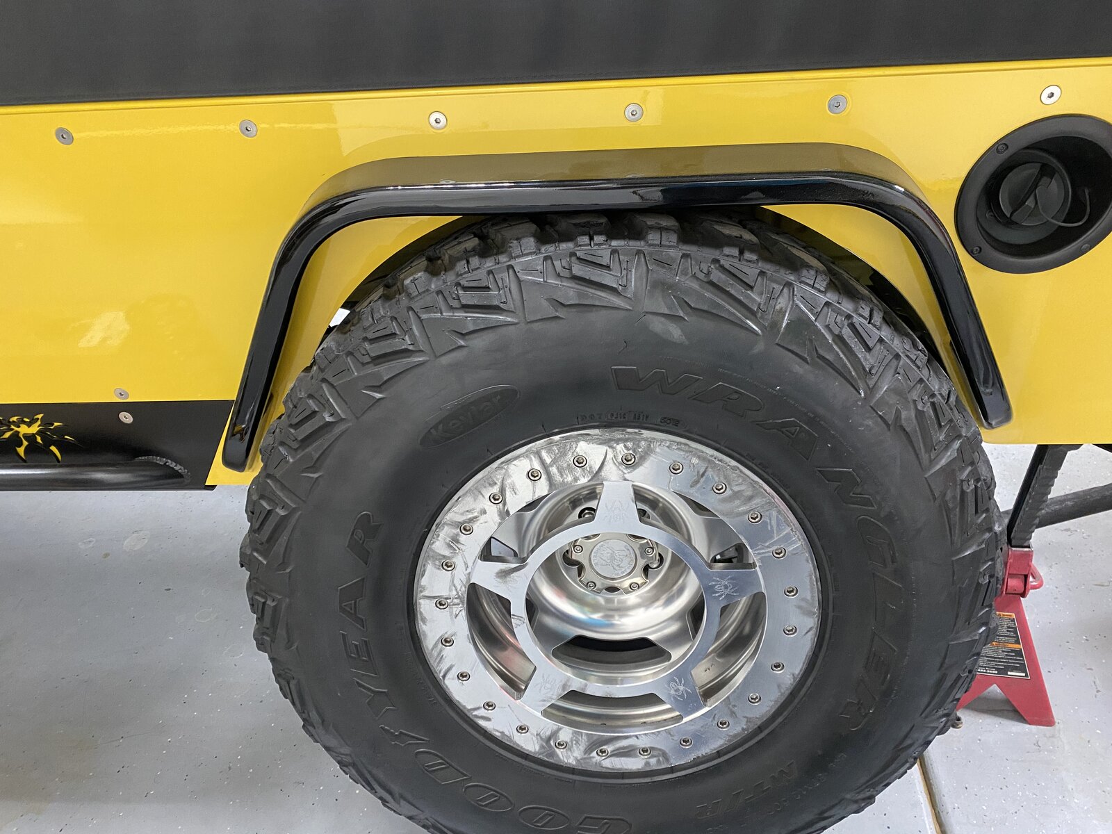

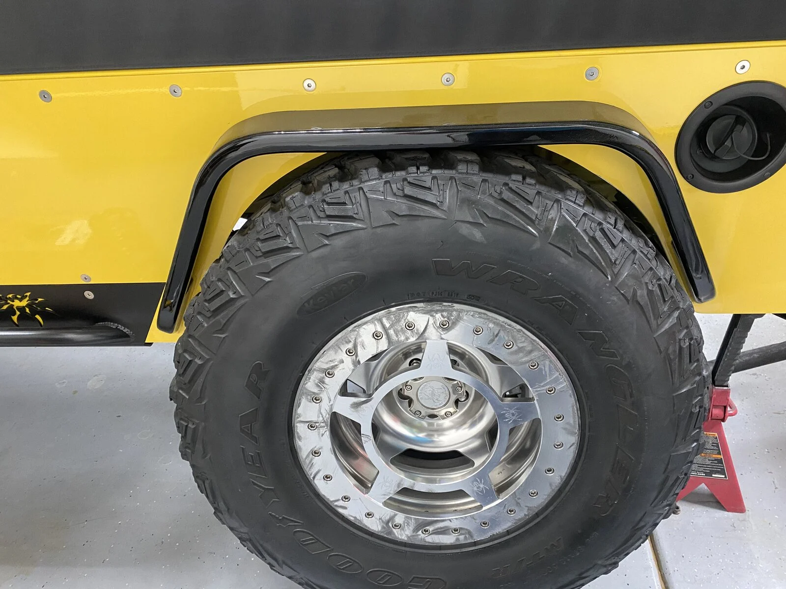

The Jeep has been on road for a bit now. Not quite ready for a wheeling trip yet. I’m waiting on longer front brake lines, I’ve got by with the stocks for now since I haven’t needed to use the full suspension travel.
I did take some time to completely work the bugs out of the rear, after cycling the suspension and trimming the rear tub wheel wells, the 37’s fit nicely. No additional bumpstop was added. (Just the Currie set that was included with the mid arm kit)

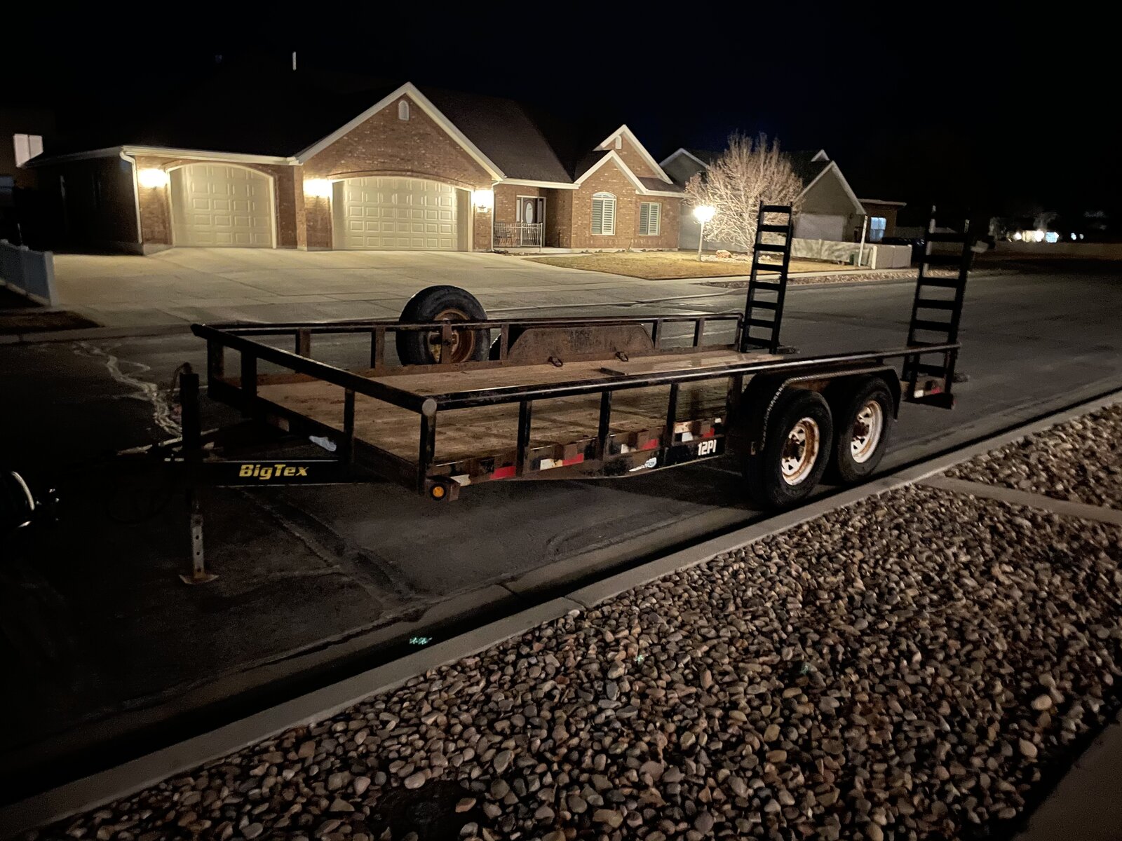

Scored a crawler hauler last week too! 18’ 14,000lb BigTex Flat bed. Needs a little work, but overall it’s in decent shape.
HOw much did that set you back? the used market up here is ridiculous. That looks like a perfect crawler hawler!
Reactions: sunnysideup_lj
$800! I feel like I scored! I went through the axles, brakes/wiring, and tires everything is in great shape. It’s a little ugly....but ive wire wheeled about half of it already for new paint. Thinking about new wood too, it’ll be like new!

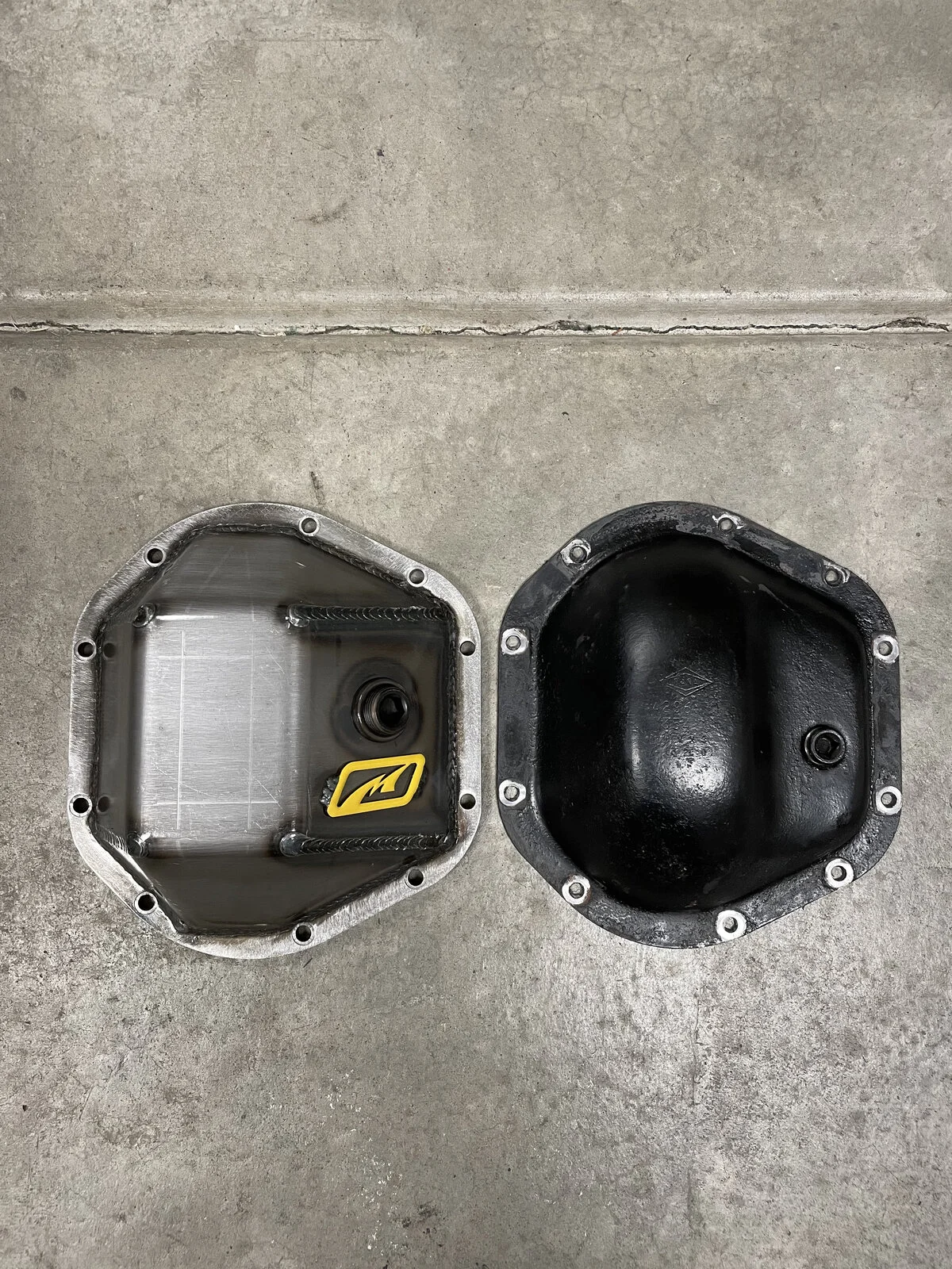

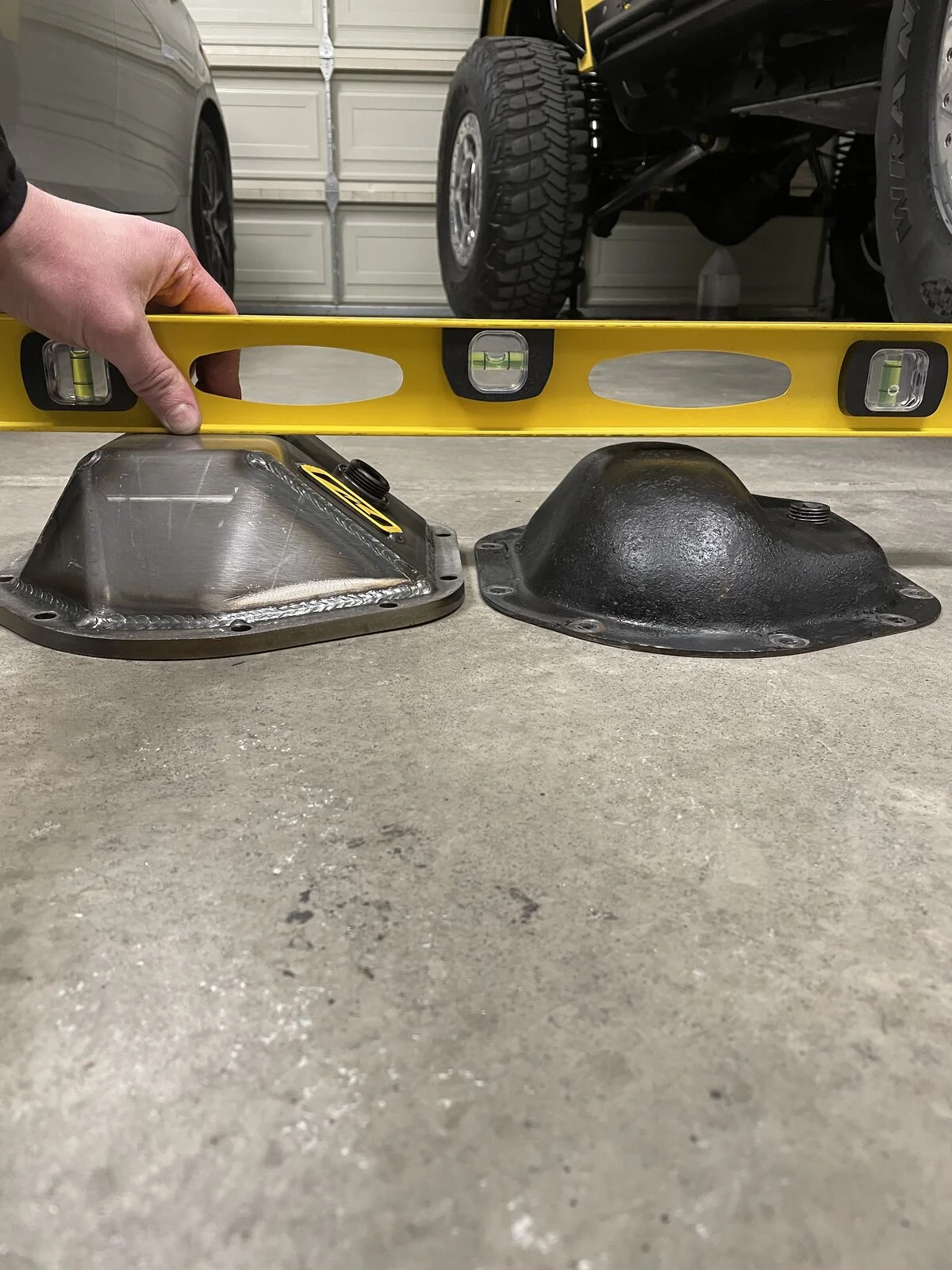

For those of you interested, I pulled my diff cover off to install my Motobilt diff cover. There was some talk earlier in my build thread about how much further it would stick out. After doing a comparison the motobilt cover is barley 3/16” taller then the stock. Not too bad for such a beefy cover!
