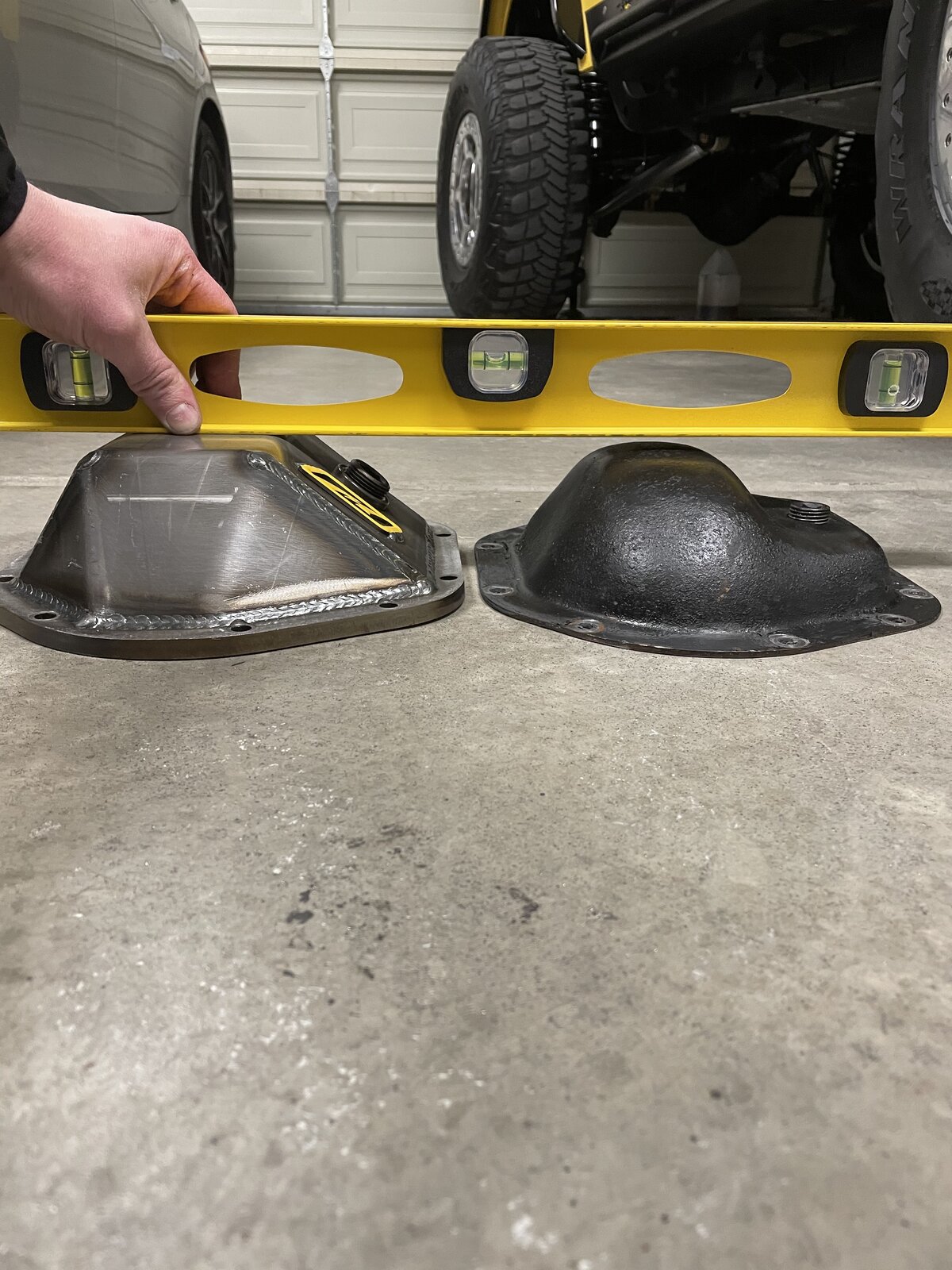

If you still have it off what is height of stock and Motobilt diff covers. I know that differ by 3/16 but height would be nice to compare to other options (meaning I’m questioning my purchase want to check lol).
Motobilt is 3” tall

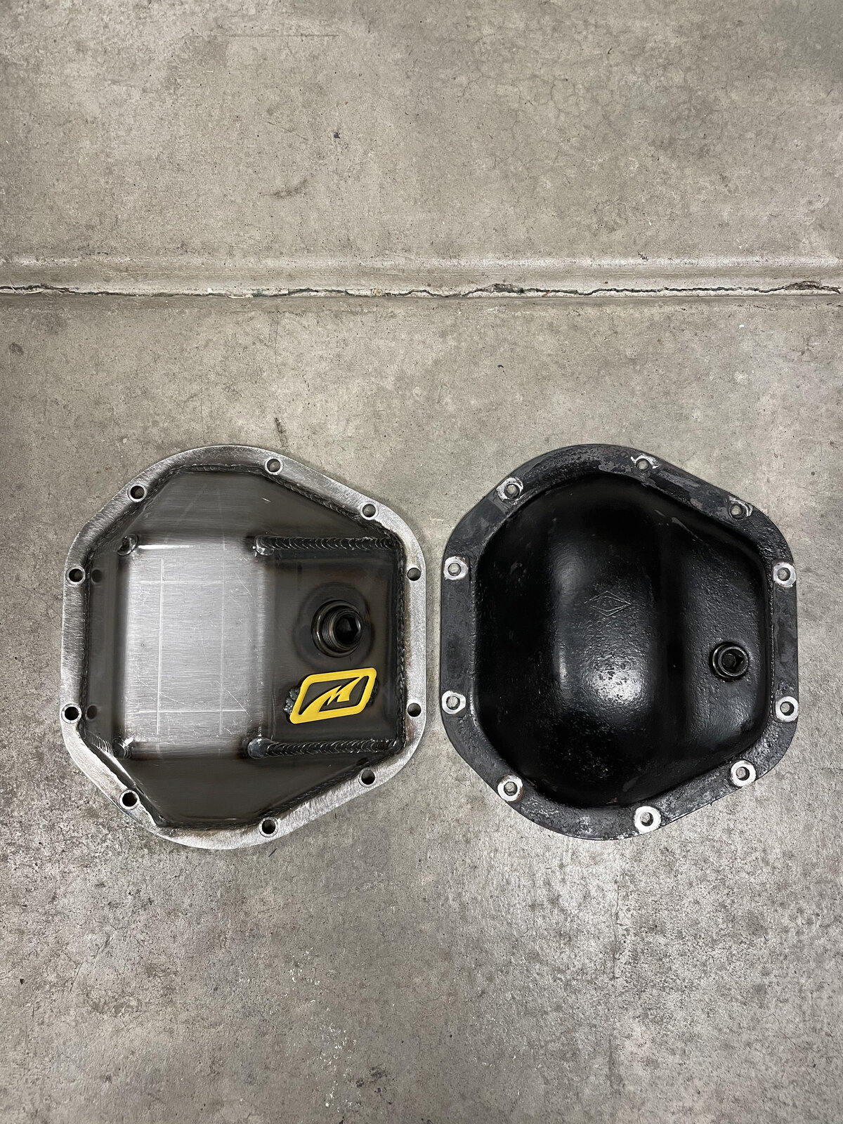

For those of you interested, I pulled my diff cover off to install my Motobilt diff cover. There was some talk earlier in my build thread about how much further it would stick out. After doing a comparison the motobilt cover is barley 3/16” taller then the stock. Not too bad for such a beefy cover! View attachment 229021View attachment 229022

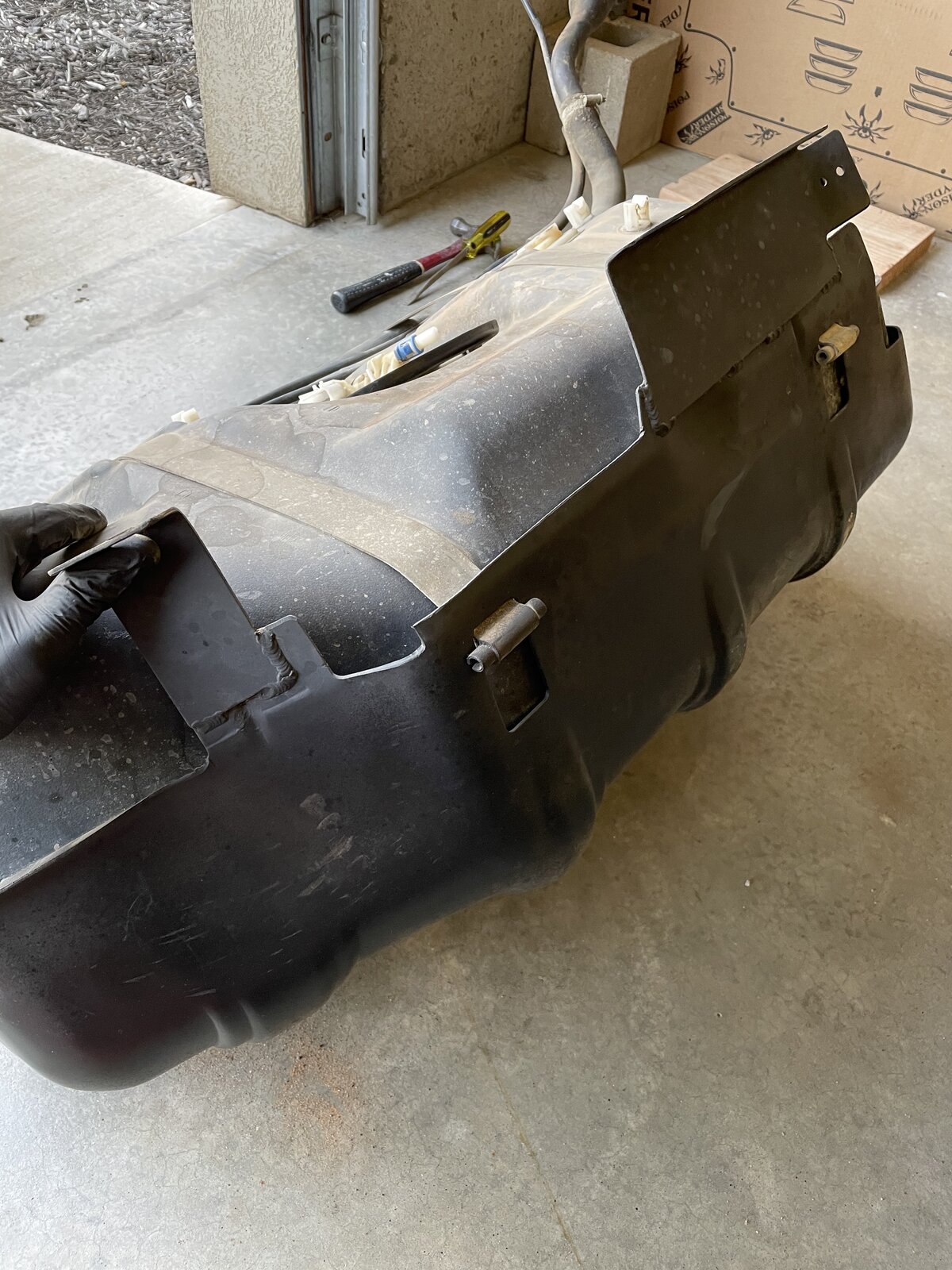

I finally ended at home with an empty tank. Figured it was a perfect time to drop the fuel tank to fix the fuel burping issue while filling the tank. Filing the guides down fixed this issue, now it fills up great!
While I had the tank out I cut the mounts off factory skid and welded them 1.25” higher. Gave me a bit more clearance for the gas tank skid. Pretty easy mod for anyone that has a factory gas tank skid and a body lift.
