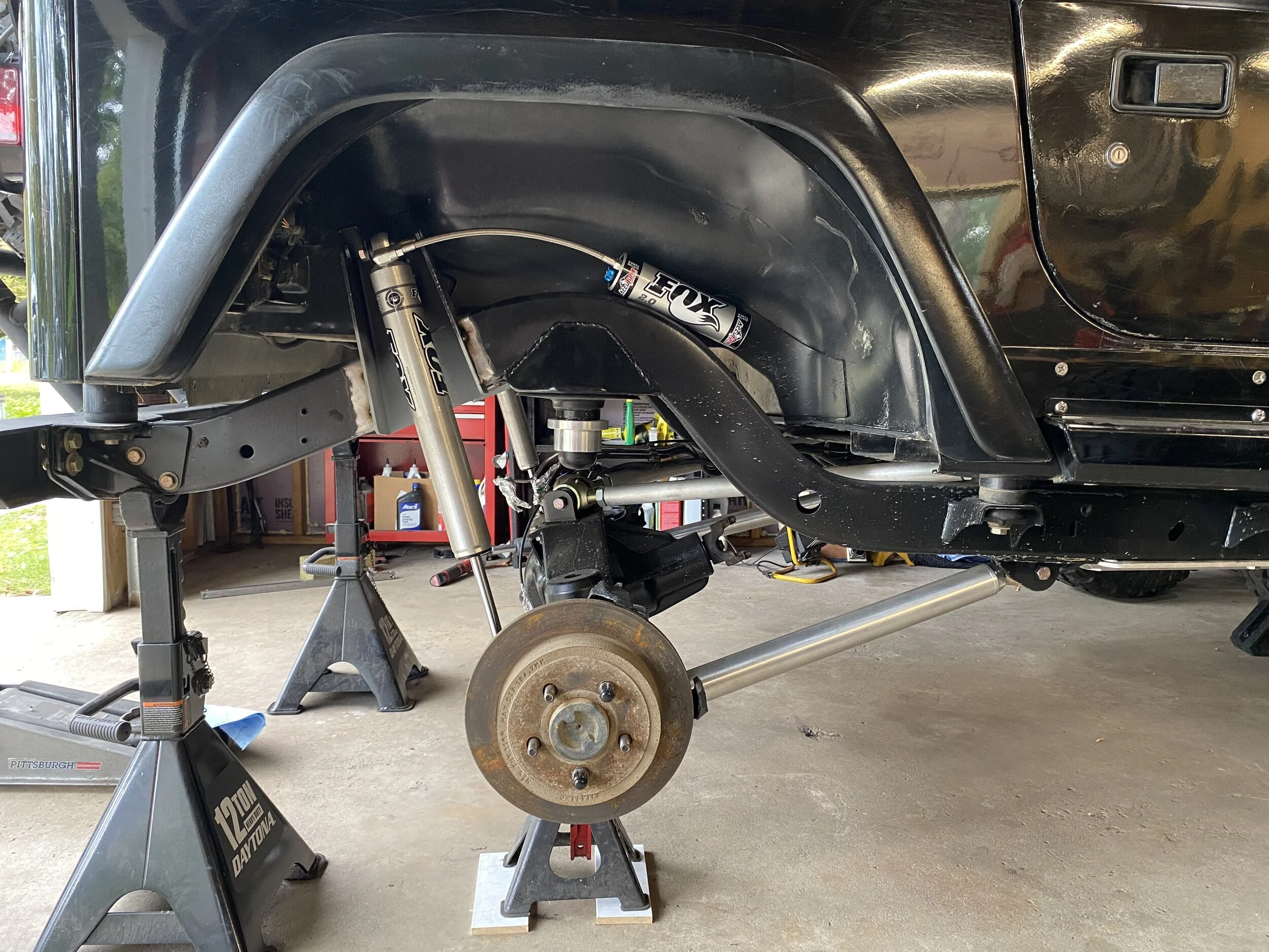

4.5" lift OME perches moved back. Suppose I'm doing that wrong.

What is the free length of the Old Man Emu 4.5" spring? Memory says they were fairly short compared to other options.
I wish I remembered. They went in last year.

In the interest of your success, it would be wise to measure the free length of your OME rear springs before you start cutting the frame.
Understand that the commonly suggested Currie/RockJock 4" rear springs have a 17.75" free length and that typically is barely seated at the full extension of a 12" Fox after an outboard where the shock is positioned at 50/50 from ride height.
There is a lot baked into that run on sentence that needs to make sense if you are doing a shock outboard.
I was wrong on the springs . I checked my orders and they are rockjock
CE-9131RH3P
- Spring Loaded Height = 13.500 in.
- Spring Free Length = 18.250 in.
