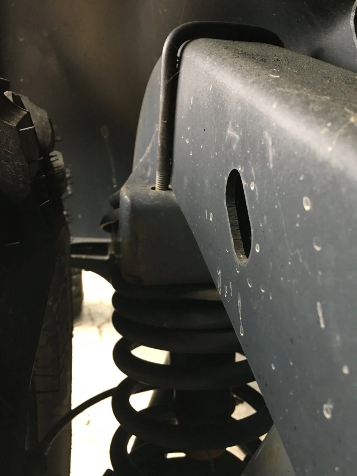

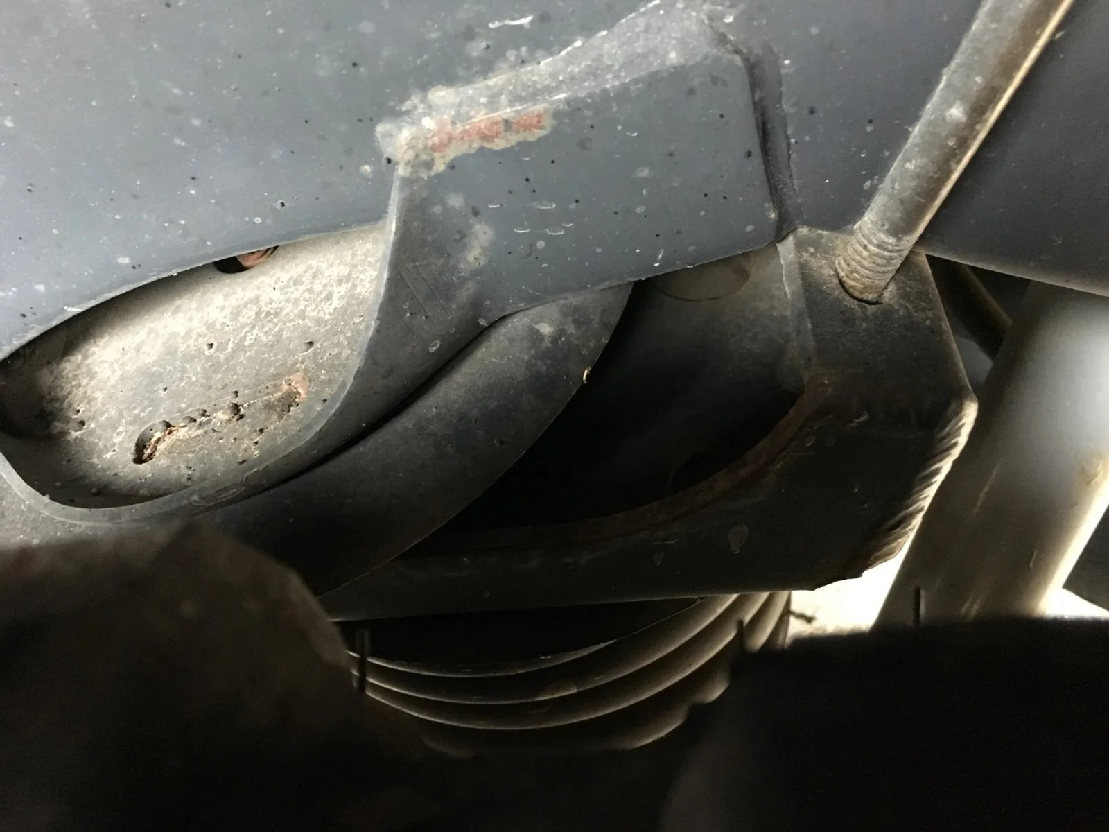

Chris, you might consider this bolt-on relocation kit. My Jeep has these and have had zero problems.
https://www.nthdegreemobility.com/rear_spring_relocators_tjlj_wrangler
View attachment 49094 View attachment 49095 Chris, you might consider this bolt-on relocation kit. My Jeep has these and have had zero problems.
Any idea who makes those?
One thing I've heard is that if I relocate the spring perches like this, I'll likely need up to 2" shorter rear springs since it will probably raise the rear a lot. Can you attest to this at all?
They’re made by Nth degree. Yes, you would need shorter springs. Not sure about the weld-on kits.
They’re made by Nth degree. Yes, you would need shorter springs, but that would happen even with a weld-on kit I believe.
Yep, I thought so. I may look at the OME 2" rear springs to pair with my 4" front springs. Though I'll have to put my 4" springs on temporarily and see how much taller the back is.

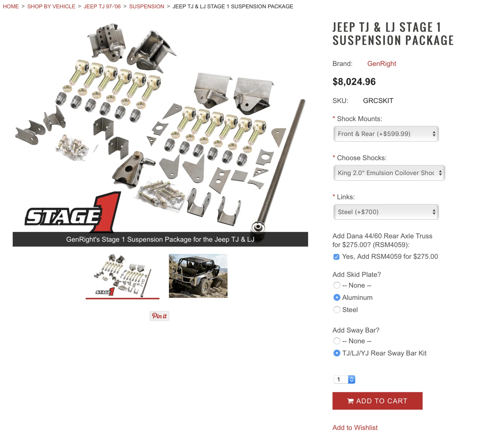

Maybe the better way to do it is to just outboard the rear shocks, ditch rear spring perches altogether, and run coilovers in the rear?
Hmmm
Decisions, decisions...
No kidding! I'd have to buy new shocks for the outboard conversion anyways. I figure that's about $200 for shocks, plus $120 for the rear spring perch relocation brackets, and then probably another $200 for new springs for the rear (since they'd need to be a little shorter).
I was looking and King sells coilovers for $599 for a pair... and those things are adjustable.
So all of a sudden (unless I'm missing something), it seems like coilovers might actually end up being around the same price... and they're adjustable!
Okay... I REALLY need to get off the internet. This TJ is like a child constantly pulling at my wallet.
