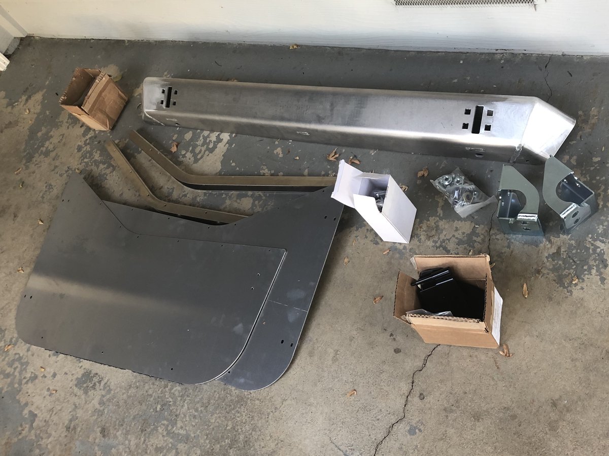

I opted to get the optional OEM style hinges on the doors but it looks like they don’t drill out for them like I expected. Not comfortable getting that straight and nice on my own, so planning to call them next week and have them ship out the standard hinges.
Savvy trying to bury me this week...
I don't blame you. I wouldn't want to drill holes either.
Is that a savvy rear bumper? It looks like d rings would go in the slots but I didn't know they had one like that.
Yeah that’s the Savvy rear bumper it came with D rings for the slots. They offer 2 bumpers.

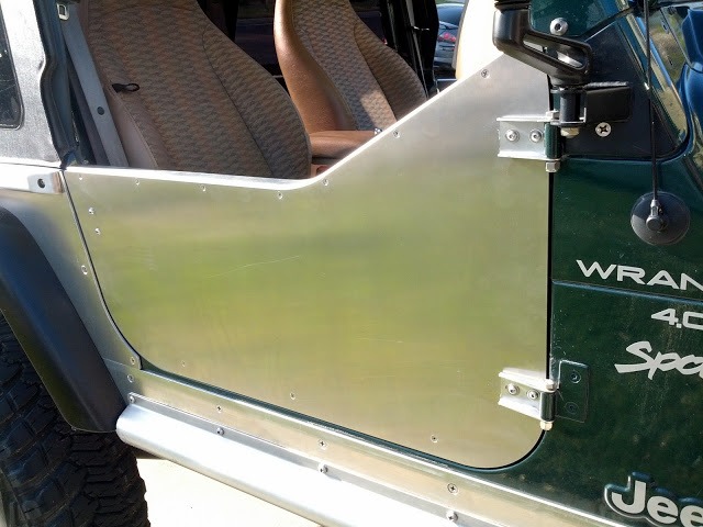

Does the standard hinge pin into the OEM hinge on the tub.
Correct, which is why I wanted them. But am not sure I am comfortable drilling the holes for hinges to get the door lined up.
I am planning to use them for trail doors and buy a set of OEM half doors for daily driving. But they have become so rare and expensive I don’t want to use the OEM doors on the harder trails.

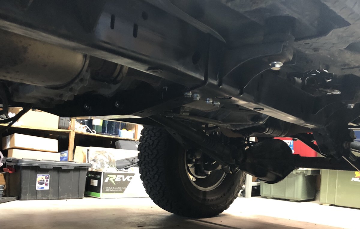

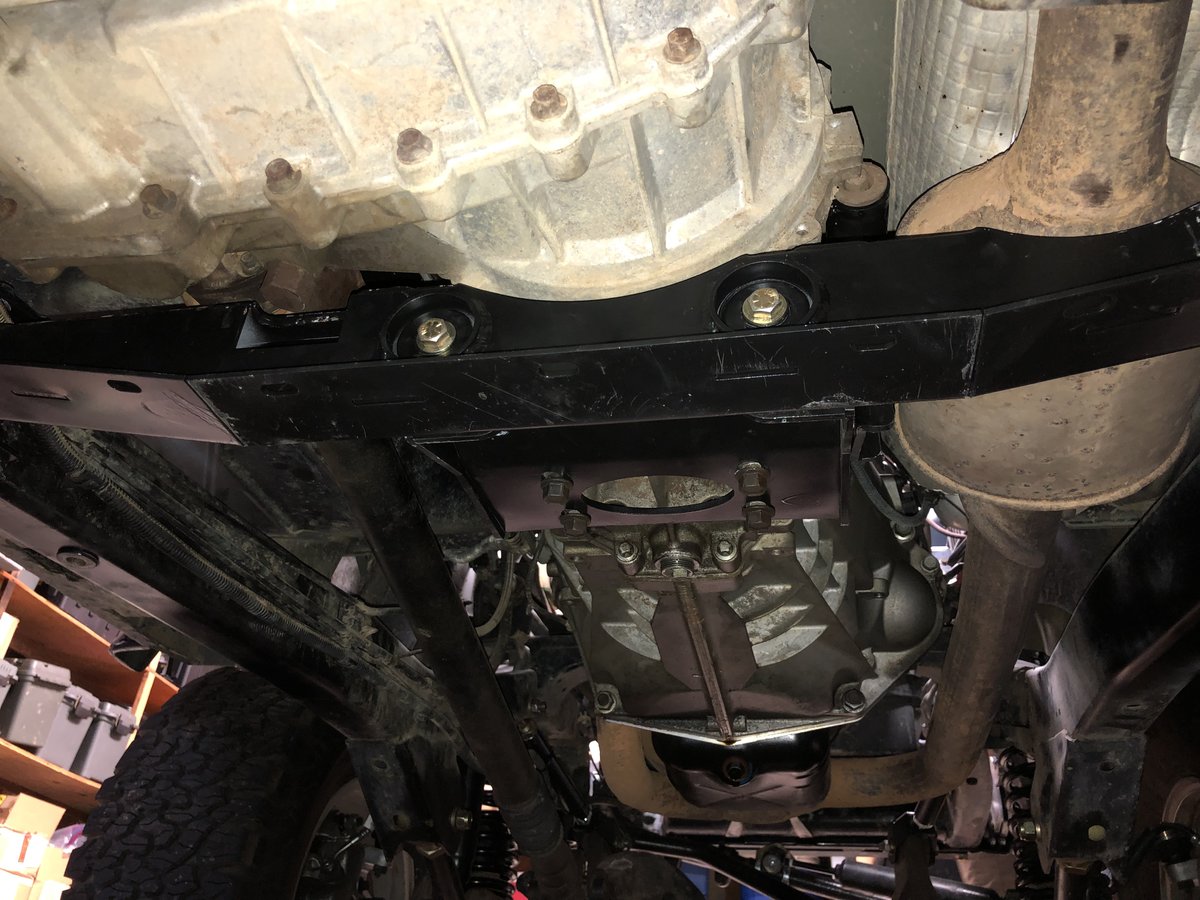

Some good progress today, I got the cross member installed. It took a lot of install and removing the cross member over and over but got it figured out.
Planning to order driveshafts tomorrow and work on relocating the air pumps during the week.

Tom woods or admas? Looks great. Did the rear brace fit (with the skid on) or do you need to get the exhaust moved a bit?
Was gonna do Tom woods. I did a very quick test fit and think the rear brace is going to fit. I will likely need to grind a small arc in it to help clear. But the brace appears to be lined up with pipe not the muffler.
It is only about 1/16” away from rear track bar though. So will definitely have to get the rear section worked on.

I have Tom woods F/R. They have been great and it's always easy to talk to them on the phone.
Funny how each jeep is different. Tom's 05 needed work of the muffler but cleared the TB fine. I wonder if the exhaust was changed 05-06 or if the manual vs auto were different.
It does seem like they are all unique which is part of what makes the forums so valuable.
Also I started mine up, and it was just a quick Idle test in the garage. But I didn’t seem to notice much more vibration then stock. Maybe a tiny tiny bit. Maybe it will increase once I bolt the rest of skid on and set pinion angles and take it for a drive.
I know Tom was dealing with idle vibration problems. It will be interesting to see what type of NVH issues, if any I deal with as it was a major concern of mine when deciding to go with the Savvy skid.

The end is in sight. The pump relocation shouldn't take to long. On Tom's I cut a section out of his OEM front bumper to make a bracket and attached it to the Abs Tray with a few bolts. It's easier just to pull the tray, mount the pumps, and hook everything up if that's the location you choose. Don't forget to take the extra time to add dielectric grease to the sodered connections before sealing them with heat shrink.
I had a hell of a time lining up the engine skid. I recall telling Tom I thought it took more time than the tuck lol.
