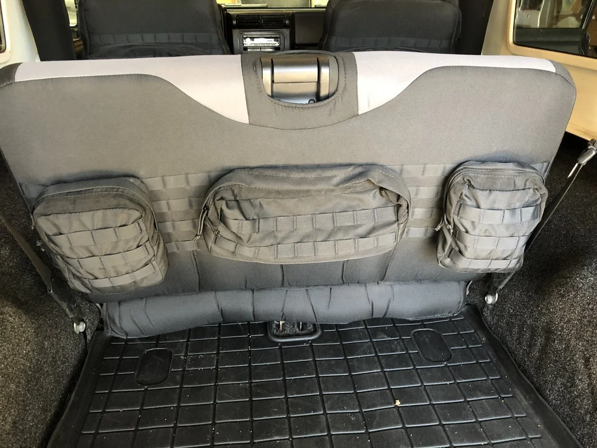

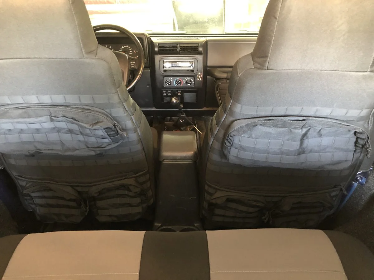

Added a ton of storage pockets to my bar tact seat covers excited to have places to put a bunch of little things on upcoming trips.

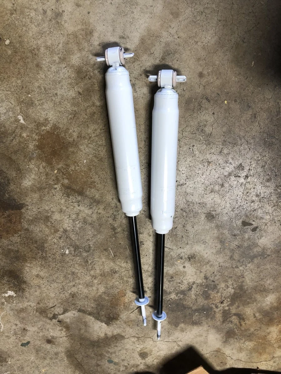

New shorter front shocks arrived need to get these painted.

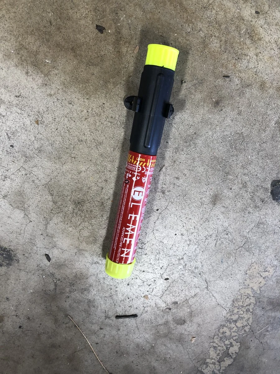

Also I decided to go with Element fire extinguishers I am planning to put one at drivers feet and one in the back somewhere. Still working on mounting locations.
