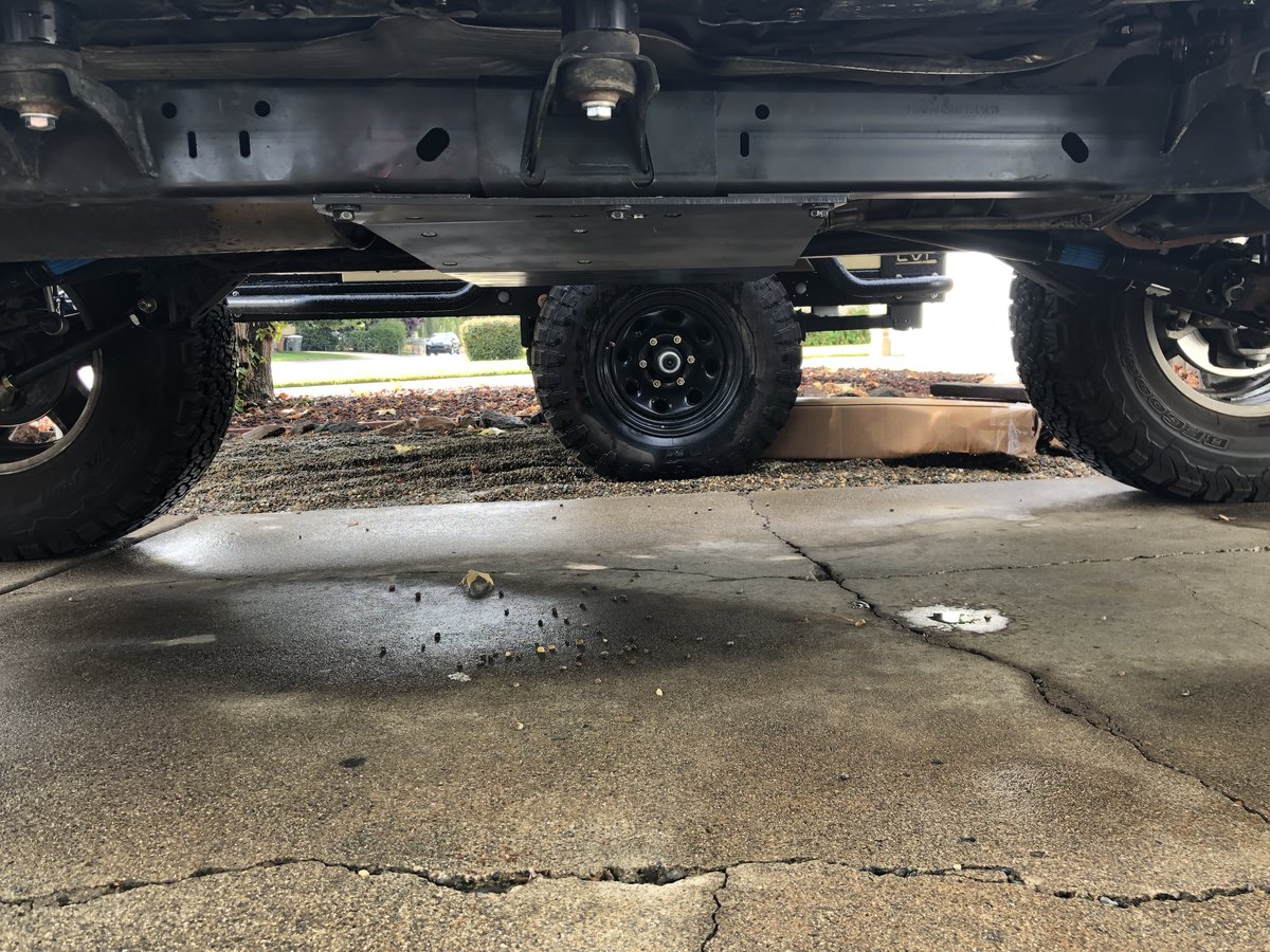

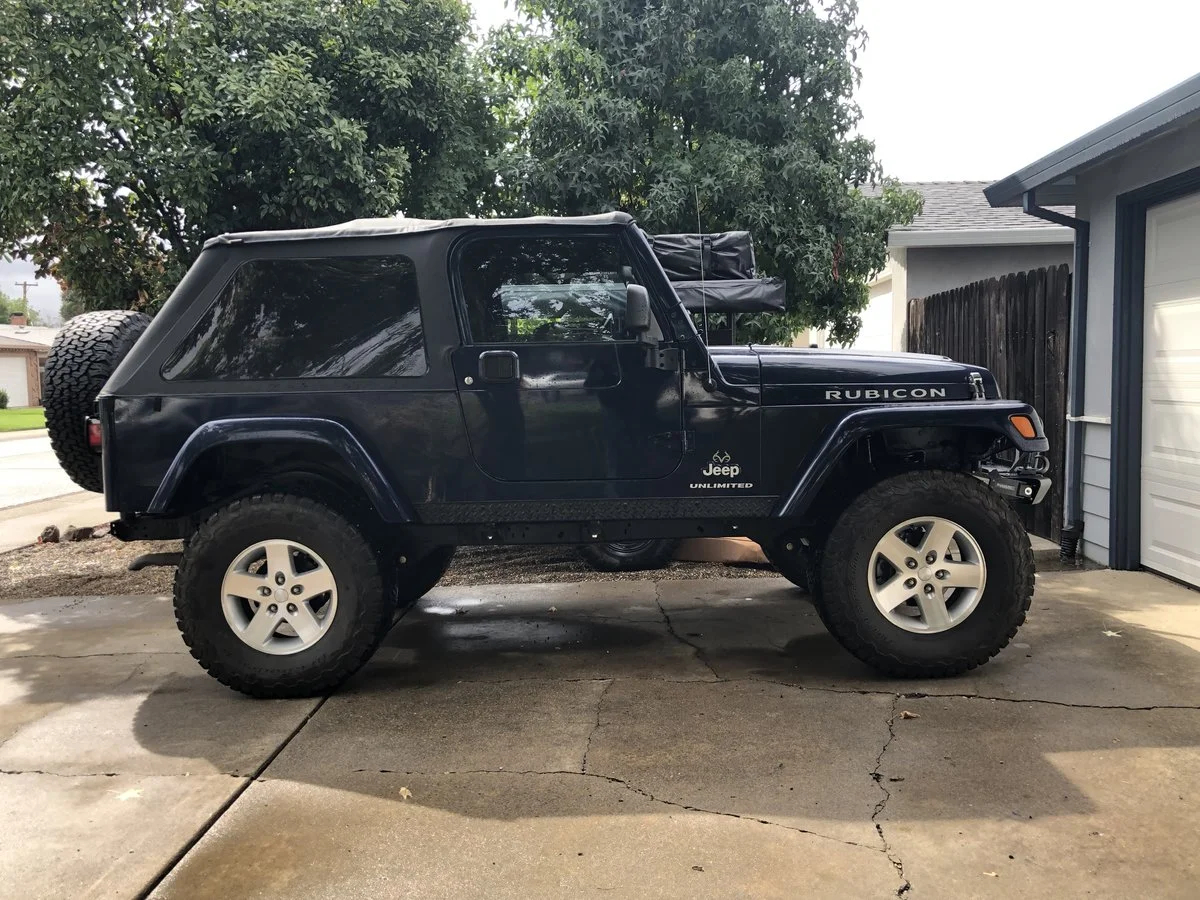

OK finished relocating and installing the Savvy Under Armor, and recreating the air pumps this weekend, also installed my new Front and rear drive shafts.
Here's a photo of the skid and jeep now. The extra clearance gain really is crazy.

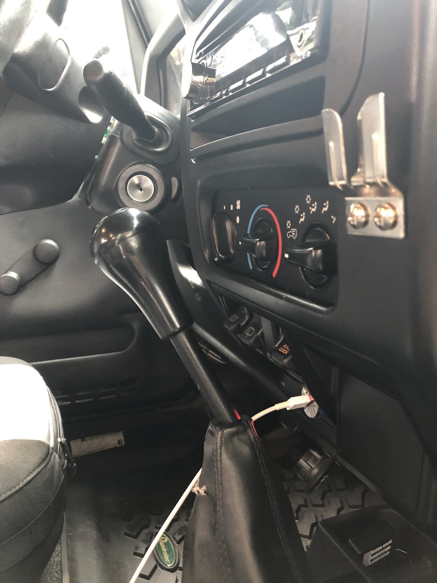

- Increased shifting height inside to where my hand slightly touches AC controls while shifting (probably can live with this one just have to get used to it, or get a new shift now/bend shifter)
.View attachment 115578

Got the Gas tank skid installed today.
Dialed in the front a rear pinion angles so they are exact. Don’t think I have anything I would call driveline vibration anymore. Just the small increase I am getting in NVH from the stiffer crossmember bushings.
Here is the clearance gained from the tummy tuck and the gas tank skid. These are single measurements from the lowest point I could find on each and does not tell the whole story of how much clearance I gained.
17 5/8” - 19 3/8” Gas Tank Skid
16.5” - 19 1/4” tummy tuck
I also did the splash back mod while it was apart and mine was frozen so it will be nice not to get gas all over my shoes every time I fill up.

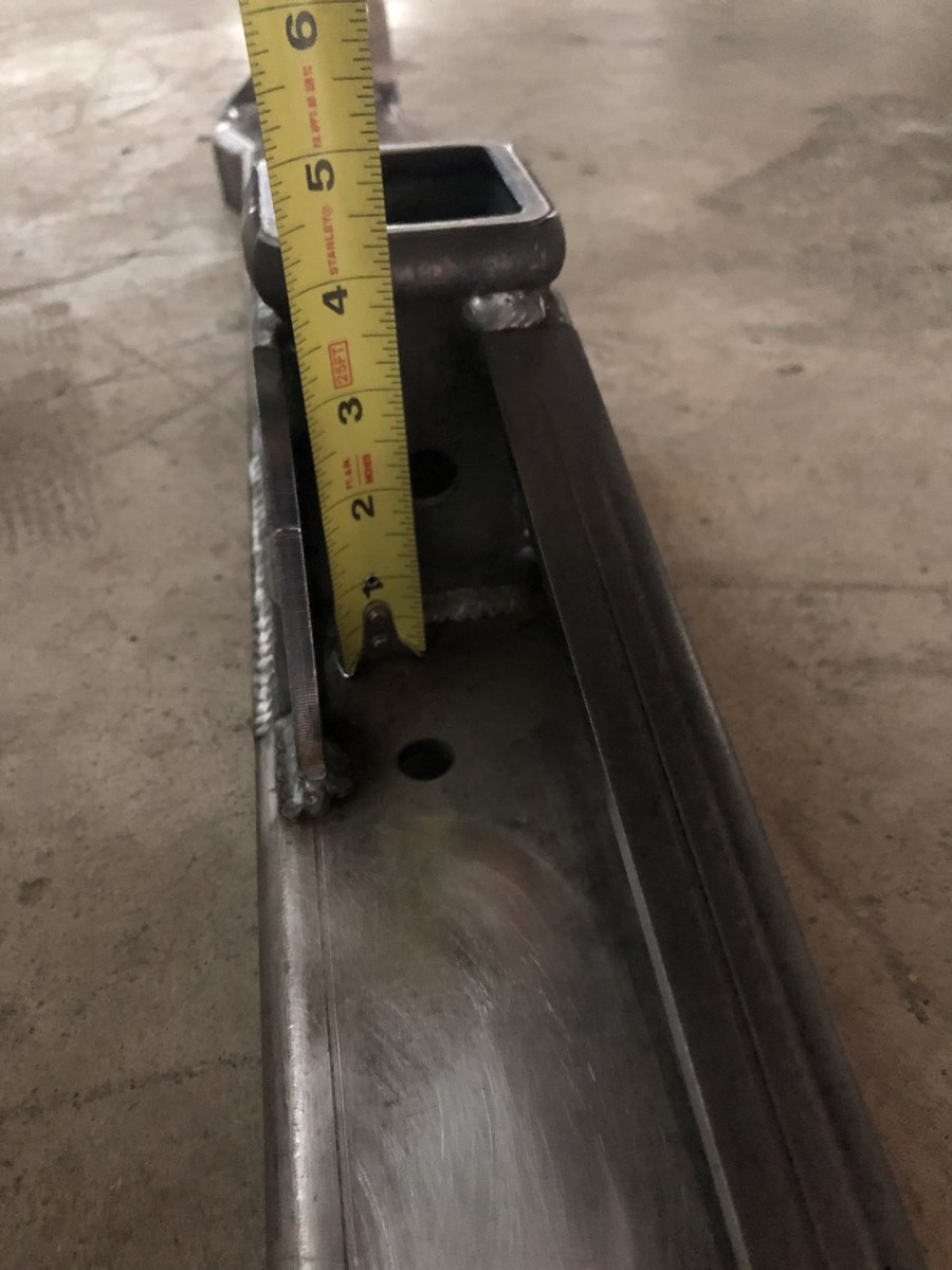

On the Next Venture bumper, how far does the hitch receiver stick out from the face?
That bolt hole on either side of the receiver is good to see. I didn't know they were there.
There is 8 across the front. 4 sets of 2
Stock one underneath.
And the frame tie in have 3 per side that go into the frame, and the 2 that tie into the bumper.
So 16 bolts total.
That’s funny I didn’t notice that either until you pointed it out.
So 10 across the front
2 on bottom
And 6 for frame tie ins.

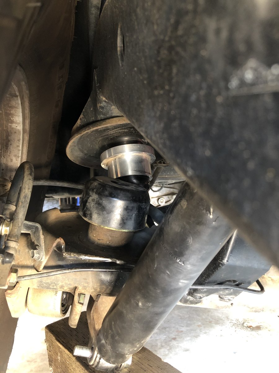

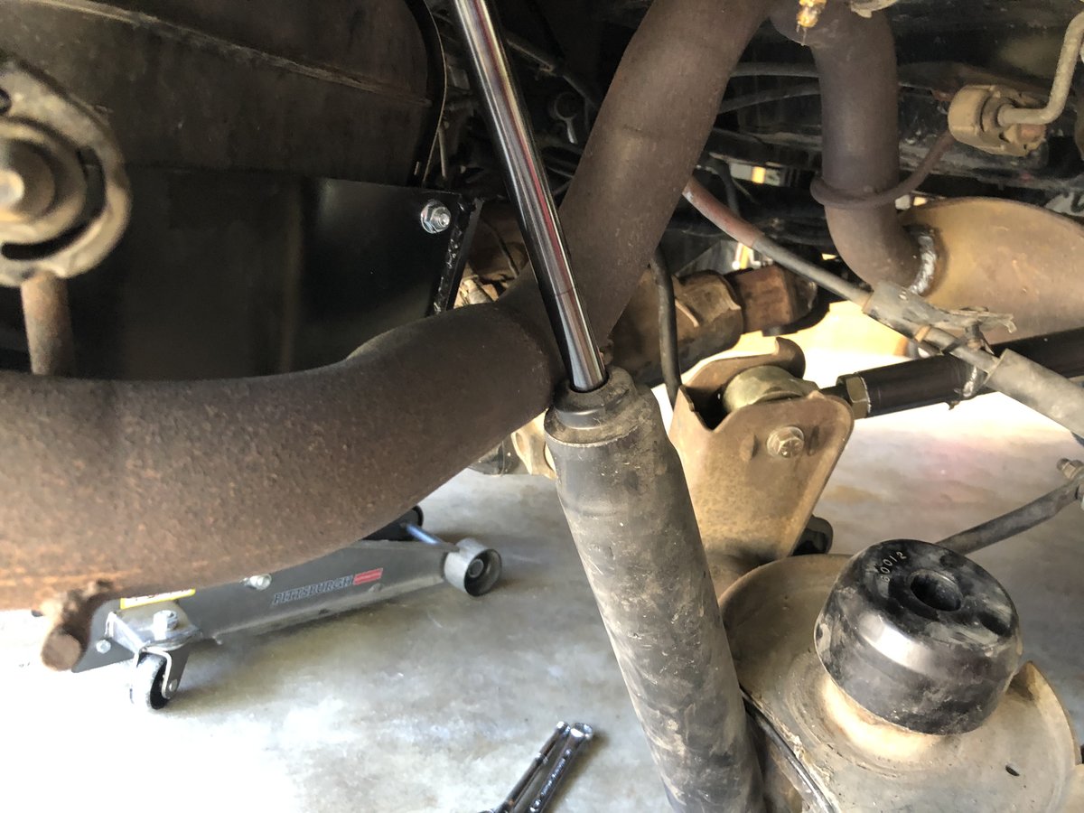

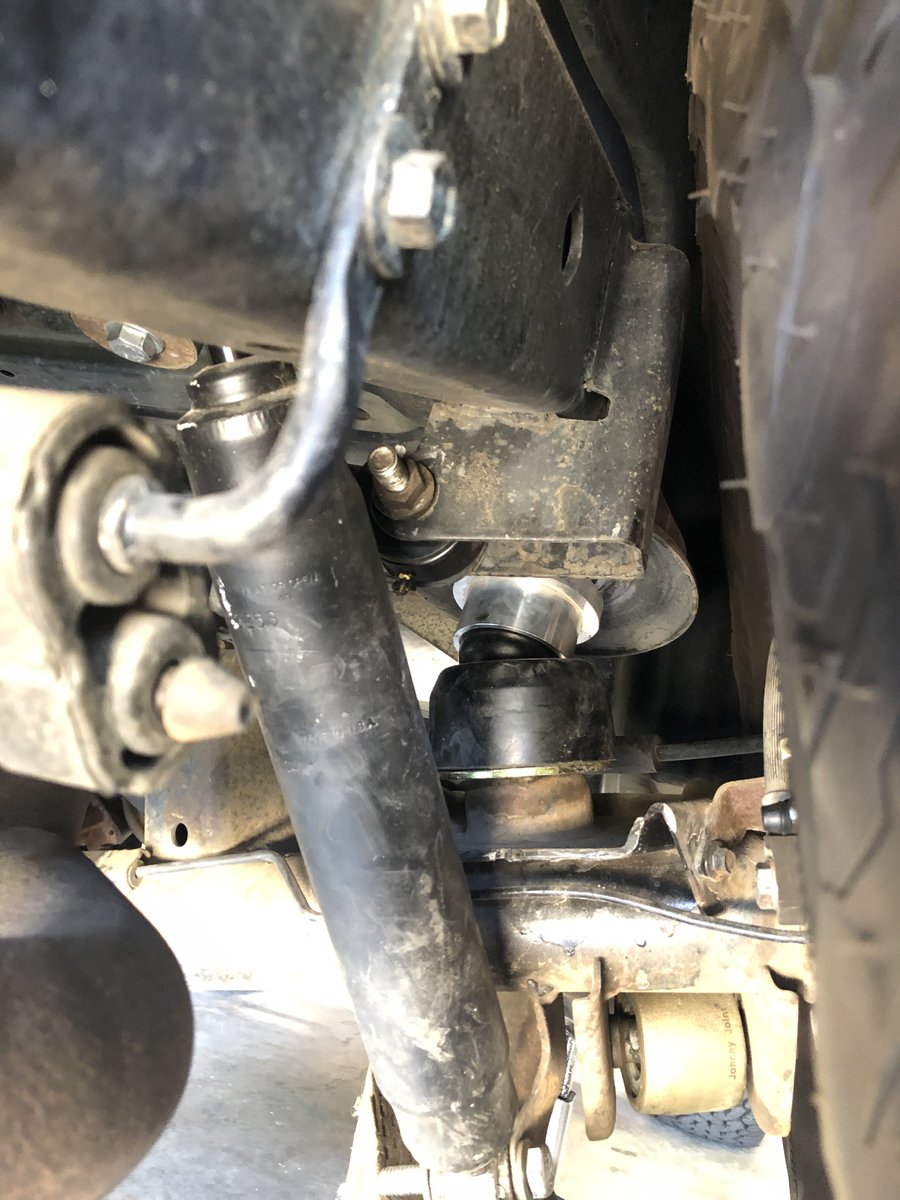

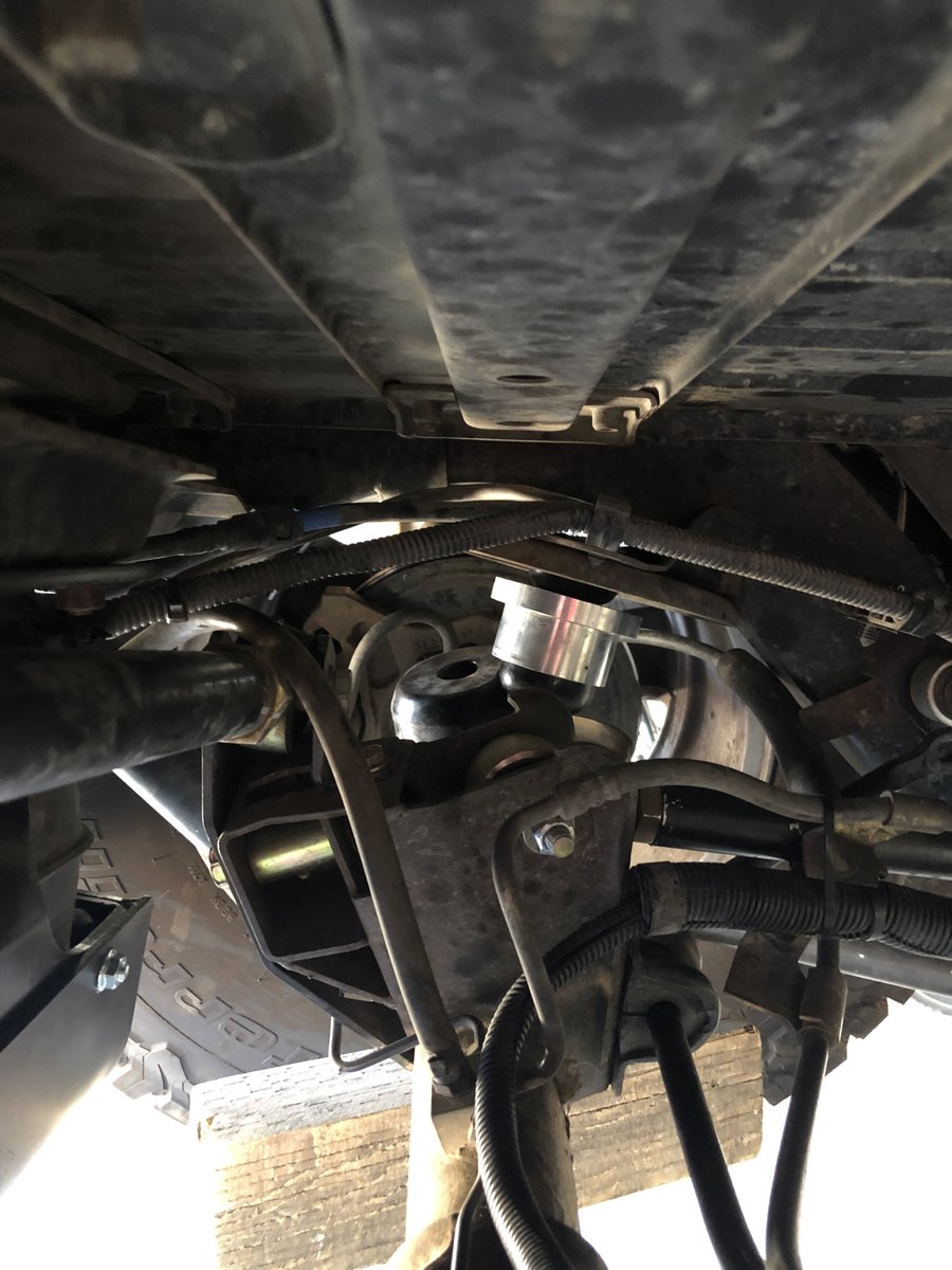

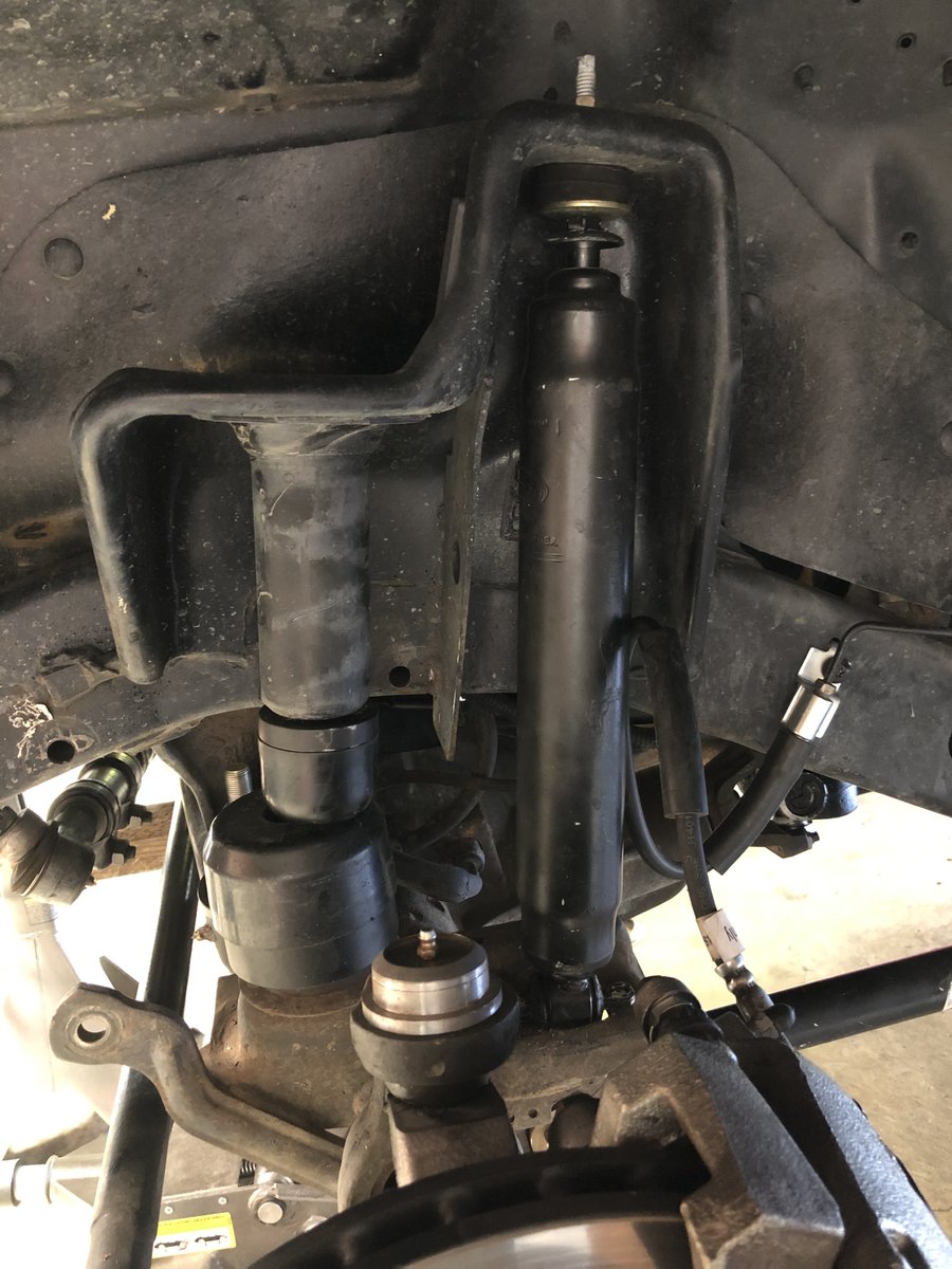

Spent the day cycling the front and rear suspension.
Get a bit of rubbing on back of the wheel well at full bump. Not sure it’s enough to damage anything but maybe. Problem is I don’t think adding bump will help with the way the currently line up they don’t touch well. It sort of looks like I might need to relocate upper spring perches one day.
Track bar just barely touches the gas tank skid at full straight bump. Tiny bit of grinding should fix that.
Shock body just kisses the spring perch and exhaust and full flex. I think this will be ok.
Much bigger problems in the front. It believe I simply don’t have enough offset in the front.
I have JK rubicon wheels which have 6.25” backspace and 1.25” wheel spacers.
This puts me at 5” and it’s simply not enough.
I added 4 washers to steering and still rub. And worse then that once I cycled the suspension at full flex the inside of the tire rubs a lot in the shock tower. So there is zero steering available at full flex.
I am going to start another thread and see if anyone knows of quality 2” wheel spacers or if they are even recommended or if I am going to have to start thinking about new wheels.
@jjvw weren't you looking for 2” spacers for JK wheels?
In addition to that my front shocks are slightly too long. I read many people say the 5000x seem long for recommended lift heights and that seems to be the case. There a tiny bit too long at full droop and a bit to long fully compressed. Looks like the next size down will work perfectly for me.
Photos are just of bump stop alignment and available shock travel at straight bump. I had somewhere to be and got in a hurry and forgot to take the other photos.
I would flip the rear shocks so the body is up. How much up travel is there from ride height to full bump?
I thought twin tubes cannot be run upside down? I could be wrong.
there is 6” of shock showing at ride height and at full bump about .5” of shock showing. So 5.5” up travel.
I need to add probably .5” of bump to keep the tires from touching in the back. But I don’t think the bump stops long up well enough to do that.
Reactions: DrDmoney
You are right about twin tube shocks, the don’t work the same upside down.
Reactions: Midnight LJR
It doesn’t seem to me that you need a shorter shock if you bump out with a 1/2” left, you don’t want the shock to be the stop in the uptravel, what is the overall stroke?
