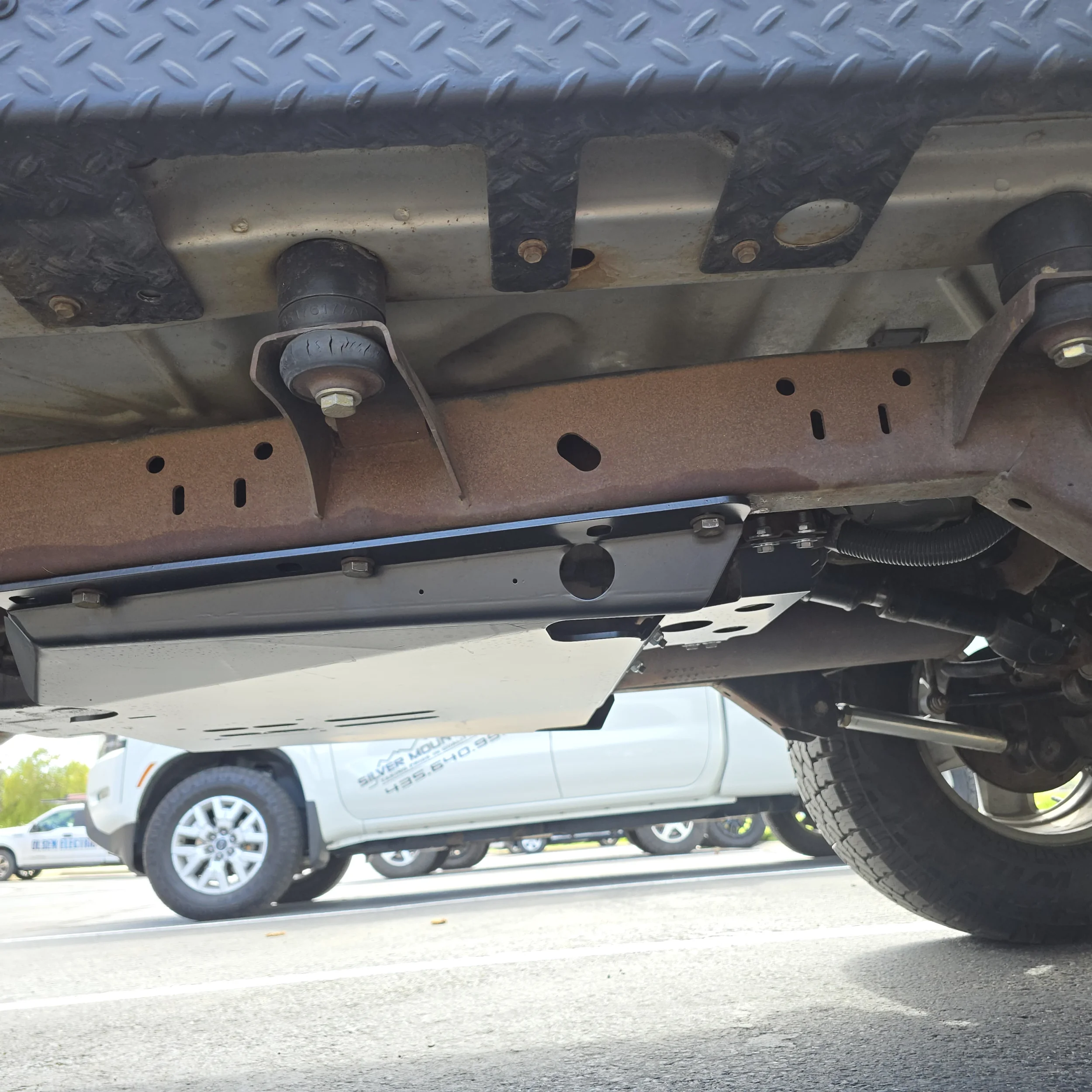

So when I did my body lift, I added spacers to the motor mounts to lift it accordingly. Fast forward to the belly lift I just did. My pinion angle (DC shaft) has been adjusted for the new angle, but getting vibes (mostly accelerating at 30MPH and noticeable at speeds beyond.) and since the belly lift brought the angle of the motor back down nose-wise I am wondering if I may need to add more of a MML to regain the angle of motor/trans/TC that I had before the belly up. The Tereflex skid came with spacers and I am wondering if it is feasible to stack spacers by adding them to the existing ones (JKS)
Does the 1.25 Body Lift + Belly Lift require higher motor mounts, or am I overthinking this? Over next weekend I will be peeking at u joints to rule those out as well.
For data sake, adding the new skid brought the nose down to the point the fan was hitting the shroud, so I dropped the shroud slightly.

If the belly skid lifted the transmission mount, then it would make sense that the engine should also be lifted to flatten out the rear output.
That was my initial thought as well. The lifting of the tran mount caused the motor to pivot forward and down, and making the driveline angle that much more extreme compared to the pinion.

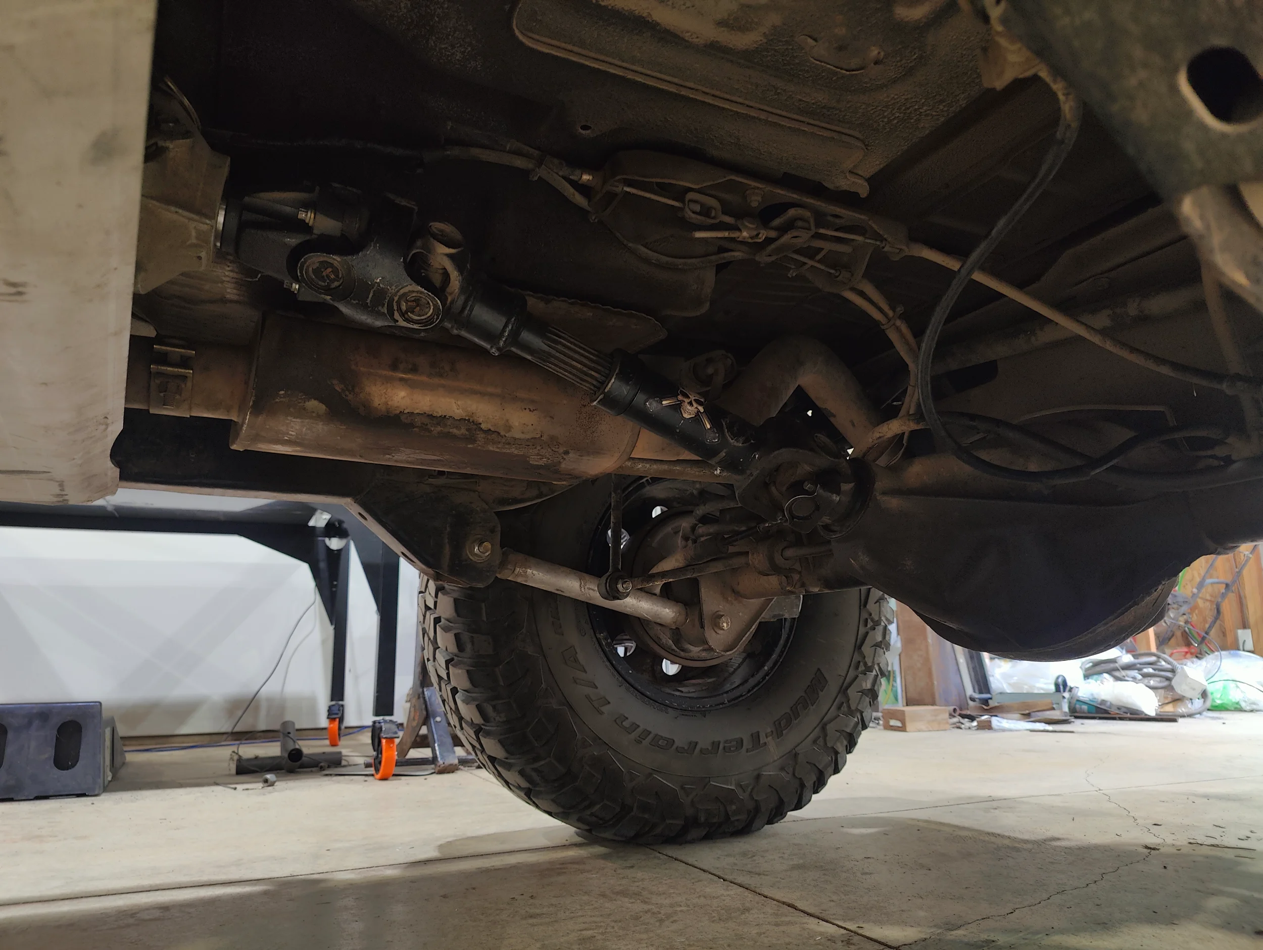

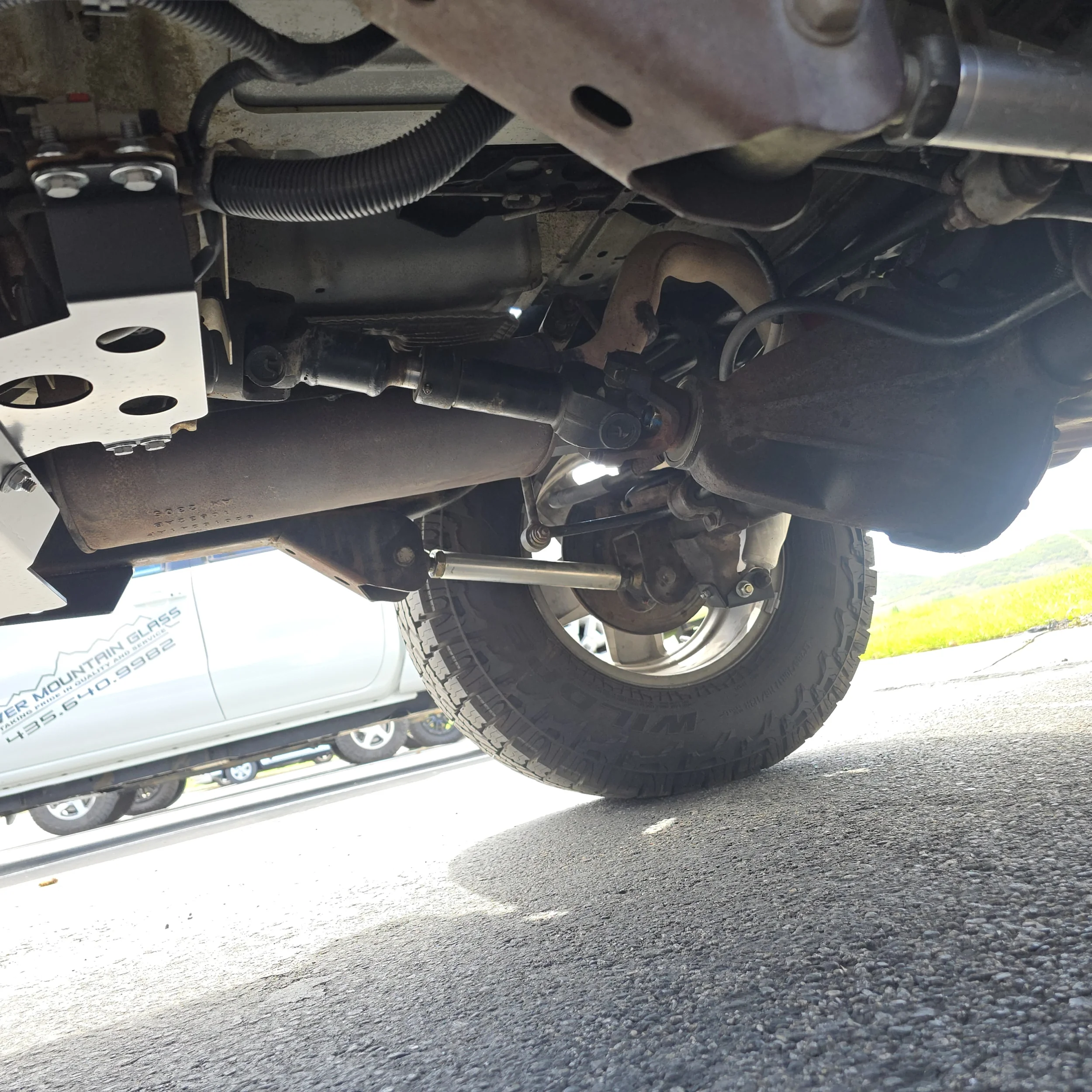

Let me know of what specifically you'd like a pic of

Pinion angle looks high in the picture...but that could be the angle of the shot...
It's currently at 0 degrees. Double/triple checked with digital gauges. Went off the flat back of the gear housing and the DC shaft straight section. I started testing at 3 degrees, and dialed up to 0 in half degree increments.

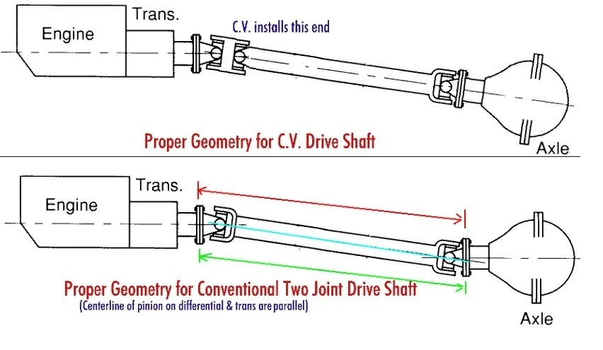

Rear pinion generally should be slightly low so that it stays closer to zero on the highway when the axle is under load. Odd exceptions do exist, though.
