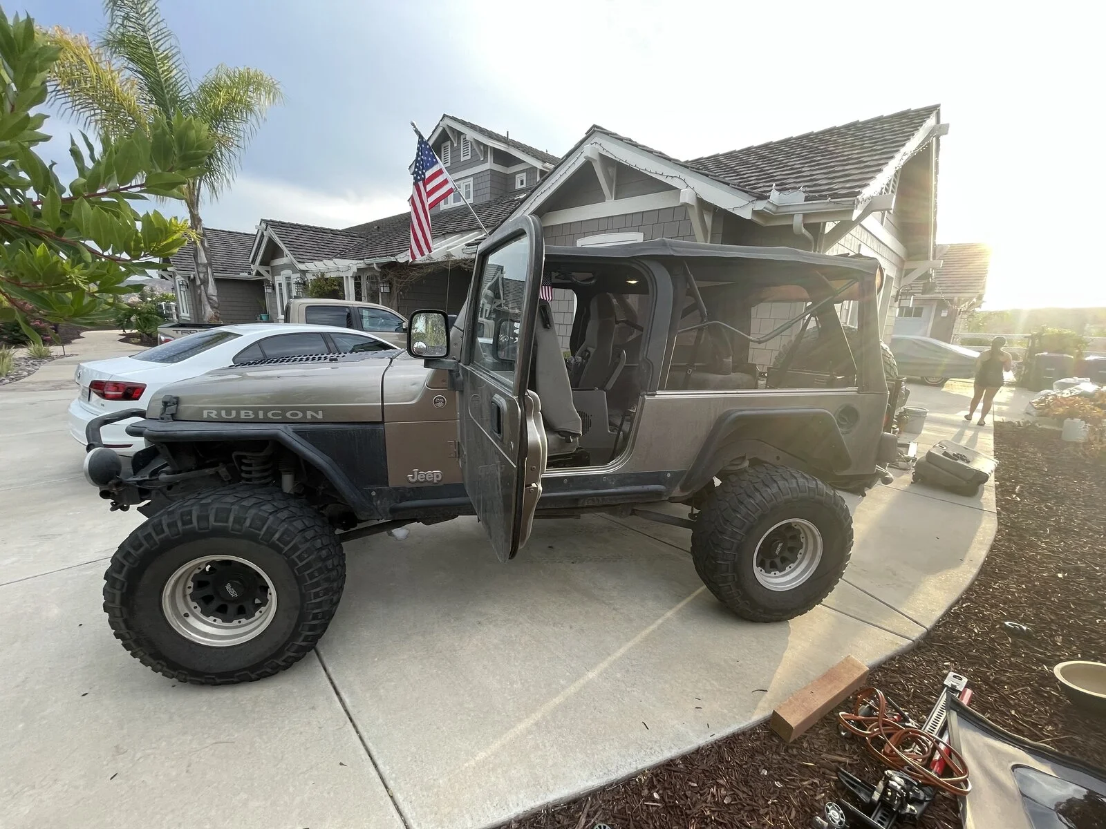

I came across this on the Facebook Marketplace. After talking with the owner since the 10th of August I bought a one way ticket down to San Diego.

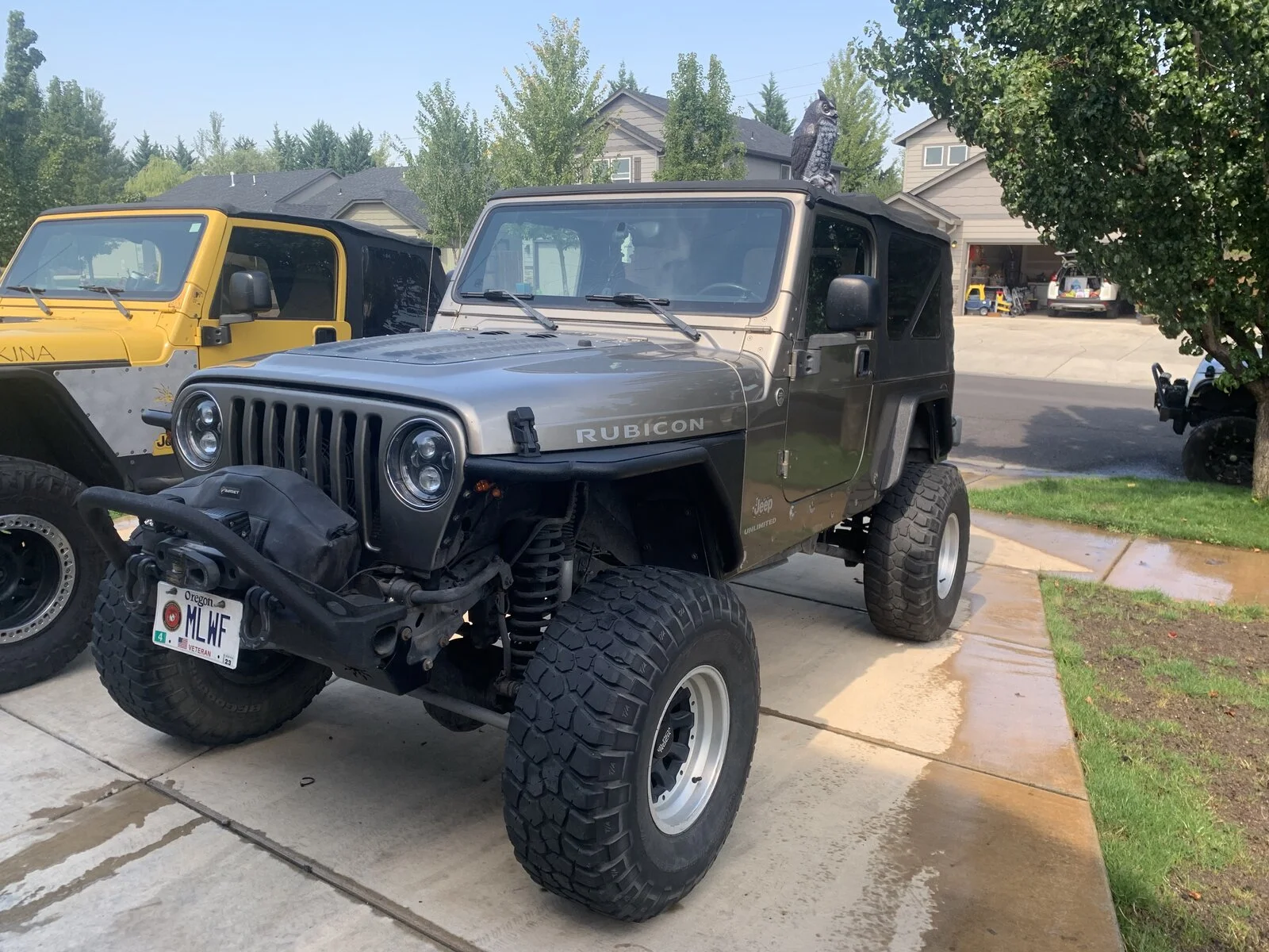

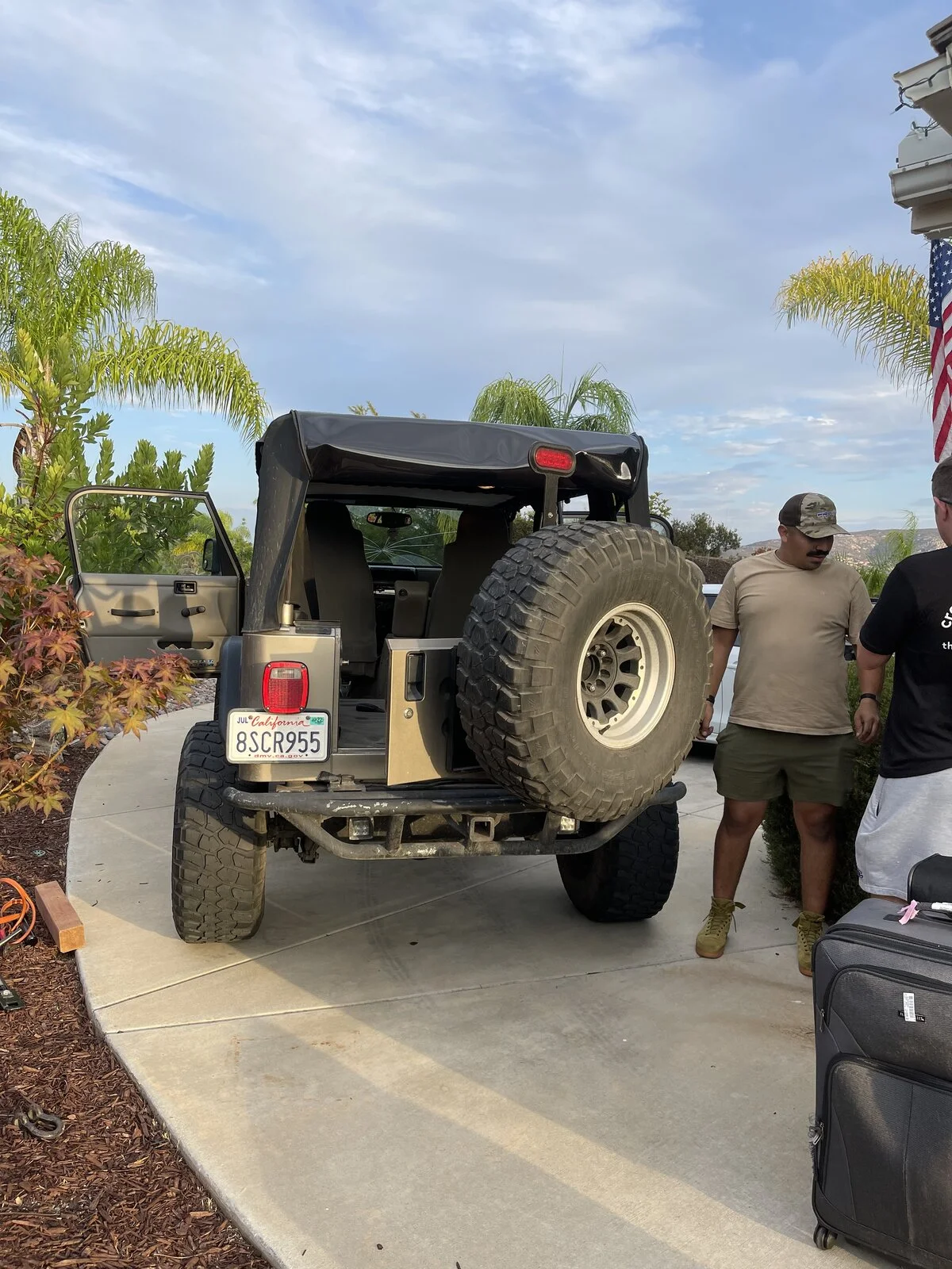

I’m now the proud owner of a 2006 LJR with 6 Speed Manual. She’s not perfect nor a blank canvas by any means but I see it as a new challenge to build it the way I’ve been picturing it since we began talking.
It’s currently on a unknown brand long arm lift with Rancho Air Shocks, Moryde Tire Carrier, Truck-Lite Headlights and from what I can tell Smitty Bilt Fenders, Sliders and Bumpers with 35” Tires.

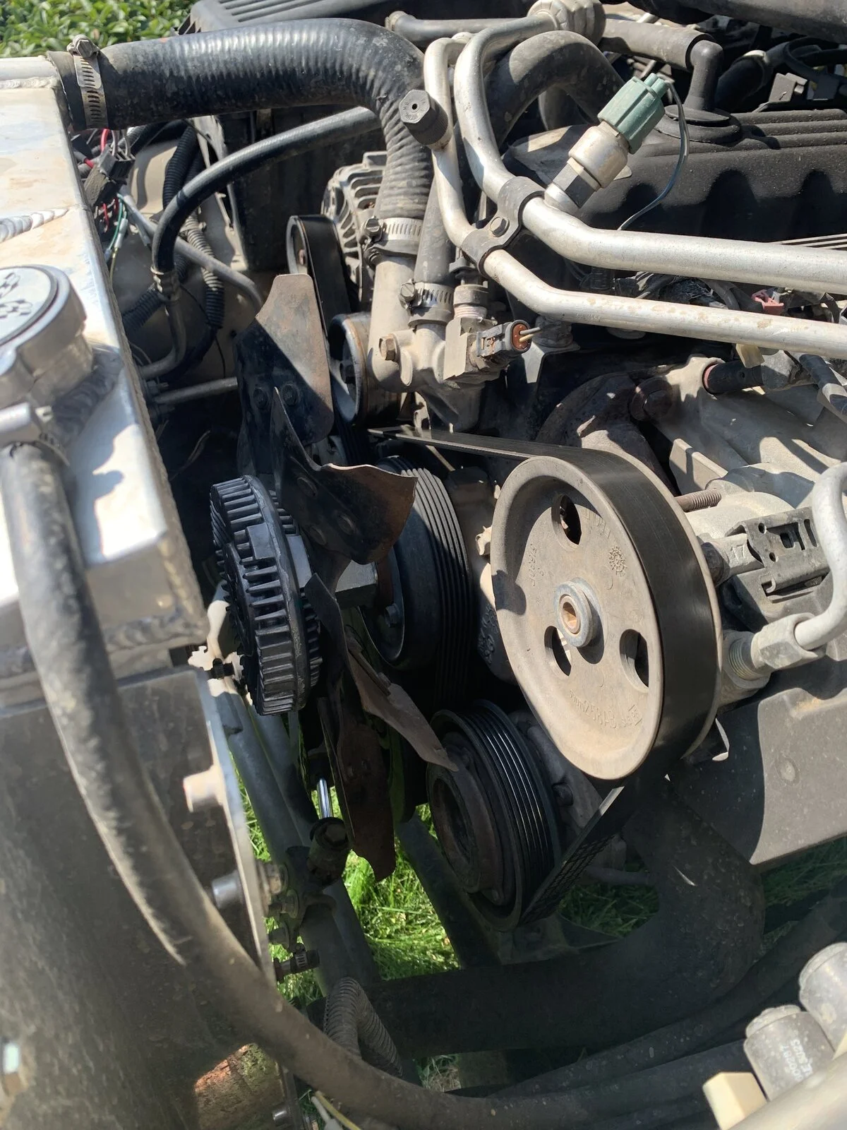

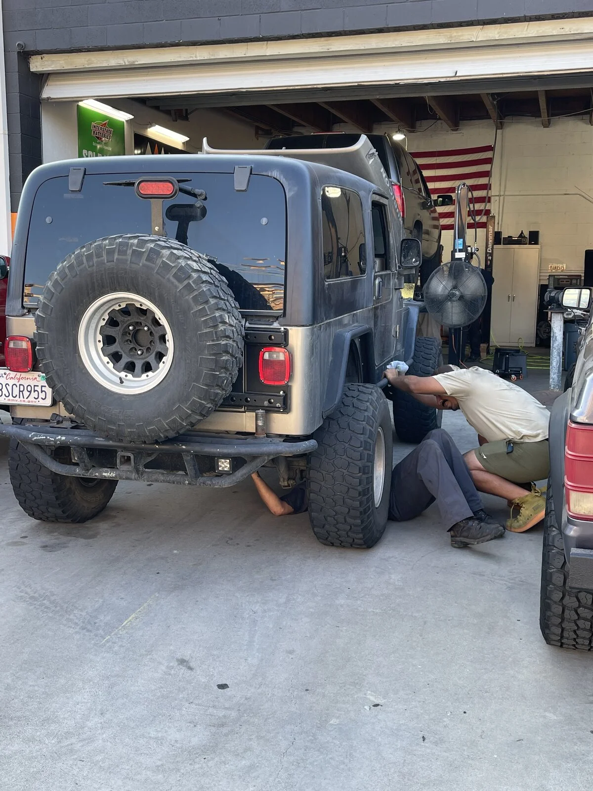

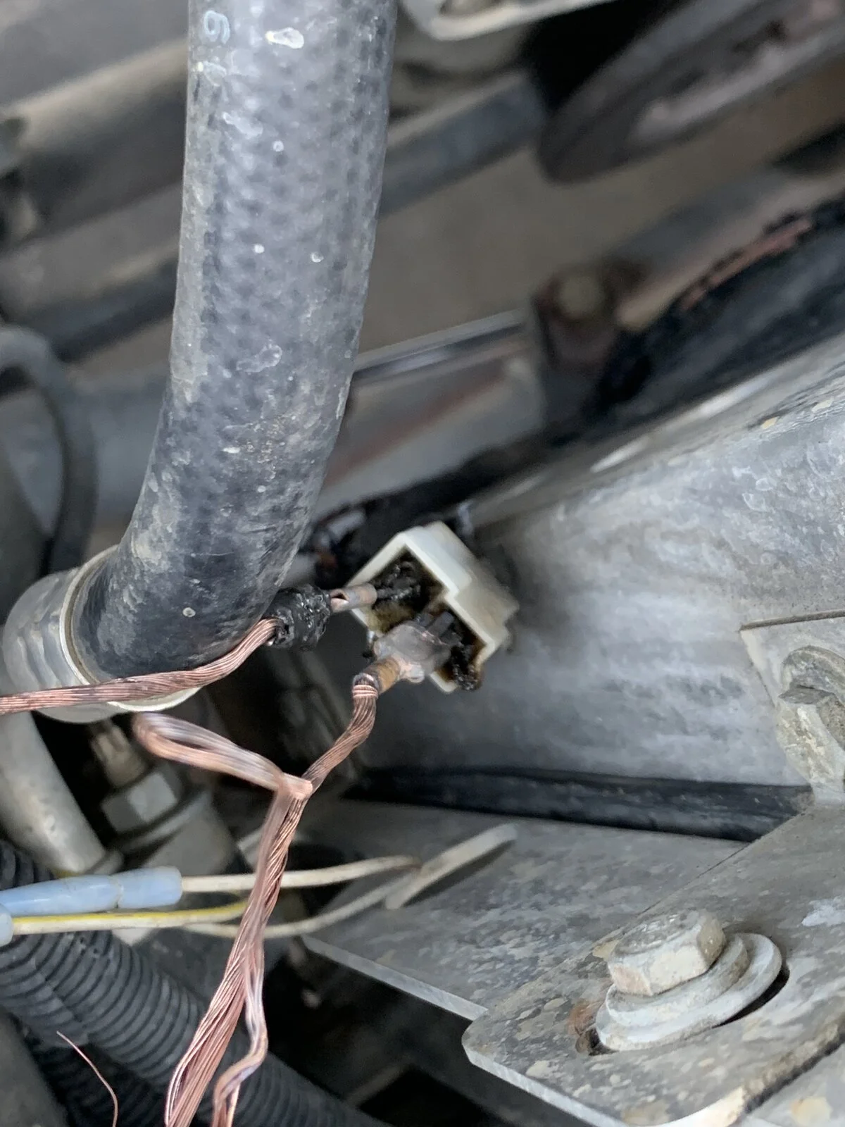

2 hours into the drive in Sylmar, CA just North of LA on I5 the Jeep began to overheat. I pulled over to the side of the interstate and pop the hood. At a glance I saw the wires to the electric fan/aftermarket radiator were up against the radiator itself and had melted the insulation exposing the wires to each other. Funny, I had planned on getting rid of the fan/radiator set up and opt for OE when I returned home. Guess the rig wanted me to do it now.
*Note, another reason to stick to a mechanical fan.
I let it cool down while weighing my options as it was Friday afternoon. Luckily out of all the places to break down I found out there was a Jeep 4x4 Shop called Mazzotti Auto just a few minutes away right off the Interstate. Once it was cool enough I turned it on and drove the rig over quickly. From there I spoke to the owner Josh regarding the situation. We quickly set a plan in motion and had ordered a fan clutch to be dropped off immediately though realized there wasn’t a TJ Fan Blade in stock and couldn’t get one in until tomorrow for the steep price of $150ish.
Well Josh went up and looked around his parts bin and found a couple of old fan blades from God knows what vehicles and lucky enough one of them managed to work while the other had a clearance issue. We got it put together, threw some water in and back onto the road! I appreciate Josh’s time and patience given the situation all the while he has his shop full of vehicles getting work done when I had originally pulled up.

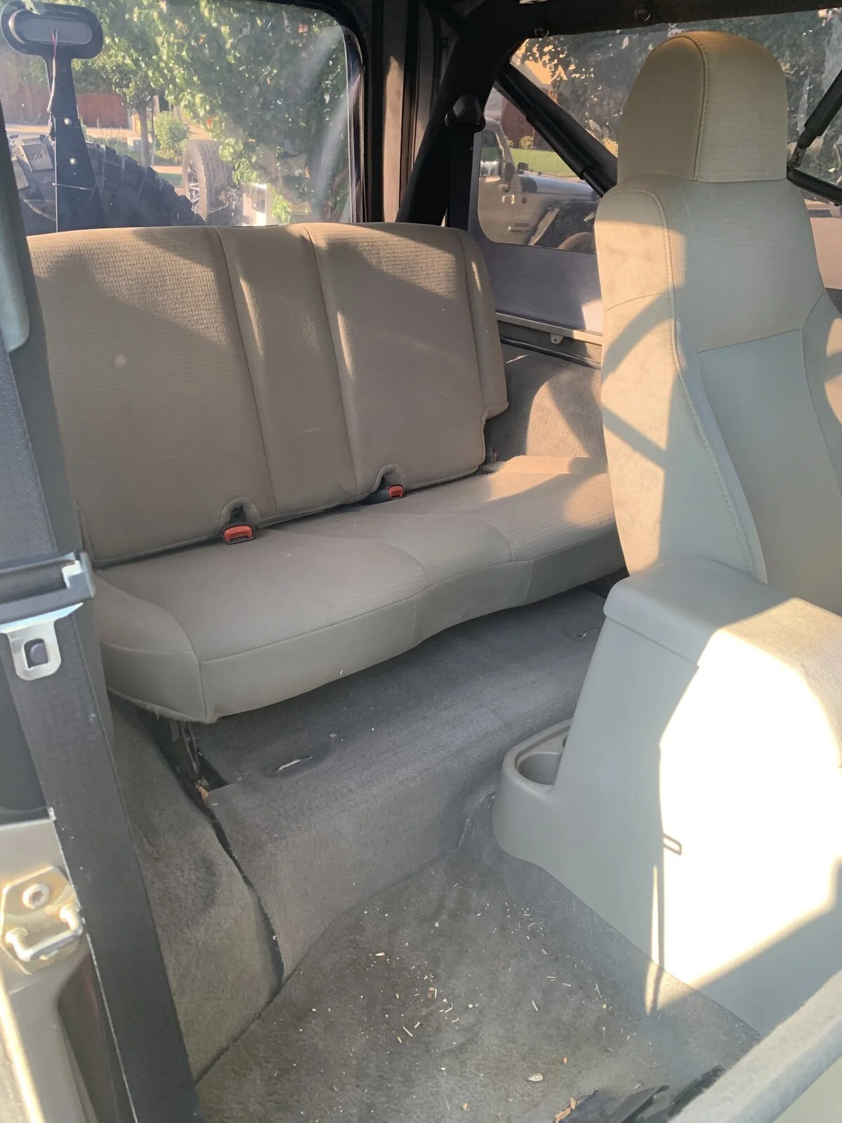

The interior is in near immaculate condition! The rear tire carrier was upgraded to the Moryde thus saving me spending the money to carry my 35” Spare Beadlock. New CA Compliant Magna Flow Mini Cats we’re installed. I also noted these brackets bolted under the Engine Mounts which make me believe this had a tummy tuck or at the least a skid plate installed. I’ll be switching my Terraflex Belly Up Skid Plate and will look into incorporating these brackets to avoid mounting the oil skid to the Engine Block. There’s also the GenTex Mirror with Compass, Temperature and Dome Lights that I’ve seen mentioned within the forum. Really is a nice touch for our Wranglers!

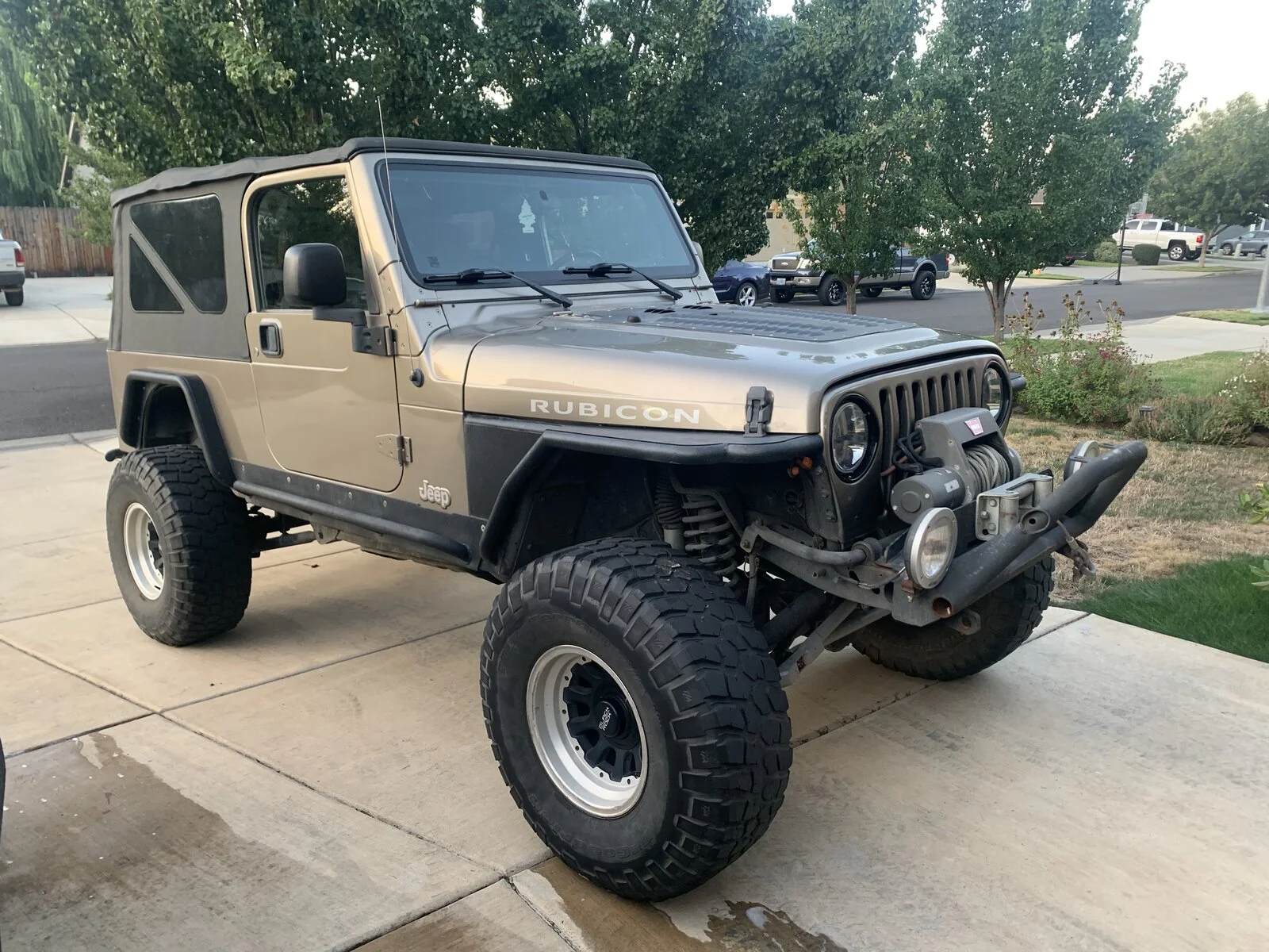

Removing the front bumper was a hassle. At some point one of the previous owners decided to tack weld all 6 bolts onto the winch plate/bumper. Once the welds were broken and with the help of my oldest son (6 year old) we started off by swapping over my Poison Spyder Bumper and Steering Skid alongside my Warn 9.5 CTI winch with Accessories over to the LJR. Then followed it by switching over the MORE 1” Body Lift and Ordered a 1” MORE Bomb Proof Motor Mount to go on before following it up with the Terraflex Belly Up Skid.

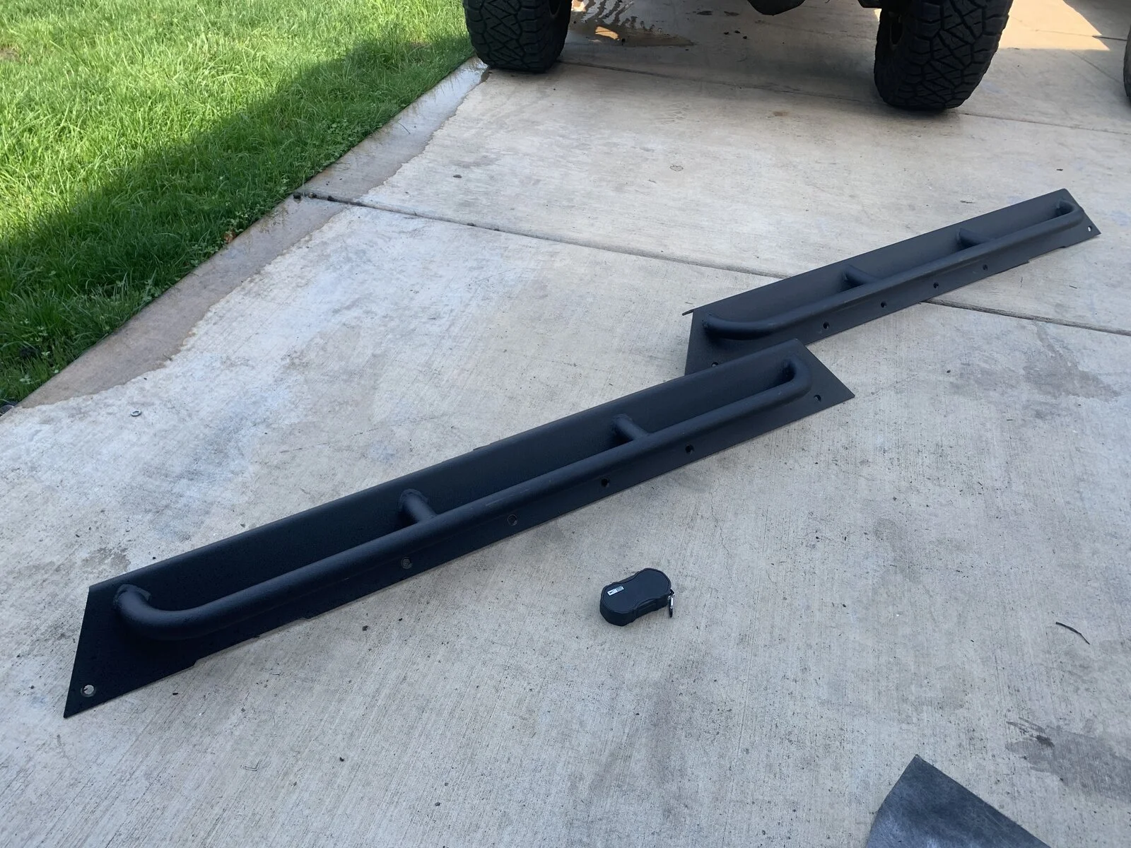

I left the Smittybilt Rock Sliders off for now as I’ll be replacing that alongside the front and rear fenders for a complete package (exception of front and rear bumpers) from Nemesis Industries Aluminum Armor in the near future.

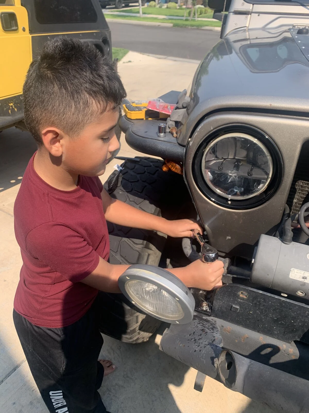

We ended it by doing a 3 way headlight swap due to my wife’s old Pro Comp Headlights hazing/cracking. I gave the Trucklites off my LJR to my wife’s JKU, threw on the JW Speakers from the TJ to LJR and left the Pro Comps on the TJ. I’m actually talking to Pro Comp now since they supposedly can warranty them at no cost to me.

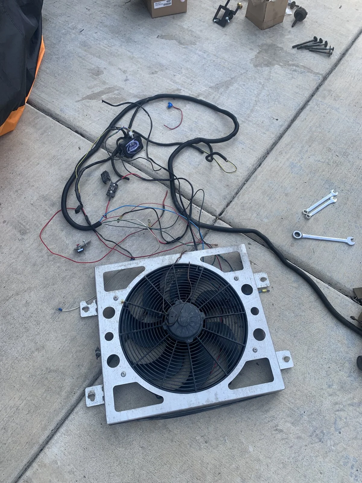

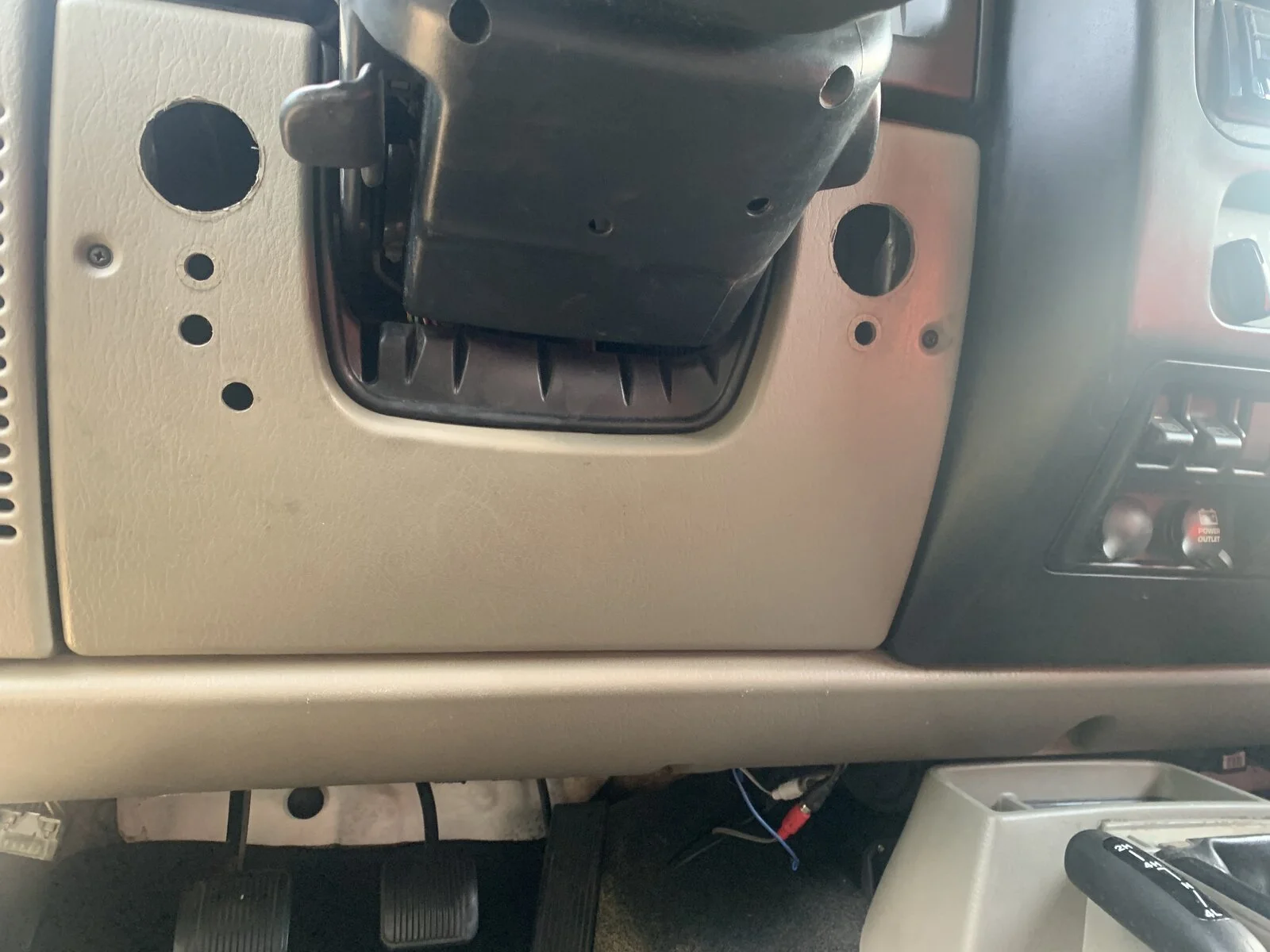

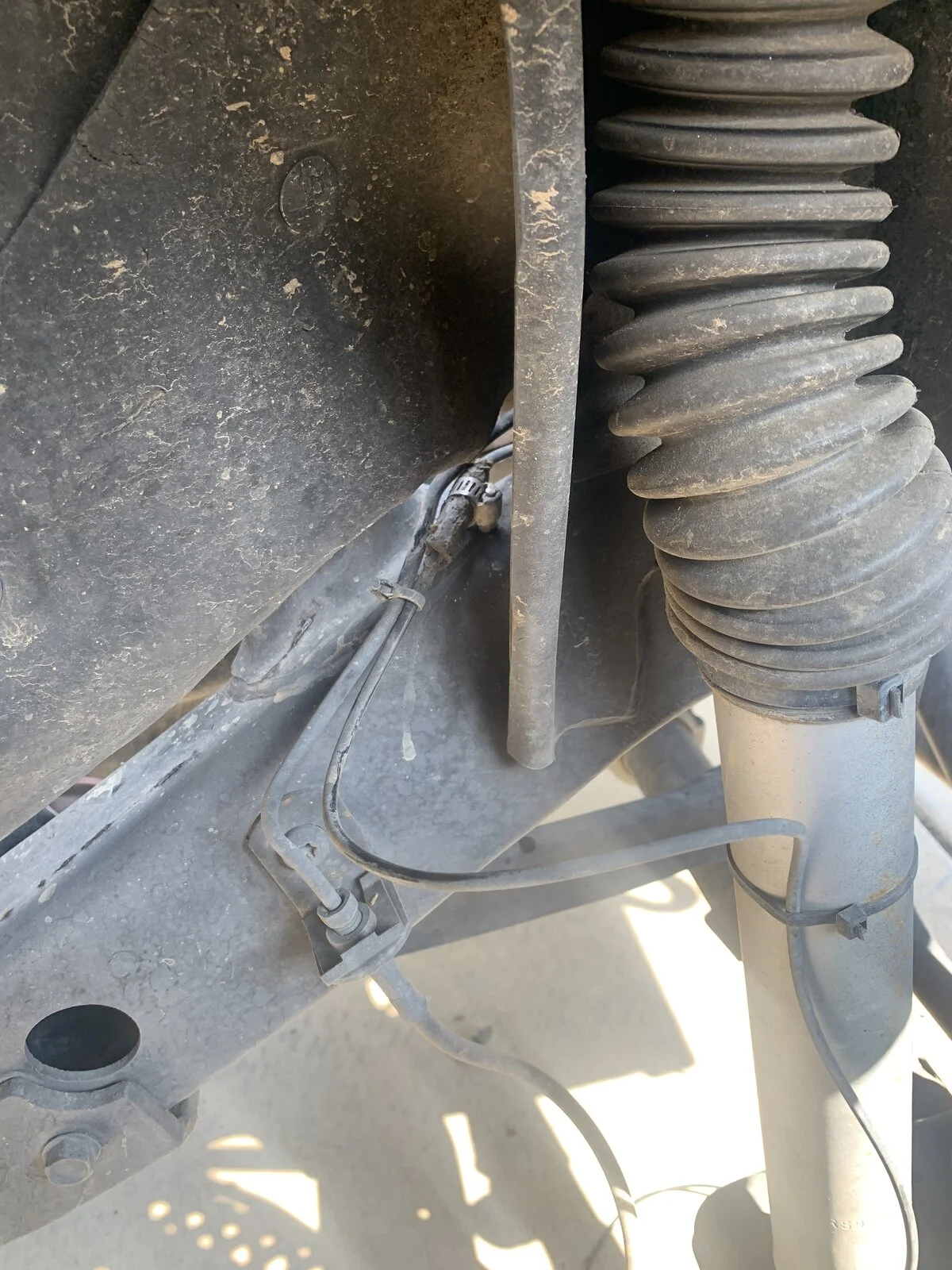

I continued on by removing all the wiring to the electrical fans and air lines for the Shocks. At one point it looked like a “temp” fix was conducted of a leaking airline…😂 now I’m left with quite a few holes on the panel under my steering column. 🥲
If anyone has a lead to a replacement Khaki Panel I have your name on a 6 pack of your choice!
Worst case I’ll pick up a black panel and paint it to the original color.

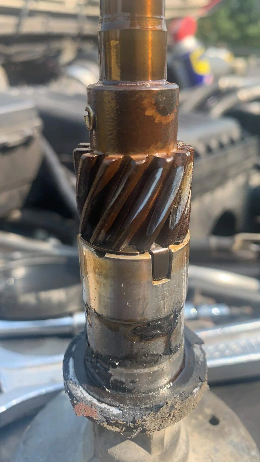

While finishing up removing everything I noted that the original OPDA was still in the LJR. With 100k miles and have read about this in the past I thought it be a smart idea to check the conditio…. yep. I have the Crown Automotive replacement on its way. 🙃
I also noted some Black RTV used where the seal for the OPDA goes instead.

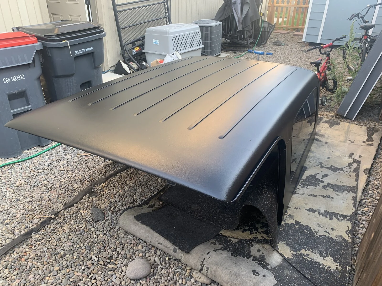

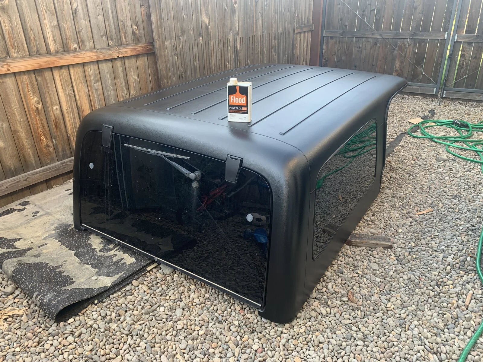

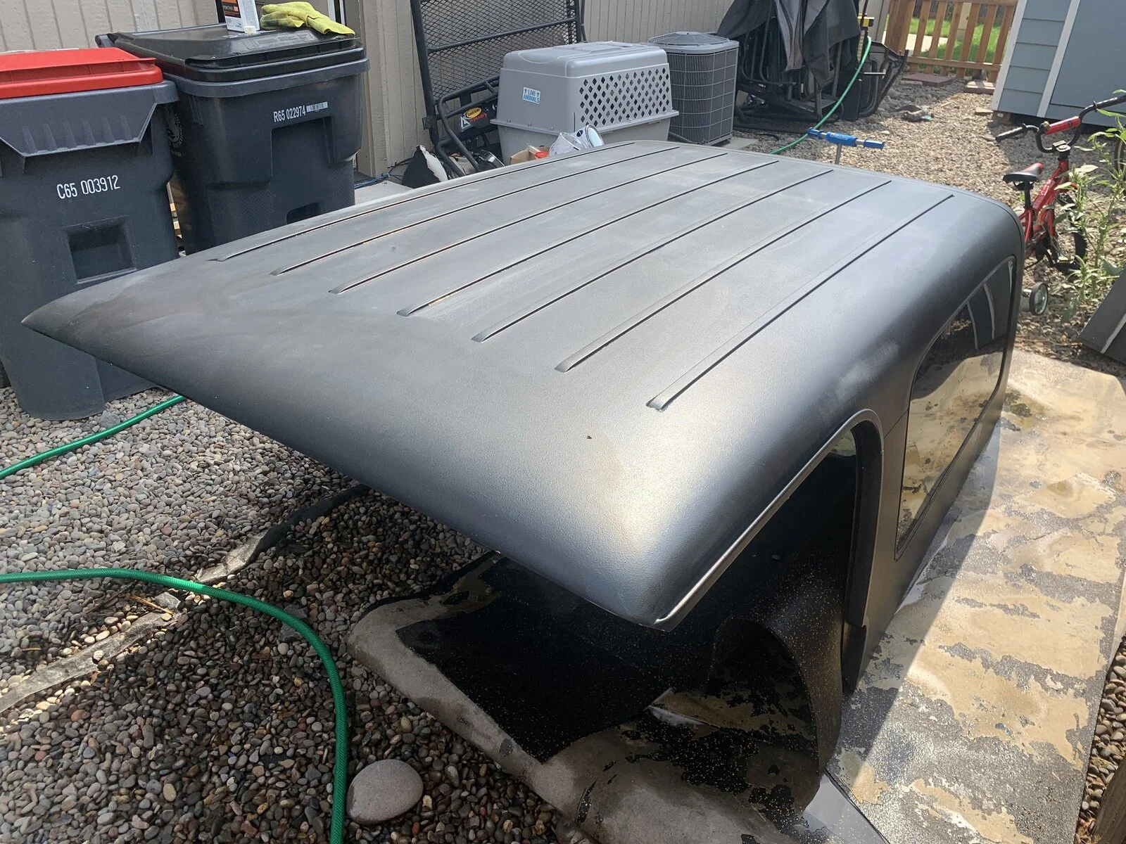

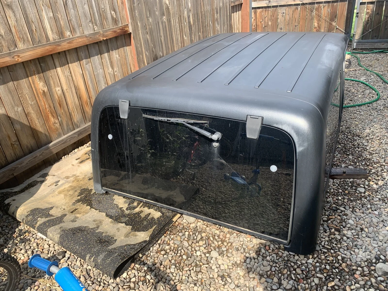

As shown previously the rig came with a hardtop. With it showing it’s age and still having some Flood Penetrol left over when I did my TJ hardtop I got to work on reviving it! It went relatively quick and decided to touch up the Smittybilt Fenders and Rock Sliders with it before I post them for sale.
