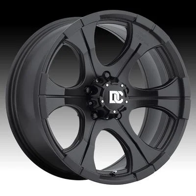

How is the fit and what are the rims?
Can’t fit a stick on wheel weight between the wheel and the caliper.
Dick Cepek blackout
15x8
5x4.5
BS 3.69
they no longer make these in all black
