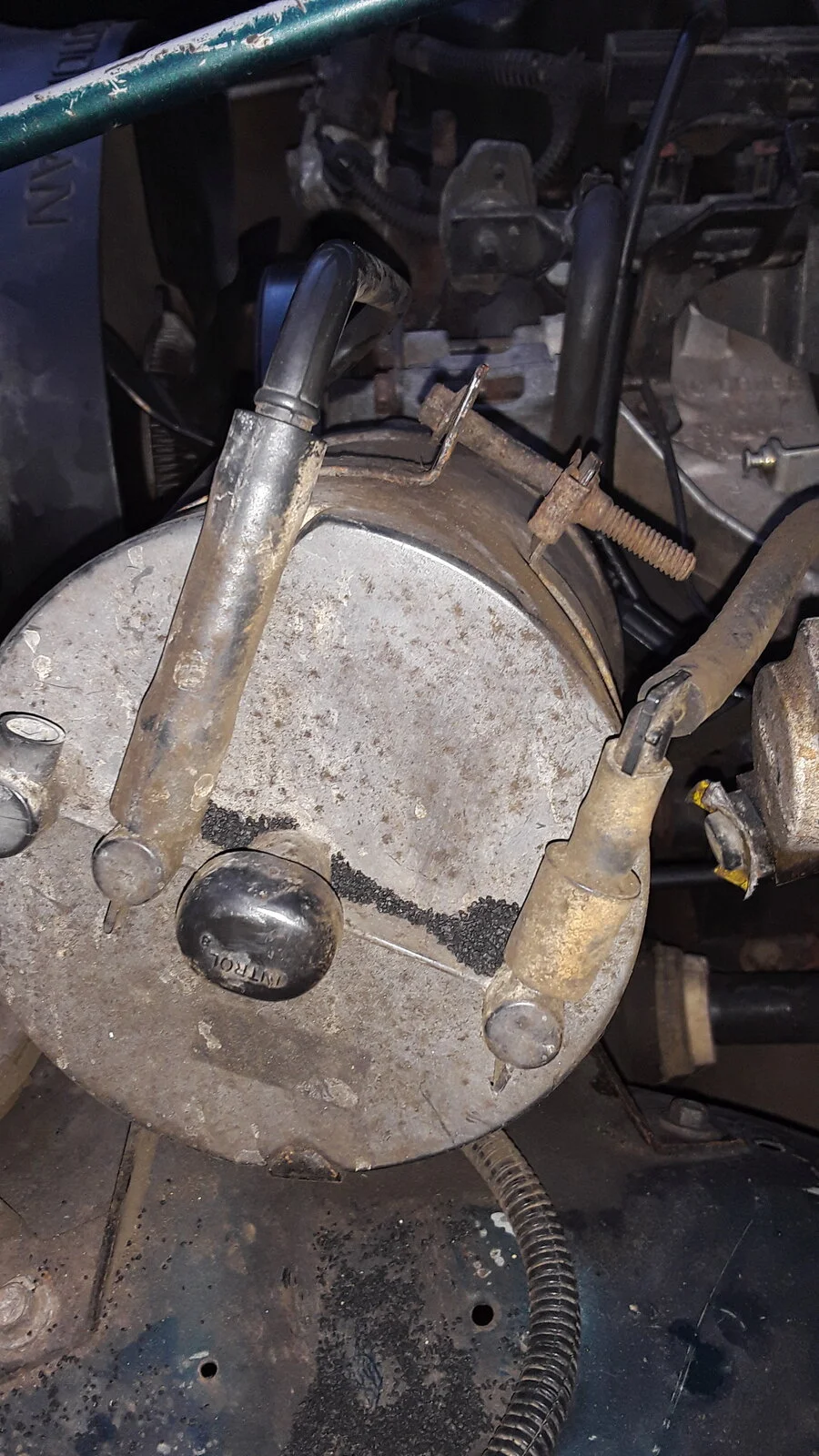

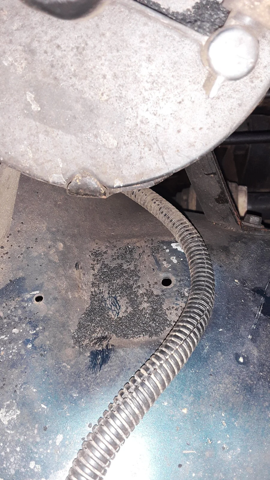

I just noticed while messing around with my jeep that under the vacuum canister (coffee can) there was charcoal all on my fender and on top of it by the vacuum lines. Could this possibly have been my problem all along causing my stalling problems? The charcoal being sucked into my vacuum lines.
