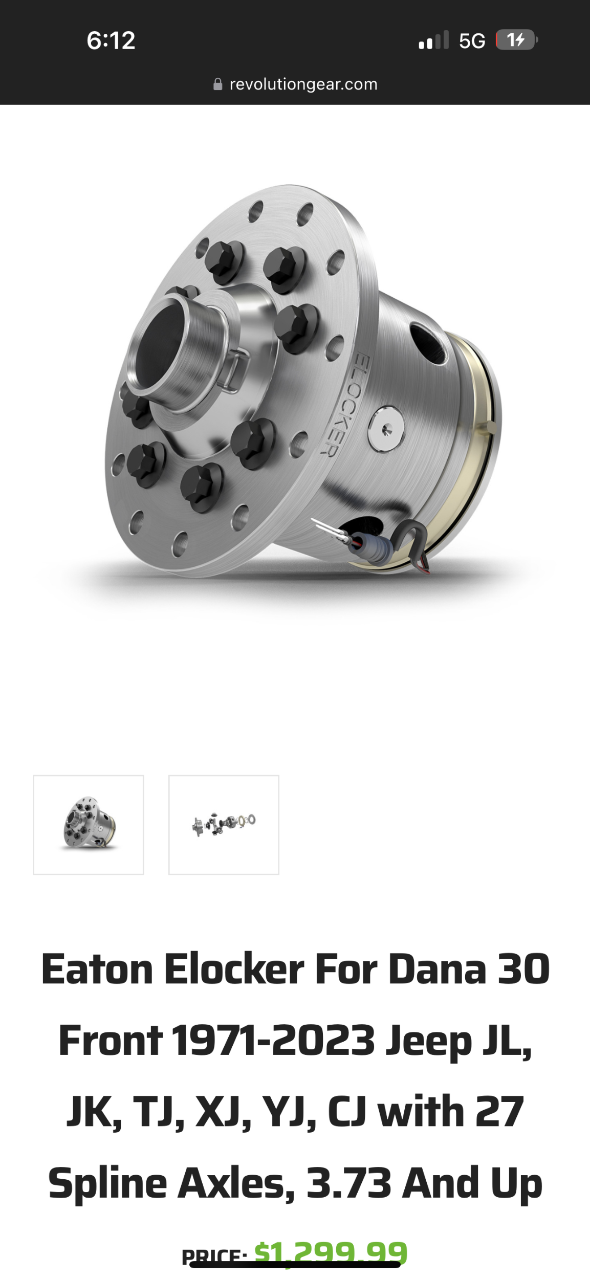

I’m describing “fair amount of pavement” as approximately 50% of its overall usage. The other remaining 50% will be light to medium wheeling with probably more on the medium side. As of today, my plan is to get a Powertrax No Slip for the front, and I will add the Eaton elocker for the rear towards the end of the final build.
I think that’s the best plan. I also have an electric locker in the rear and torq lunchbox locker in the front.
I went with torq because it seemed a better design than the no slip powertrac, less parts. If you don’t mind the ratcheting noise give it a look.
I wish I had a selectable in the front but it’s hard putting that much money into a Dana 30.
