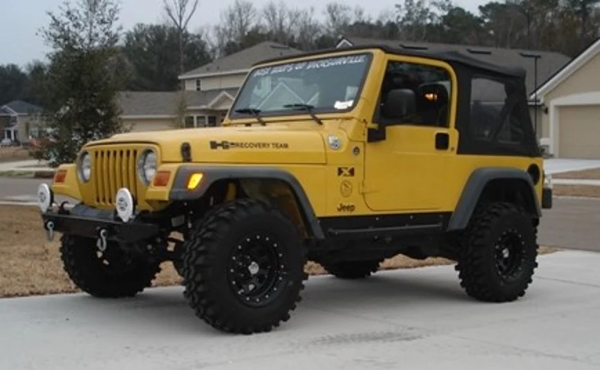

Welcome to this forum. The TJ in your avatar looks pretty good. The top down and the dog are a nice touch.

The shop is just trying to take your money and sell you things you don't need, this forum isn't. Put a 2" BB or 1.25" BL on, add some aggressive 31s and enjoy it.
Thanks Boog, this is a great looking example of a mildly modified TJ. Most TJ owners don't need to go beyond this level of mods.
