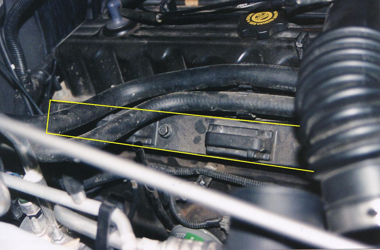

If you have multiple coil packs on the passenger side, you have a wasted spark distributorless ignition. If you have a distributor, you don't.

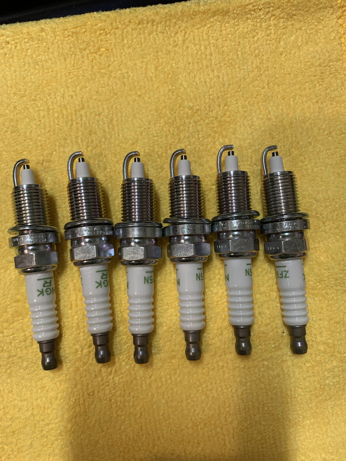

Ok per Jerry's recomendation (because I feel like he's the Jeep Guru) I ordered the XP985's. Going into a 04 4.0 /123k on the clock. I've owned the Jeep for 4yrs. Got them installed and Jeep fired instantly. My normal cranking procedure was spin it for 3-4 seconds. Knew it wasn't gonna fire. Hit it again & it cranks. The plugs I pulled out were NKG ZFR5N.
I can only assume that the were factory installed. Gaps were from .075-.080 had 1 that was close to .090.
Hard for me to believe this thing even cranked. Ain't took a test ride yet but thus far I'm happy.

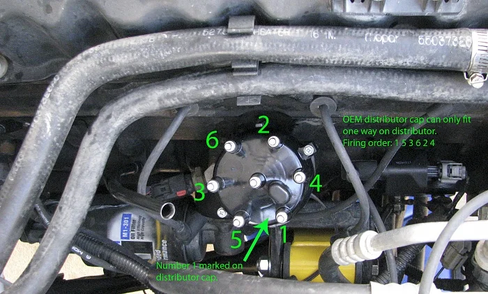

Hopefully this helps. Top is distributor, bottom is distributorless (waste spark). Look at the passenger side of your engine. These are both pictures of Jeep 4.0's.
