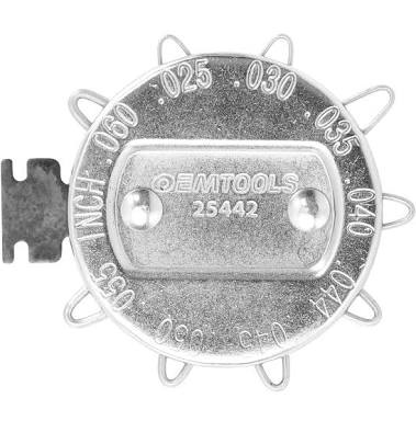

Never gap platinum or iridium plugs with a tapered sliding gap tool which can damage the coating. Instead use a tool with a notch cut into it meant to bend the electrode to achieve the correct gap. Like this...

Been driving diesels for years and I can't tell you how many years it's been since I changed spark plugs on a vehicle, I found my gappers and they are the wire type not the tapered.

Are feeler gauge types OK to use for iridium plugs?

Thank you for your reply - I will gap them at .040 for my 2005. Is a feeler gauge type OK to use for iridium plugs?
