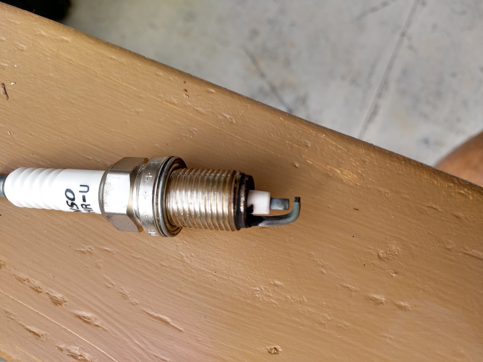

So, after looking around, I decided to pull a plug.
None of them looked too bad, but there was some weird deposits. They looked pretty new. I've only had the vehicle for about 5 months, and it had been running well enough that I hadn't thought about the plugs.
Denso qj16hr-u, a copper core grooved plug.
I changed them out with the ones Coach recommended, the Autolite APP985 gapped at .035, and boy, what a difference. Fires up more smoothly and really revs up smoother. Better pickup for sure.
Now, I'm not really a believer in plugs making a huge difference, but, in this case...big difference. No drugs or DIY delusional enthusiasm required to note the change.
Not sure what to say, except those skimming this thread who just bought a new old jeep (mine is 2001 Sport 4.0, 136K), change your friggin plugs and put in the ones Coach is recommending. I mean, wtf, must be the coil system makes it finicky like Coach said? I've owned many Vanagons, which were very persnickety about using only the specific Bosch plug and NEVER Autolite, which will put the old vanagon right into safety mode, but this seems to be a pretty extreme predisposition.

I think it is strange that the deposits are not on the anode/cathode, but the base of the plug.
While the reduced performance was especially notable after this trip, compared to how smooth the motor is running now, its safe to say those Denso plugs are NOT good for this 2001 4.0 engine, even when properly installed and new and not subject to the huge pressure difference.

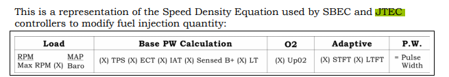

I don't have the answer off the top of my head so I'm gonna think it through as I type this post.
The presence of Baro in the denominator of the Load equation creates an inverse relationship between Baro and injector pulsewidth. (Baro low->pulse width long, Baro high -> Pulse width short). Since your PCM on the way down would have been using a Baro of ~9psi instead of 14psi, the base injector pulse width would have been inappropriately long for the conditions, seeming to agree with your running rich assessment.
That said, I'm not sure why the STFT wouldn't have been able to adjust for it, and if for whatever reason it couldn't, I would have expected an oxygen sensor or fuel mixture code. Maybe it was just low enough or just short enough duration to fly under the CEL radar.

The plugs show a rich condition, probably from the trip up the mountain.
The carbon is left on the rim of the threads because that area is cooler and out of direct contact with the burn.

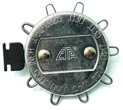

Generally that's true so long as the spark plug wasn't dropped so its electrode got bent.
They can be gapped so long as you use the right type of gapping tool like shown here. You use one of the to notches cut into it to bend the electrode to the right gap near where it attaches to the threaded base, making sure to keep the notched opening away from the iridium or platinum coating.
Use the notch located at the far left in the below photo to bend the electrode so it has the right gap if it didn't come properly gapped or it was bent somehow.
Recommendations for newer TJ 4.0L engines like yours are the Autolite APP-985, Champion 7412, or Autolite XP-985. I recommend against Autolite's AP-985 (one 'P') which only has the platinum coating on one side of the gap which causes rough idles/misfires on the newer waste-spark ignition system used on 2001 and newer 4.0L engines. The APP-985, 7412, (both platinum) and XP-985 (iridium) plugs have their coatings on both sides of the gap which is what a waste-spark ignition system needs.
