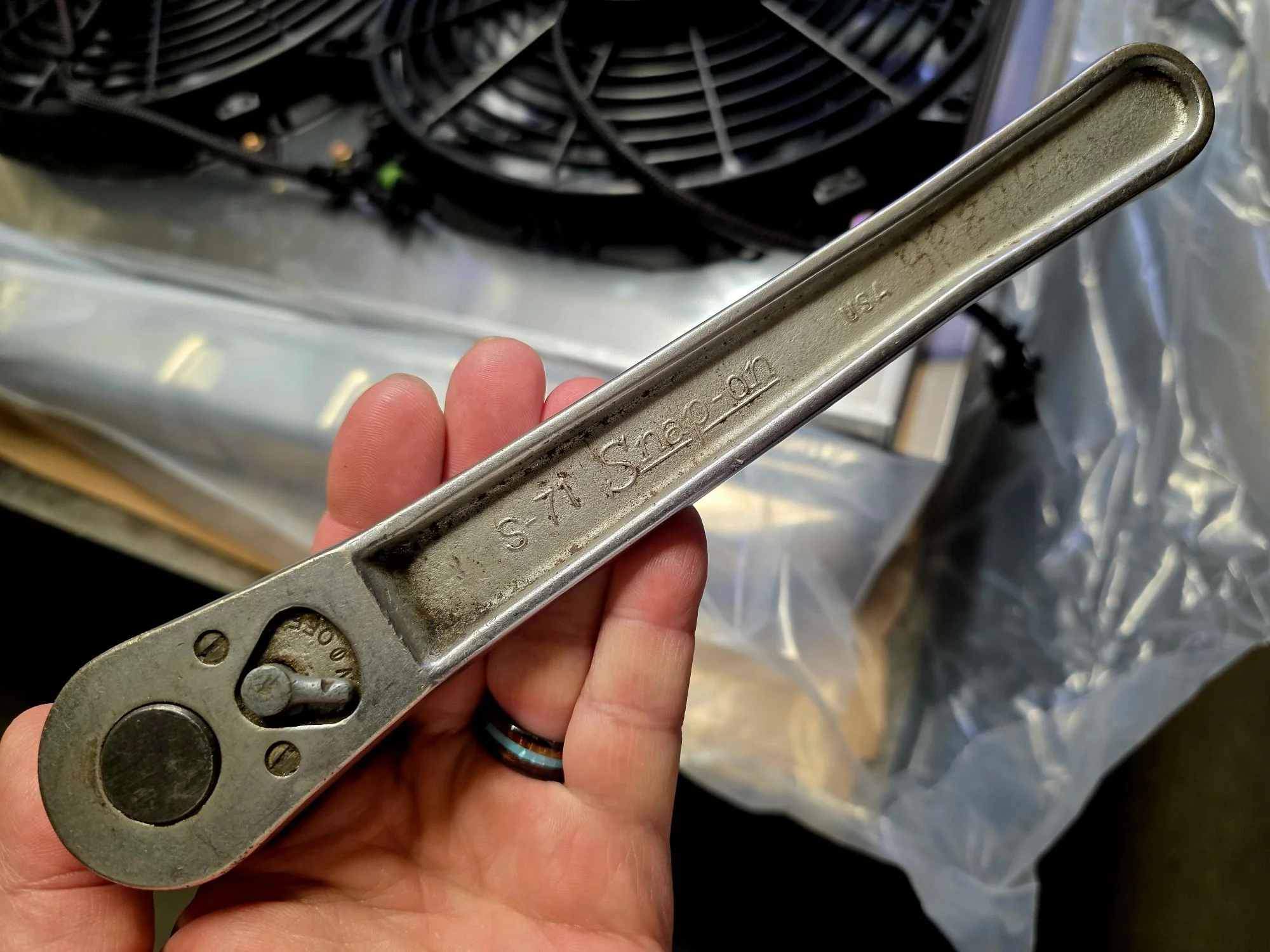

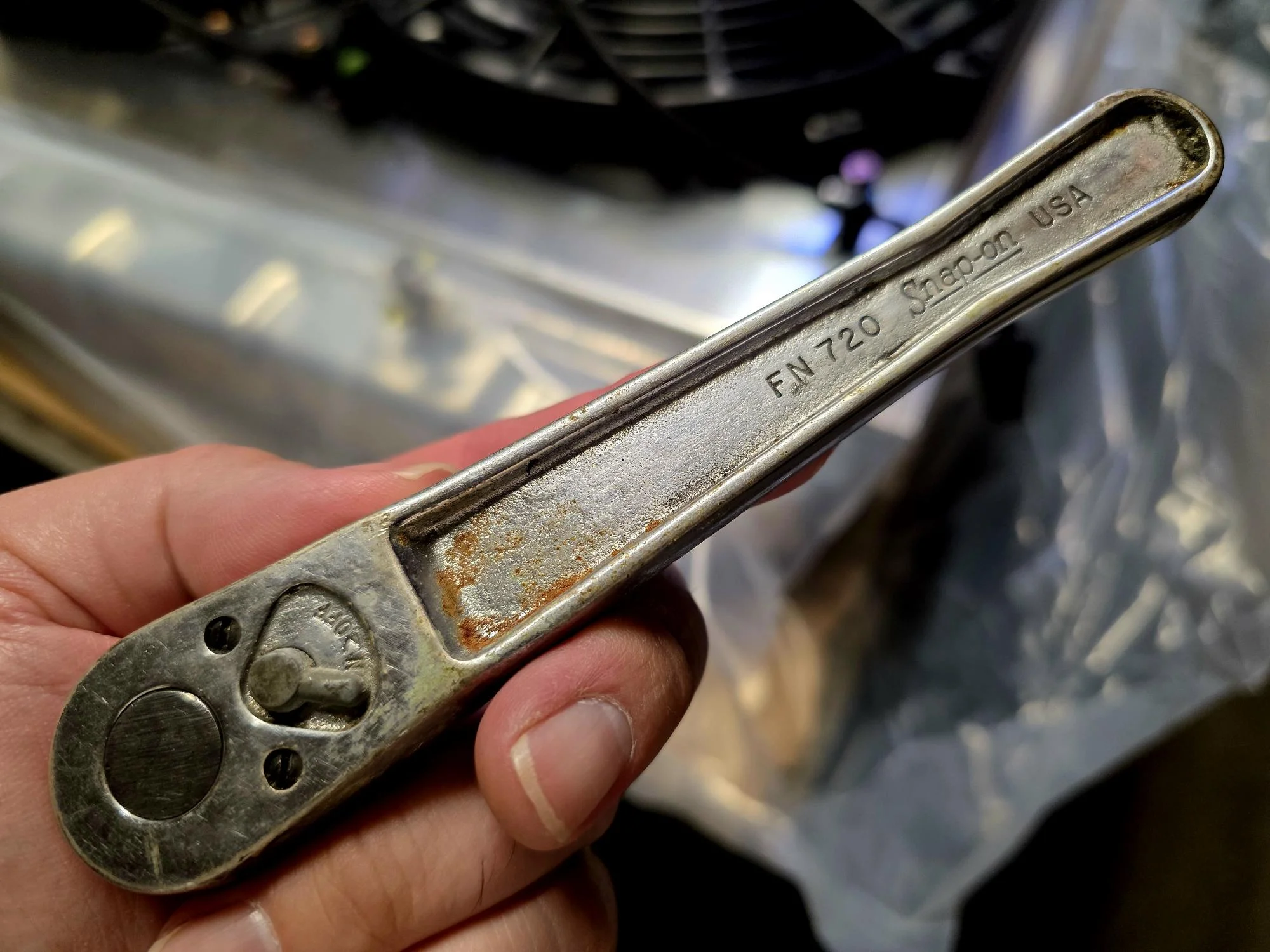

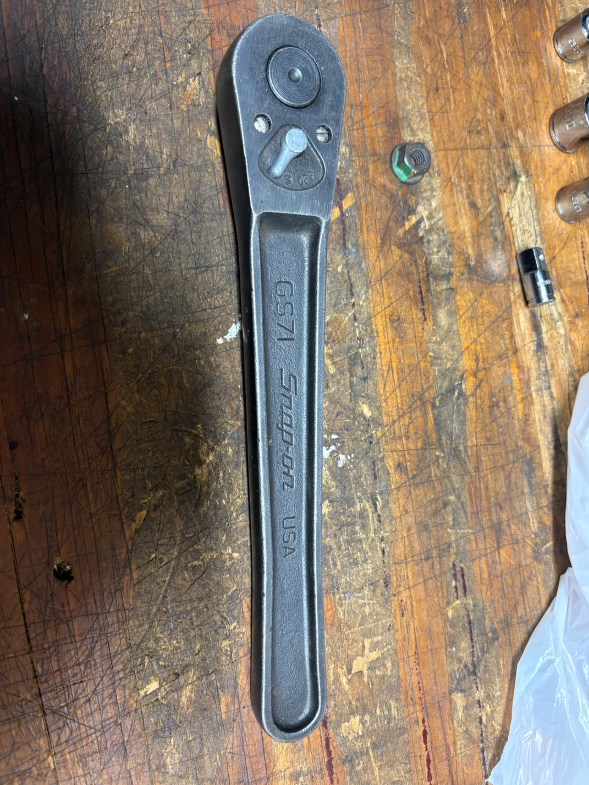

A few new tools, one old one. The Snap-On 1/2” drive ratchet, not sure how old it is. Anyone know how to oil them? Then 3/8” impact swivel sockets, new transmission jack, and neck light, which to my surprise works pretty well.
The ratchet isnt old old. New script says its 80s and newer.
I have several of that style but not black. Have never oiled a Snap On ratchet, just take apart clean and grease every decade or so :D

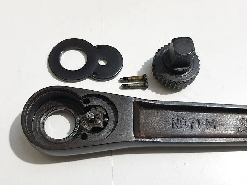

Not my pic, but all this lever style Snap On is the same. Just clean it out and new grease. And if needed rebuild kits are available.

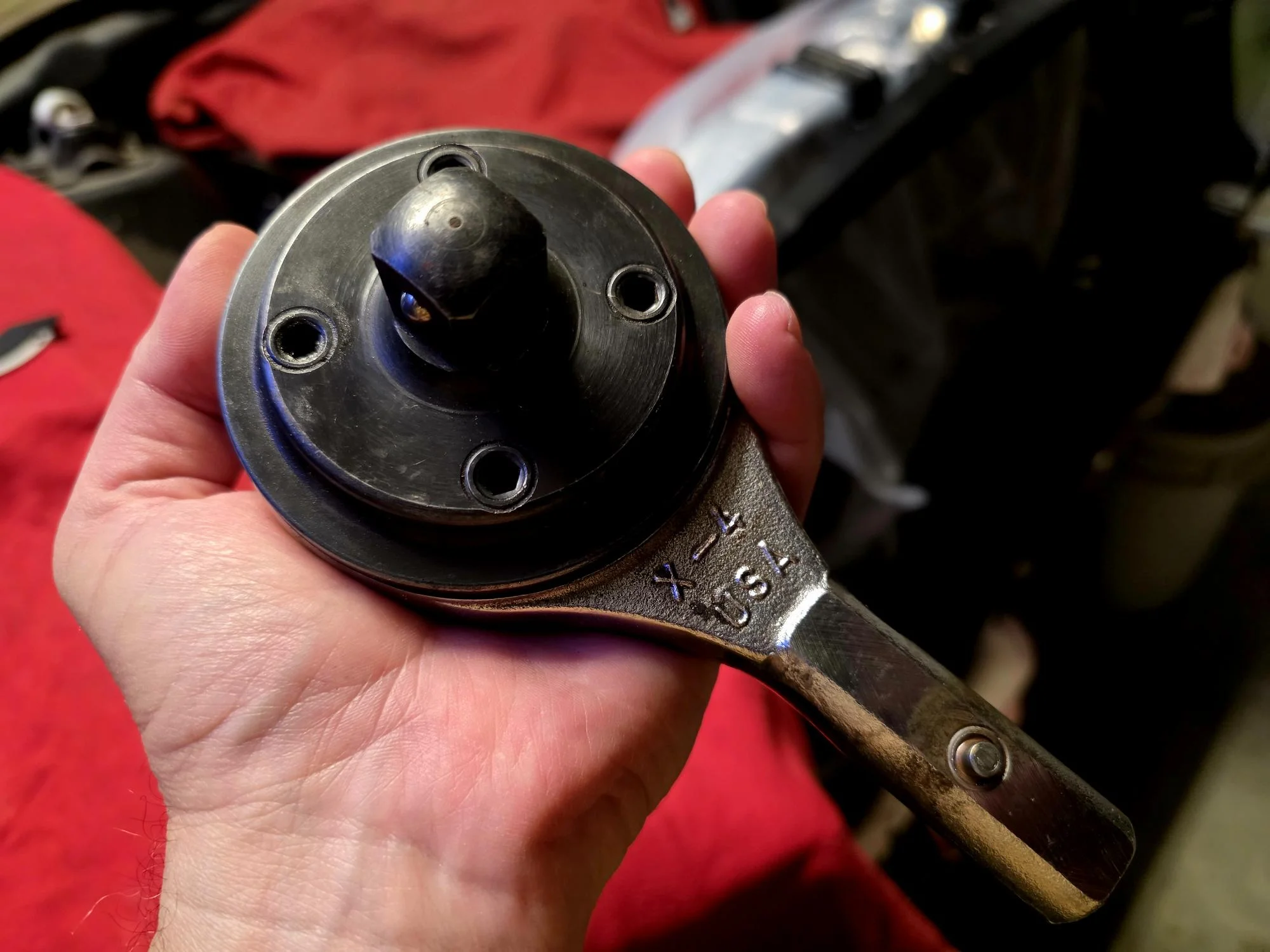

That may well be, but the ratchet @Danarch posted dates back to WWII, and I would suspect you can still get a rebuild kit for it. Is your Craftsman older?
The Snap On script on that ratchet is 80s or newer.
The pics of the two I posted are old script.

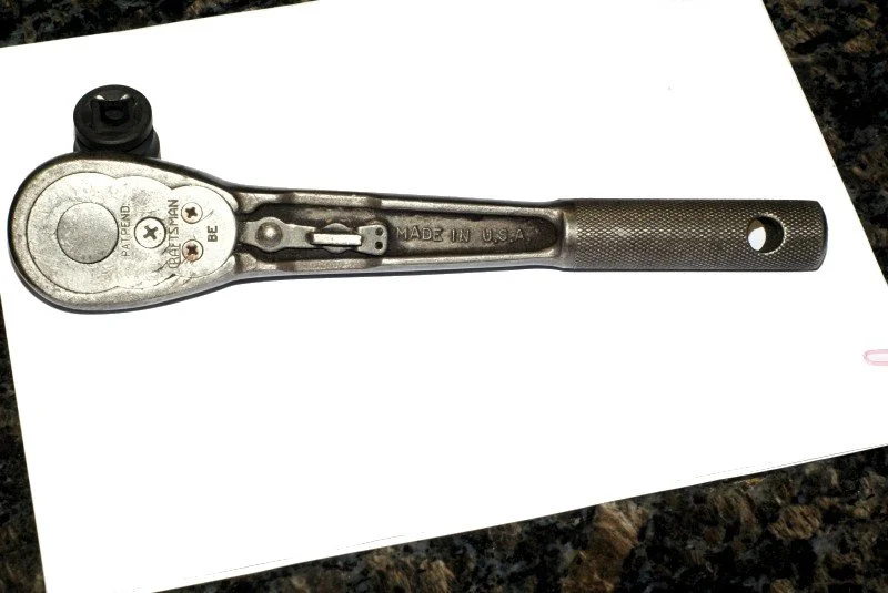

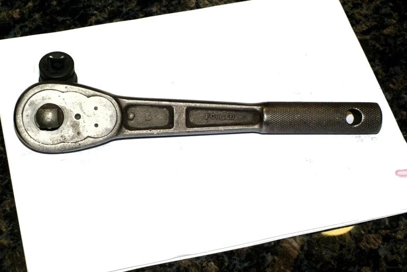

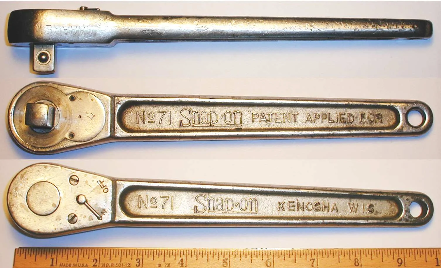

Like I said above....maybe his/yours isn't but that ratchet design dates back to the 1940s, at the least. Pretty sure the origins of the 71 go back farther than that, here's one from 1933.
Also, I believe the G may indicate it's a government contract model (in black oxide), yours is a consumer model.

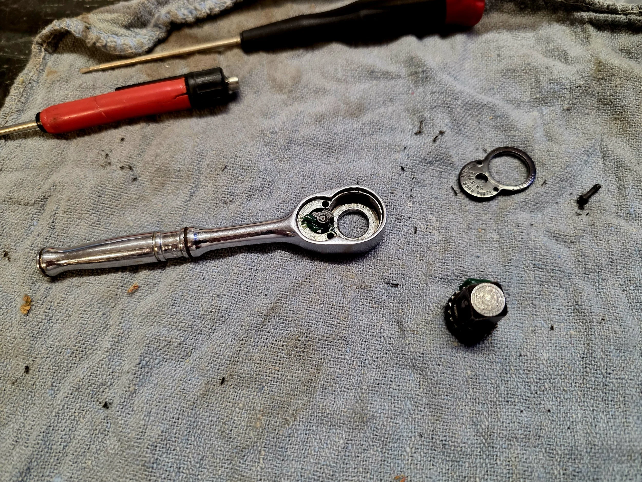

The bonus, from the disassembled photo, it looks like there's nothing particularly susceptible to wear in the ratchet body itself. Aforementioned kit quality warning by @WVJeep304 aside, it should be infinitely rebuildable if maintained.

Most on the ones I have had that didnt work were just gunked up. Just gotta be mindful that there is a spring under that ball for the direction change piece :D

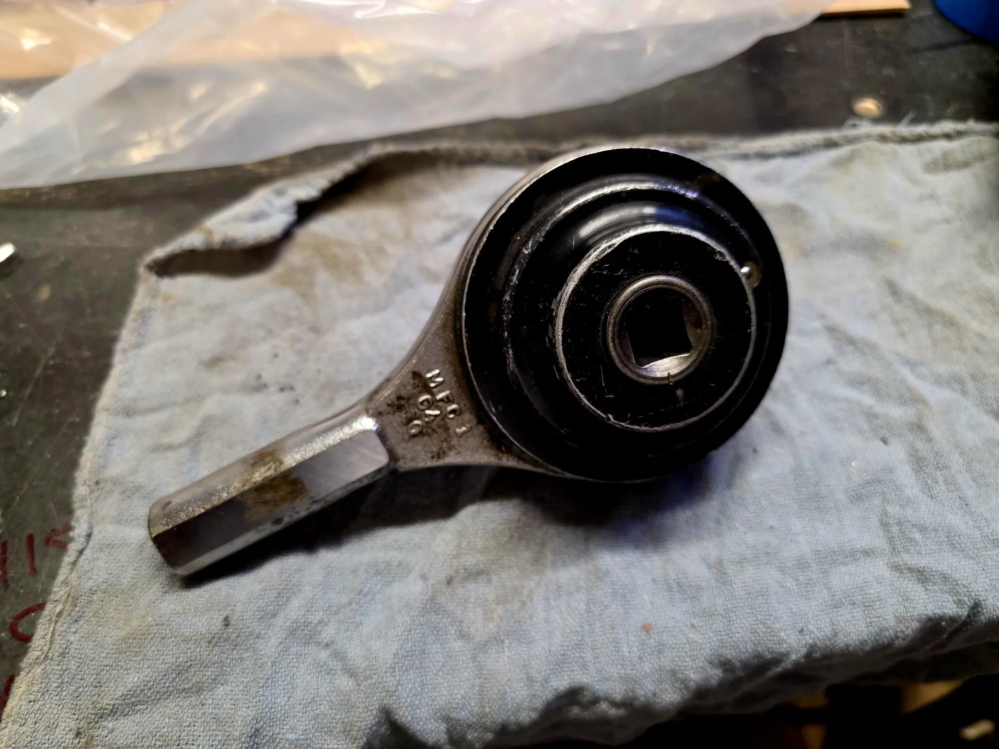

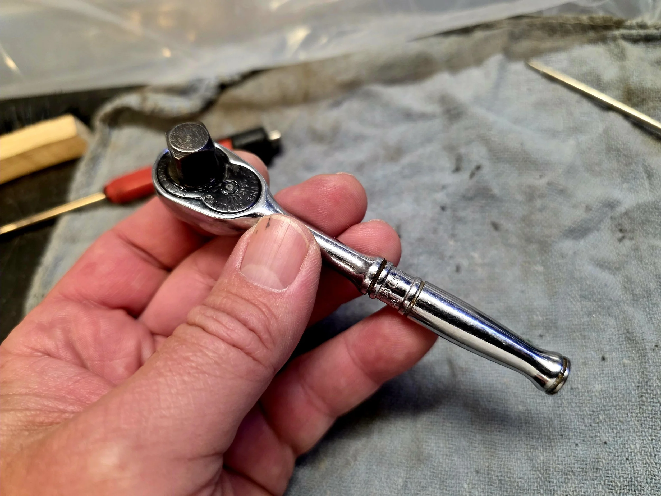

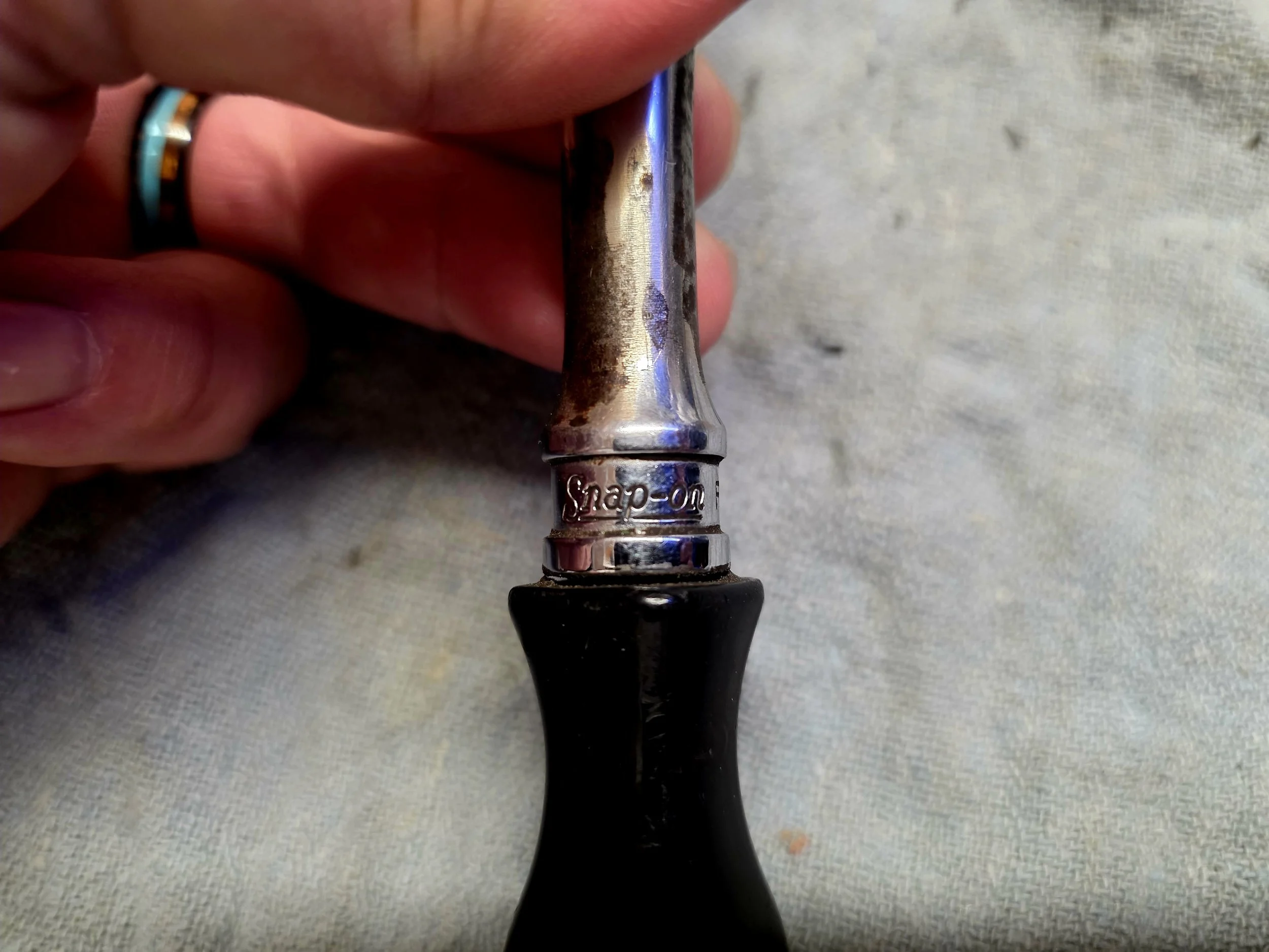

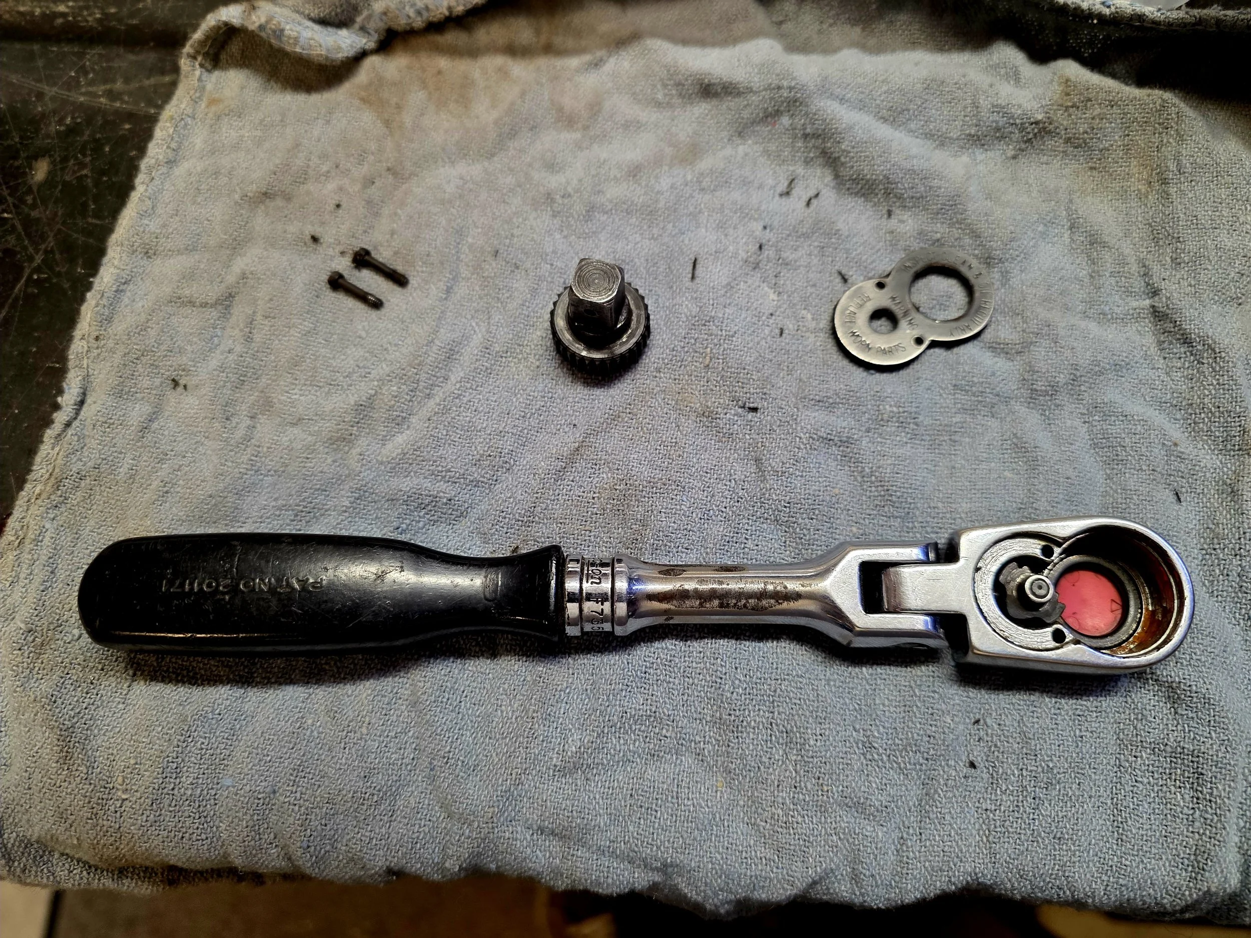

These two just didnt ratchet at all in either direction.
Not worn out, just dry and crusty. Cleaned up the gears with a wire brush and did not pull the direction change part. Because it is a major bitch to successfully get the ball on top of the spring in the hole and get the direction change thing back in.

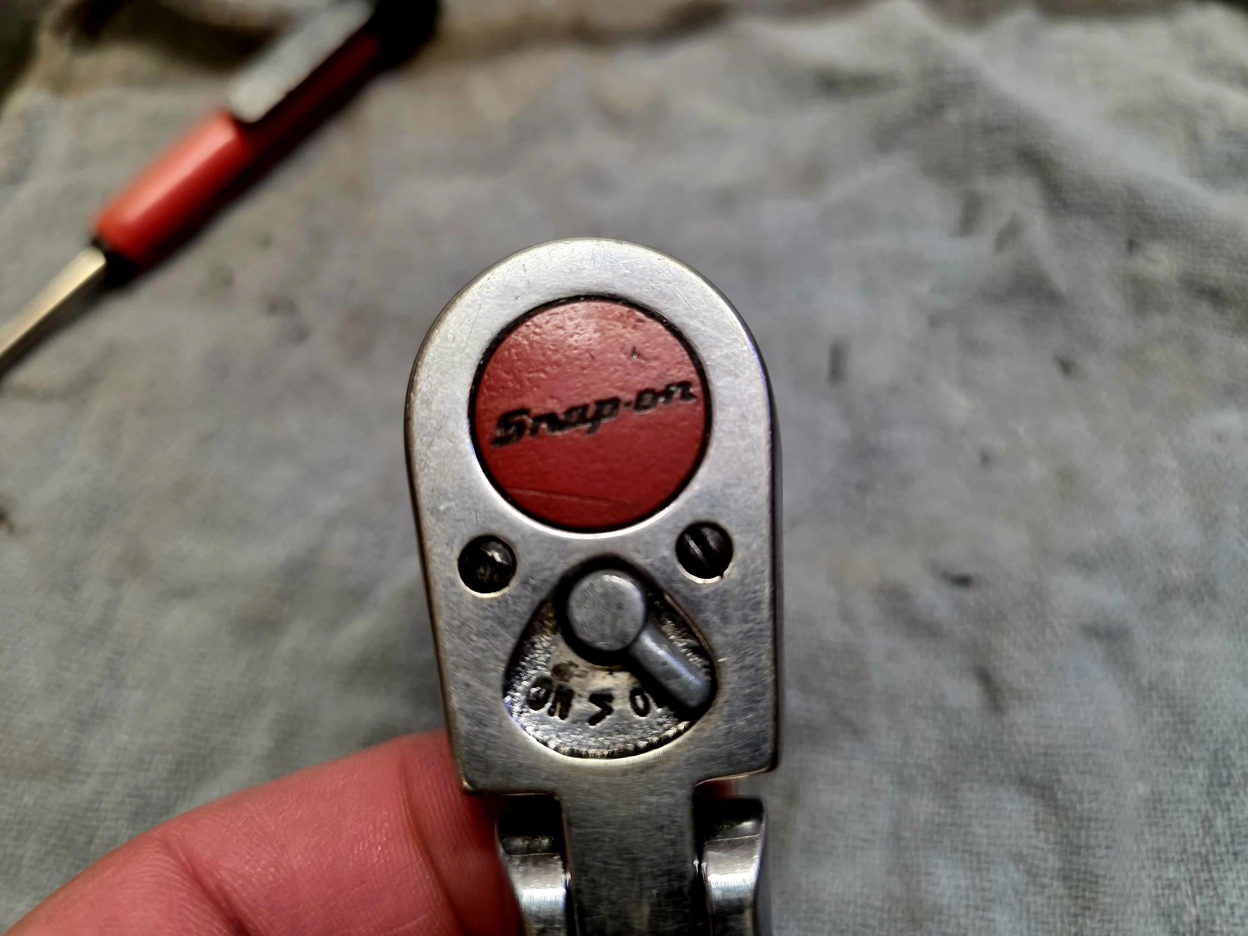

Flex head one is weird. New script head, old script handle.
And those 1/4 drive handle 3/8 drive ratchets are one of my favorites 😁
Greased them up and good as new.

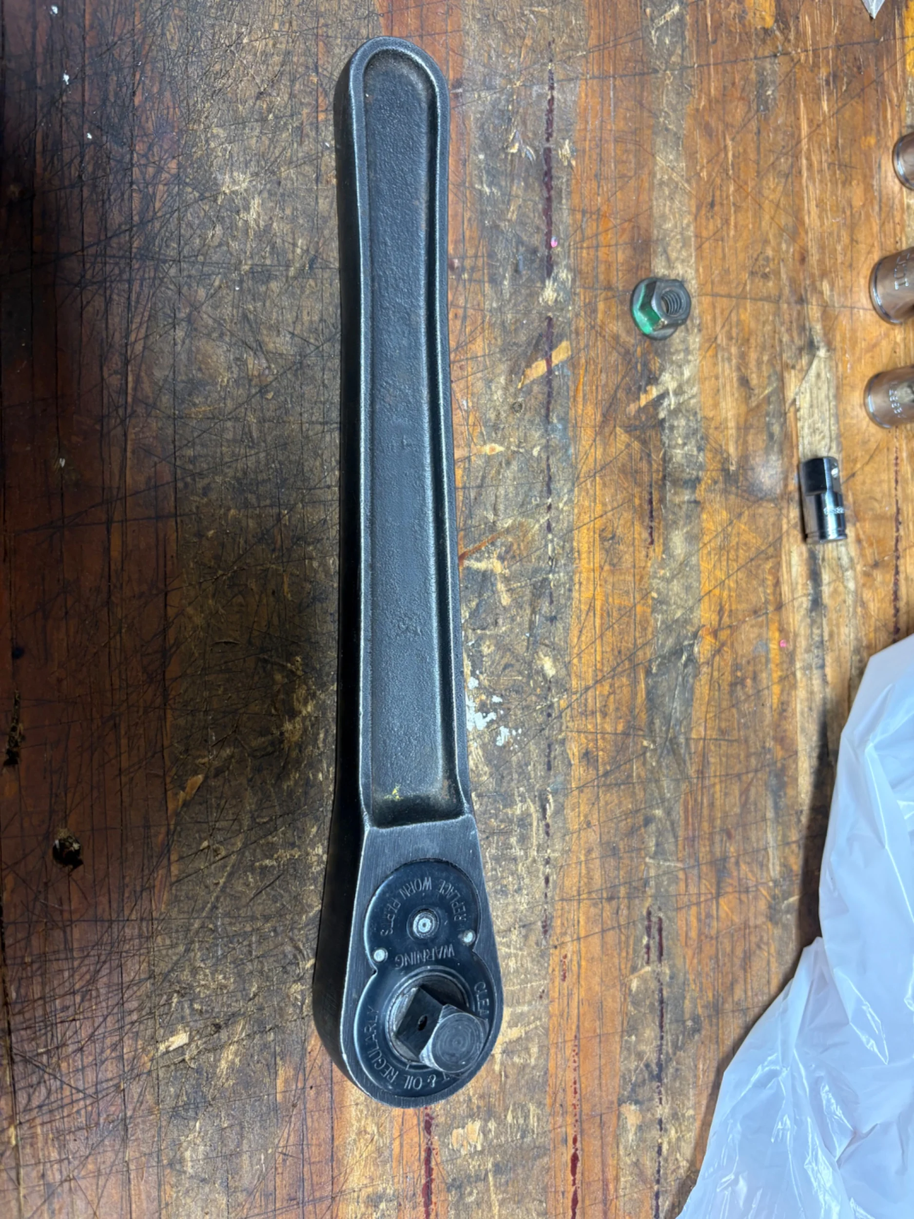

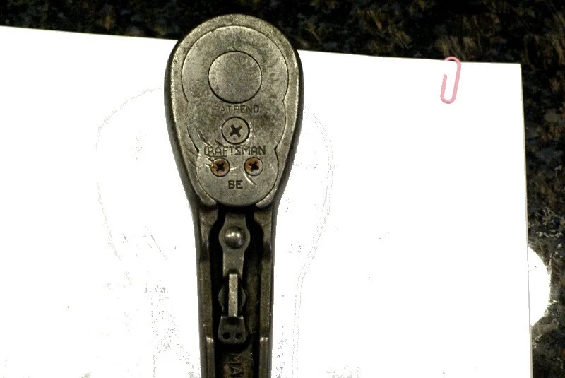

Ok, answered my own question. There were two virtually identical Craftsman ratchets, the "BE" which is this one, from 1935 to "early 40s". There was also the "Circle H", which was "late 30s to late 40s". In any event, they're quite easy to take apart and clean - so I'm gonna do that and see if the "false shift" in the direction lever gets better.
