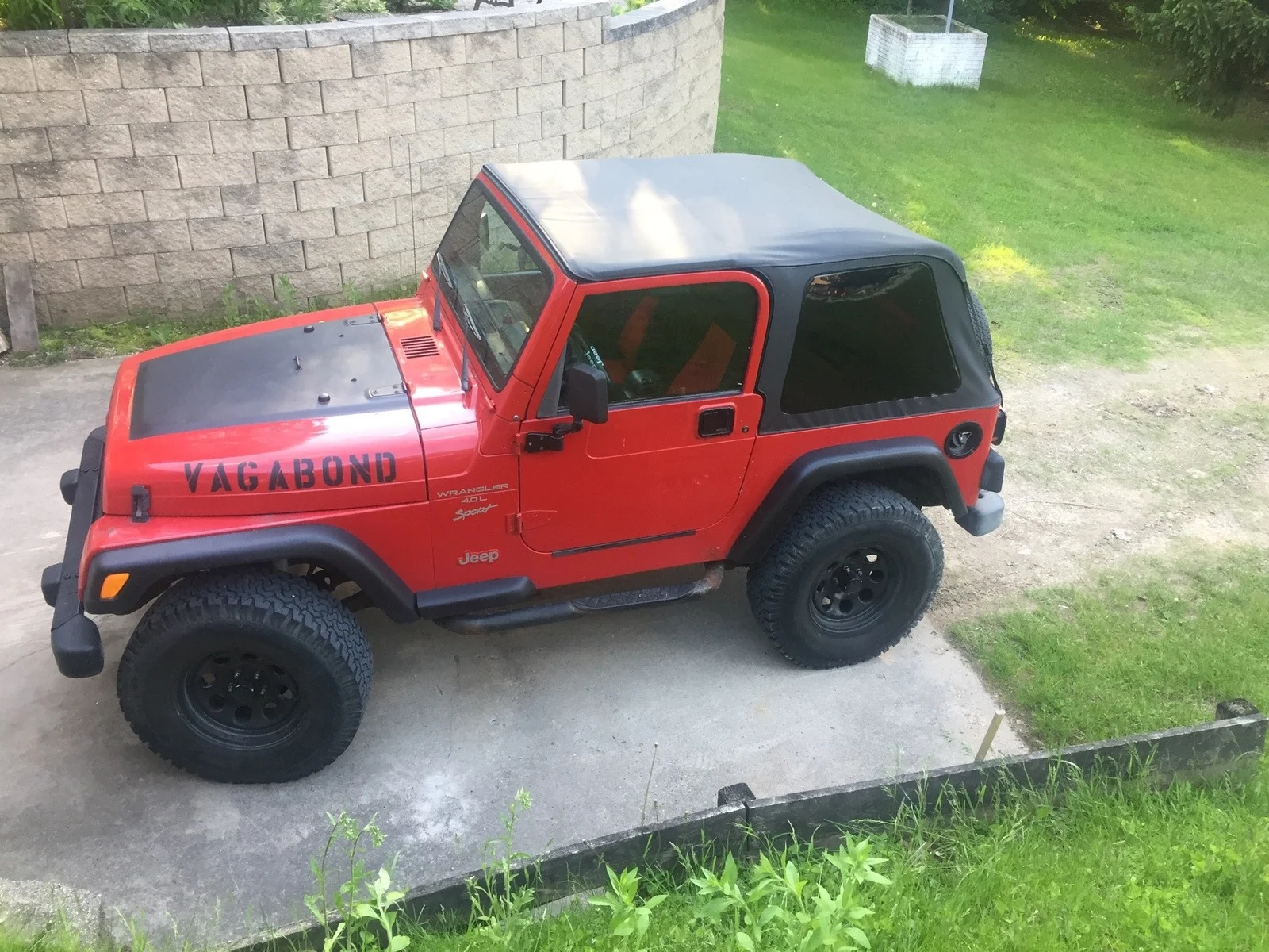

Can you not get a class c tire for a 16 inch rim? Do you think the consensus is I should have 15 inch rims if I'm going to invest in new tires? Thanks
You can but choices are limited. I believe Chris has 16s for his Duratracs
I went back and looked and it had a 3 inch spacer lift and new shocks that were put in shortly before he sold it. So based on that I think I should be able to put a 33 inch class C tire on it and be ok . Thanks again for your feedback .

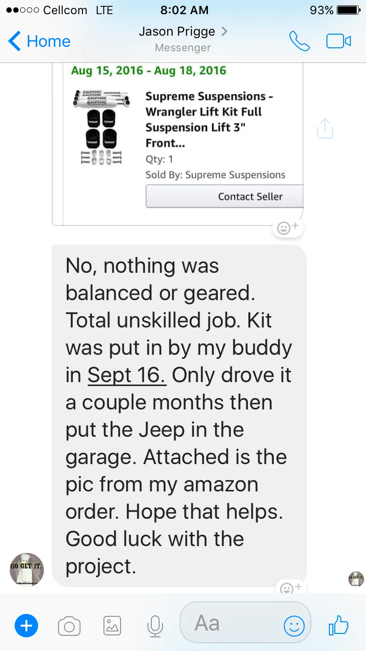

With 3" spacer lift the shocks should not be stock. That would not be a good combination. There should be some numbers stamped on the shock body at least.
I
Messaged the last owner and this is what he sent me. I want to get the jeep at a minimum in shape to drive to and from work this summer.

Rim size doesn't really matter. People commonly run 15, 16 or 17. Most on this forum like the look of 15 and there are other factors. But, yes, lots of tires in 33's that fit 15's. Much less in 16's. 17's are fine. Just know the tires get more expensive on 16's and 17's.
To run 33's you really need to see what gears you have. You can find this on the back left side of your rear differential. You may have to clean it off to read it. Probably 3.07 or 3.73. 33's are not really ideal at either, but more doable at 3.73. Ideally, you'd want to regear to 4.56. It's just going to be a dog on the highway if you don't.

Tire balance is very important on the TJ. Or should I say, perfect balance. Sounds like you have a typical poor balance job, not the dreaded "death wobble." Take them in and make sure you stress the importance of balancing them perfectly.
Most shops over inflate the tires as well. Try running them at around 26 psi and see how they do.
Hey, wanted to let you know after putting back tires to front the shaking got a bit better. Then I deflated all to 26 psi and it was even better. THEN I took the back and sides off leaving the top on and it improved a ton! Why do you think that is??
Less wind resistance? Maybe some of that shaking you were getting was from the soft top sides. Sometimes the wind can make them flap a bit, which might be mistake for shaking.
