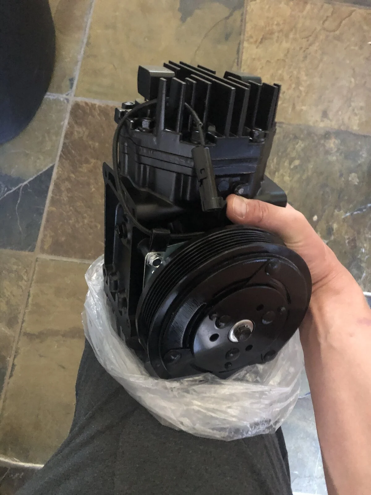

Putting this little guy in tomorrow!

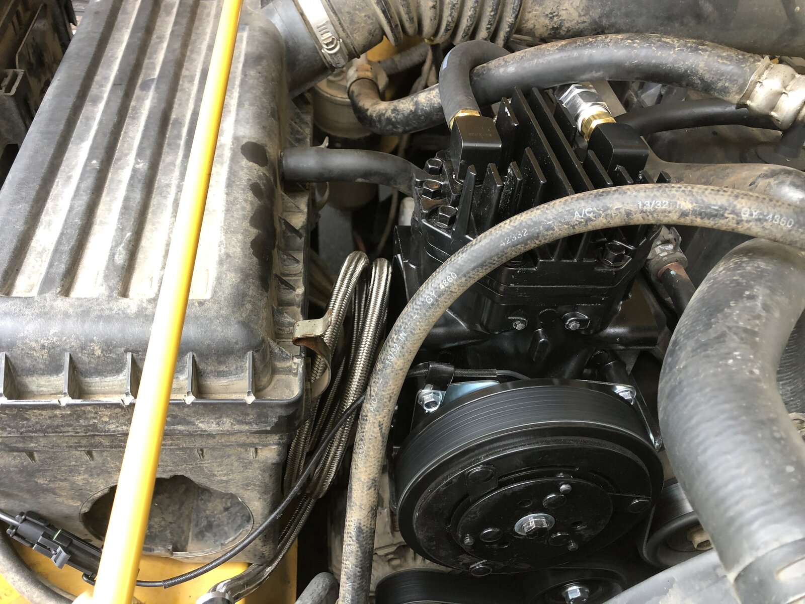

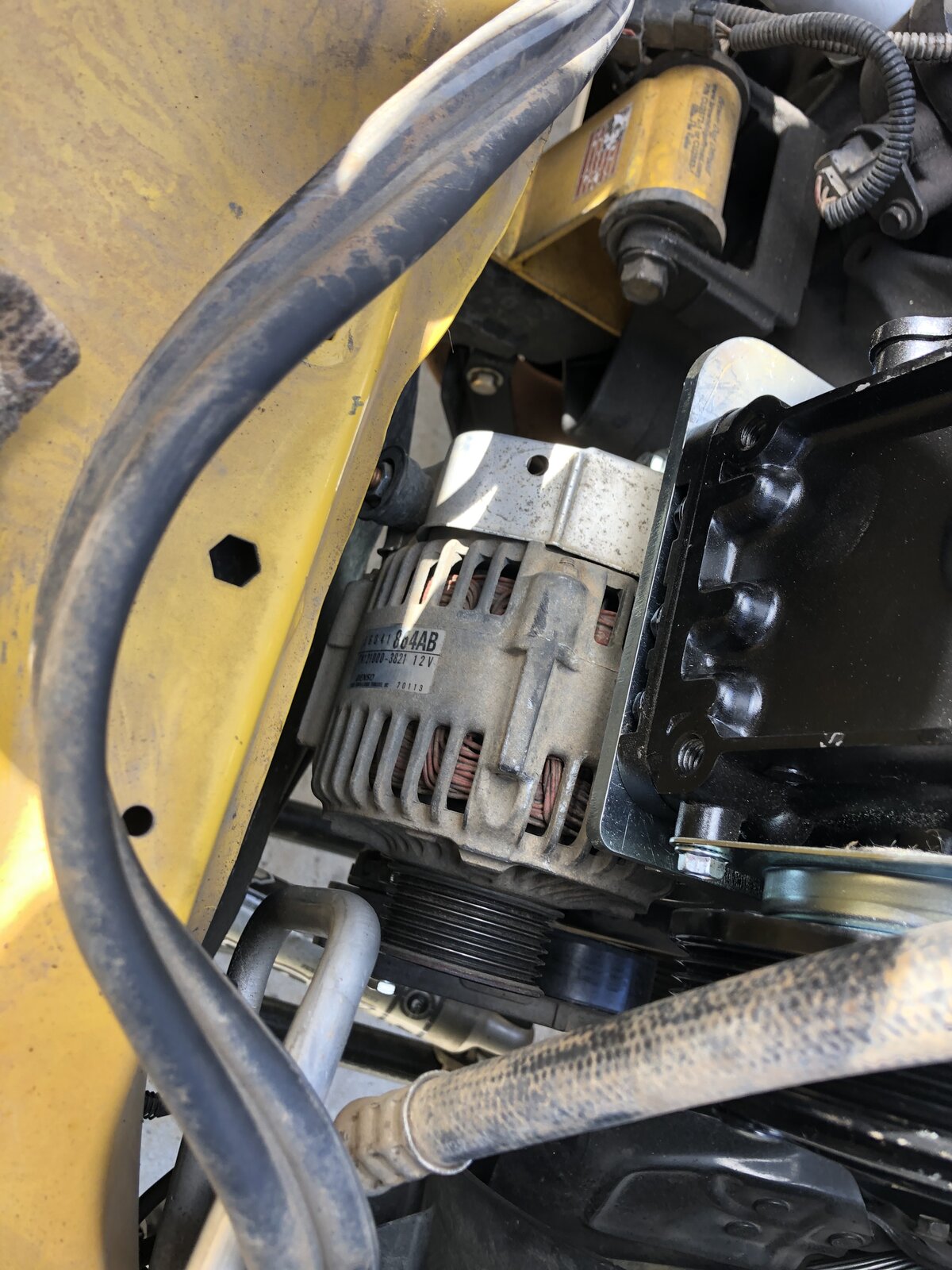

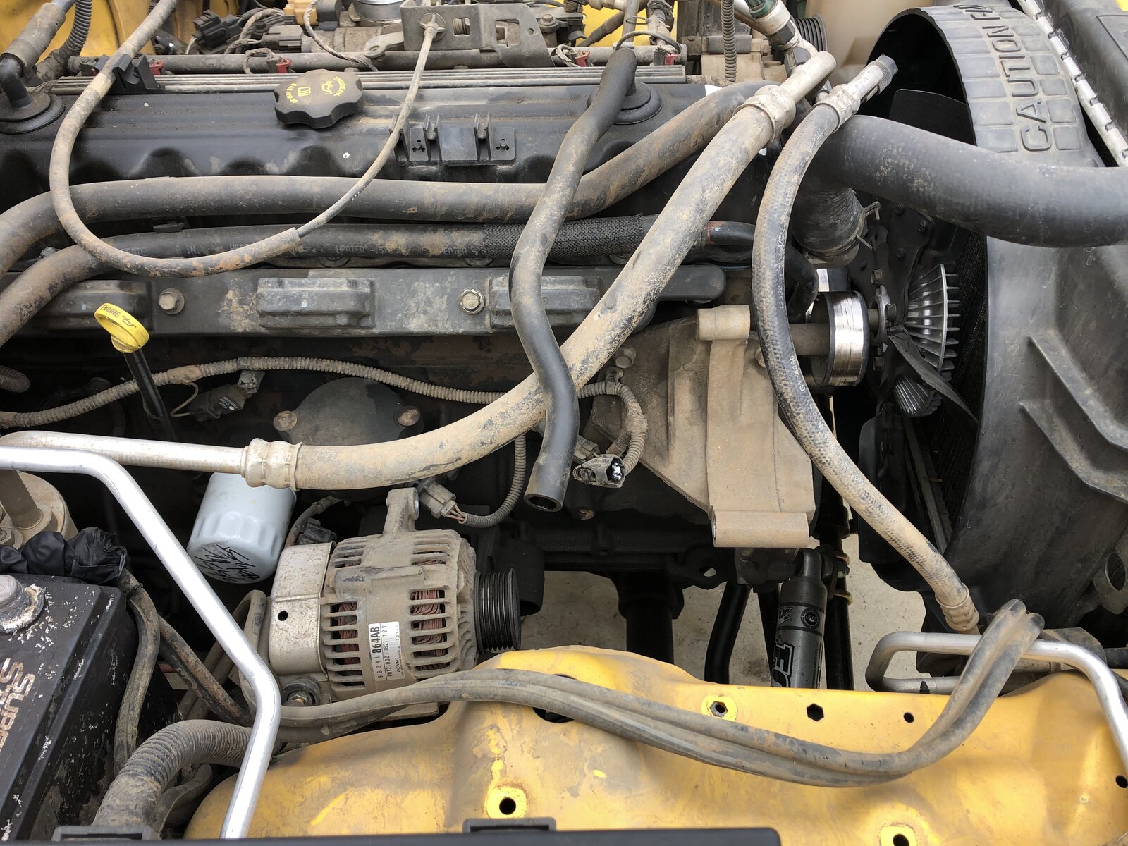

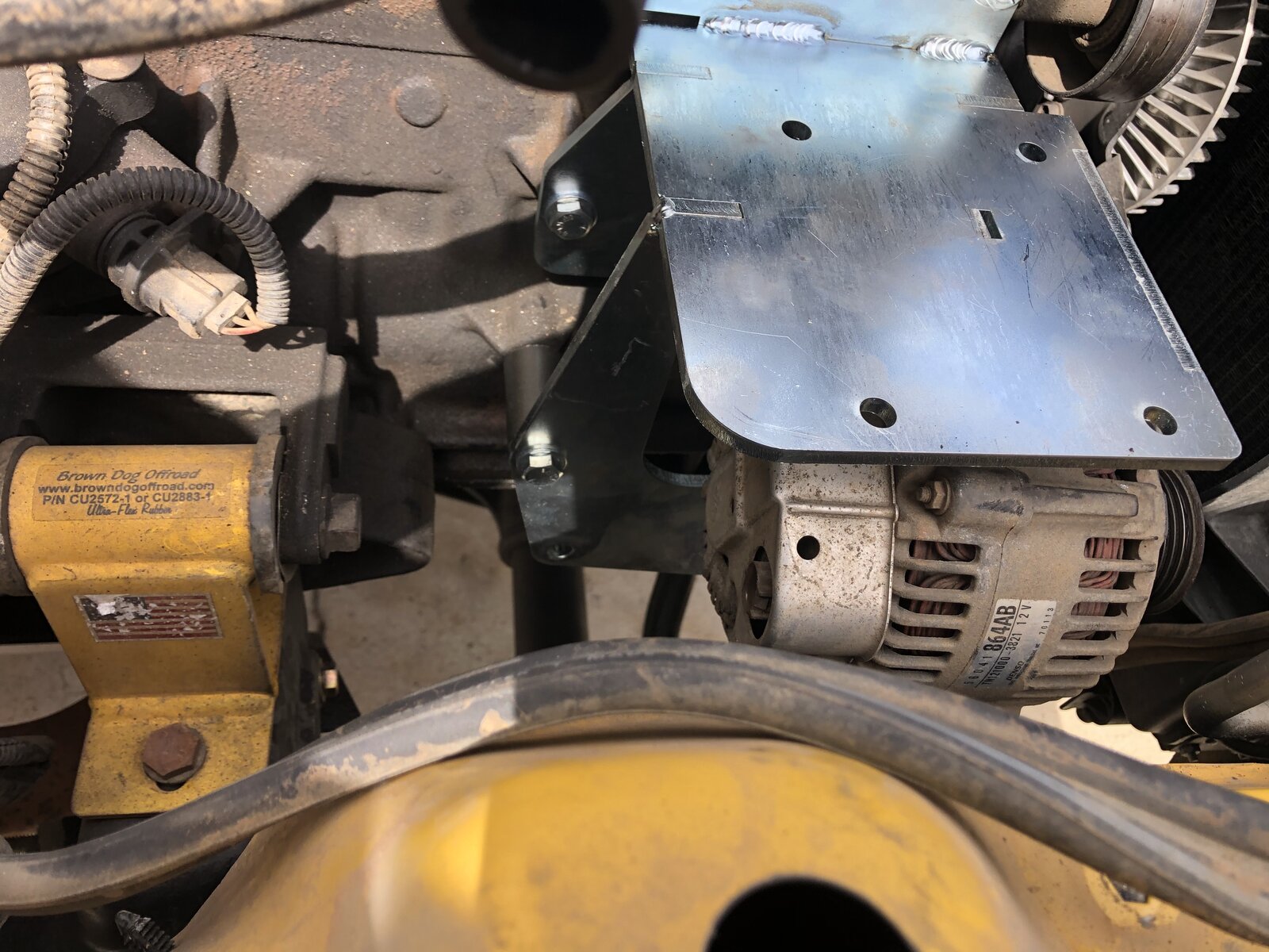

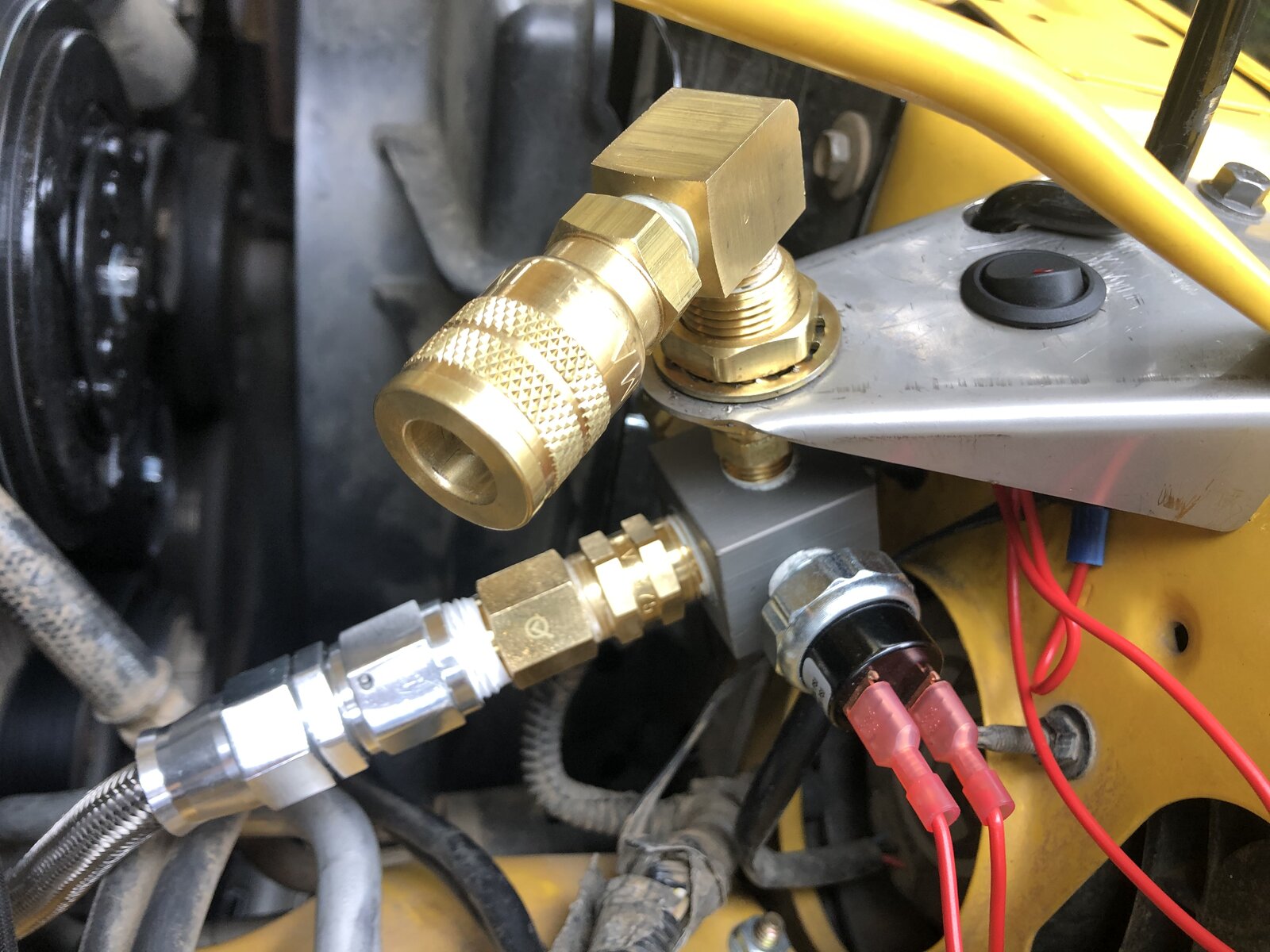

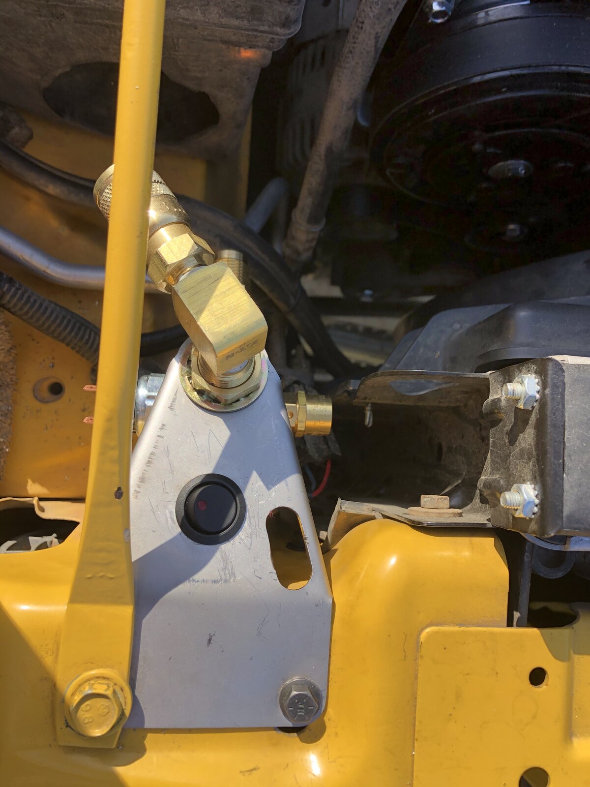

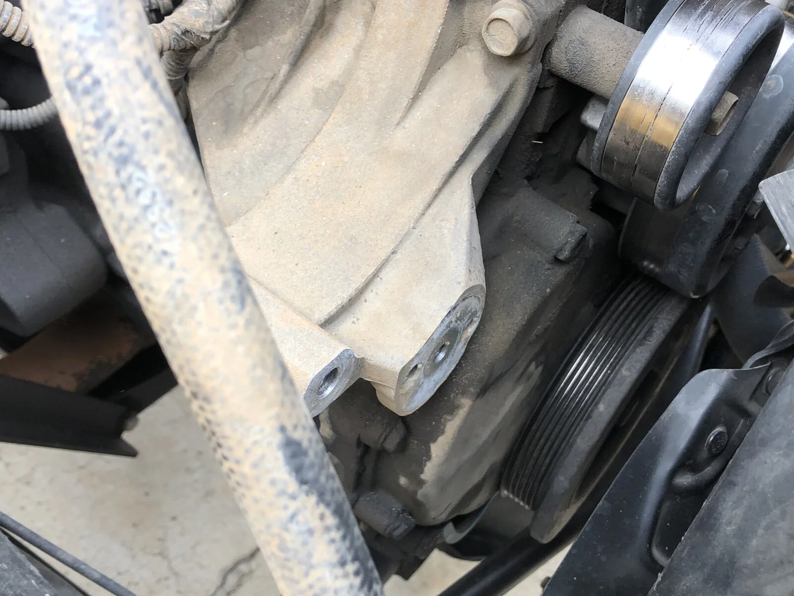

Ok finally hooked up my York mini on board air kit by Off Road Only. The kit is pretty complete with decent instructions but I’ll walk through it here for those who are interested in what the kit includes.

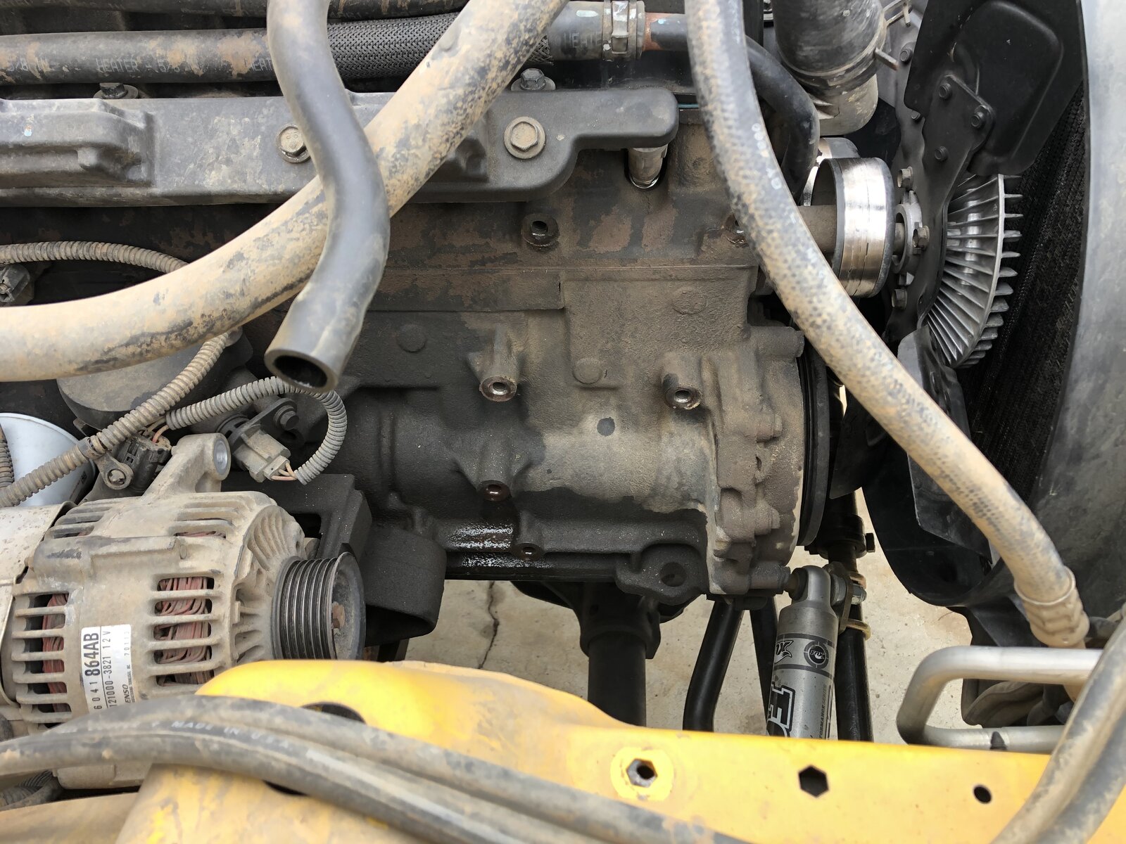

First remove your belt, airbox, and alternator.
then remove your belt tensioner from the alternator bracket
Next remove your alternator bracket.

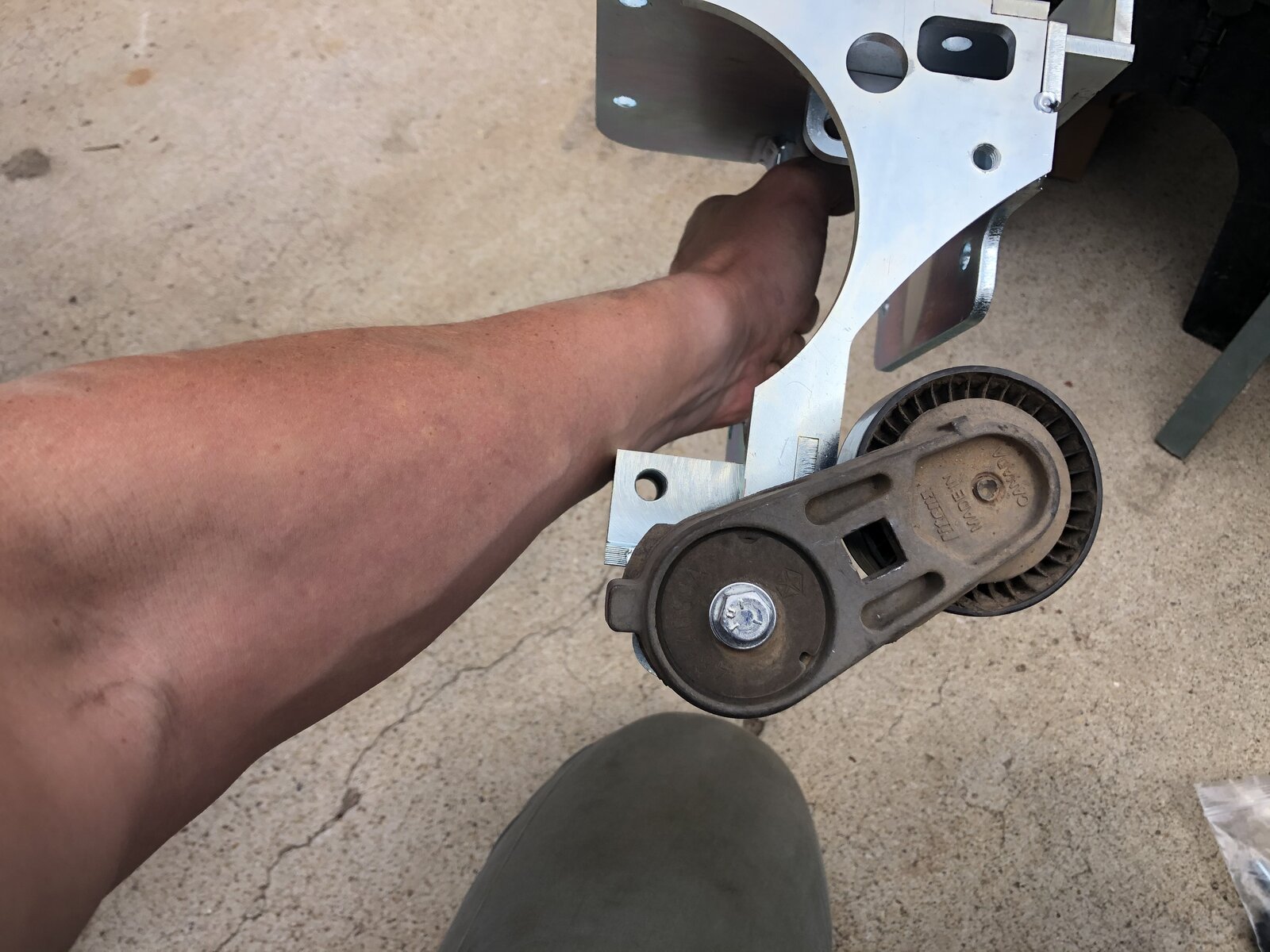

then attach the belt tensioner to the supplied bracket from the kit.

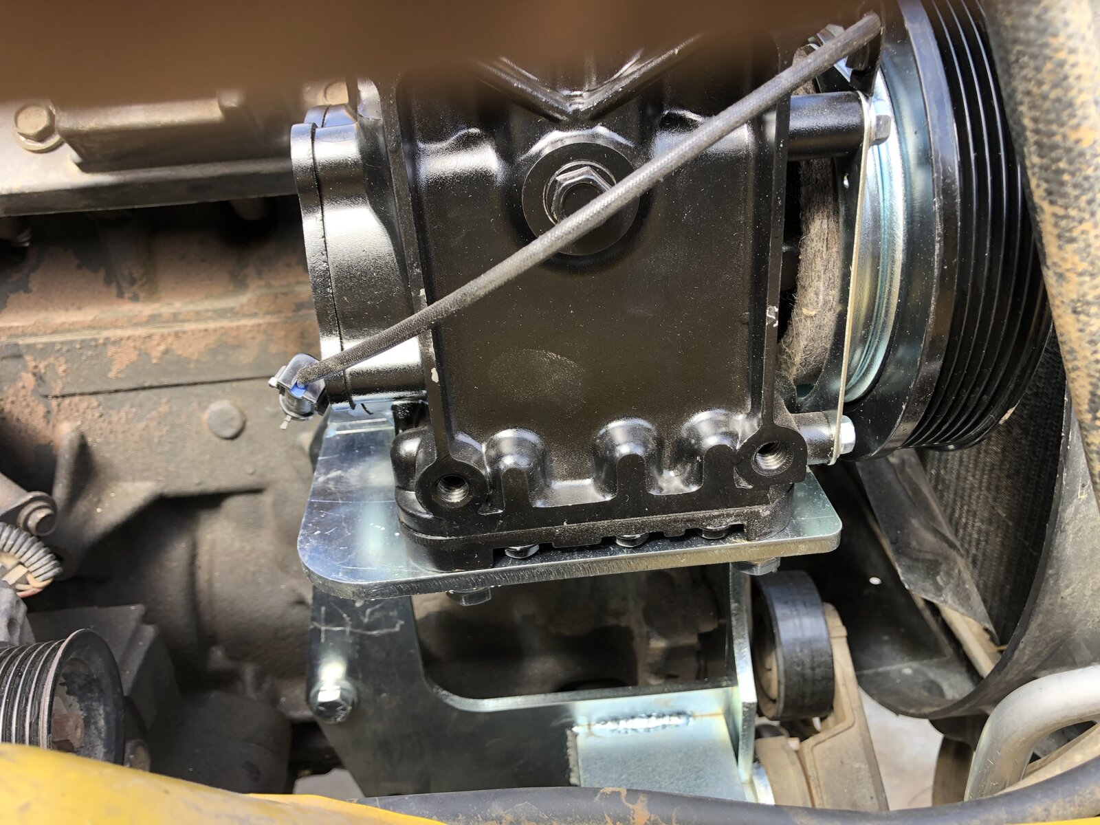

then attach the bracket to the engine with the supplied hardware. The final bottom bolt that was supplied was to short so I had to get a longer one. This seems to be a common issue. One the bracket is attached you test fit the alternator to make sure the block fits in the alternator fork.
once your check the alternator fitment you remove it and install the York.
then install the alternator
after the alternator is attached is the supplied idler pulley, I used the smaller of the two they supply, then route your belt.

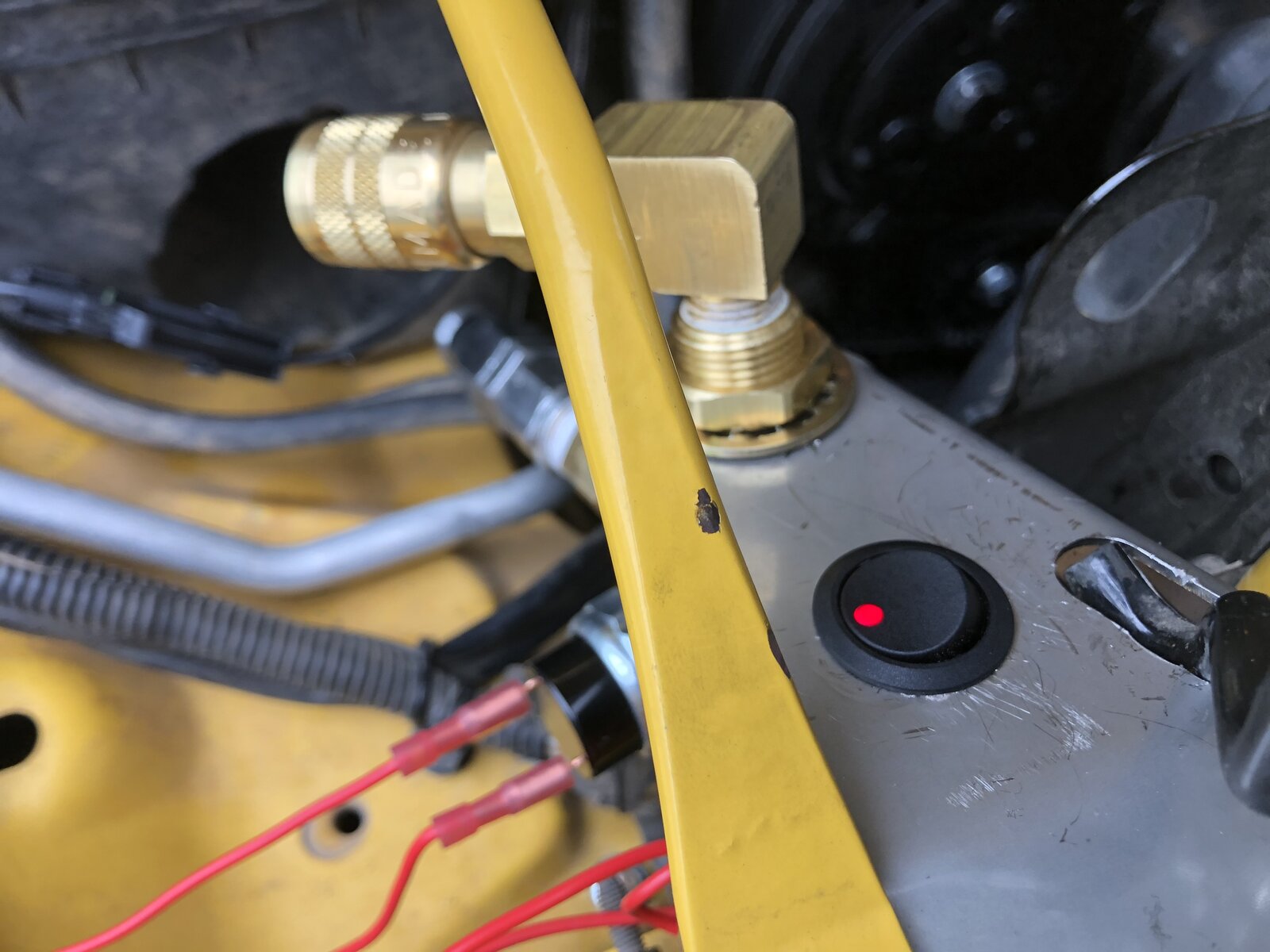

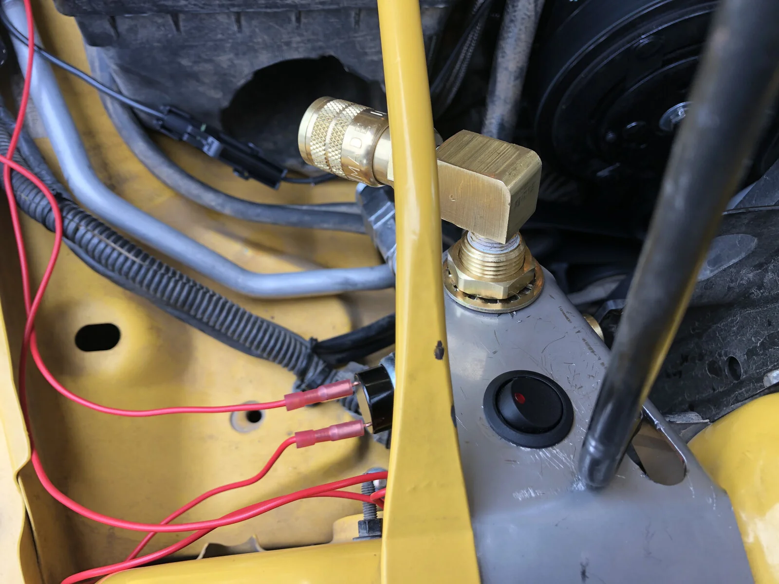

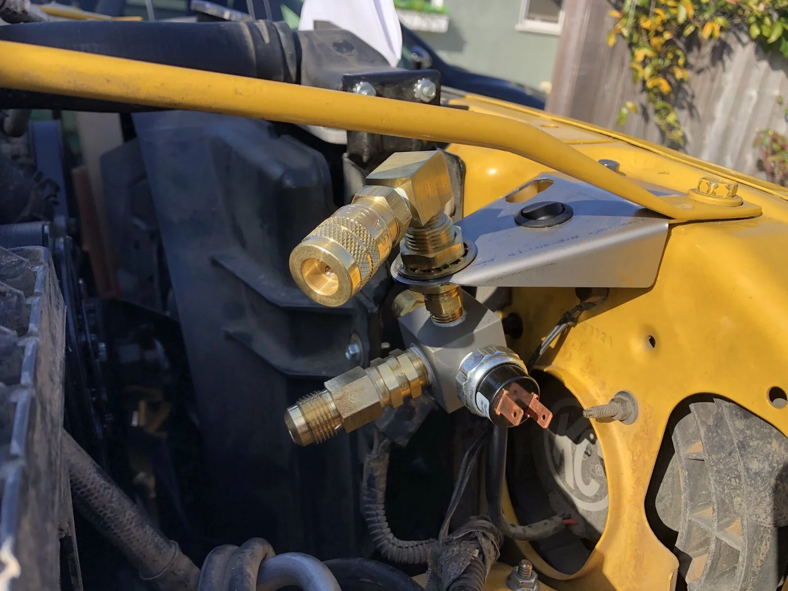

next is your bracket with the manifold, pressure switch, and quick connector. I didn’t want my rocker switch in the jeep so I drilled a hole in the bracket and mounted the rocker switch to the bracket.
now all that is left to do is plumb your lines, reattach your alternator wiring and wire up the supplied wire harness for the York. Overall a relatively simple project.
Now I finally have my own air supply!
First remove your belt, airbox, and alternator.View attachment 234608then remove your belt tensioner from the alternator bracketView attachment 234609Next remove your alternator bracket.View attachment 234610then attach the belt tensioner to the supplied bracket from the kit.View attachment 234612then attach the bracket to the engine with the supplied hardware. The final bottom bolt that was supplied was to short so I had to get a longer one. This seems to be a common issue. One the bracket is attached you test fit the alternator to make sure the block fits in the alternator fork.View attachment 234613once your check the alternator fitment you remove it and install the York.View attachment 234614then install the alternatorView attachment 234615after the alternator is attached is the supplied idler pulley, I used the smaller of the two they supply, then route your belt.
next is your bracket with the manifold, pressure switch, and quick connector. I didn’t want my rocker switch in the jeep so I drilled a hole in the bracket and mounted the rocker switch to the bracket.View attachment 234617View attachment 234618now all that is left to do is plumb your lines, reattach your alternator wiring and wire up the supplied wire harness for the York. Overall a relatively simple project.View attachment 234622View attachment 234623View attachment 234624View attachment 234625Now I finally have my own air supply!

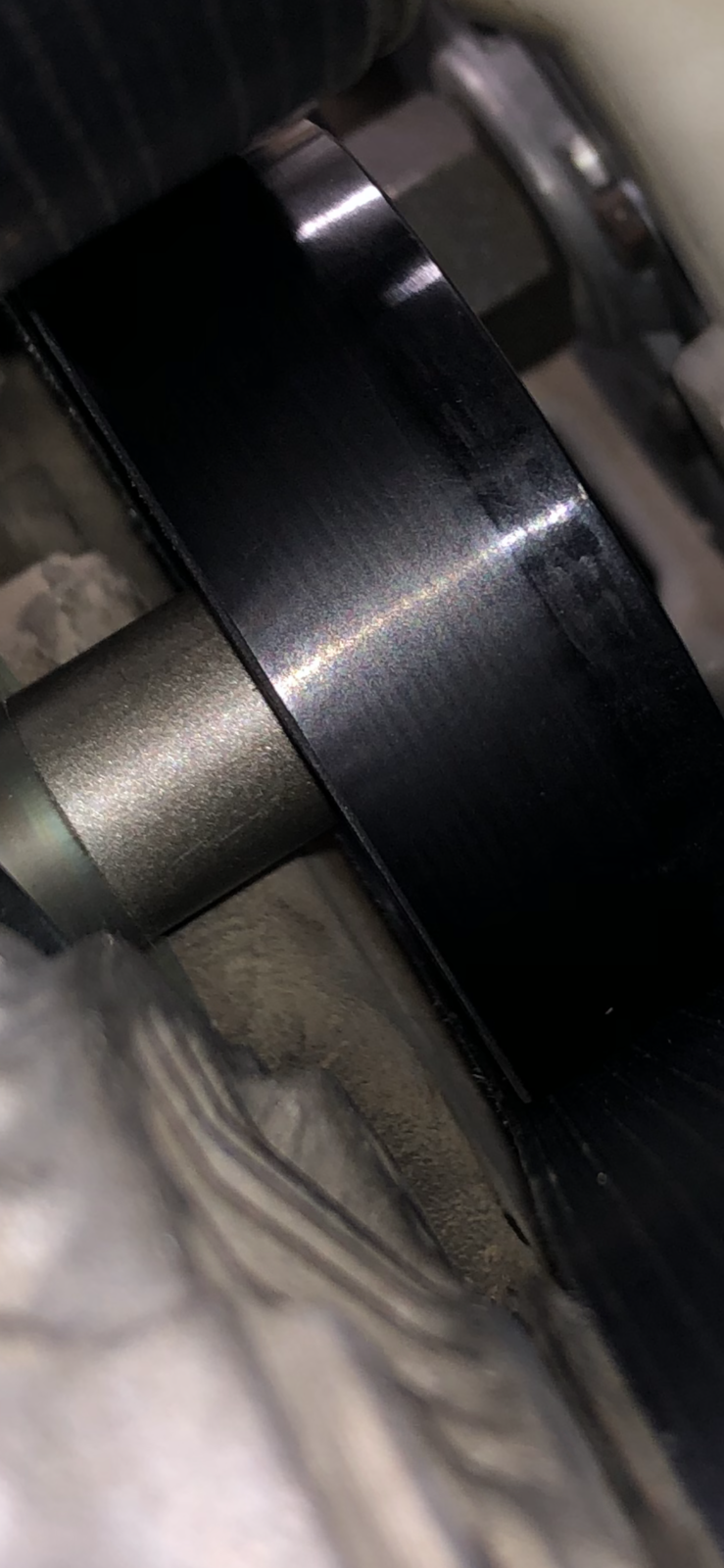

I can see from your last picture that your ORO bracket is just as fucked as the one I just got. The forward face of the bracket sticks out too far. Your belt is hanging off the inside edge of the new idler pulley. Take a good look at your tensioner pulley as well because my belt was hanging off that one too.
Ive been in contact with steve at ORO and he has been very friendly. He hasn’t offered to send me a new bracket yet but we already fixed my problem. We cut .150” off the new idler stand off and put a washer between the tensioner arm and tensioner pulley. Now all my pulleys are aligned correctly.
Yeah it’s not quite hanging off but it’s right even with the back of the pulleys. Still something that needs to be addressed
This seems like an easy enough fix.
Reactions: Alex01
Certainly not difficult if you have a way to trim the spacer square. Still disappointing considering how much they charge for the product.
