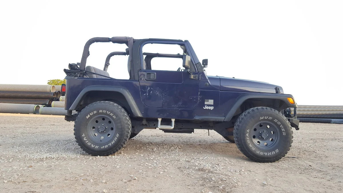

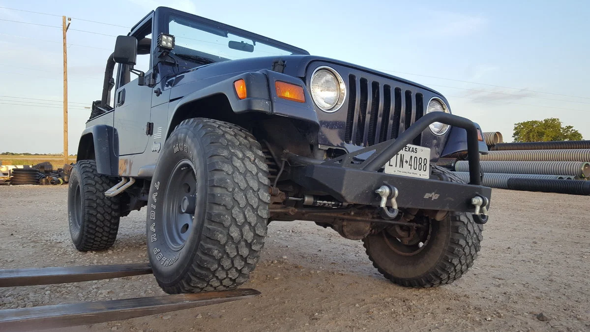

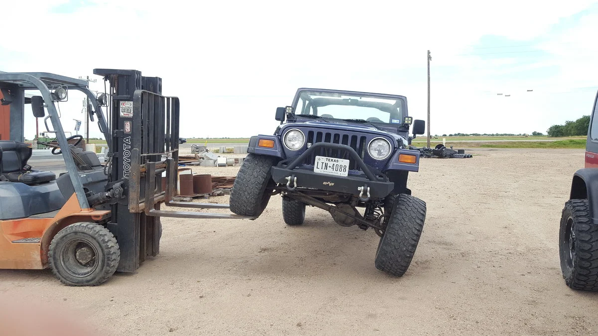

I had to laugh when I noticed that your very first picture had a Wells Fargo bank in the background. Yeah, because you'll be getting very familiar with withdrawing money from some form of baking institution, now that you own one of these! Also, your second picture has a "TJ Maxx" sign in the background. Gonna name your little rig "Maxx"? Somehow seems appropriate, given the picture. ;)
Yeah I've noticed that to! Another coincidence is my initials are TJM.:cool:

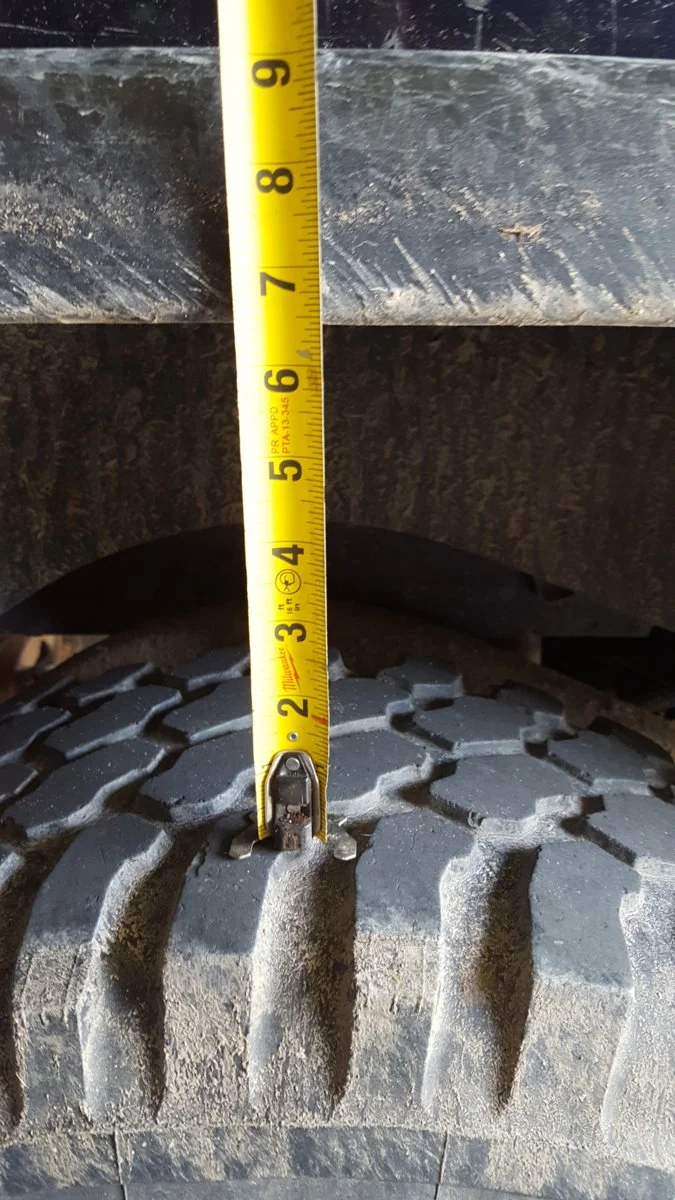

On another note, it looks like it might be a bit before I get the lift ordered. So I'm thinking about getting some spring spacers for the front to take care if some of the rake. I didnt want to go this rought but... From the measurements it looks like I could use about a 1.5 or 2 inch spacer. Technically I don't think that should cause any problems but am I overlooking anything or should this work.

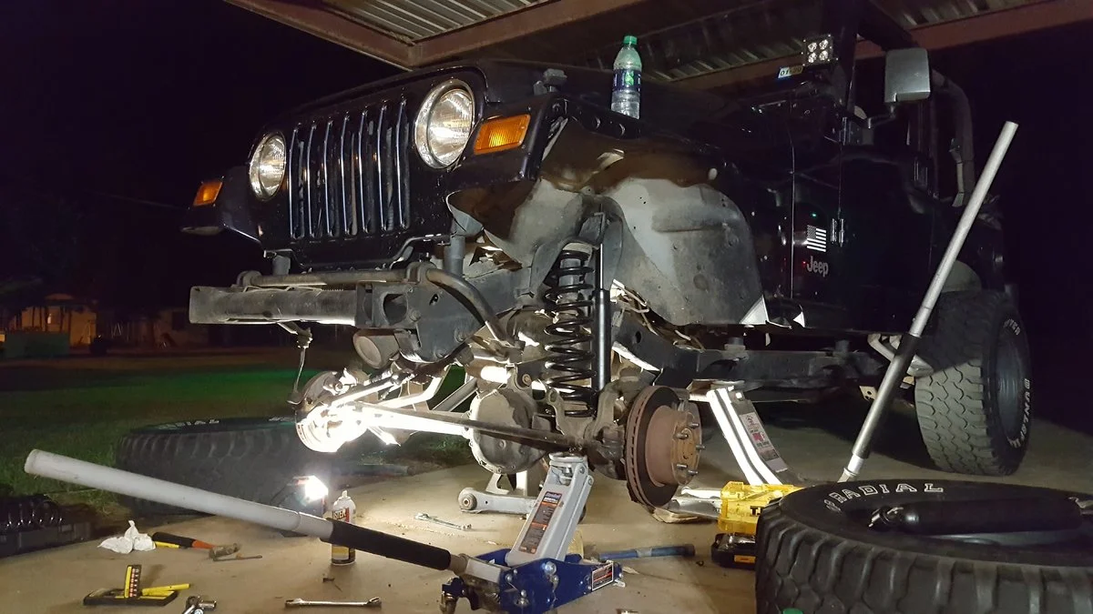

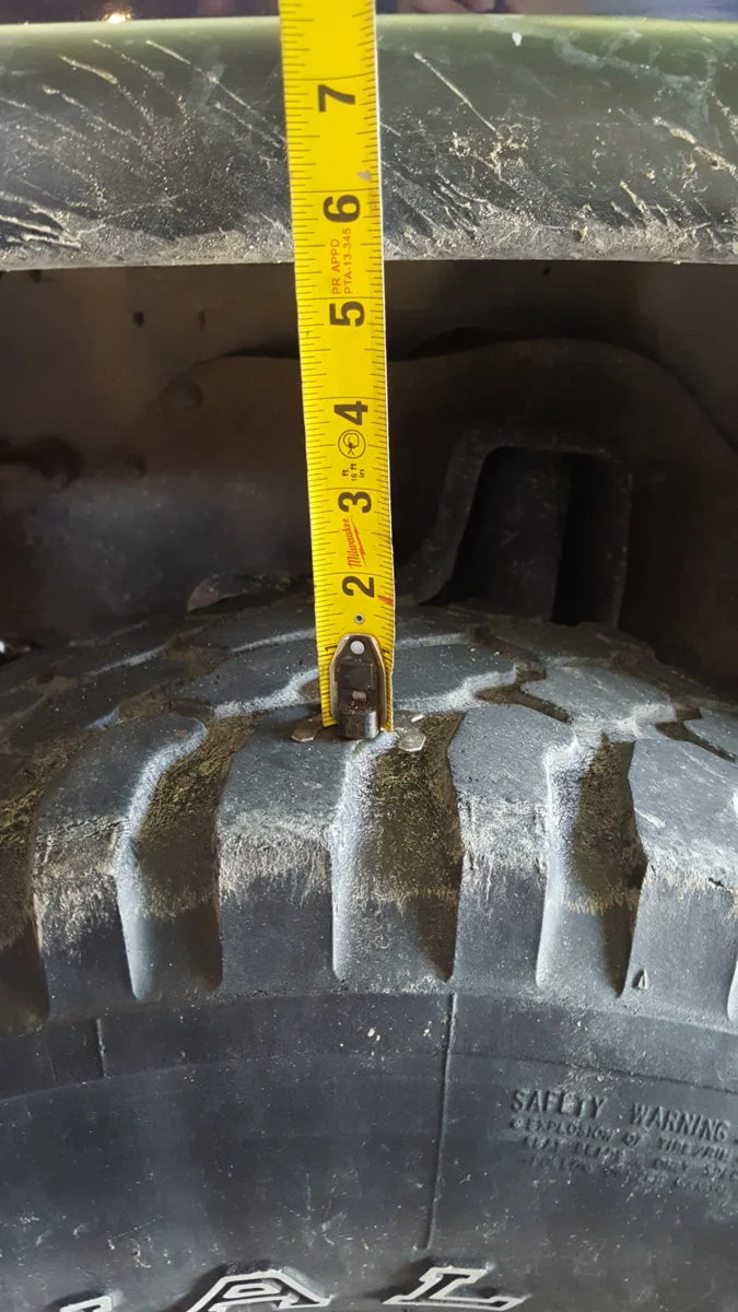

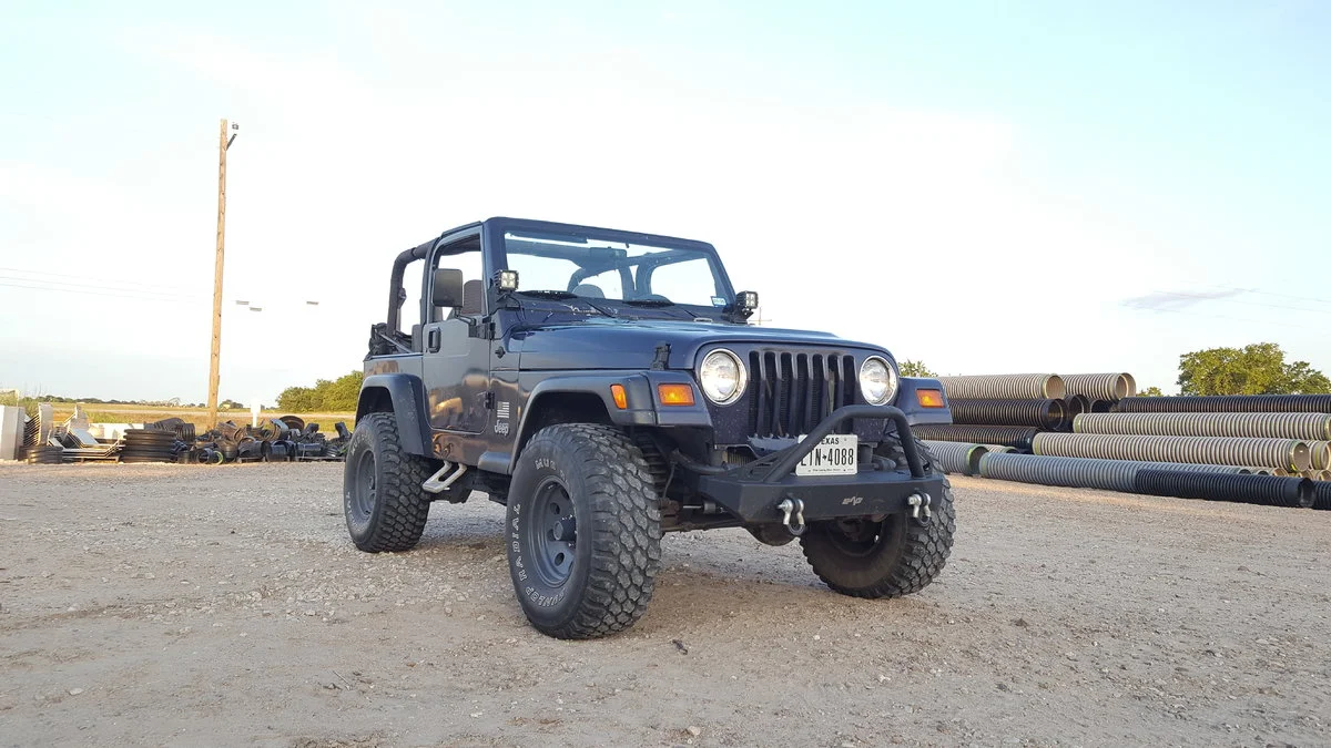

Alright so got the lift is done (need to connect front swaybar yet), and the body lift removed! I can't explain how happy I am with it and will it'll fit my needs perfectly. Tommorow I'm going to quik go check my travel measurements and double make sure nothing is binding. I'll get some pics tommorow also.
Reactions: Chris and Kiwi TJ
Hoping to soon get a UCF skid and SYE to get rid of the T case drop. Probably won't be for a year though.

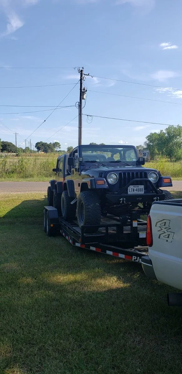

Also test fitting on the trailer. We're almost a foot short so out comes the metal, torch, and welder to build some temporary extensions.
