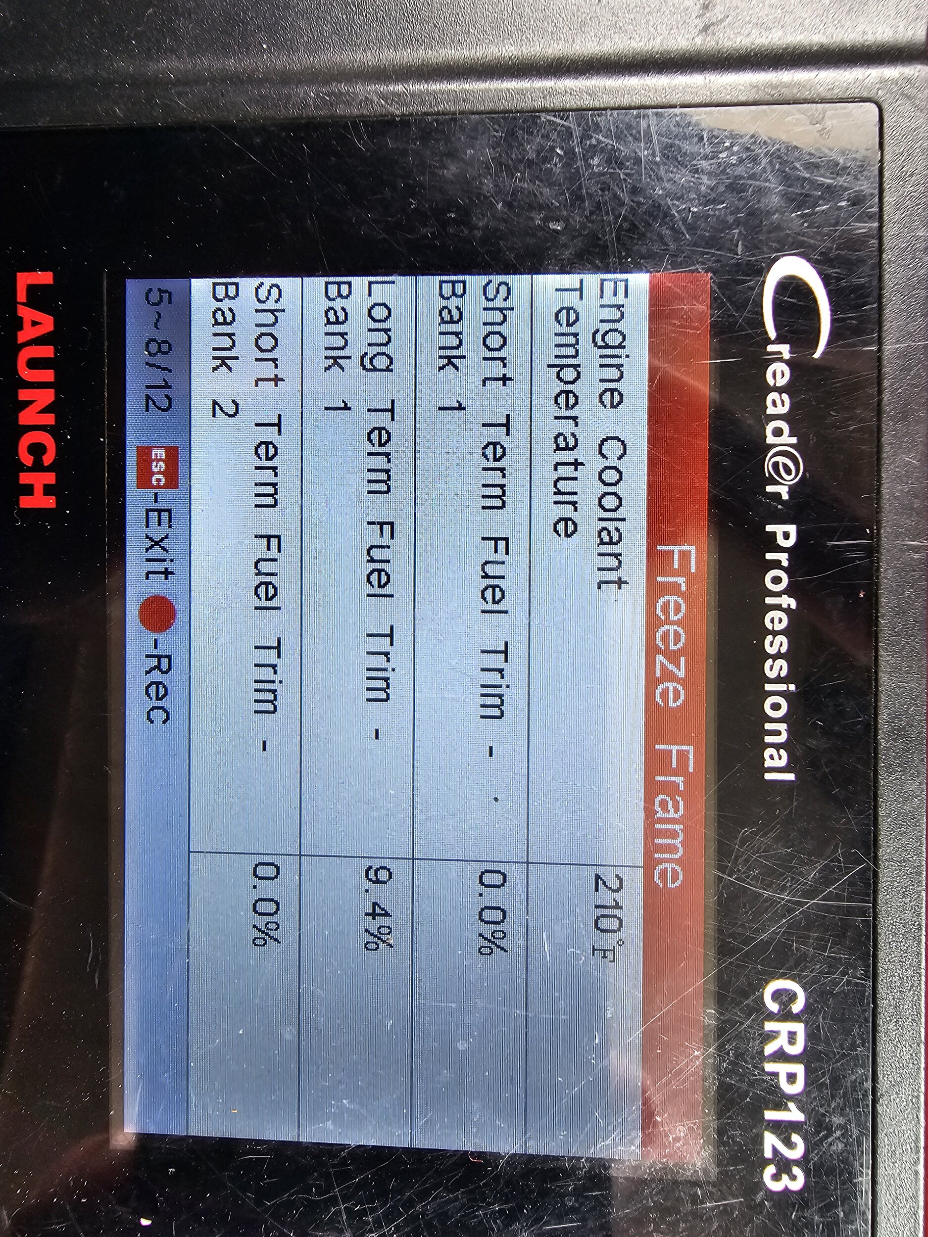

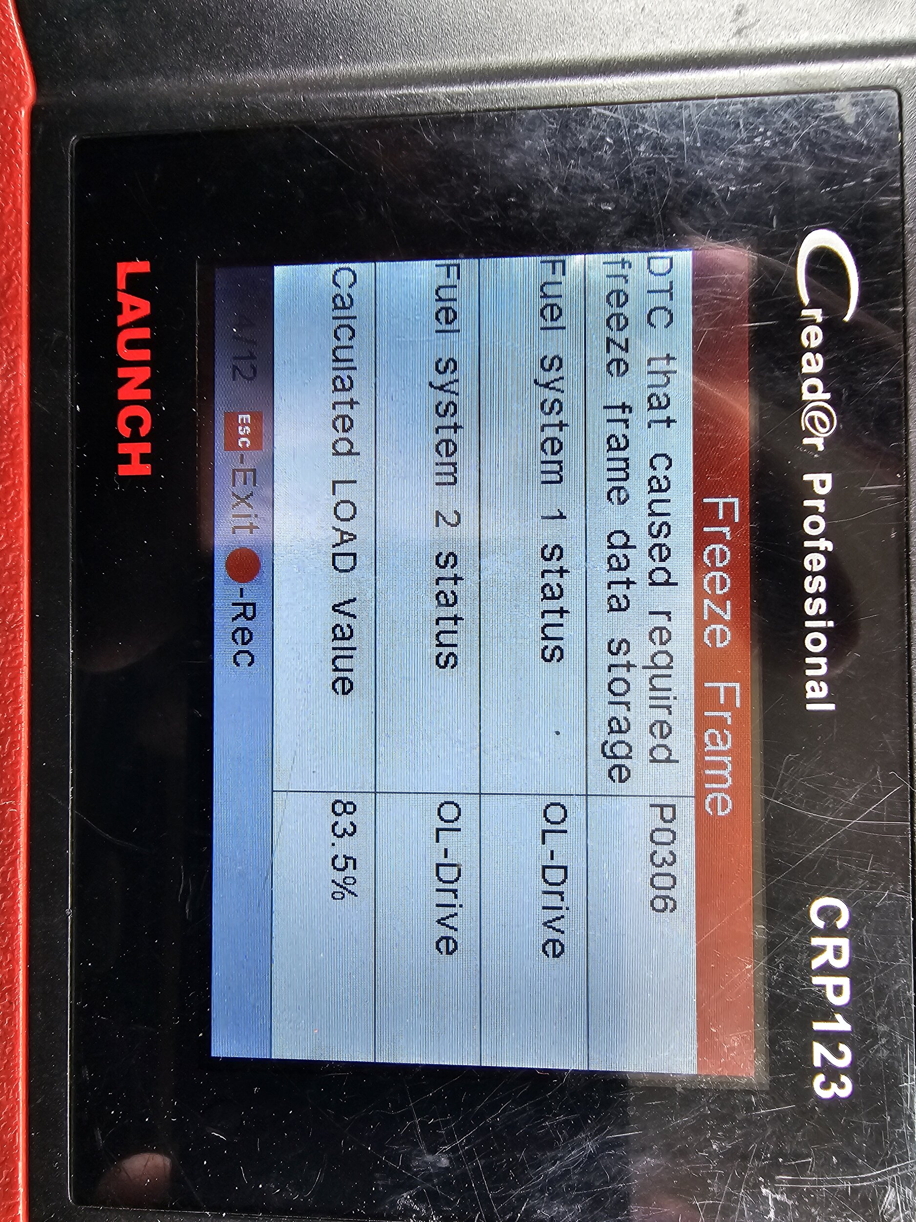

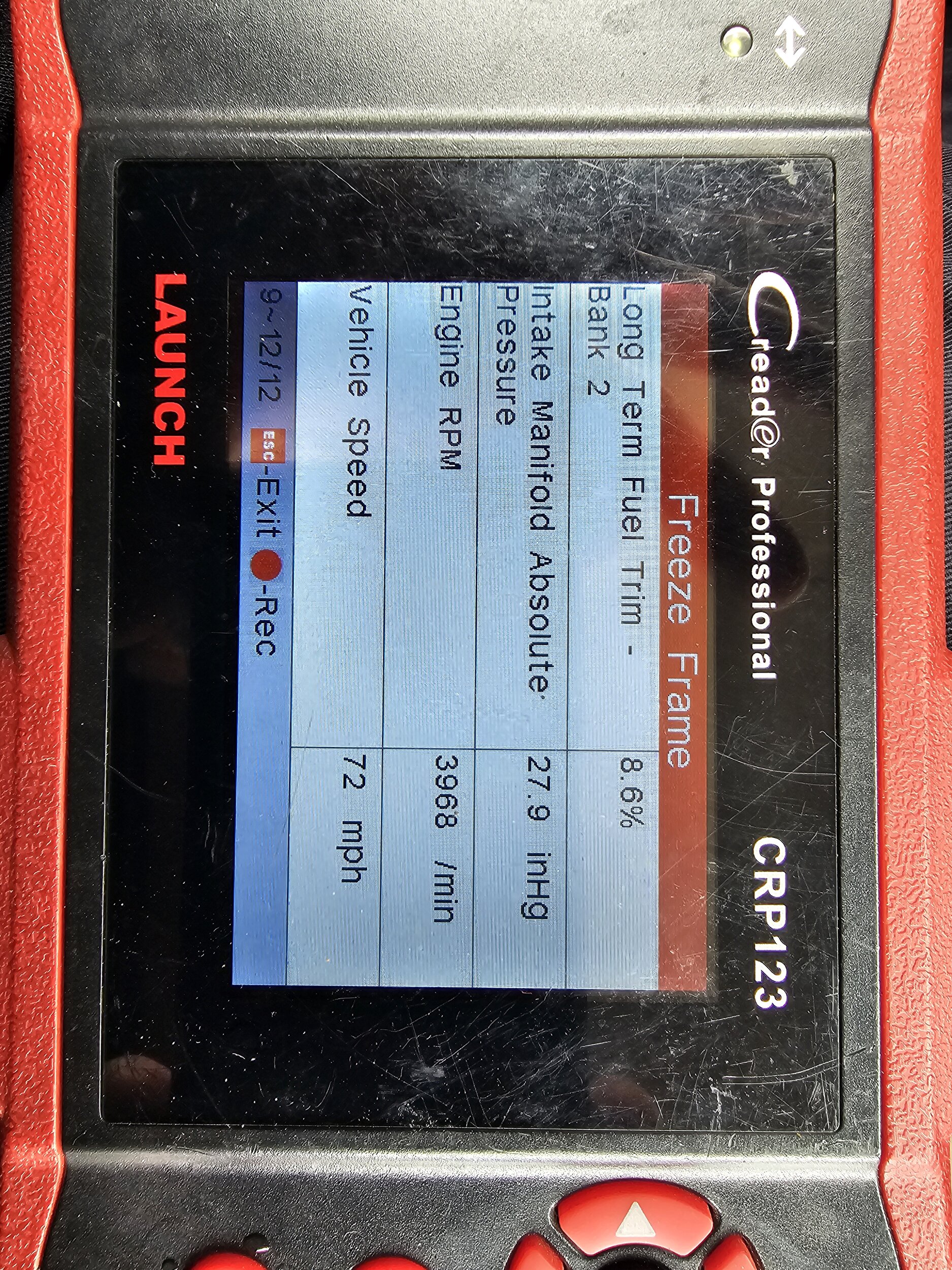

I figured I would get it to hard fault and upload the freeze frane data. Maybe it triggers something.
According to these readings the fuel system is not being adjusted by the ECM. (Not in closed loop).
Reactions: macleanflood
@Rygrego excellent points and thanks for fixing my error.
All the more reasons I want to see what those O2 sensors are doing.
Something is keeping this engine on open loop...my gut tells me if we find that we get closer to a solution.
-Mac
