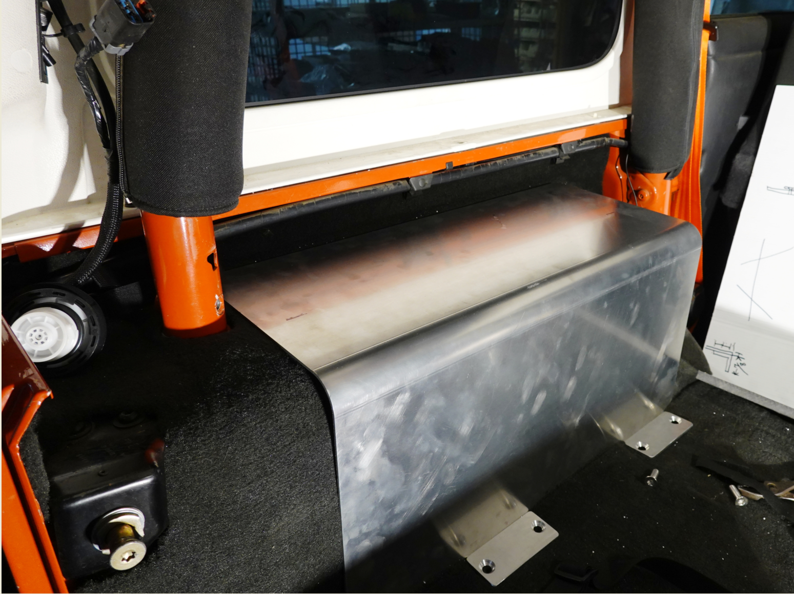

A few small details are left to do, some of which are already done like finishing the corner welds. The small pulleys for the cable supports are on the way. They will stop the drop level about where I have it propped in place. The actual amount will be about 1" more than the overall depth of the basket.
The straight-edge shows how far it sits above the side roll bars so as to not intrude on the visual space when looking out the rear view mirror or across from the sides.

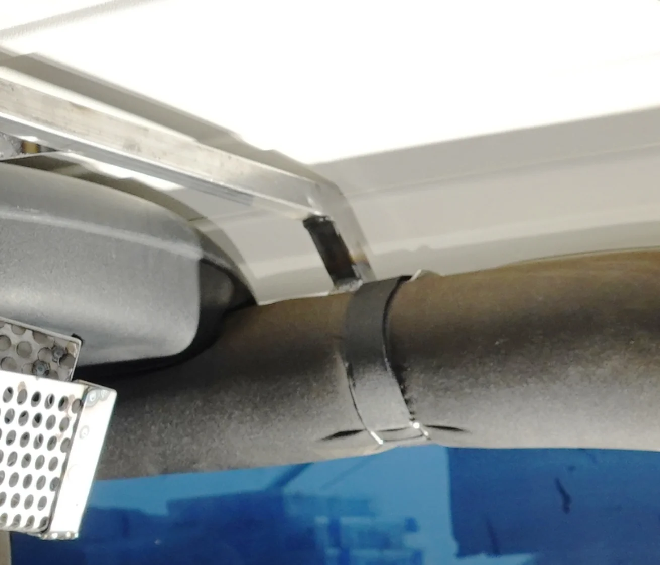

Will the bracket be welded to the sport bar? or some type of cold connection such as a clamp?
At the front, there is a 14 gauge flange that sticks forward and one that sticks down. The forward flange rests on top of the B pillar. The down flange butts up against it and has the hinge at the lower end of it. At the rear of the flat flange are two slots we cut which accept the same backpacking type velcro straps you see around the roll bar in the pic below. They hold it down and forward. The cross bar has feet with turned up ends that straps go around. It doesn't try to move at all when strapped in place and it takes about 2 minutes to install or remove it.

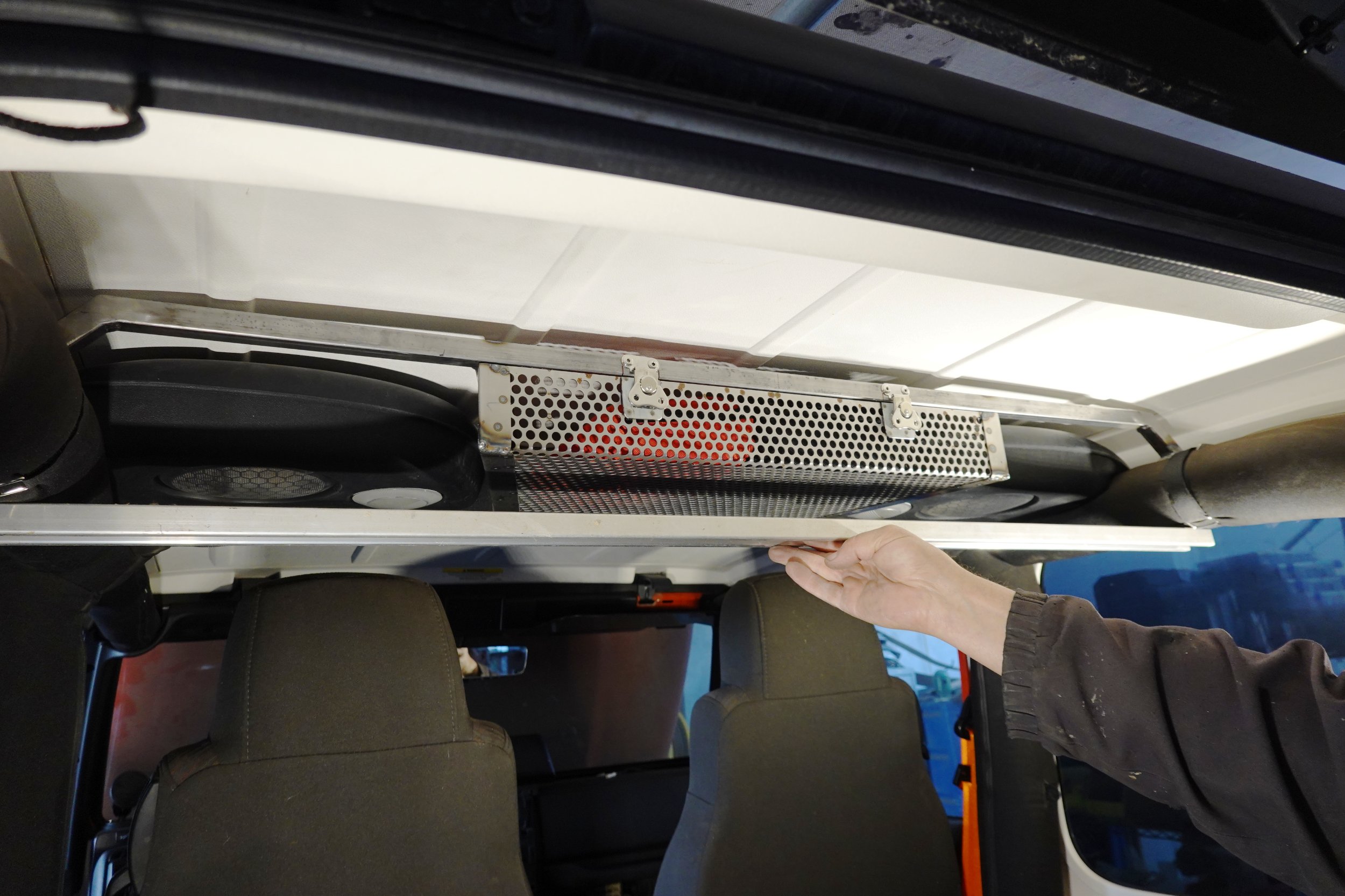

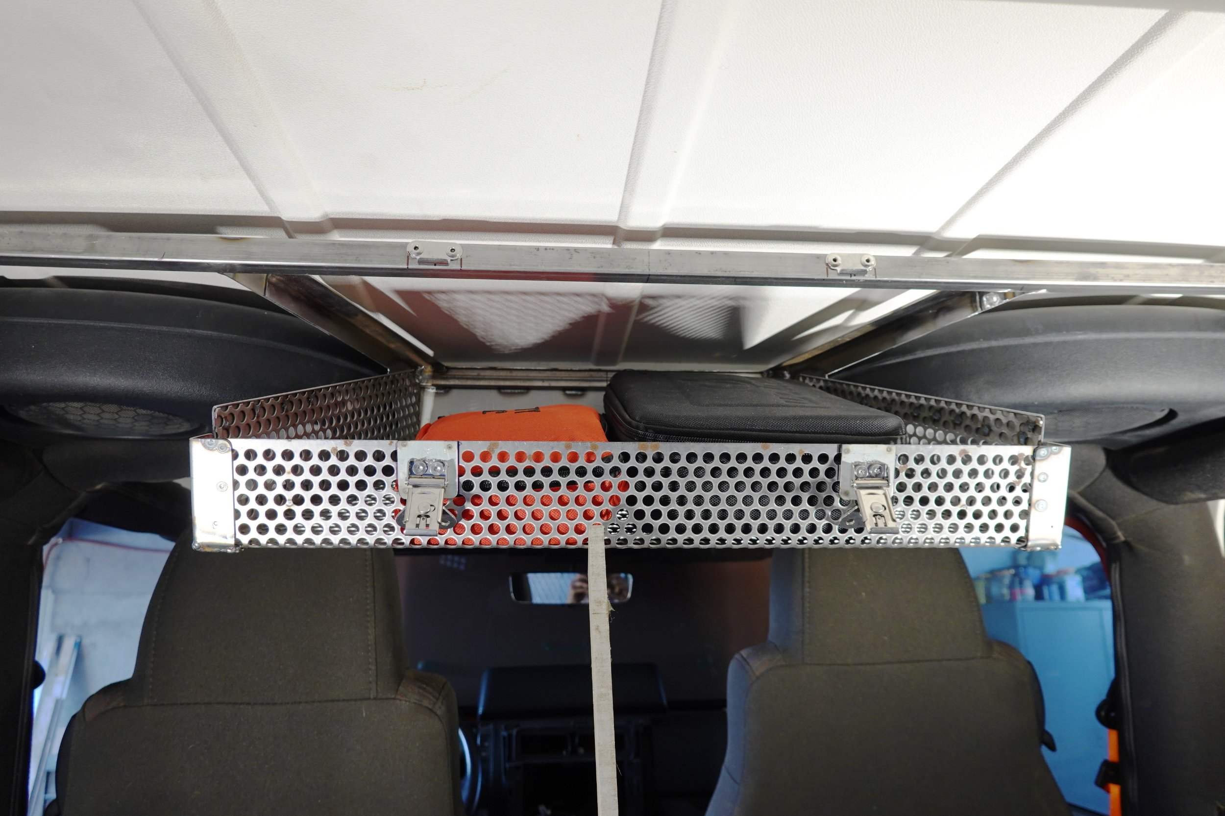

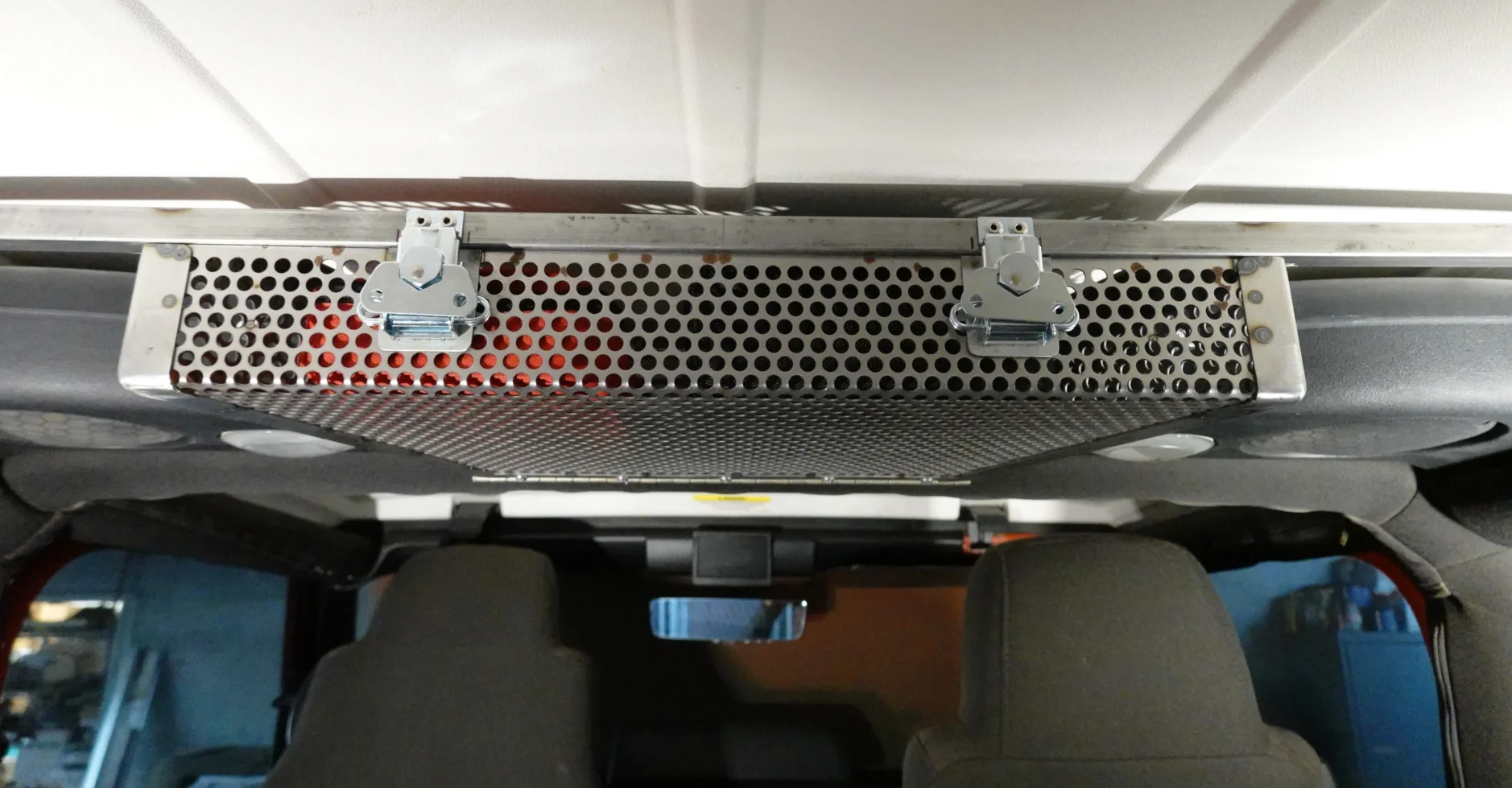

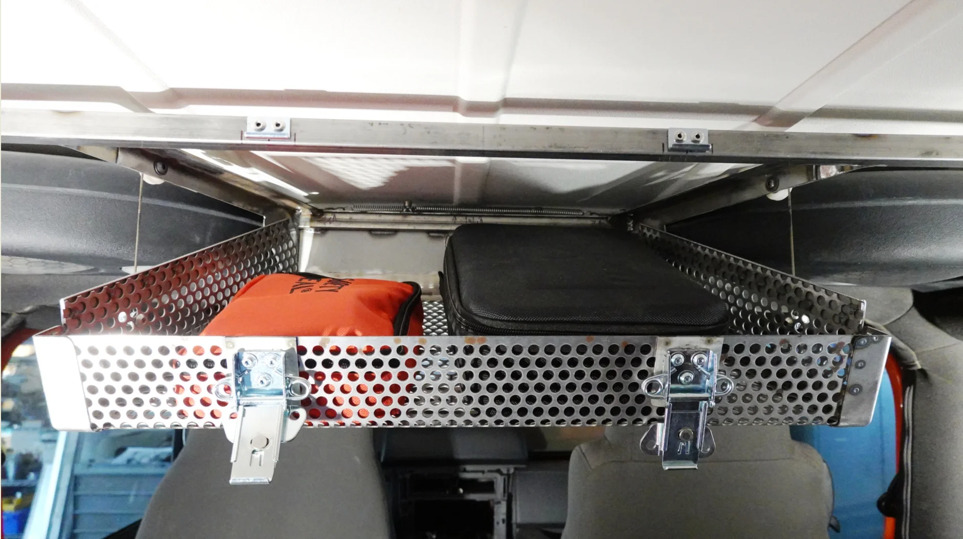

Blaine finished the final details of the overhead storage. He made spring loaded cables with stops so that it opens the right amount. He also added a nice set of latches in the front. This compartment will store my safety seal tire repair kit and a pair of GMRS radios. I will keep a pair of extra gloves in there.
I really love how Blaine conjured up a use this otherwise dead space.
Open ...
and closed.
Very cool to see Blaine taking some artistic, yet very functional endeavors to your rig. What steps were taken to ensure that the storage rack won't make a bunch of noise whilst off roading?
Blaine hates rattles, squeaks, vibrations and other irritating noises more than anyone else I know including myself. I will ask him, but the way he has designed this, there is nothing to rattle as far as I can tell down to the latches and I don't plan to keep anything loosely packed inside that compartment as well.
I do which is why I picked Southco as the rotary latch. The butterfly lever is spring loaded inside the hex so it stays wherever you put it, straight out, up, or down without moving or making any noise. The latch tongue is also spring loaded so that once the basket makes contact with the crossbar, it tightens some more against the spring which loads the basket upward so it can't move.
The other 3 points of contact are on top of the roll bar and the cinch straps are very secure. The basket is perforated metal so it can't oil can and act like a drum if the stored items happen to bounce a bit. The worst that can happen is the Safety Seal soft pouch might bounce against the hard top in which case, wrapping it in a few microfiber towels will stop that nonsense.

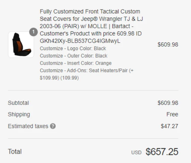

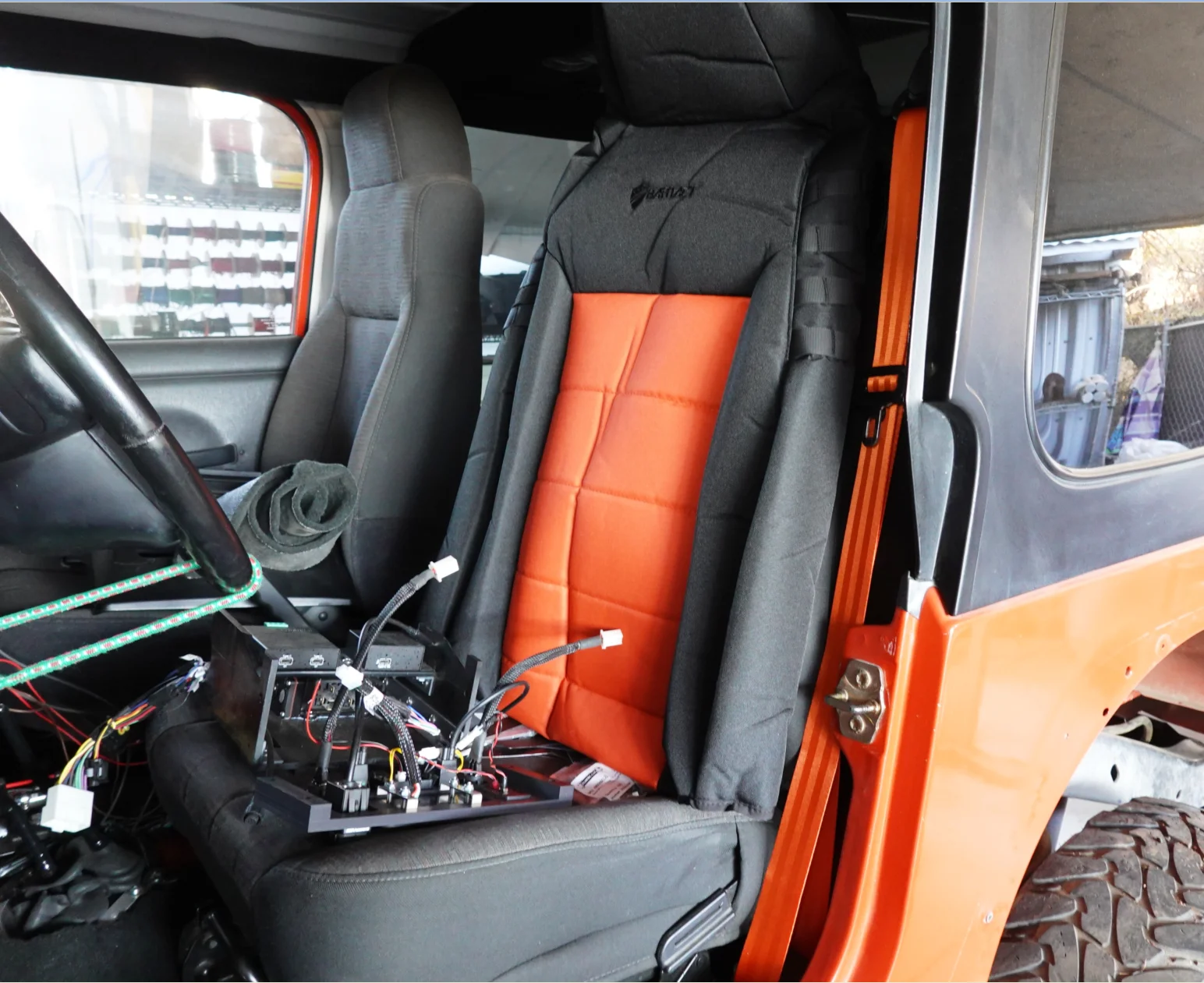

Seat covers showed up. Ordered them on 13th Oct 2024. Orange center and black logo, those were the only customizations. Prices have gone up post COVID and by not a small amount. They had still not even started after 4 months when I called Bartact last week. I had called them before thanksgiving, before Christmas and just got the usual runaround. This time I called and politely but very clearly told them if they were not interested in making mine, they should simply be honest with me and I would go elsewhere. A day after that, I got an email saying they were expediting my order. It was finished and shipped the next day after the email and we had it the day after.
I will post a pic later after Blaine puts in the seat heaters. Blaine said the orange centers would look good and that it certainly does.
