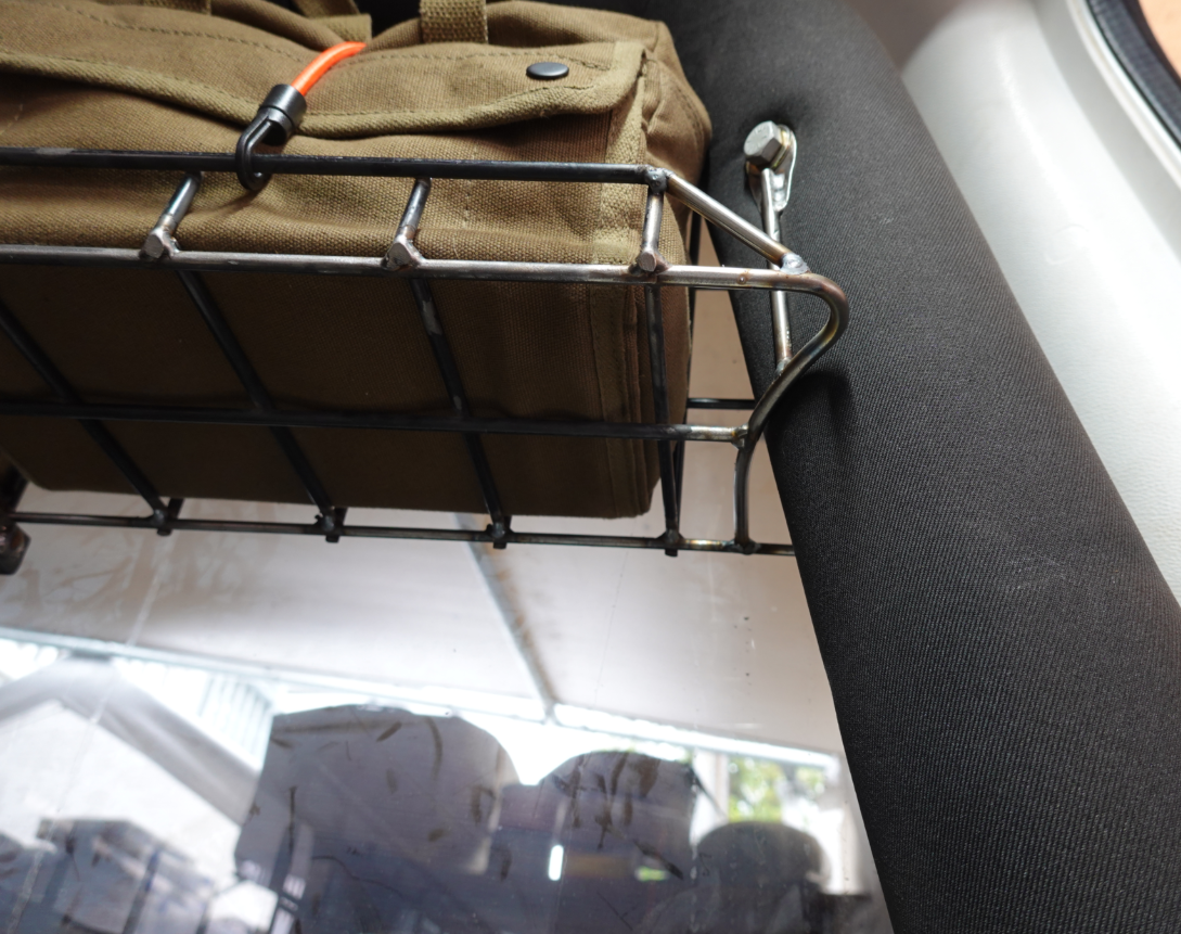

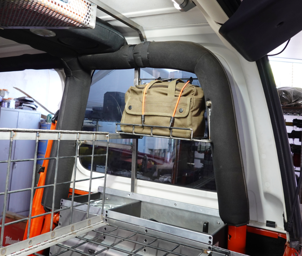

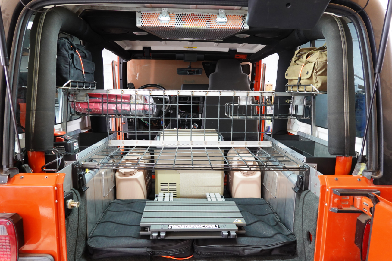

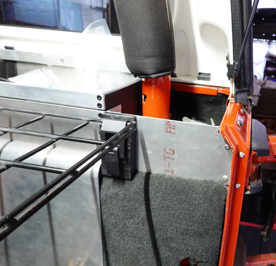

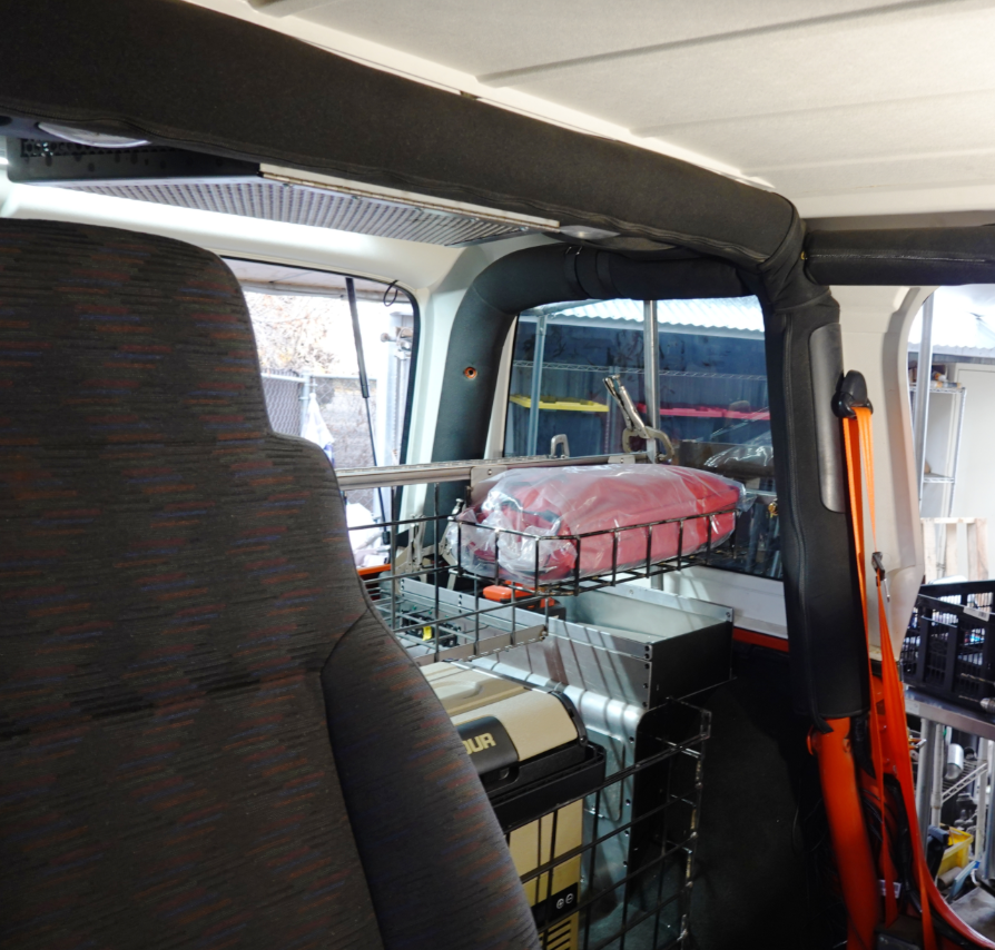

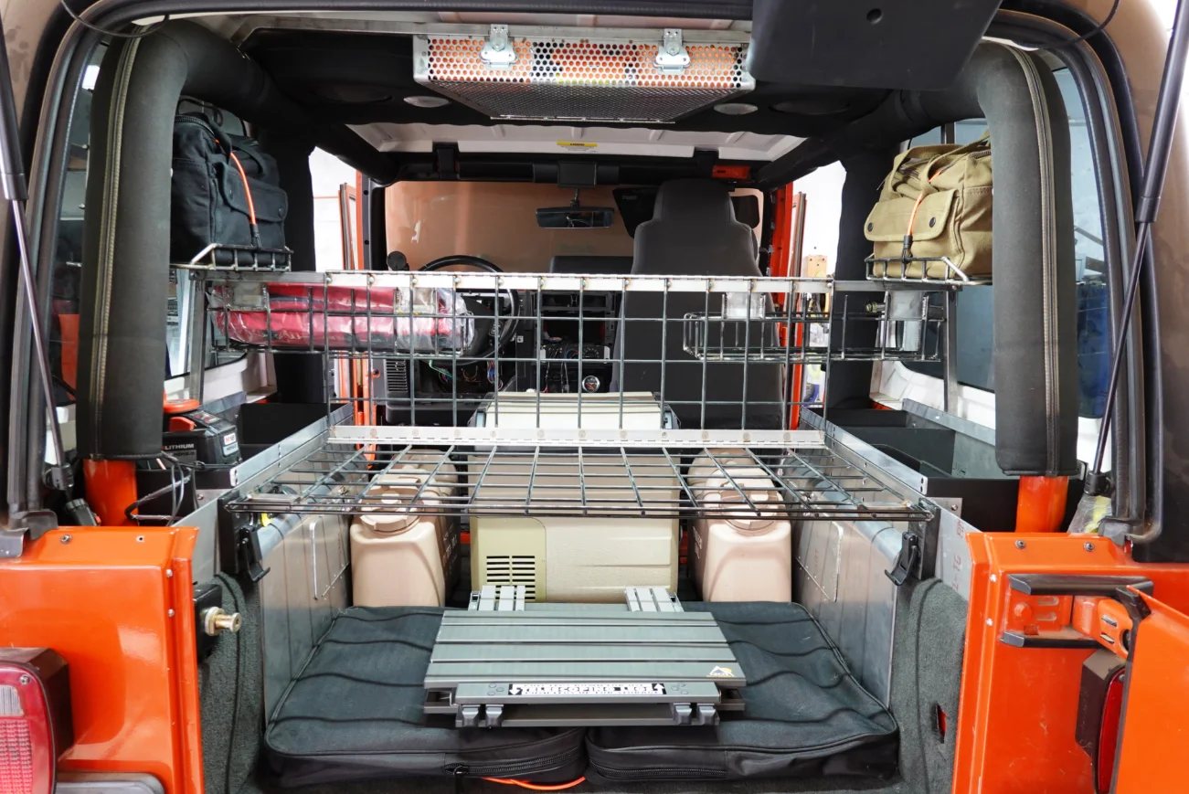

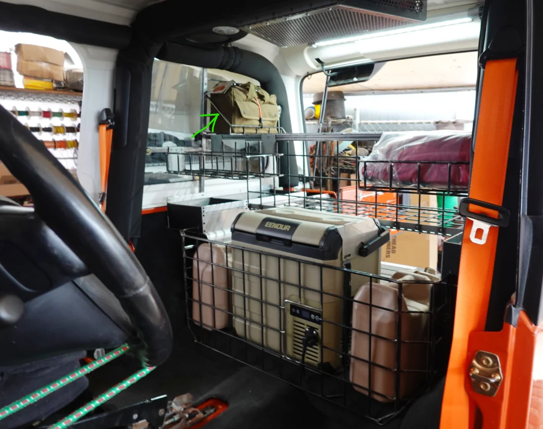

Blaine has been some doing some super nice work in the back of the Jeep. Not a full reveal, but couple photos just to show some details. That red bag is the same one I posted in previous photos .. just to show the size. I will post some detailed photos and description later.

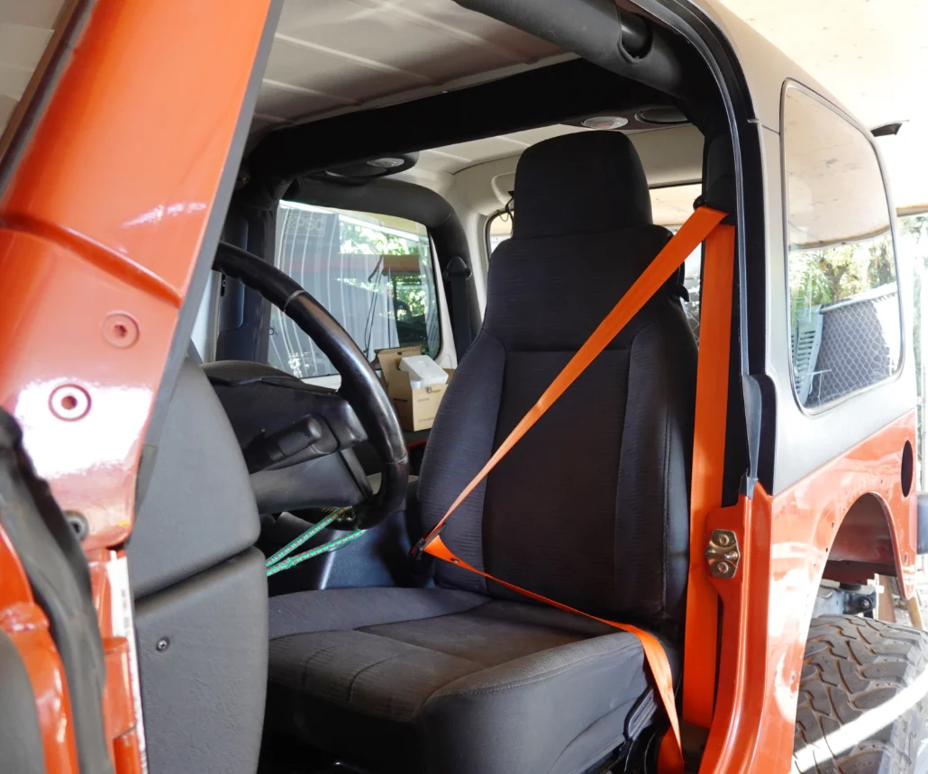

The orange seats belts are a nice touch. Where are they from?
Thank you. Blaine surprised me with that and it put a smile on my face when I saw it. Looks it came that way from the factory. With the Bartact covers with the orange center inserts it looks even better.
Think he got them from Seat Belt Restore but I will confirm with him.

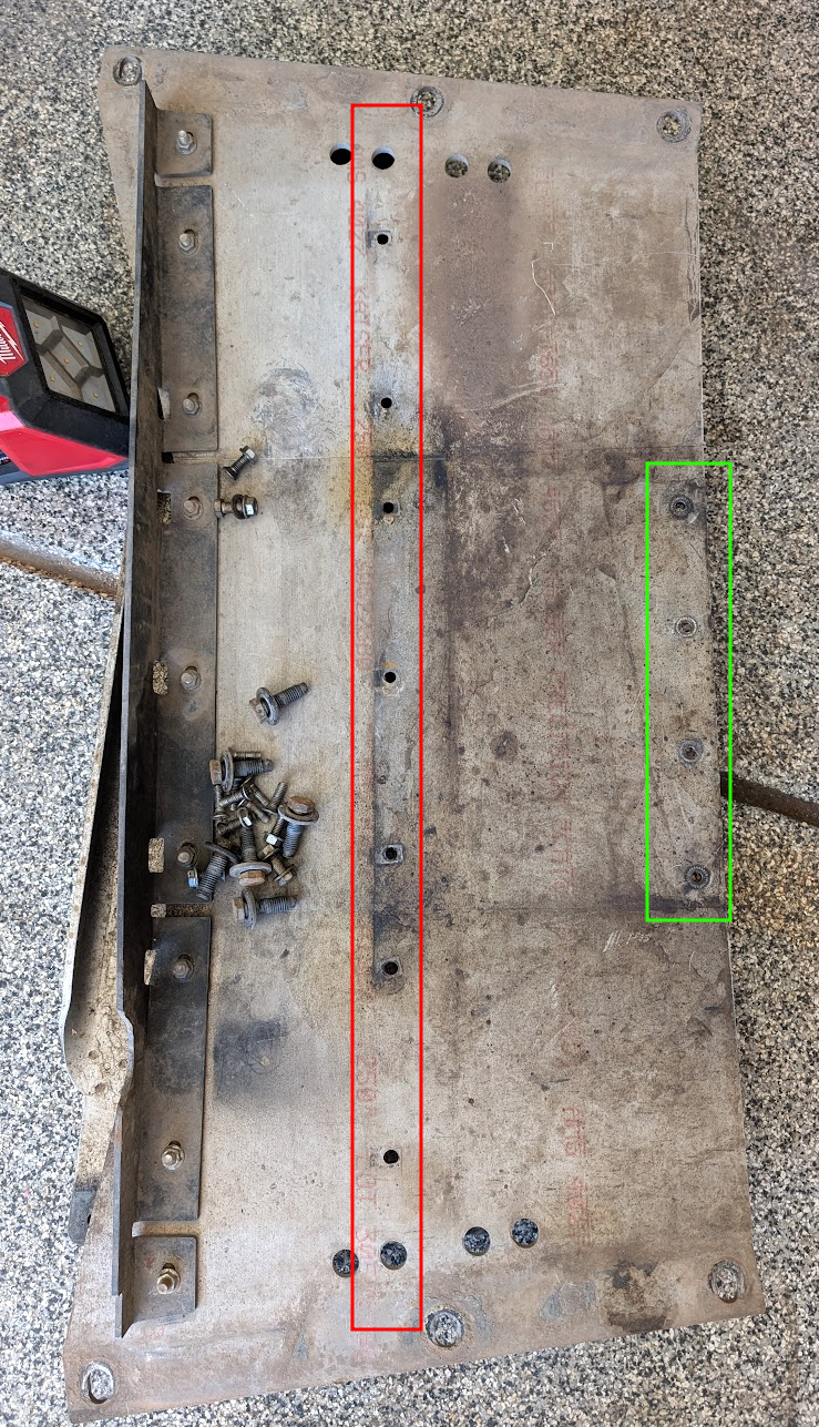

This is my filthy skid out for a bit during the midarm + remaining work - left of the image is the rear of the rig (in case you're not familiar with the frame shape). Red is the second reenforcement (which I converted into a crossmember, I can't remember who did this first but I copied @jjvw on that mod). The green/yellowish is the engine skid bolts. You can't really get the "red" stiffener too much further forward since you'd be getting all sorts of interference (I saw a guy saw his front drive shaft in half a couple years ago by having something too far forward a few years ago - I think it was the Nth degree skid's lip?).
For the rear stiffener, there's flange nuts (I don't really ever take these out, but they could be speed nuts). The new crossmember has "speed nuts" similar to those you'd likely have on your exhaust manifold - a little u-clip with a threaded segment. The front (engine skid) are also flange nuts.
Another couple improvements could be either counter sinking closer to the frame to be "flatter belly" or counter sinking the bolt heads. Blaine has done variations of both of those (and others) on his builds I believe.

I don't have any deep questions, but out of curiousity - are you leaving the rear sport bar padding in for aesthetics or is it just not worth removing?
I like the set up a lot and wish I could delete my rear seat but might try to adapt some ideas with just my LJ trunk space until my kids are older. What size are the water jugs? Have you tried lifting them in and out full? I'm sure it's doable, just curious if it's at all irritating since the angle your body will be at will be awkard.

What are the piano hinges for? For installation/storage ease or to make it somewhat "adjustable" to fit in bigger stuff? Probably the former since it is bespoke to the specific stuff you intend to carry?
Are you worried about losing visibility through the back windows? Maybe I just think that's essential because I don't have a mirror on the passenger side.
How'd you find water jugs that perfectly match the cooler?? I like seeing the cooler with everything around it. The form factor seems pretty efficient. Still waiting for Jeremy to upload pics of his to decide which one to go with 😉
I can only imagine the amount of time & effort it took to plan that out, form the mesh, & then weld it together! Perfect little welds. Very cool! I wouldn't need anything quite that elaborate, but possibly some of it.
I think the interior build is great, all of the process to make everything functional and yet looks to be removable. Makes me think on how to do some of these. from the fridge tie down bracket to the side storage and the cubbies. Over all one of the best builds that has me thinking.
