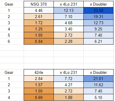

Gear ratio comparisons: 3rd gear in low is about the same as 1st in high, and 5th in low is about the same as 2nd in high. I didn't think of that until after the last time I was on the trail and I kept switching in and out of low and my shifter was binding a bit. Wish I had thought of it earlier - that's another nice thing about driving a manual and being able to pick whatever gear you want whenever you want.
These charts obviously don't include final gearing at the diffs, just trans, t-case, and potential 2nd t-case.
