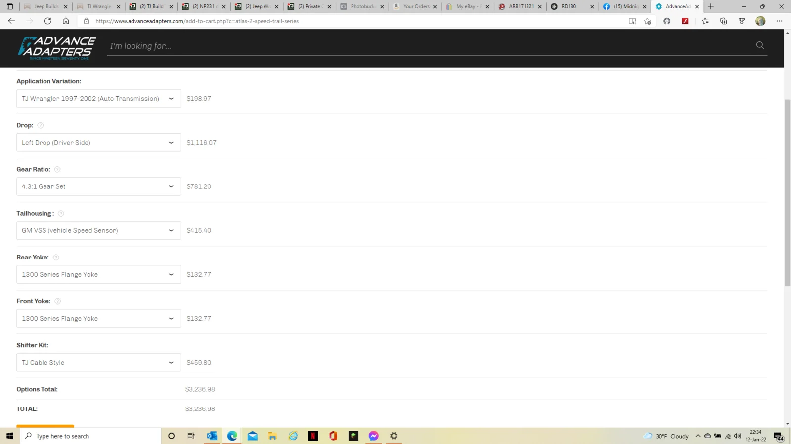

Is the 2 speed atlas over $3k?
Depending on how you option it out YES $3236.98
I was trying to compare the two built about the same way. Like if I was putting it in my Jeep.
