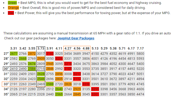

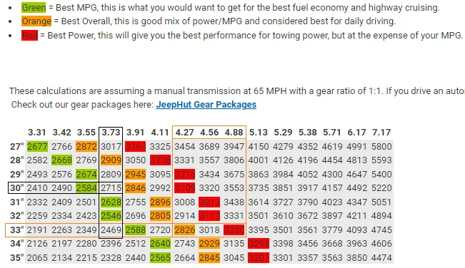

Ok, so according to this chart, I'm less than ideal with 3.73 and 33s. To get back to stock (LJ came with 30s originally) I would need to be at 4.11 gears, but that's hardly worth doing for the cost and effort involved. "Best mix" would be 4.27 gears, but that also seems like only a small gain.
Someone suggested 4.88 gears "where I should be"... I would appreciate the 30% improvement in final gear ratio at low speed on the trail, but that would also increase my highway rpms into like 4cyl range (70mph in 6th gear on 4.88s would be 2924rpm)... would the 4.0 be ok with that? If so, then I'm all for it. I'll start with regearing and see how much lower I want to go on the trail after that.
