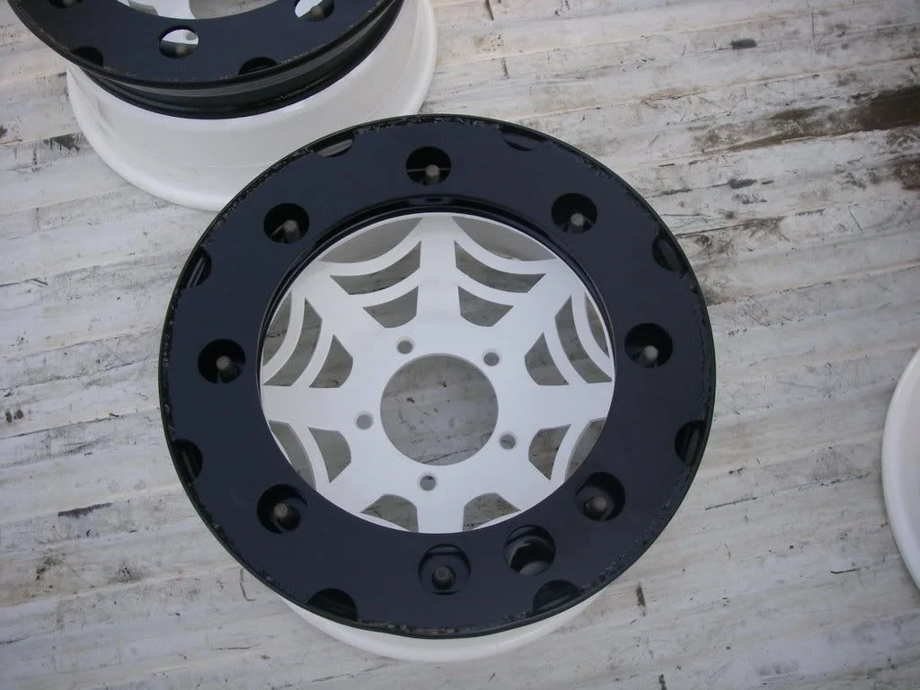

I started out on Allied beadlocks when I first built this Jeep but I kept burping my inner bead on some of the trails in the Rimrock area. A few other club members were also burping on some of the trails so it wasn't just me. At the time one member had a shop so they did a group buy of Staun inner beadlocks. I'd come across a great deal on the H1 rims and because I was familiar with them I went that route instead.

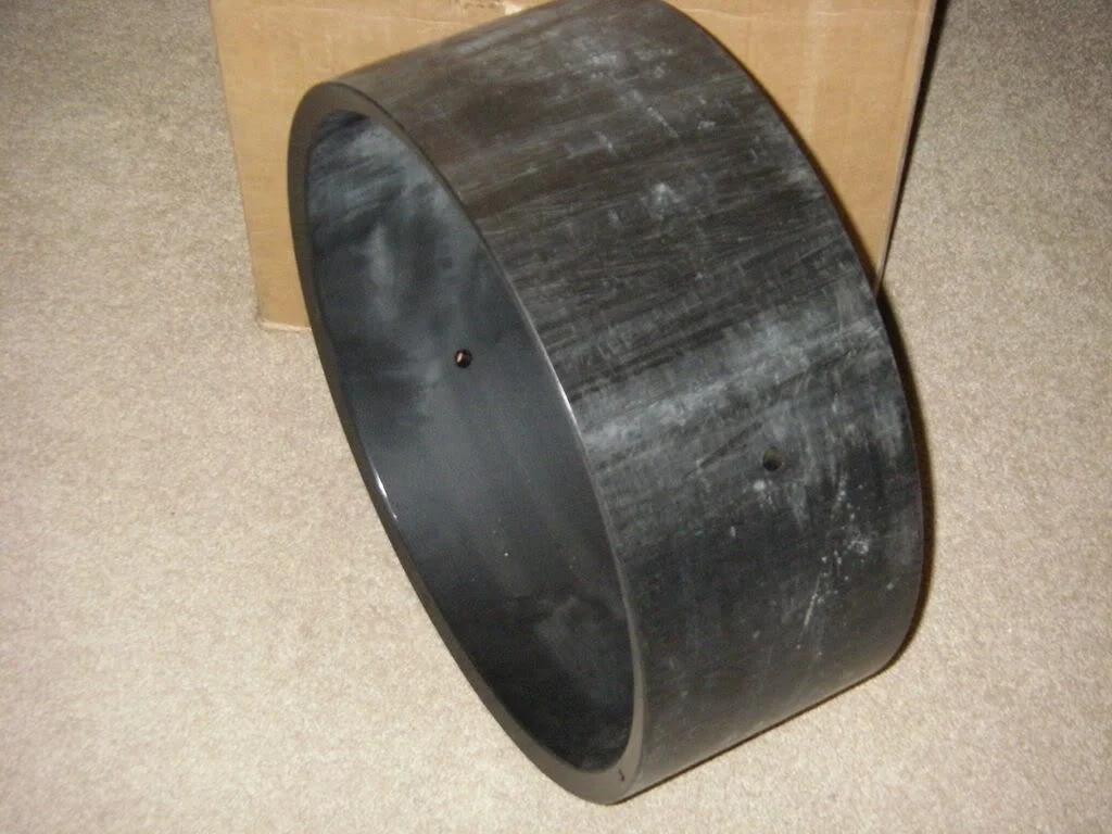

That was WAY easier than trying to get the insert into a tire for the dual beadlocks like I have.
Now getting that DANG NAB insert BACK OUT of the tire is even more of a fun time. But I'm learning tricks as I go.
Of course the insert that worked with the H1 rims doesn't work with the Staz rims so I have had to change them.
They were good lookin rims...…

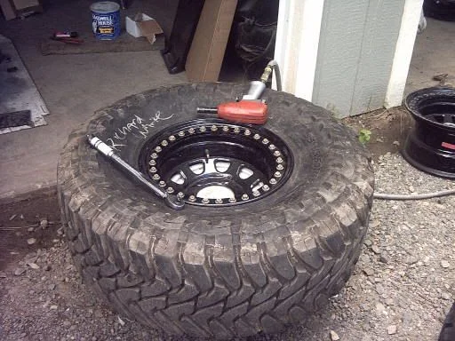

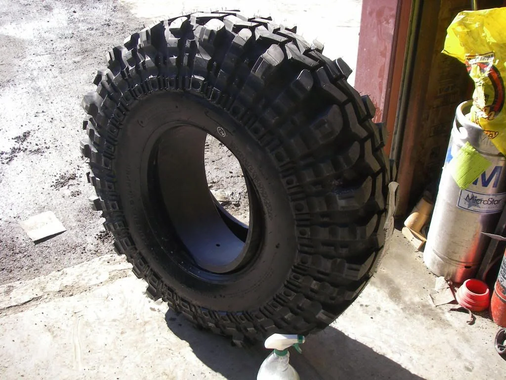

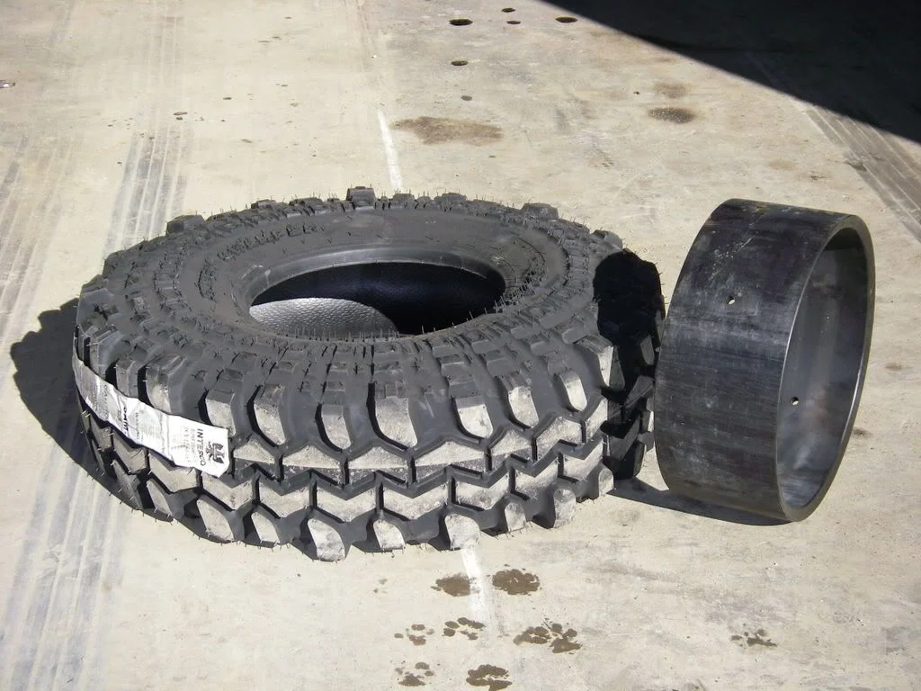

Mounting those Toyo's on the Allied rims.
Nice looking wheels for sure! Those inserts suck, lots of liquid soap!

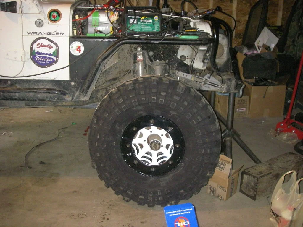

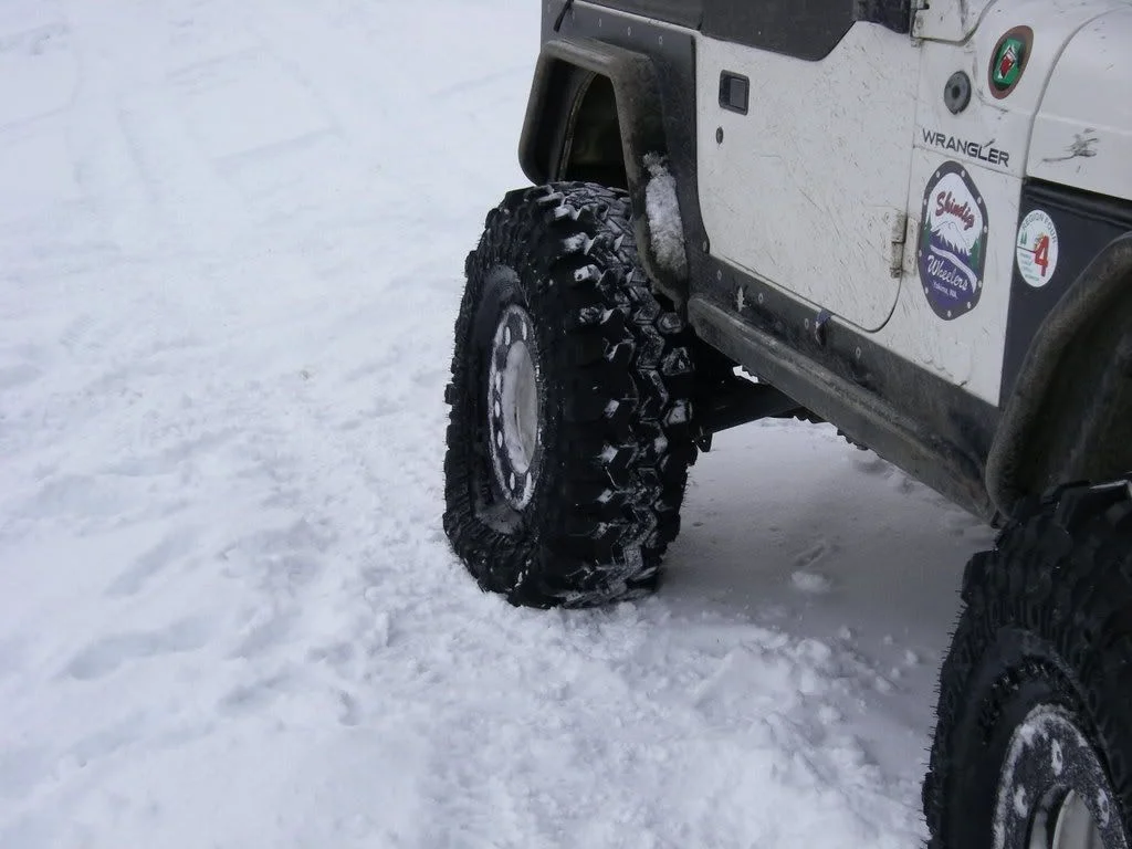

2 PSI trying out my new tires and rims....

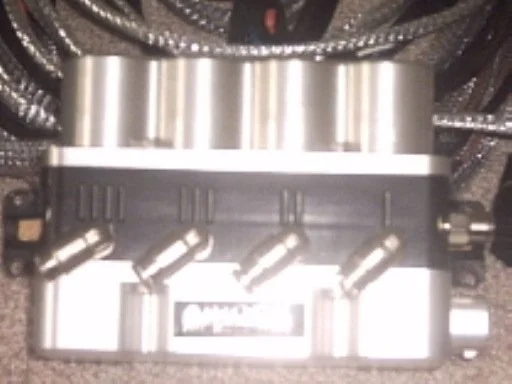

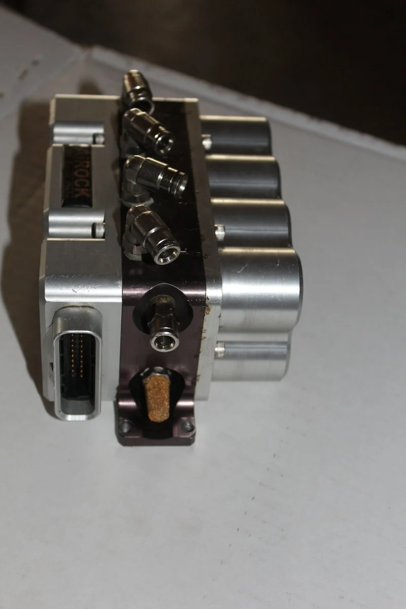

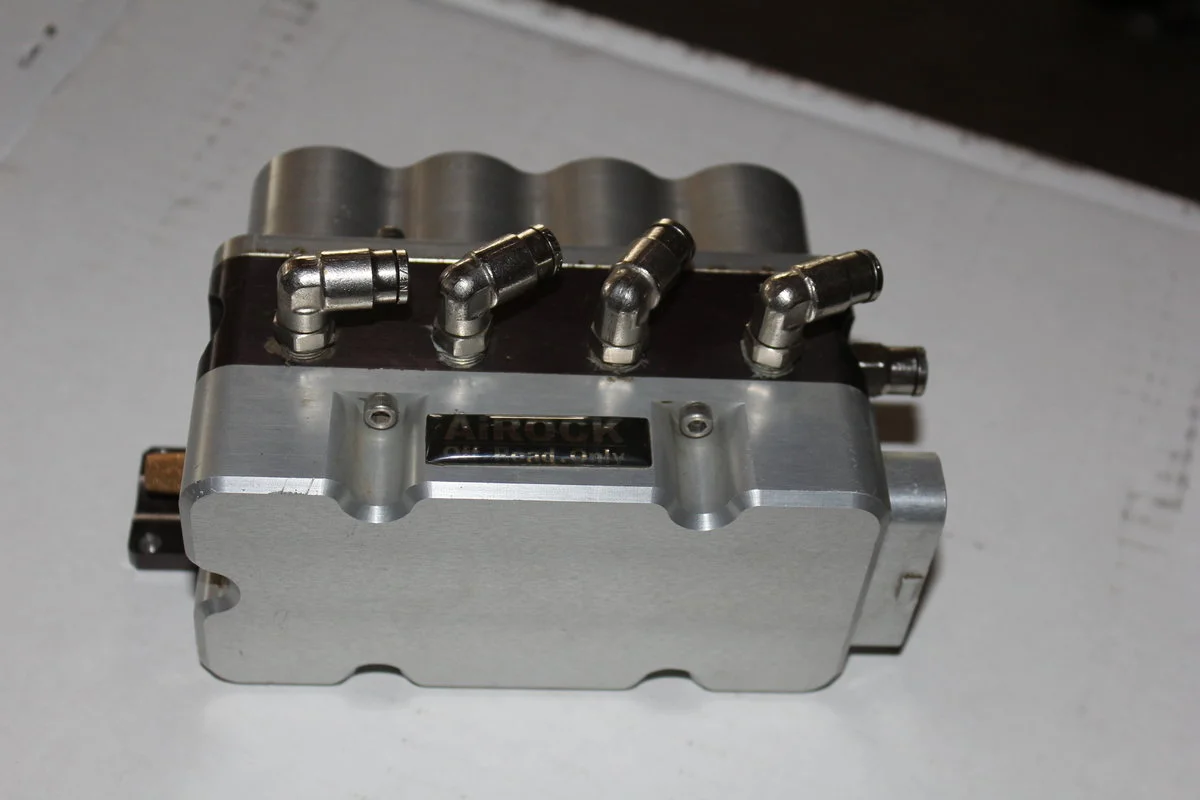

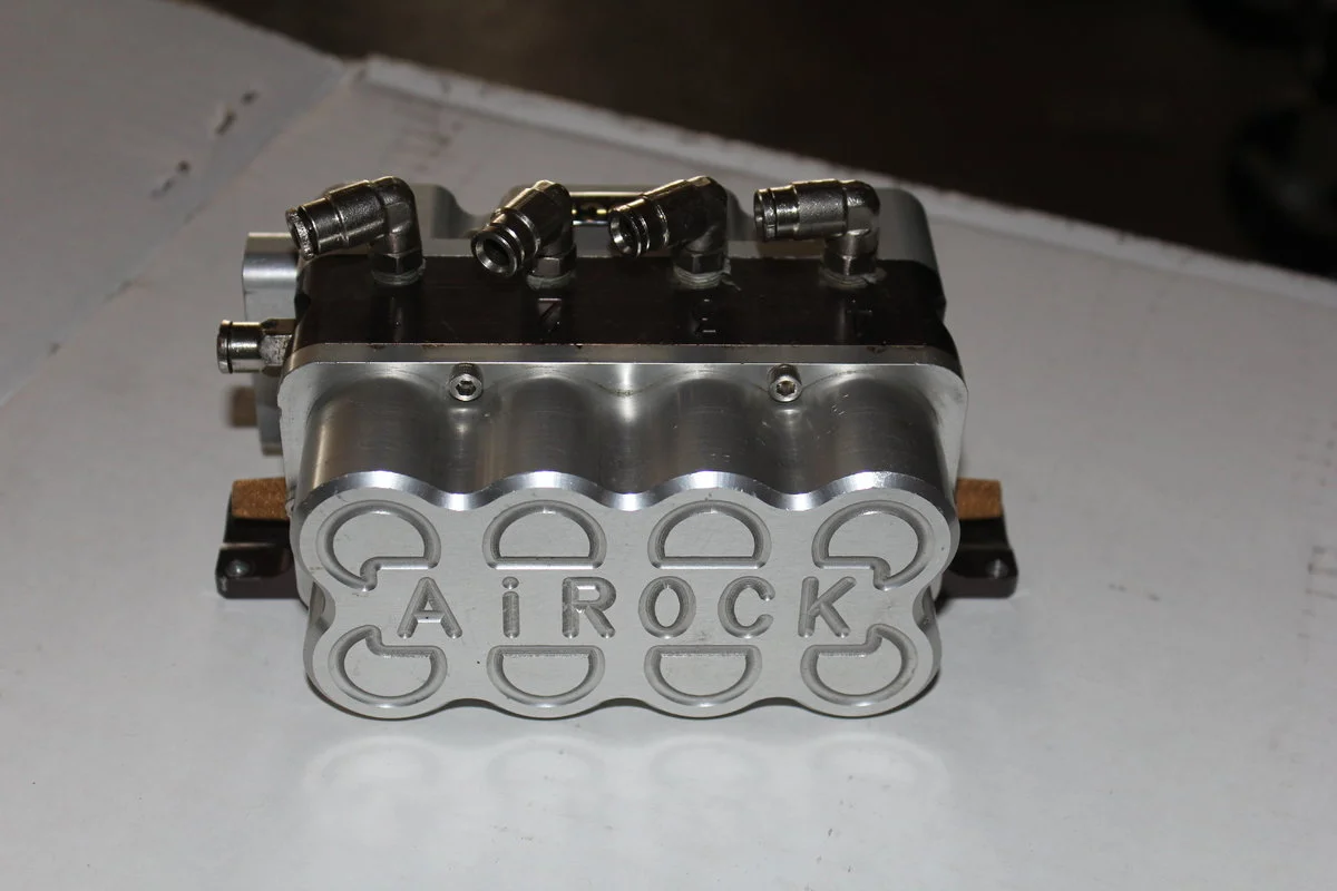

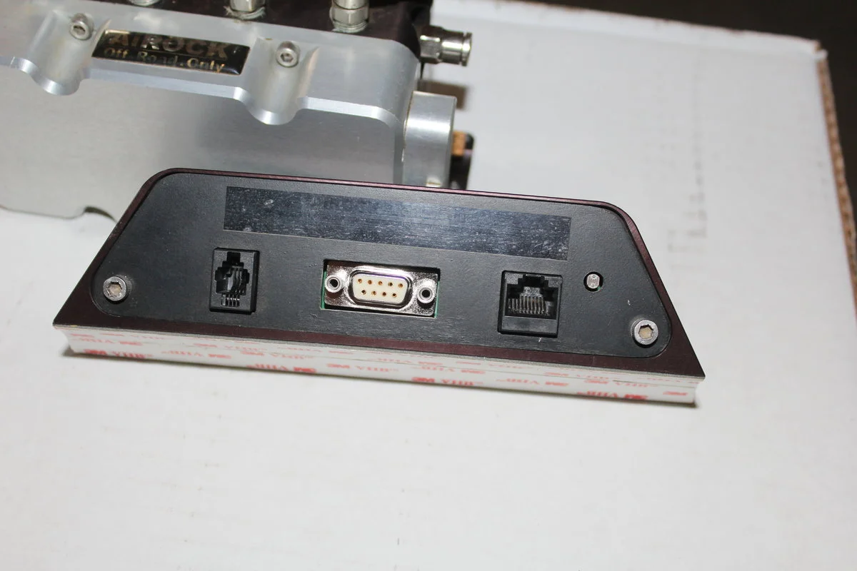

Here are pictures of the computer and air manifold View attachment 138750View attachment 138751View attachment 138752

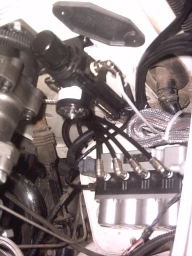

Here is what it looks like hooked up.

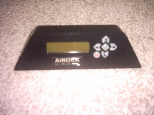

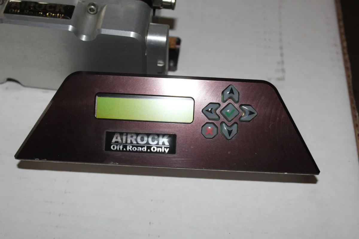

Then this is the controller for the dash
View attachment 138754View attachment 138755

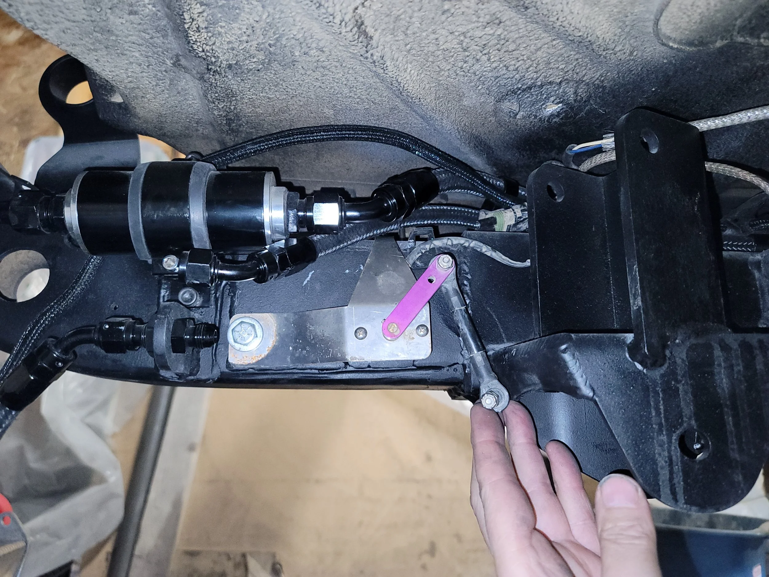

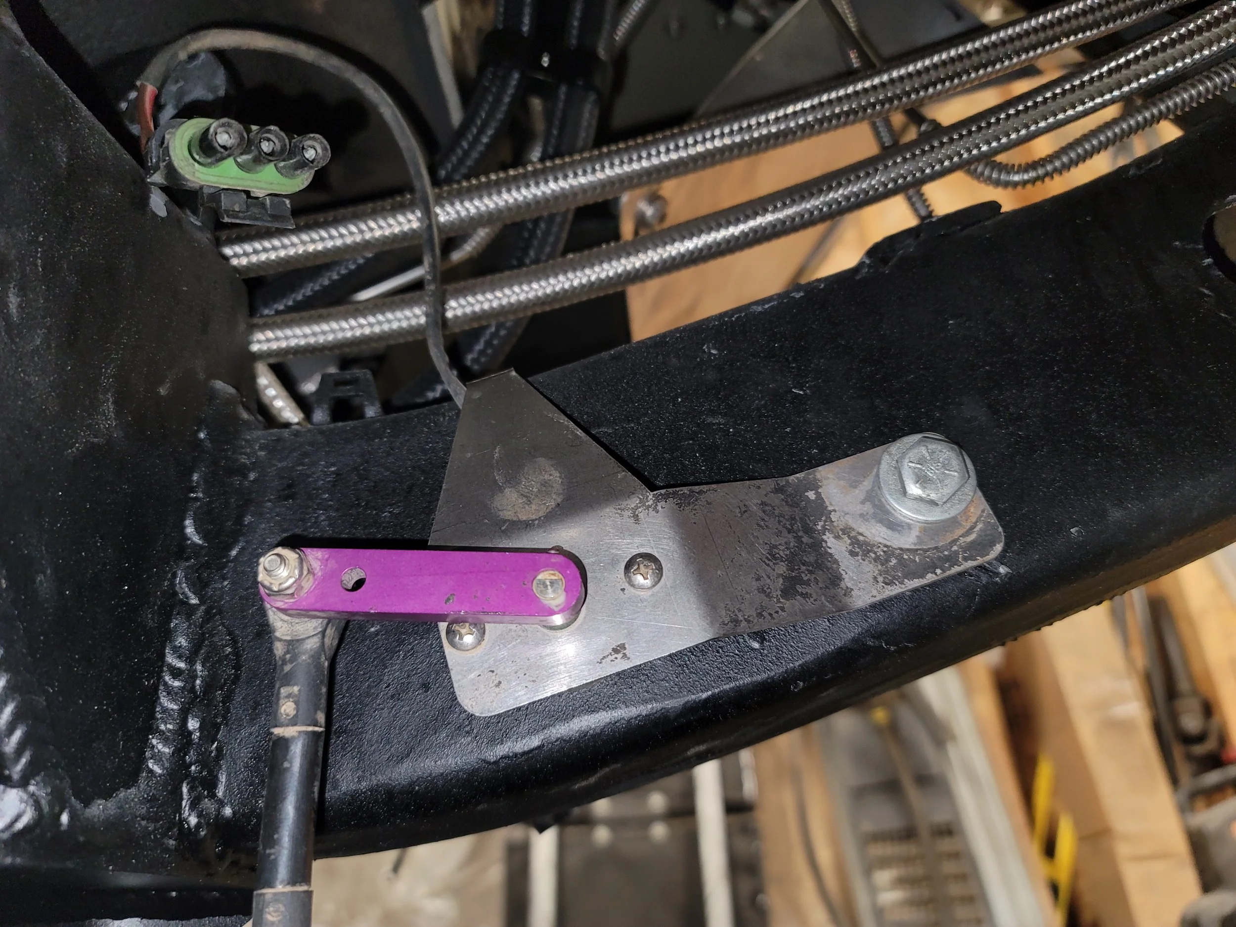

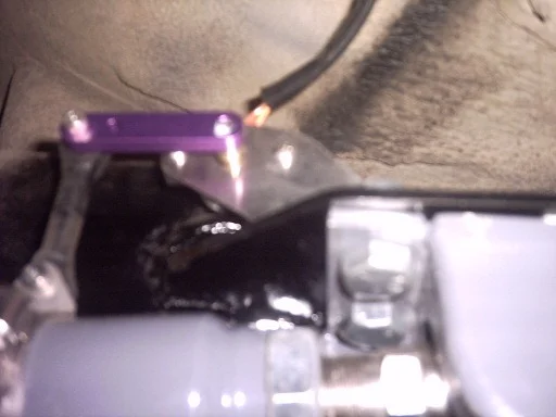

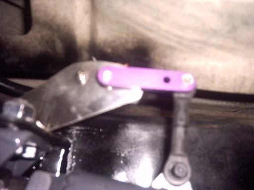

The system uses height sensors to determine how much air to put into each air bag. The sensors are connected to the lower arms of your suspension.
View attachment 138760View attachment 138761

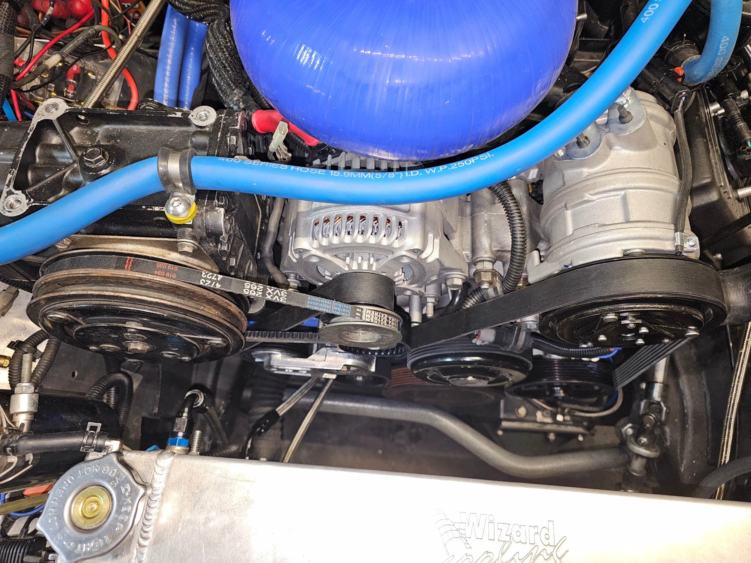

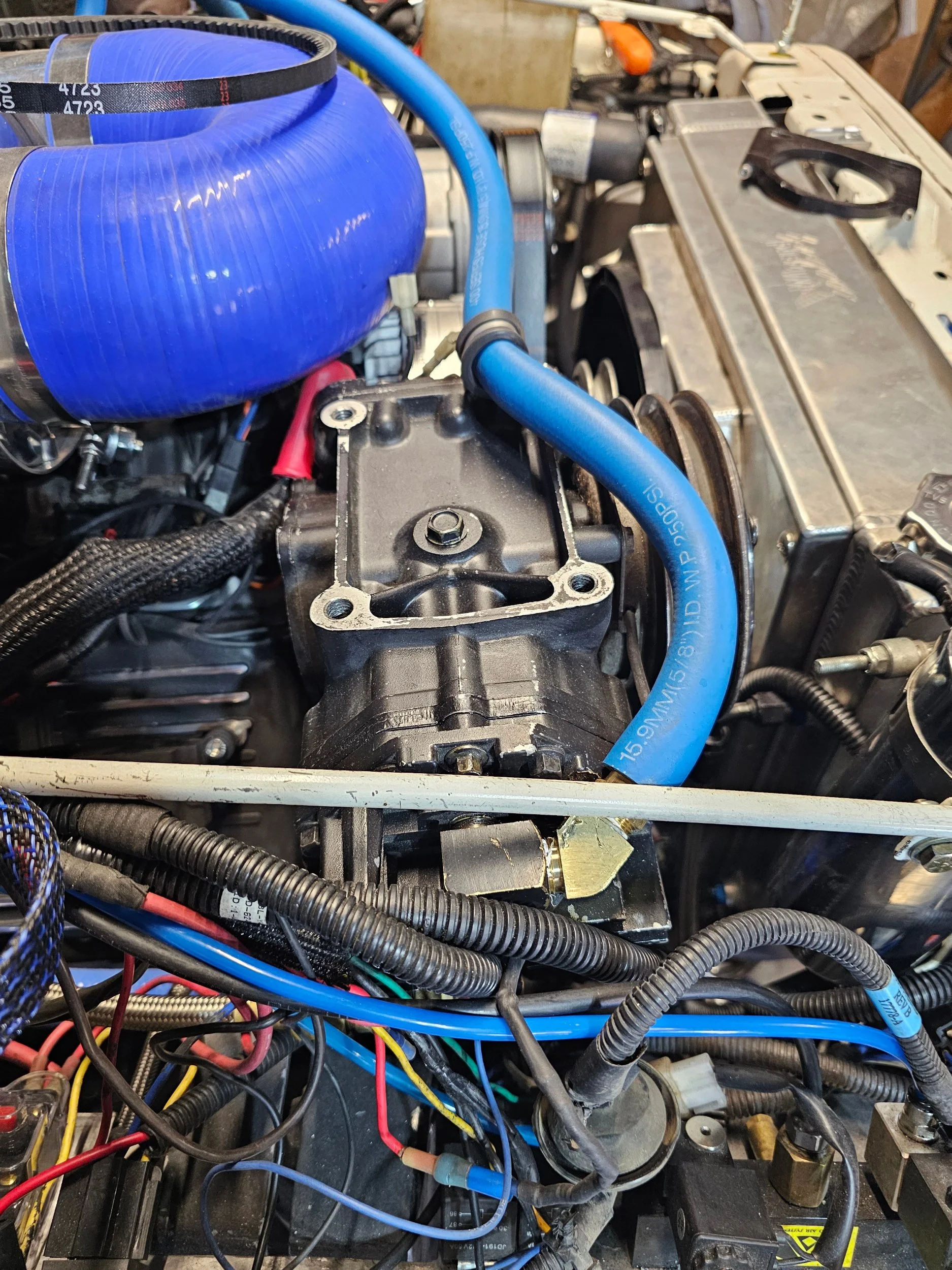

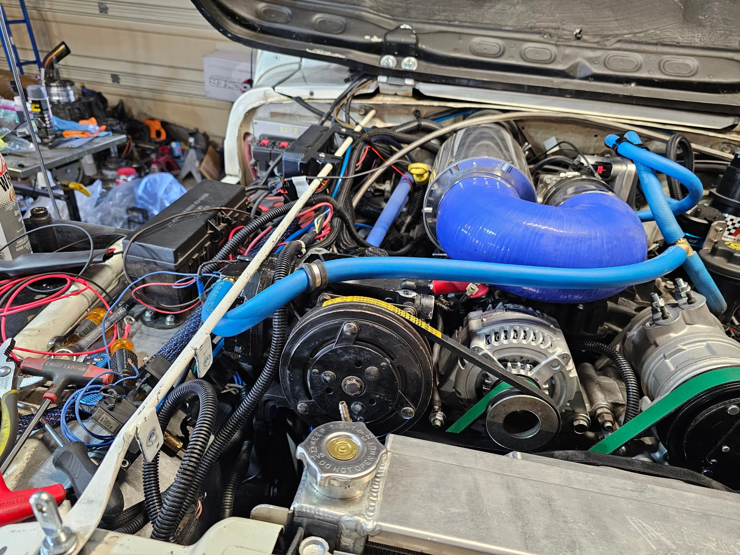

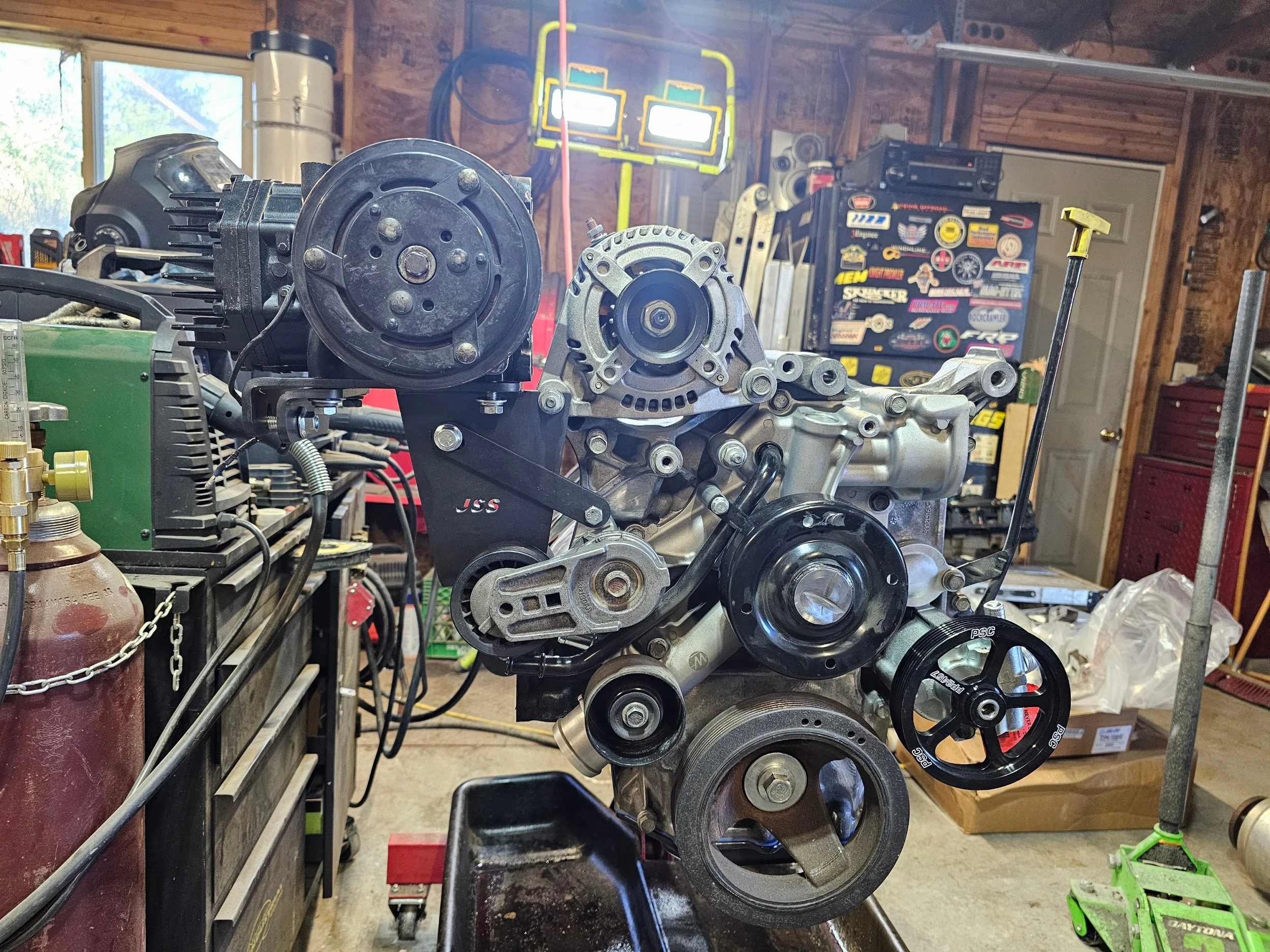

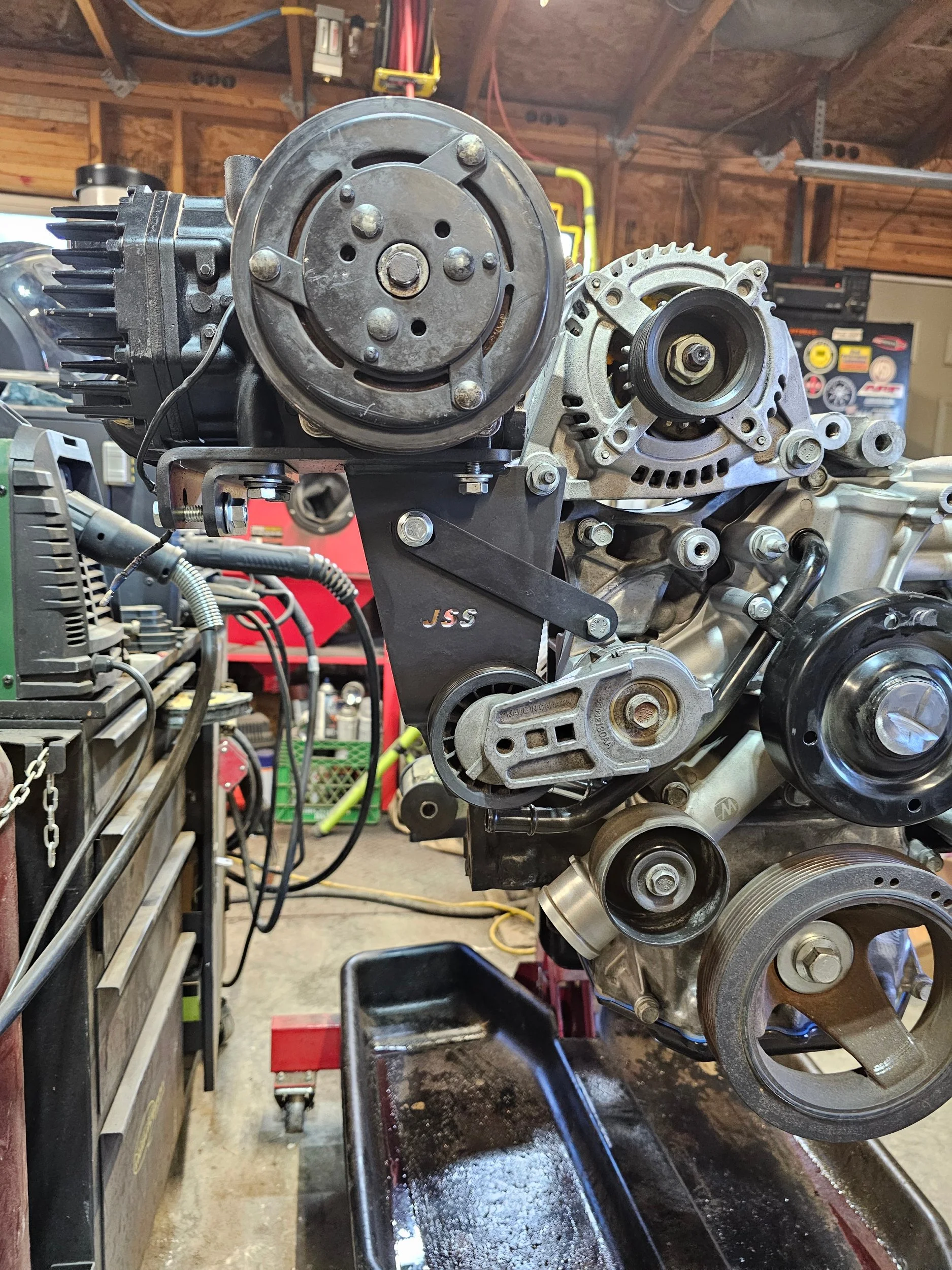

The pump is a York compressor but mine is different than most since I have a V-8 (Hemi) in my TJ.

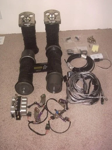

This was the complete kit.

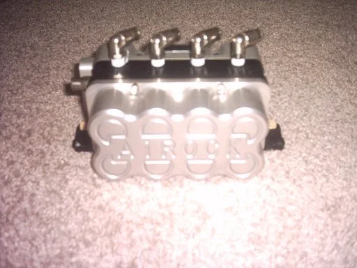

This is the brains of the system and the air distribution system.
This is the controller that goes on your dash.

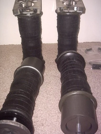

And the air springs.

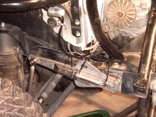

The height sensors mount in different ways depending on which suspension you're running. I drilled & tapped these holes in the frame & then mounted the height sensors.

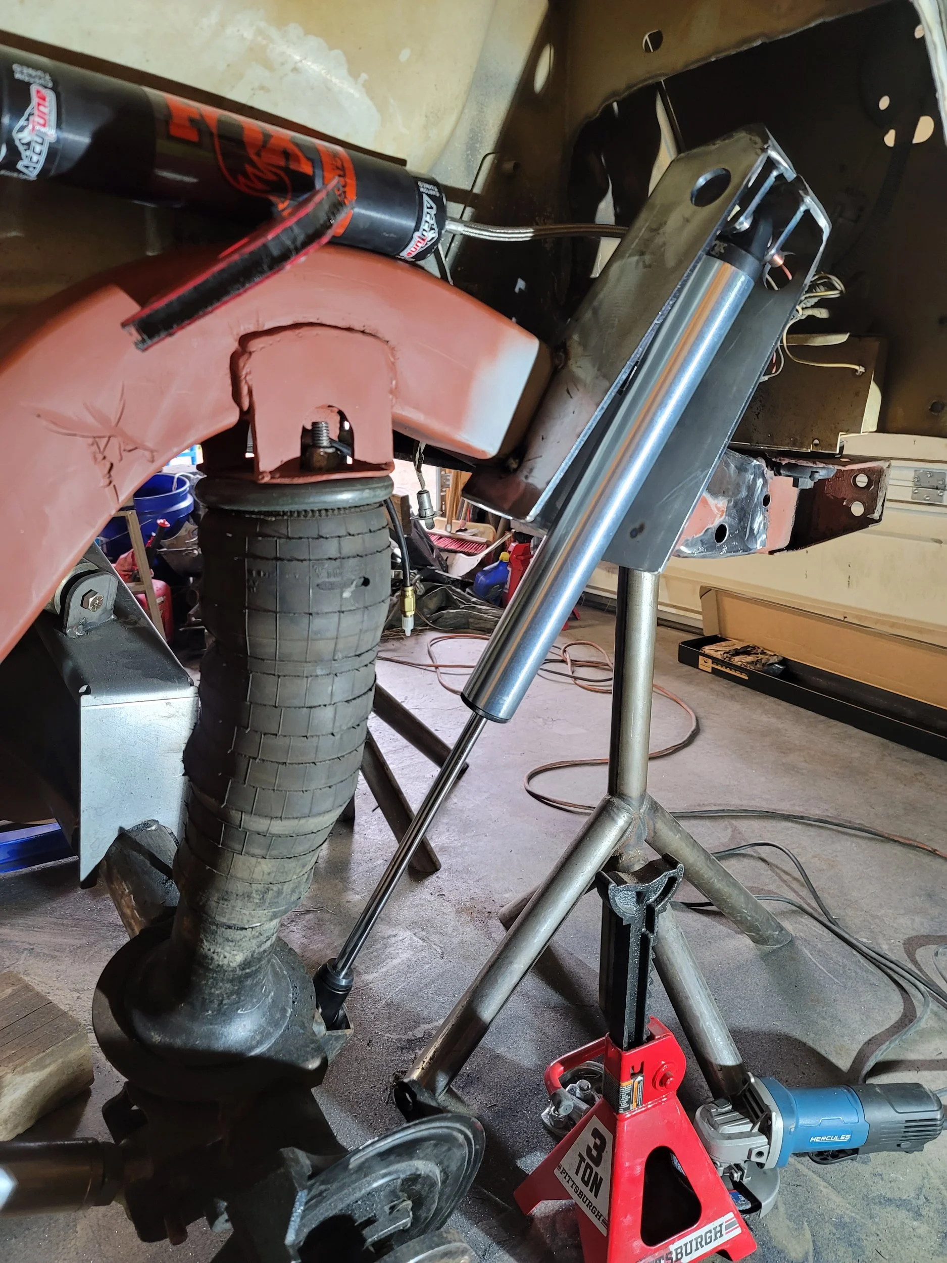

I made new mounts for the air springs and tried to get MAX travel out of the air springs. ORO sells a 10" travel shock with the 6" kit but I'm using 12" shocks front & rear.

FOr me the York mounts to the front passenger side of the engine.
When the engines installed in the Jeep it's tight.
