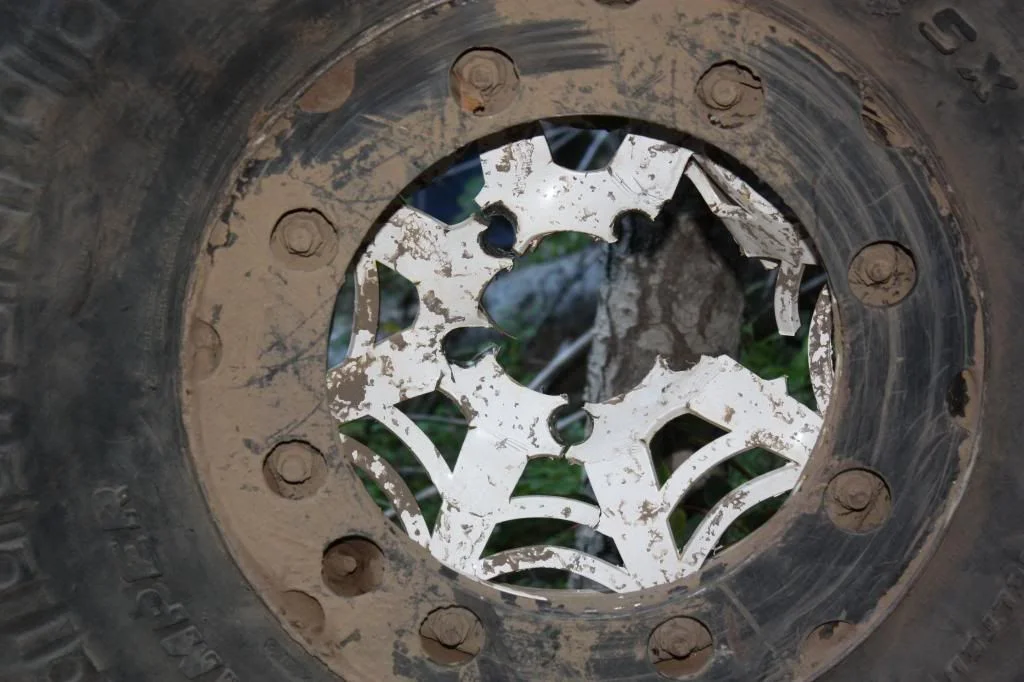

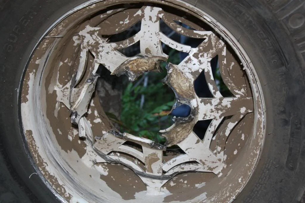

When this happened over in Rimrock:
And then the wiring for the electric fan caught on fire I determined it was time to park it until I could figure out why it was always running hot.

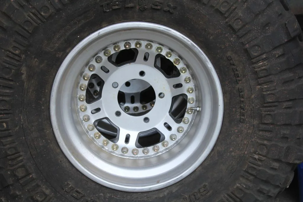

And I got these from StazWorks to replace my recentered H1 rims.
Yes Trail Jamboree 2010. The last year the Jeep was running.

IMHO the o-ring on H1 rims is easier to deal with than the o-ring on Staz rims. And getting all the bolts on and then tightened on the Staz rims is LOADS of fun. But I knew all this before I started so what can I say.... I'm a gluten for punishment. My biggest issue at this point is the lack of 16.5 tires that are being offered anymore. Interco and Pitbull are about it for off-road tires.
I still have two rims that need to be setup and the tires mounted. When I get ready to do that I'll try to take some pictures and post up with all the fun.

I started out on Allied beadlocks when I first built this Jeep but I kept burping my inner bead on some of the trails in the Rimrock area. A few other club members were also burping on some of the trails so it wasn't just me. At the time one member had a shop so they did a group buy of Staun inner beadlocks. I'd come across a great deal on the H1 rims and because I was familiar with them I went that route instead.
I'll run these tires until they are worn and then I'll switch to a 17" wheel. Not sure if I'm going to go inner beadlocks then or what I'll do.
