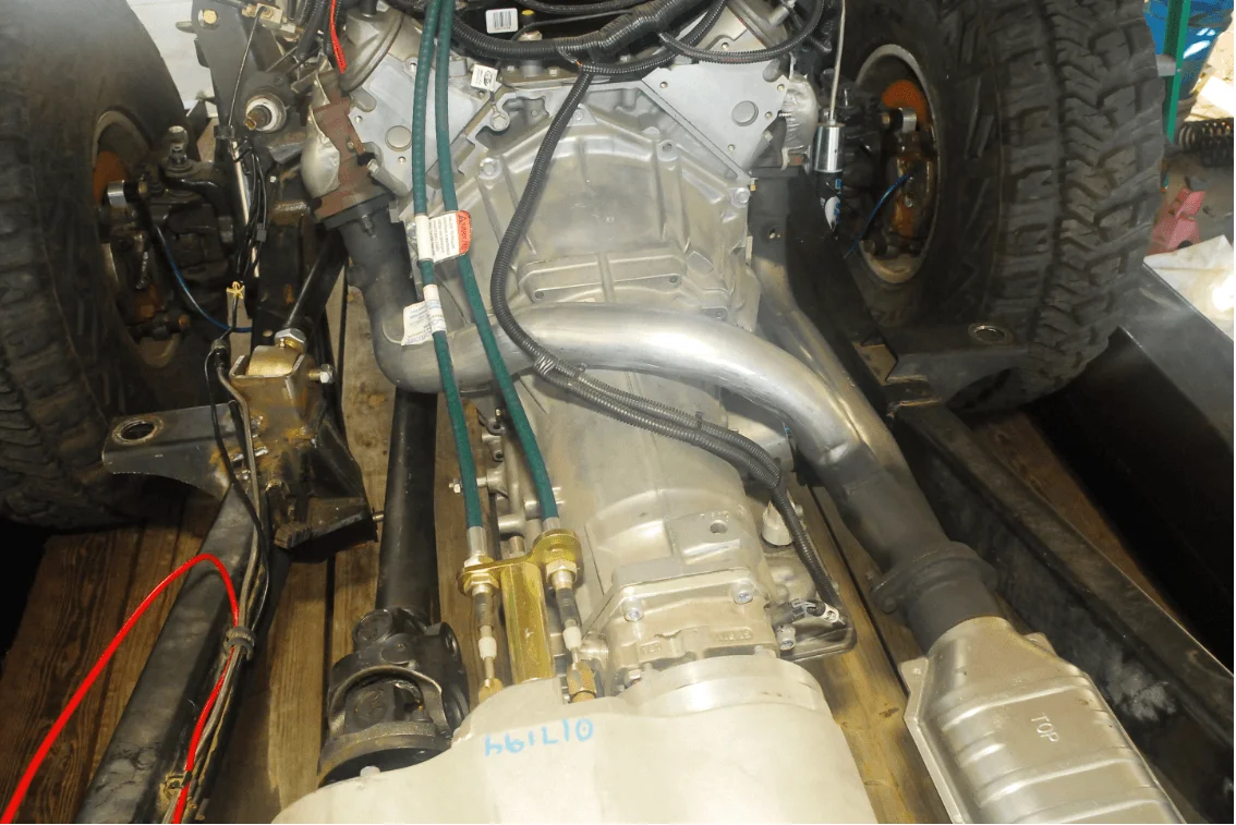

So, do either of you think that a transmission swap is harder than this?

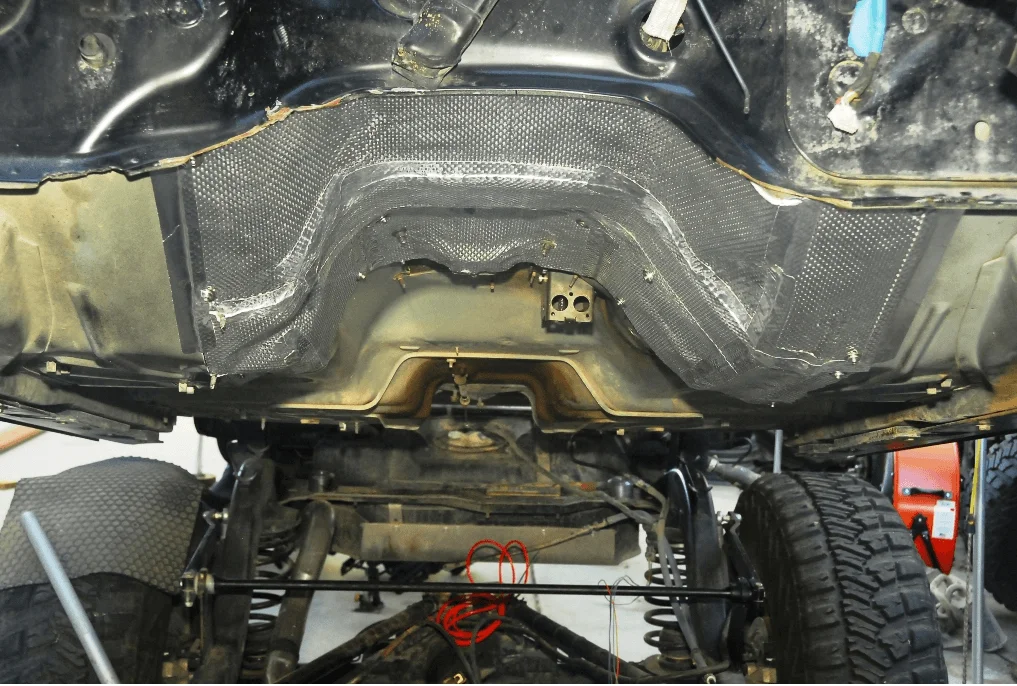

Just to get the exhaust routed-
And the associated heat management.
