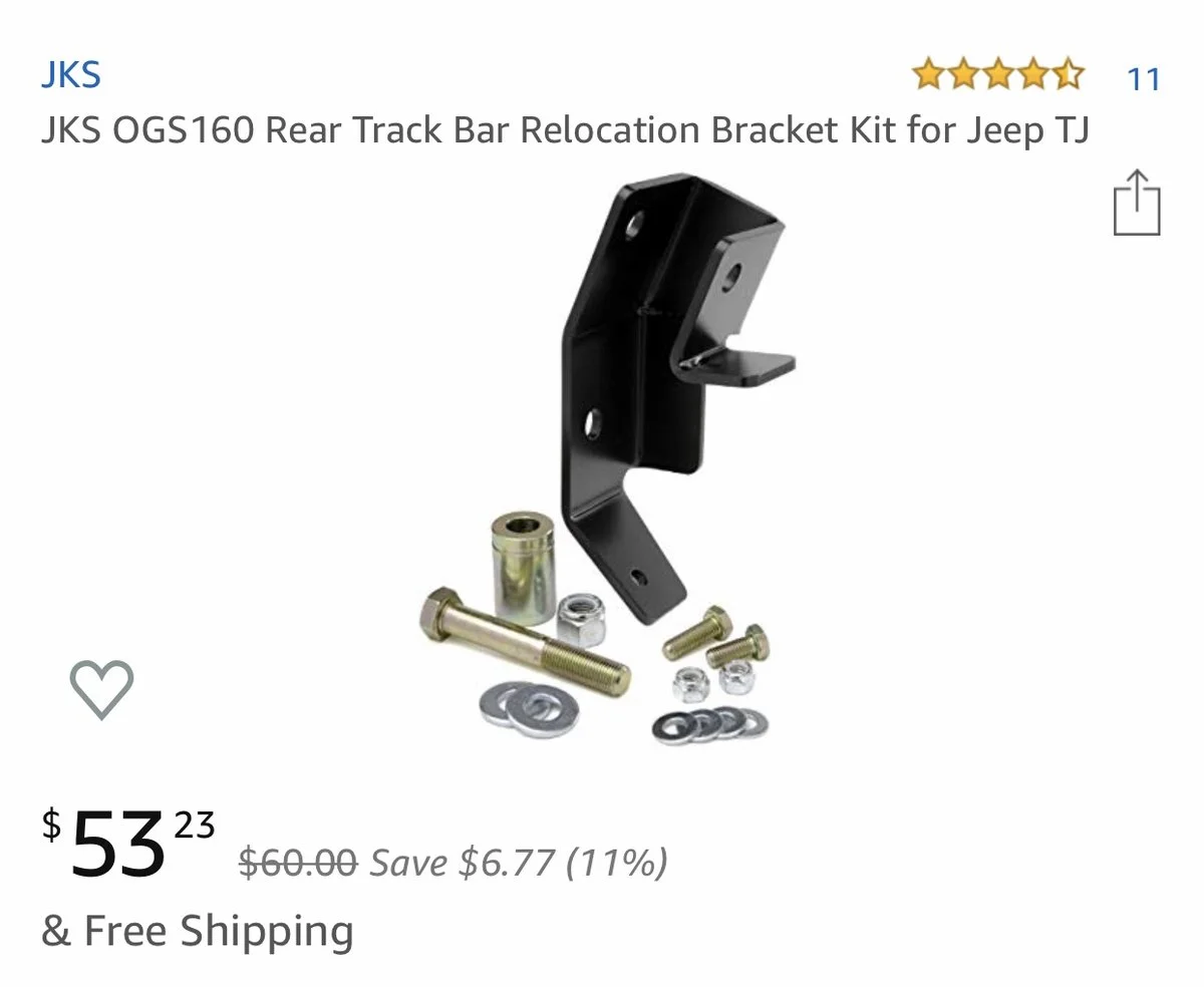

@Specks what did you end up with on the rear track bar?
I installed my whole lift this weekend and 4wp back ordered my track bar relocation bracket so it wasn’t available. Getting my original track bar back in after a 3” lift was the toughest part of the whole lift.
It was supposed to be a 2.5” lift using rough country shocks but I got about 3” front and rear.
I opted for the JKS adjustable.
Overall it wasn't too bad, definitely a good learning experience. I got my a$$ kicked on the T50 bolt that holds the track bar. I soaked it in Aerokroil, PB Blaster and was using a pneumatic ratchet to try and break it loose. No dice. I later remembered reading on here sometimes you just need a BFH. I gave it 4-5 good whacks and it broke loose. What a relief that was.
