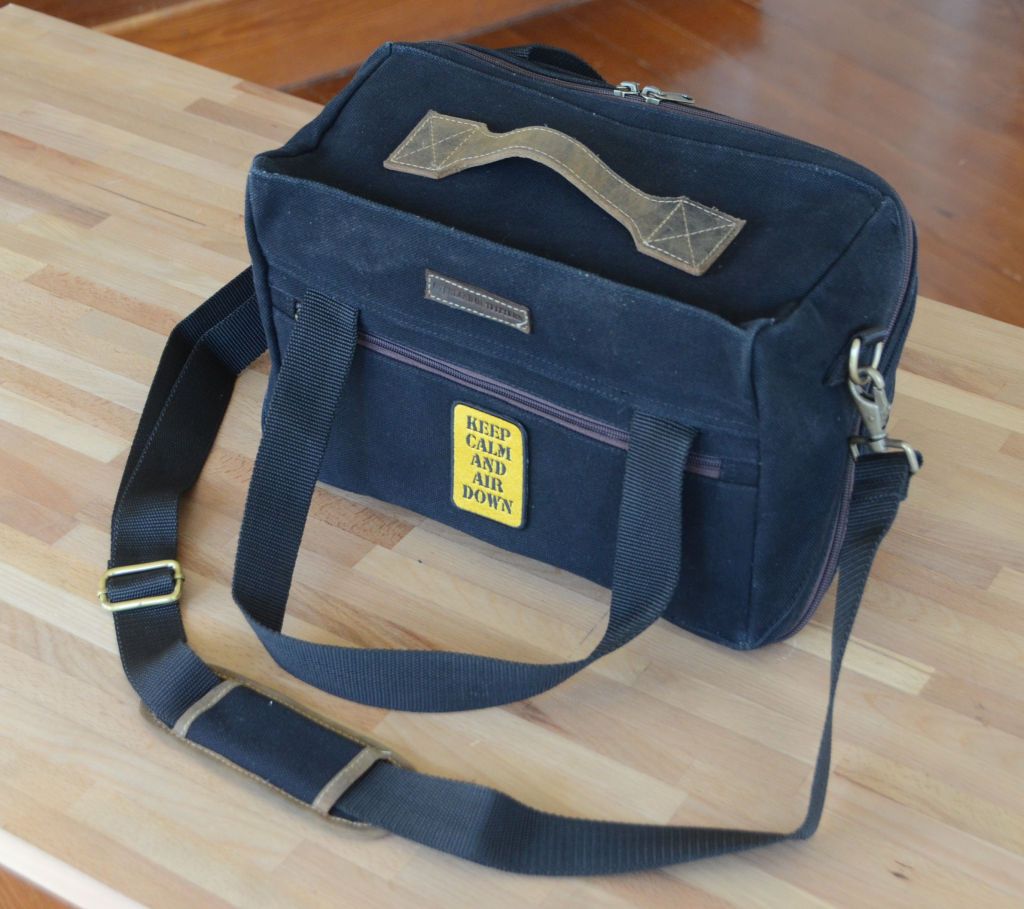

Overland Outfitters sent me some preproduction photos of the Compressor bag:
It's heavy black canvas and the brown accents are leather.

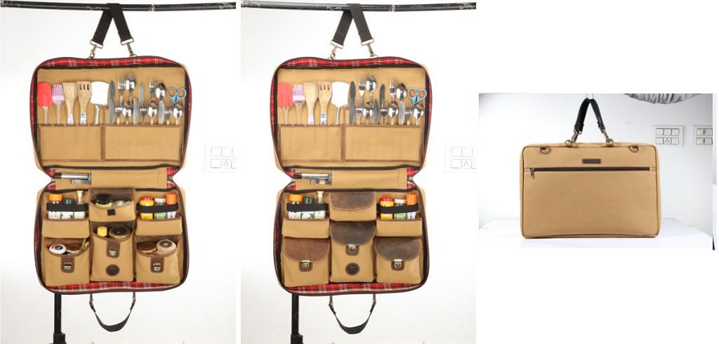

Also in the email - photos of a preproduction Kitchen Keeper:

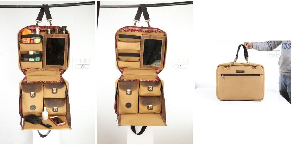

And a preproduction Camp Campinet (vanity bag). I can't tell if the black rectangle is a mirror reflecting something black or if there's no mirror in it yet and it's been blacked out with Photoshop.

Yesterday I received (finally) 3 preproduction Compressor Bags from the company. Today I checked them out to verify the details and construction. They're very close to production ready, I only had a few comments to send back to the company.
The production bag may have the leather handle pictured or it may be webbing, they haven't decided yet. The other two samples they sent me have webbing handles and they're very nice.
It's also not clear at this point if the production bag will include the 'Keep Calm and Air Down" patch.

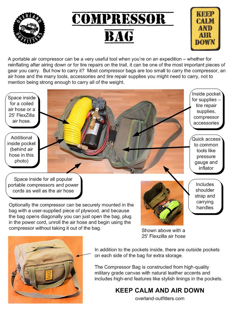

The bag designed to fit all of the popular portable compressors, plus the power cord and an air hose (a 25' Flexzilla hose fits in just fine) and it's got pockets for assorted tools and tire repair supplies.
A draft flyer, this was done before they had their own samples so it's got photos of my prototype. It's all a draft subject to change but I don't think they'll mind if I share.

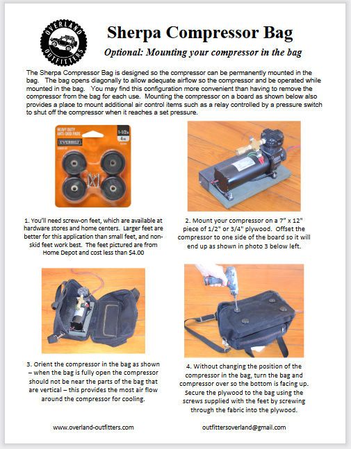

Sometimes companies ask me to take photos of products installed in one of my Jeeps, but that's not necessary with a product like this so they'll do their own studio photography of the final product, but they did ask me to take a few photos and write a draft of the instructions for mounting the compressor permanently in the bag. Like other bags, the compressor can just be thrown in this bag and removed for use, but this bag is designed so the compressor can stay in the bag during use. Since I already did that in the prototype bag it was easier for me to take the photos and draft instructions than it would be for them, so I did this:
They'll edit and format it to their liking but the basics are there.
