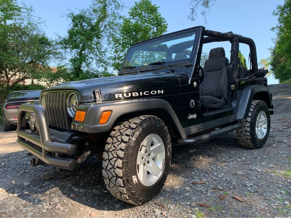

Opinion on potential TJ purchase

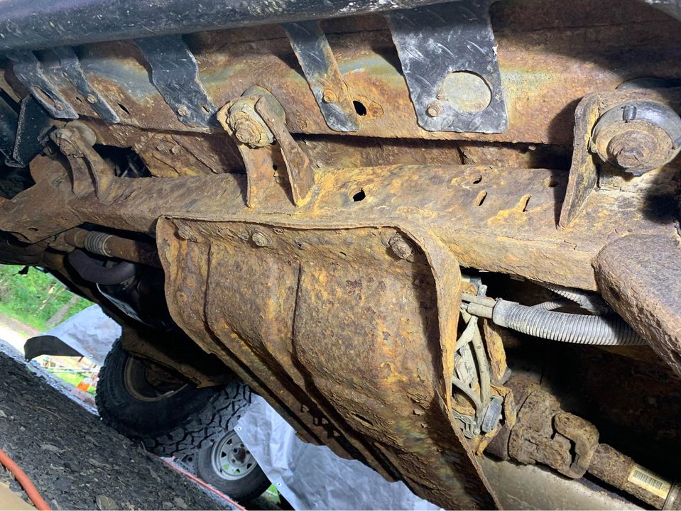

Where in Florida? Skid plate has alot of rust between it and the frame.

looks pretty good, is it a Florida jeep it's whole life? The frame looks to be good however there is rust between the skid & frame rails, very common, but I'd want to drop that and see how extensive it is & also make sure the bolts are still operable. None of that would be a deal breaker, assuming everything else checks out. And what's that dripping from the skid, perhaps tc or trans fluid, I'd look deeper into that too. If you aren't mechanically capable I'd take it to a trusted mechanic for a once over.
Edited to add: check the entire frame inside and out, feel around inside for flakes... tons of frame rust threads here to consult. TJ frames are notorious for rusting, so beware...

Assuming that it checks out mechanically and the rust isn't an issue, what would be a fair price for the vehicle?
10k max, but I would hard pass if there is more rust than what's in the pictures.
Besides the frame, pull back the inner fender liner directly underneath the gas filler. Shine a light up to the tub and see what rust, if any, is there. Given the time this Jeep spent in NJ, even with low miles, I'd be giving this the eagle eye!

Spending 15 years in the salt belt of the NE would most certainly require a thorough inspection of the inside of the frame rails.
Since there is obvious rust between the frame rail and the skidplate; that would be the first place to inspect as others have responded.
Do a thorough inspection of the frame dog leg as it goes approaching the spring perches and the frame mounts where the tub is suspended on the frame.
It will need new tires - those ones are old. Something that tips me off to rust is the condition of the air filter box clips and brake booster. What I see in your pics would make me want to look carefully for further rust issues. The oil pan looks like it might be just about rusted through (happened to me).

That frame looks pretty rotted on post #19. I just get the feeling that there is more being hidden from all the rust on the oil pan and engine compartment. Also, those look like neoprene seat covers. But, I could be wrong.

The rust in the engine bay alone makes me think it has been "under water" more than once....most likely salt water. Then the frame is starting to show stage 3 cancer....
